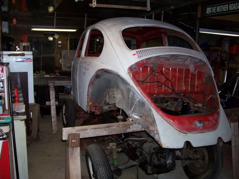

FINALLY!!!!! The body is off the chassis. We lifted it last night (8-1-07). It took us this long since we didn't have electric, so that means we couldn't weld the bracing.
[IMG][/IMG]
[IMG][/IMG]
[IMG][/IMG]

We haven't had power in the garage for a couple of weeks and the Holidays just killed me. I have been working around the house. I finally got the tins painted for my engine. I had to throw a screw ball into the car onca again. I'm going to have a fairly nice paint job and the car is going to look be well known in the area (not many bug around) and the engine is going to be visiable. Everyone goes out of their way to have a shiny clean paint for the engine. SCREW THAT!!! Heres mine.
The paint system is REAL RUST!!! The base coat is a real iron dust paint. Then you paint a acid on it to rust it. It is real rust!! Heres the iron dust paint:
