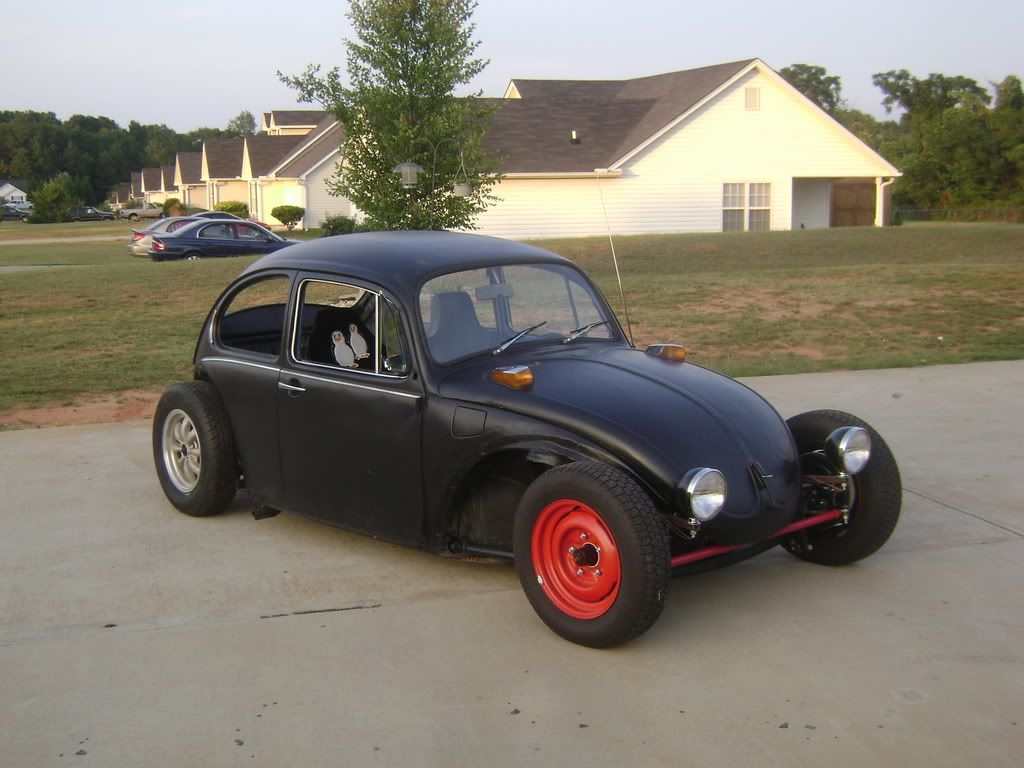

mines a super and i think it looks pretty good (though i did cut and weld alot of shit)
that's some raight thar bud!!
How many clicks down are you on the rear?

Hey Steve, how about some pics/info on your front suspension ? Can't tell much from this photo. Have you already got something out there that I missed when trying to do a search ?

Default Re: '78 Super Beetle Conv. Rat Rod...What do you think??
just plate steel welded to the framehead and angle and a plate to make a channel for the front spring, people make it to be a very hard thing to do, all i used was a sawzall, 140 amp Mig w/gas, and an angle finder.
Engineering at its best
One more thing is that i made it too low in the front and i had to cut the bottom of the framehead out and put some 2x4 square frame tubing in to raise the bottom up, but it still scrubs alot, which i recommend doing even if its not low.
here are some pics:

Thats right!!!!! and thats two clicks all the way down!! its even notched and also did the irs swap from side to side to reduce camber a little
