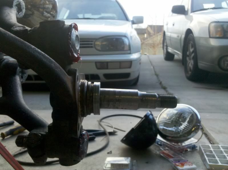

Took the front end appart to do the link pins a few days ago, and my passenger side drum was grooved all to hell, but since I haven't drove it much the pads looked ok.
So I got some parts today...they sent me the wrong fucking tie rod ends though wwoooo.... so now I get to wait till next week for the correct ones.
But I did get my new master cyl/res which should solve my leak so least there's that...
I think I fixed my brake drum as well, and pressed in my new link pin bushings, since mine looked like this

Sooooo, I started putting the front end back together but then gave up when I found the REAL reason as to why that wheel was so positive camber to the max.
Yea....guess I'm buying spindles, on the bright side though, least that means more low on the easy!
And since that kinda ruined my plans last night I wanted to get SOMETHING done so I half mounted the deck lid, just need to figure out a bottom support/latch hook to hold it down.
It poped out a bit more than I was expecting, but that's fine cause it just means I fer sure have the space to still run it when it comes time for the turbo!

Got the new spindle on (thanks ta Double D) and reemed for the tie rod flip, buttoned up the front end just needs the wheels/tires and aligned.
