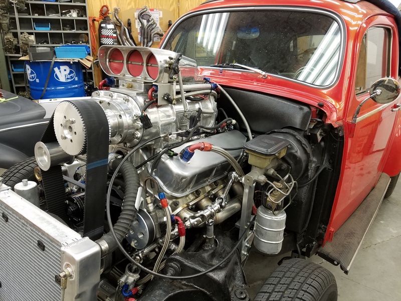

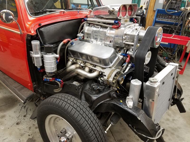

I changed the red '61 V-8 bug from small block Chevy to 548, 871 Roots supercharged, EFI big blocK Chevy and I've been playing with that.
CMD

Originally Posted by CMD View Post
Uhh.........which build......? LOL
CMD
[/URL][/IMG]
[/URL][/IMG]
[/URL][/IMG]
Is there a build thread here for this beautiful machine?
