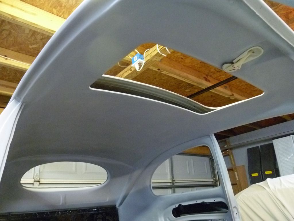

The interior is almost done. Welded up everything on the dash other than the speedo. Even the defrosters. Added A/C vents and Grant steering wheel on Speedway stainless column.
Since the car has a 73 super beetle hard sunroof grafted in, I didn't want a typical headliner. I laid up 2 layers of 8 oz. bi-directional glass cloth on the outside of the roof! I popped it off the next day, trimmed the edges and adhered it to the inner roof over a layer of X-mat. Sanded and filled and sanded and filled and sanded. I now have a really nice solid fiberglass headliner...

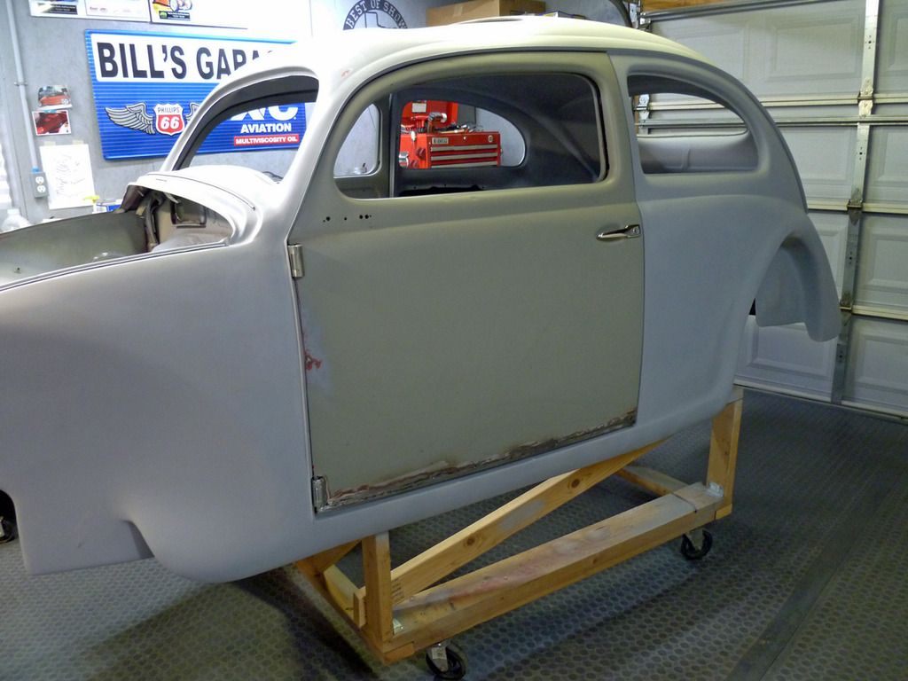

I also re-fitted the doors. Once the fiberglass rocker panels were on, the doors were too long. I had to cut a 1/4" section from near the bottom of the doors.

As noted previously the doors had to have a 1/4" section removed. This was removed and finally re-welded, ground and filled smooth. I also welded up all unnecessary holes, skim filled and sanded smooth.
