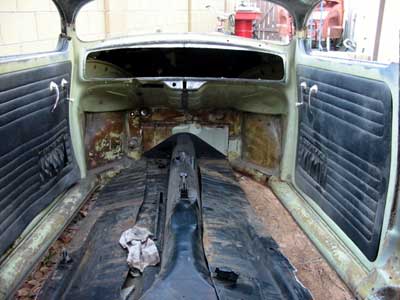

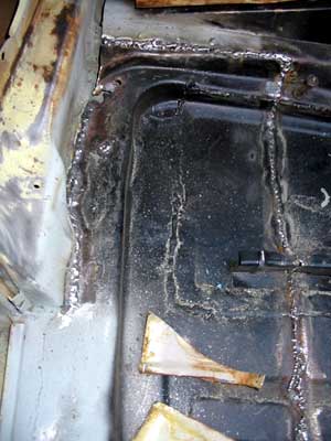

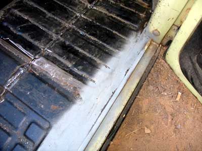

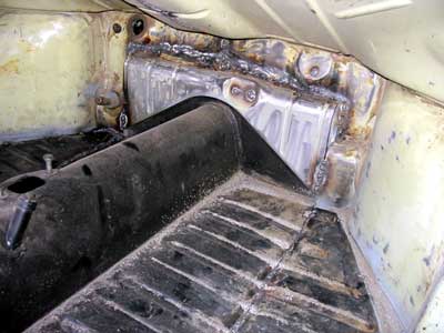

Finally, some more pics I promised.
On this pic you see that I cut the pan in half and trimmed the front and rear pan bulkheads to get the body down to where we needed it. You can barely see the part that was cut out, it's just sitting in there for fit.
in this pic, you cen see the pan half resting in the car unwelded... look to the rear bulkhead-- see that primer? under there is a 1x1x8" of square tubing to act like a spacer. It's not a strong enough area to cary the weight of the car, tho. We'll add that later.
Here you can see the floor welded in place, and a patch panel needs to be made for that naked corner where the pan lifts up. Look closely into that corner and you'll see the weld on the previously mentioned 1x1" tube. It's covered in weld-thru primer. Oh, BTW--- does anyone else get crazy splatter when using weld-thru primer? The welds look awful whereever I use it... that section that looks like I chewed thru it was the old jacking point. Incase you hadn't guessed--- it's got to come out first!
You can really see the amount of the drop in this pic. I still need to make some patch panels where the side is open. Why? I dunno. [img]style_emoticons/<#EMO_DIR#>/Idunno.gif[/img] Just gotta do that.
Where the floors end up! you can see that I still need to remove the other half of the seat bracket and finish that weld.
Still got lots more to go, I'll takes pics of the bracing and the package tray work I'm going to do when I get back from cold-ass New Jersey for the holidays. [img]style_emoticons/<#EMO_DIR#>/ohmy.gif[/img]

Anyway- the car will be a unibody. The other side of the front bulkhead is already welded to the pan and so are the floors. the rear is next.
The only problem I saw was that the torsion housing would be 'buried' under the body, and that would make it impossible to adjust/ replace parts. I'm going to clearance the side so I can get to it, I haven't decided on how--- either like a beetle (visable) or like a Ghia/ T3 (behind a little panel).
Other than that, the car will be a lot like a unibody H20 Car...
I may do a 'mini cage' later-- -basically a hoop extending up from the torsion housing and braced to the frame horns and the sills at the door--- there'd be a few tabs attaching to the body.
As far as ground/ unground welds... I want a finished car. The original plan was to leave it ugly, but at this point I'd like it to look good. If I do leave the welds unground on the inside, they will be painted/ covered with bedliner... all the welds will be a 'reminder' of what went on. [img]style_emoticons/<#EMO_DIR#>/smilespin.gif[/img]
