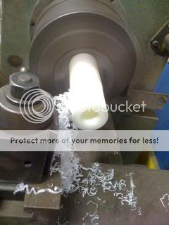

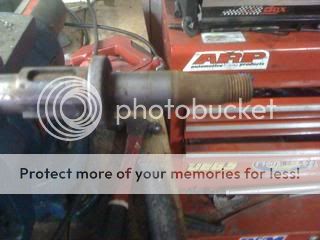

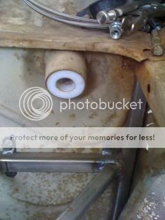

this is how i did mine I cut some UHMW
pounded it in from the cabin side
hooked everything up using super beetle u-joints and shaft
this is the part of the super beetle shaft the goes to the steering wheel just cut the threads off grind a notch for the bolt to go through
and then weld it to the rag joint coupler (i cut the tabs off)
way easy it just takes time
I can't make it "idiot proof" the universe will just make a better idiot and send them my way
life is short make fun of it!
Dbug41 is offline   Reply With Quote

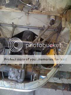

Default Re: BEAM EXTENDER "FAQ" THE BASICS 101
Why is the box so far towards the center?I centered the shaft in the column,with the pillow block holding it centered,it doesnt make any contact with anything down the column.I cross drilled and pinned every union as an added saftey feature,dont trust my welds that far!
NONYA is offline   Reply With Quote
so I can run my 10" without cutting a notch in the hood

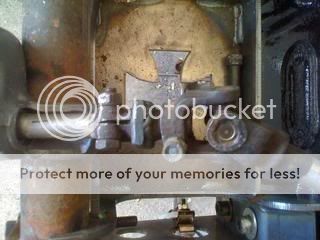

Has anybody had any problem installing the Dbug41 8" lp/lp Extension & Tie Rods? My uncle was working on the car and told me that after installation of the extender the tie rods hit the extender.
G00se is offline   Reply With Quote
Old December 16th, 2010, 08:43 PM   #120
Dbug41
Dbug41's Avatar
Location: Ogden Utah
Posts: 1,070
Ys this has been a problem for a few of my customers recently and I am taking the neccecery steps to correct it unfortunatly this does not help you in any way. most people have an adj. beam therefore this is not an issue with the wieght put on the car.
what I've done and what others have done is to grind that one plate back to the bolt plate there is more than enough steel to do that. Sometimes on custom cars you still have to Cut, Weld, Grind...
So your saying that if I have an adjustable beam I should be ok?
He was going to grind it a little, so, thats no problem. But i told him to hold on before starting to cut since I hadent heard of anybody having an issue. He likes to get "cut happy" and i wanted to make sure it was ok to do that.
