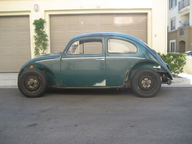

After looking around for weeks, I found a bug that met my needs, and my budget. She has a 1600 single port, and is already converted to 12 volt. I picked her up in Long Beach, and, after overheating in Compton and Hollywood, she arrived home via towtruck. So far I have charged the battery, removed the cd player (there were no speakers anyway), and taped up the driver seat with some fancy black duct tape. Total cost of repairs: $6.49 plus tax.

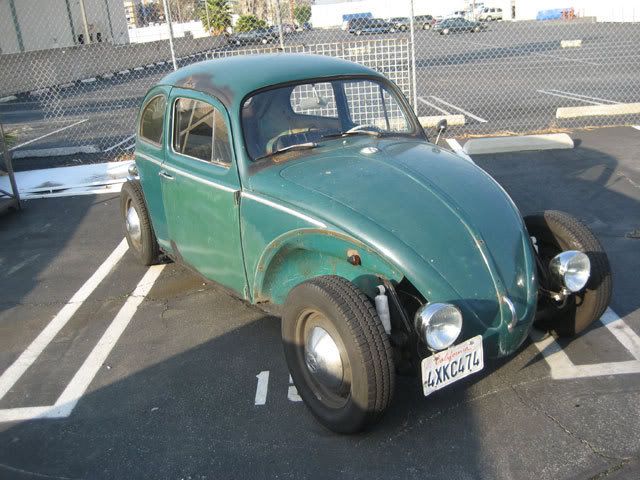

Both ends are lowered. The front maybe a bit too much. I snow plowed the driveway pulling into work this morning.
I also ordered headlights and taillights. Fenders will go when those arrive.

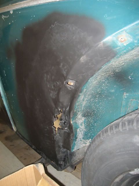

I ended up raising the front an inch or two to prevent fender rub when turning. My taillights are here, but no headlights yet. I gave up removing the pistons from my swap meet connecting rods. I planned to use them to mount my headlights to the beam. I found another set, minus the pistons, on eBay.
I also picked up an angle grinder and some Rustoleum this morning. There were a few primered spots on my bug that were rusting through. After some grinding I found that the primer was covering bondo, and the bondo was covering some giant rust holes. In front of the windshield there were even a couple pieces of galvanized steel under the bondo because the holes are so big. A quick spray painting will have to do until I save up cash for a welder and learn to use it.

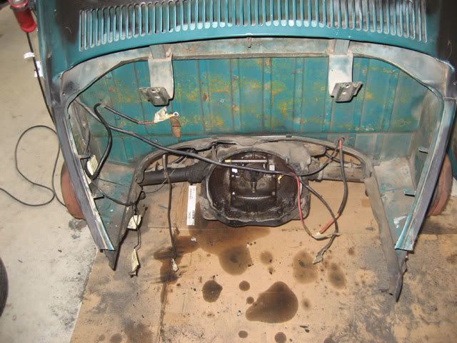

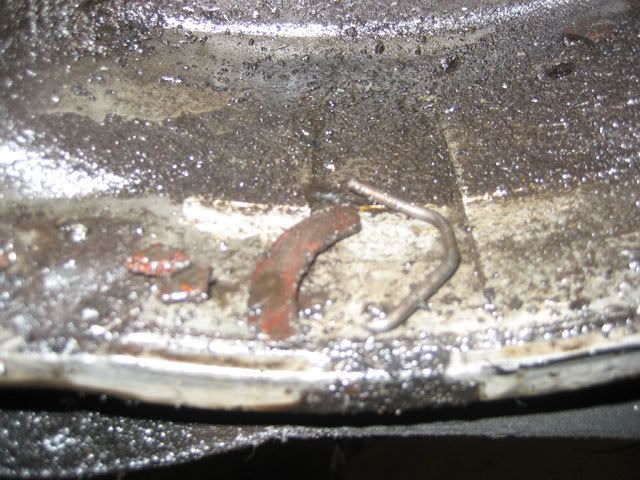

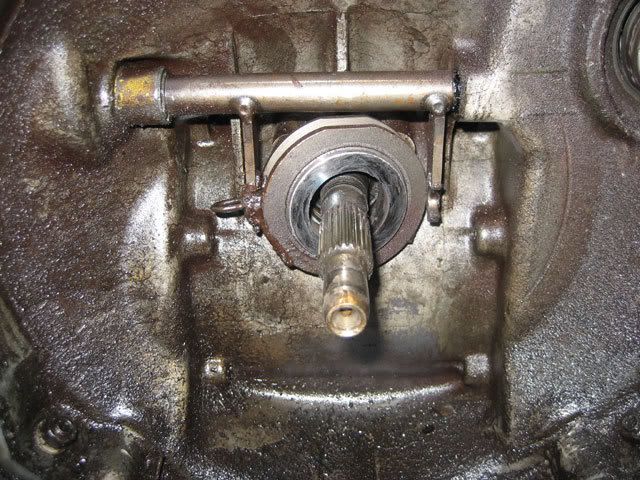

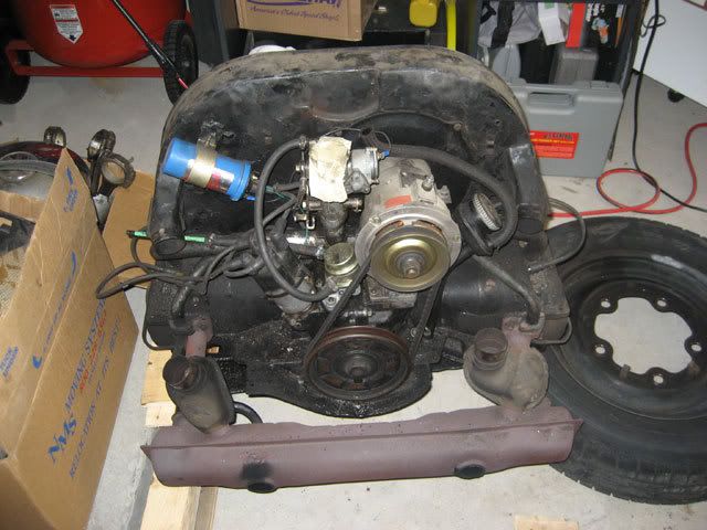

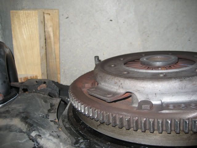

I barely made it home on Wednesday. My clutch was acting up. I thought maybe the cable was binding somewhere, but I wasn't so lucky. The clutch lever on the transmission was stuck. So, I decided to pull the engine out and have a look. I've never done this before, but it was pretty straight forward. I also decided to lose the fenders and chop the apron off while I'm at it to make pulling the engine easier. Once the engine was out, it was obvious why the clutch lever wouldn't move. The throw out bearing was totally jammed in there. There were also bits of metal in the bottom of the case. I think the fly wheel and starter gear need to be replaced.
Before
Fenders
Leftovers
Empty engine bay with apron removed
Dirty engine
Jacked throw out bearing
Crud in clutch case
Jacked fly wheel
I'll update again when I get it back together. Then I can pull the front fenders and do some more cutting up there.

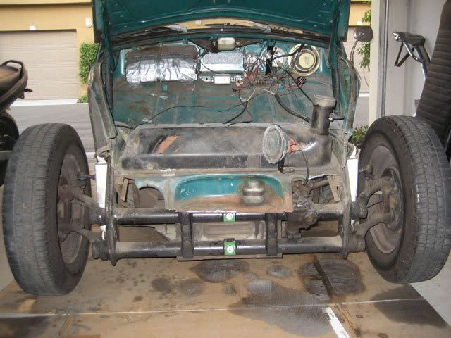

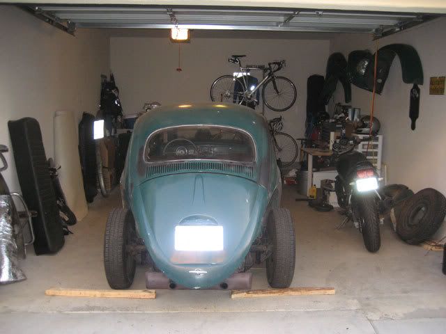

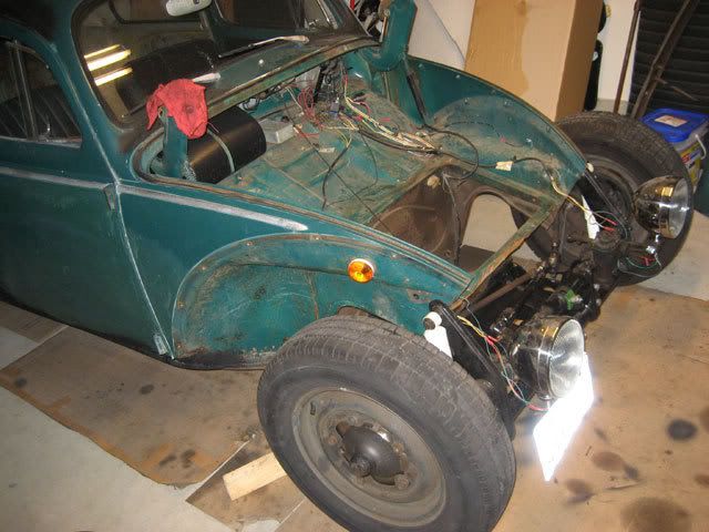

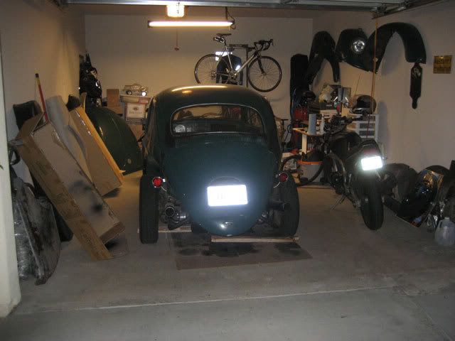

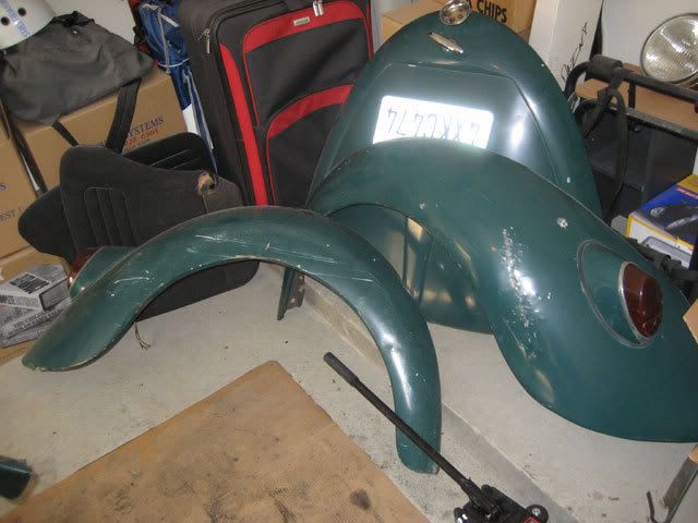

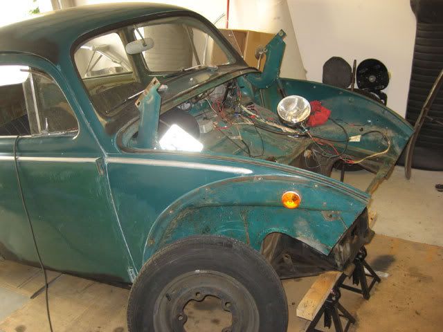

Bug chillin in the garage after a day of cutting. Hung the fenders on the wall to keep em out of the way. On the right is my parts getter.
Frontend minus fenders. Needs a beam extension!
Kept the stock fuel tank and brake fluid locations. Remounted the horn to one of the fuel tank bolts.
I have headlights and taillights waiting in boxes. Might spend some time on those tomorrow.

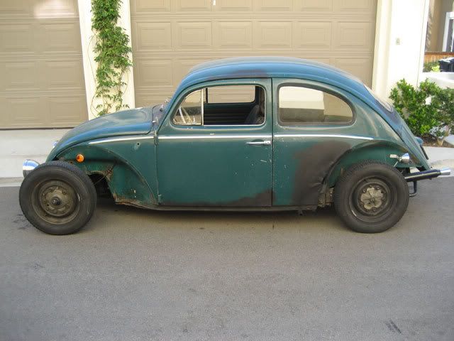

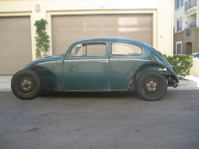

Here are some updated photos.
Current
Planned
I'm also gonna order a dual exhaust from the bug shop on Monday.

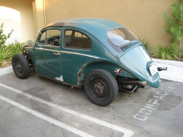

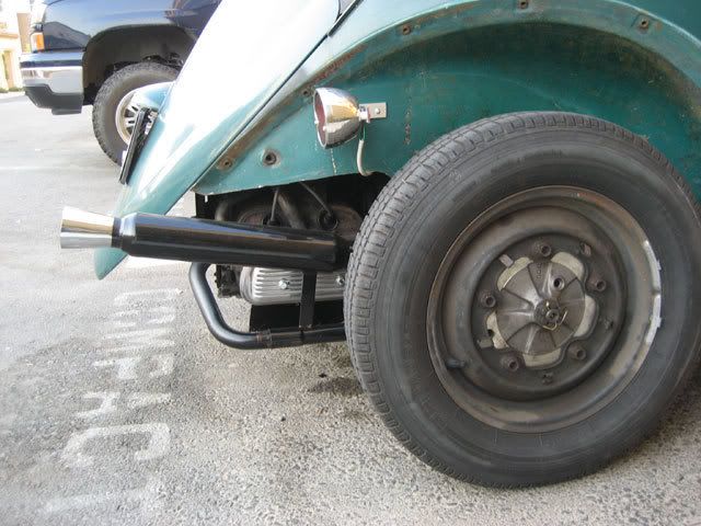

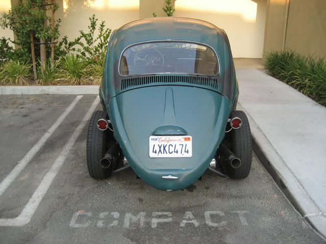

Picked up the dual exhaust yesterday, and mounted it today. It sounds soooo much better. I also moved my headlight mounts from the lower part of the beam to the upper part for about a 5 inch difference. Before I kept worrying about hitting my headlights on a curb when parking.
I've had problems the last couple days with getting the tranny in gear. I think the clutch cable is backing out of the wing nut. I'm gonna try throwing an extra nut on there to lock it in place.
I'll take some pictures of the new exhaust and headlight setups tomorrow.

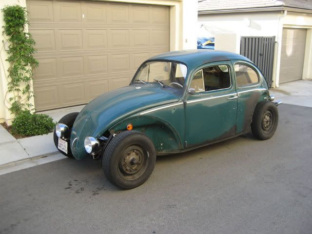

Took some new pics after I drove her home from work.

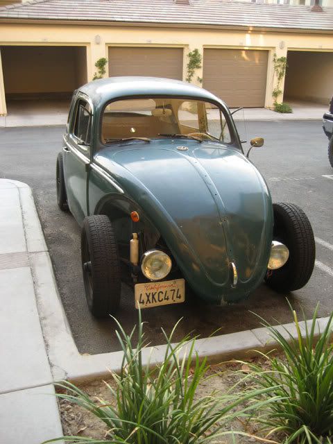

The headlight setup now that I've raised them up.
The new dual exhaust!
Check out the progress!
Before
After

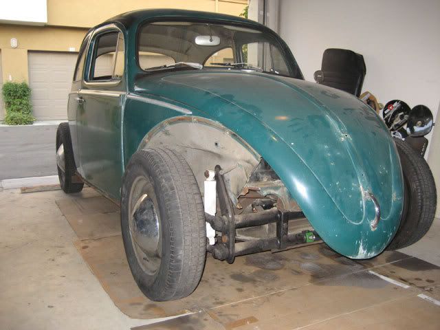

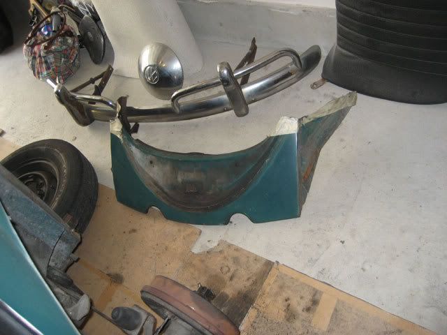

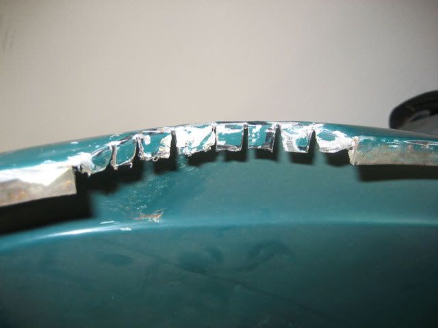

Saturday - I took all the bondo off the driver side rear quarter panel. My entire garage was covered in white dust.
Sunday - I scored a donor quarter panel at the Pomona Swap Meet for $20.
Today - I got the tracking number for my beam extension!

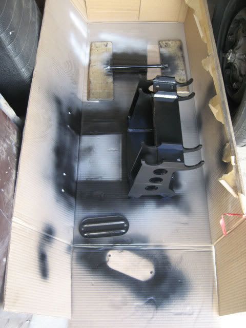

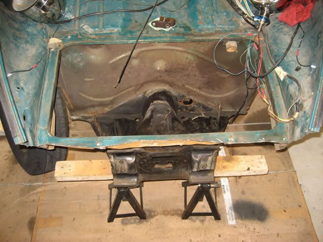

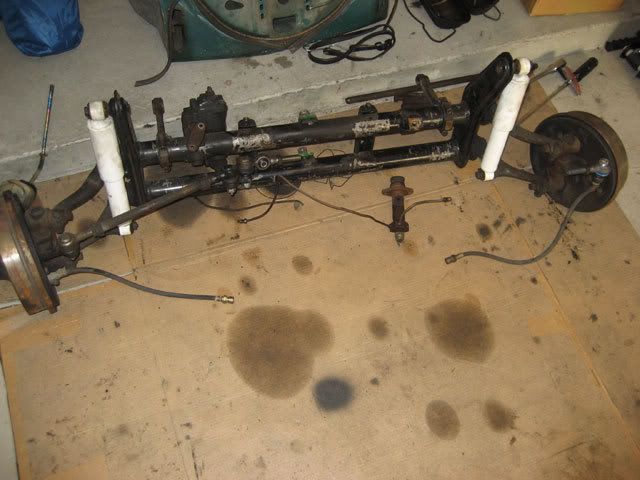

Everything is pulled apart. I'm just waiting for the paint to dry before I put it back together. I found a couple local welders too, so I'm gonna take the steering shaft to be shortened and welded this week.
Front end with beam removed
Painted beam extension
Front beam on the floor

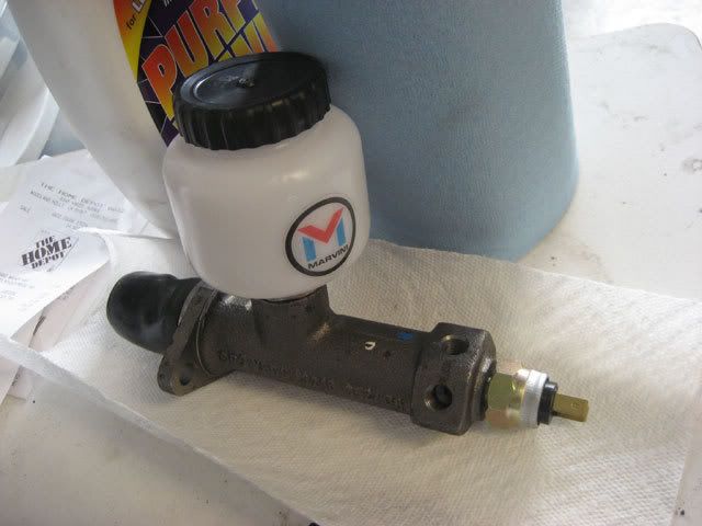

Bus master cylinder and fluid reservoir

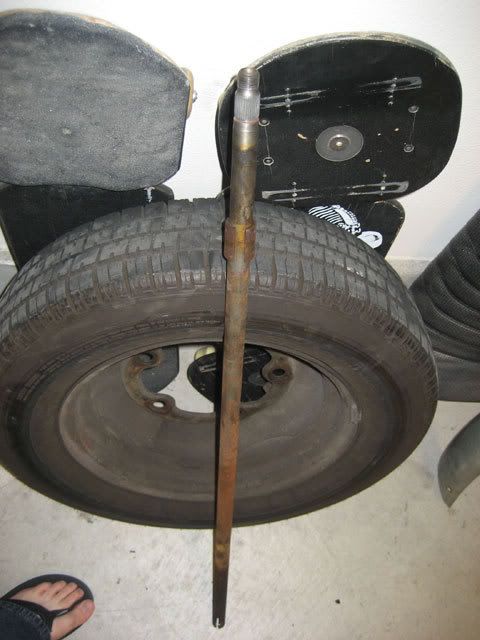

Steering shaft. Do they all have those plates, or are those just for column locks?

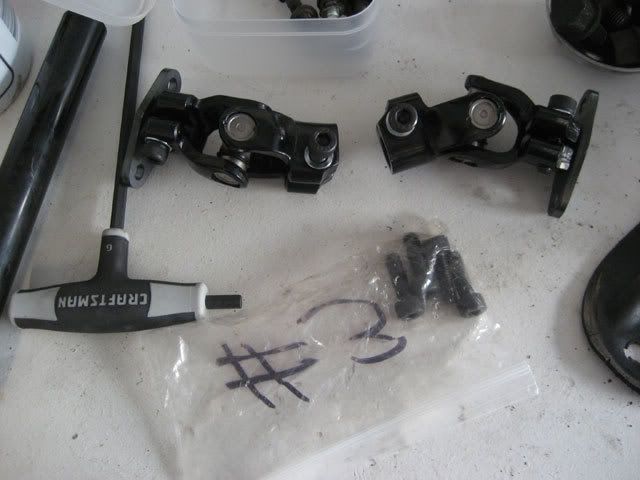

Empi U-joints with couplers. Are those bolts from Tinbeater for the couplers?

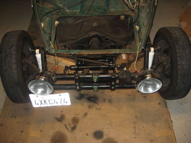

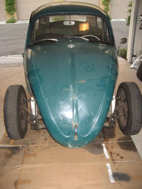

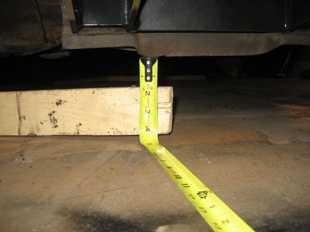

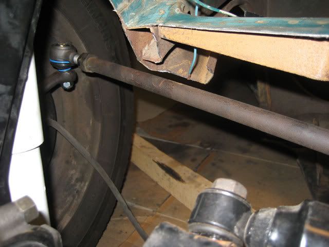

We have extension! (But no steering, brakes, or gas tank.)
Make sure to clear some room for the tierods.
I was surprised by how low it is. About 4.5 inches clearance under the bulkhead.

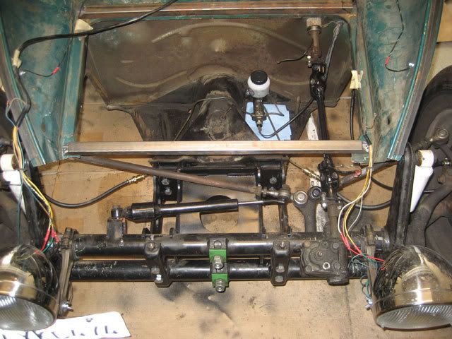

I got everything back together today.
I added a new crossbar of 1 inch square tubing to support the front of the fuel tank, and hold the front of the body together. I used another piece of 1 inch tubing to raise the back of the tank the same amount. My wife, Sarah, helped me bleed the brakes. I raised the adjustable beam about an inch to prevent the tierods from rubbing the body. I also used a tape measure to roughly adjust the alignment to about 1 inch toe in.
I wanted to point out that so far I have not done any welding. The only welding needed to get the car to this point was to shorten the steering shaft. I had a machine shop do that for $40.
New cross bar, steering linkage, and brake lines
Pie cut on hood to clear steering box
