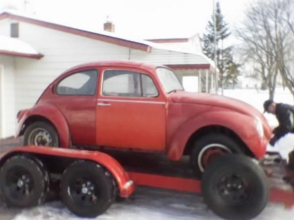

Well I found a nice 74 Bug and picked it up for $200 minus the suspension & drivetrain and it even came with a set of new floor pans not installed yet!!
So I can get rid of the Super Beetles! Thats good cuz I'm surprised the neighbors didnt start calling the township on me for all the cars in the driveway haha. Cant even keep my Nova at home cuz theres NO room right now!
I ordered a beam extender and picked up a new ball joint front end with dropped spindles! Going saturday to get the rear control arms, a steering box & a sunroof top I guy cut off a car that I will put in when I chop it.
I'm finally moving ahead now that I got the right car!!

This is the newest one.. obviously its not that low... I just had to stick the tires under if for some visual effect lol!
