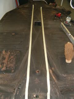

Started cutting.....
Removed the bottom of the tunnel to make room for the driveshaft.

Yesterday I made a "template" for the frame that later will be welded under to the chassis.
And started cutting..........

Now I need to spot weld everything and check if I did the measuring OK.....

oh and to keep this post on track how did you do the measuring.
For the outside of the frame I took the bolt holes for the body mounting as a reference.
The rest is very basic.
On the back I followed the "hornes".
In the centre I used the outside of the tunnel as a reference and on the front the size of the diff.
Hope I did it OK.
After I spot welded everything together I will do a "test-fit".
Don't think it will be a problem.
Then the complete frame is welded and welded to the chassis. The holes for the bolts that hold the body will be drilled when the body is on the chassis.
This is just the beginning........................
