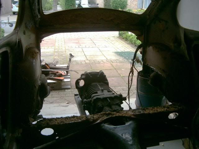

This morning I finaly found some time to work on "De Konjel"..........

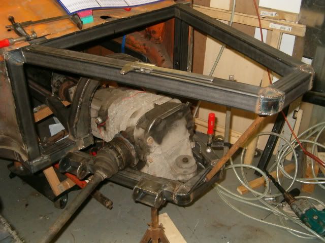

Made the bracket to hold the front of the diff. and did some pre-assembly to see how it looks and if it all will fit.
Think it will be OK.

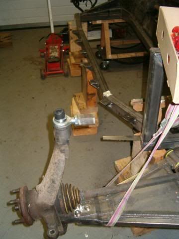

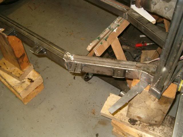

Started with the brackets for the frontsuspension.

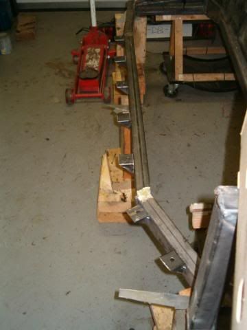

A little up-date.................
After a few weeks with a lot of other things to do that are more important (at least that is what my wife is telling me .............) did something on the car again !!!!!
Started with the lower front a-arms.

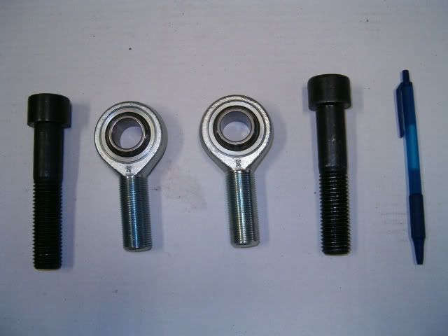

Finaly received the rod ends I was looking for the upper a-arm. These have a 20mm hole and M20x1.5 threads.

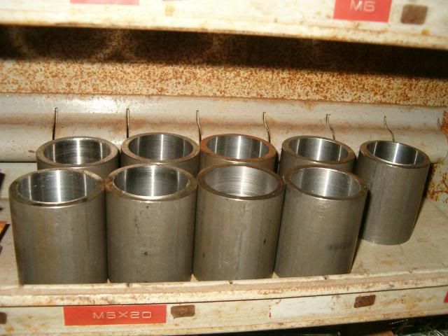

The sleeves I had for the bushings that go on the insite needed to go to the machine shop. The inner diameter is 1mm to small so I couldn'd get the bushings in correct.
Hope to have them back this week. It holds up eveything on the front.

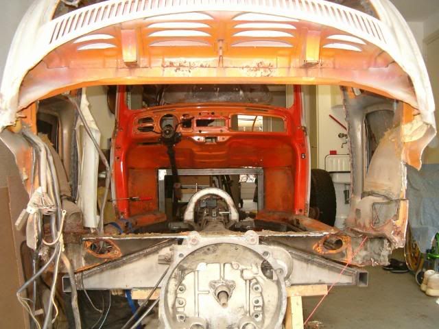

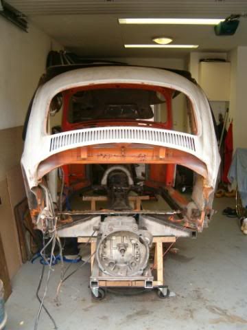

Did some weight reduction at the back...............

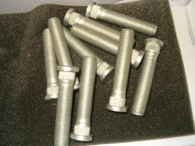

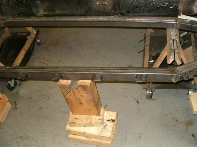

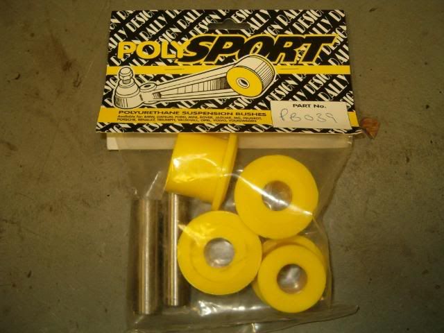

I had to wait for the sleeves for the bushings of the front suspension so I started with the mountings of the body to the frame. First I wanted to drill holes through the frame but I changed the "design". I removed the profile and placed it a little more inside so I can mount brackets on it on the outside and later on the roll cage can be mounted on the profile.
But today finally got the sleeves in.
They fit perfect with the bushings I choose. Also found the longer bolts I need for the front wheel mounting. So I can continue with the front suspension .
But first I finish the chassis. One thing at the time. Or the front suspension, thats the most fun!!
