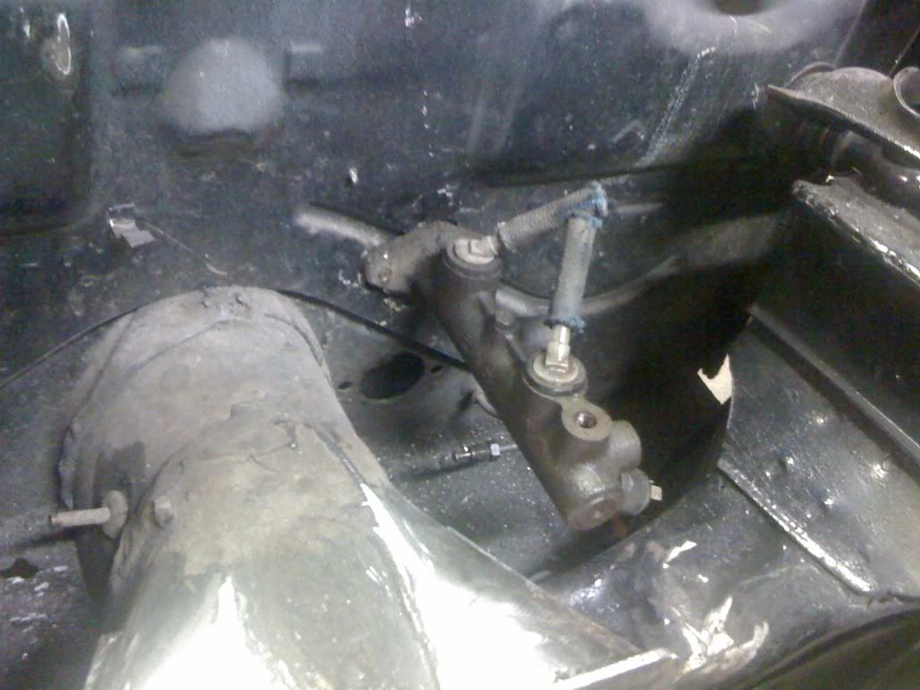

I moved the stock master up about 4 inches to clear the cross member of the MII suspension. But now the actuator interferes with the gas peddle.... a little more fab work and it will be fine.

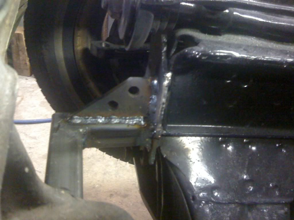

Dad and I started gutting the spare tire location behind the front apron. Gonna reshape it to make room for the air tank. With the stock front beam gone it opens up the area in front.
Built a new support for the front of the body.. Used to bolt to the top of the stock beam.
Not to sure about my master cylinder placement. May go to the junk yard and scout out some master cylinders replacements.... I need somethin with a dual circuit and that measures just over 4 inches.... The stocker is about 7 inches and the new MII crossmember is now in the way.
