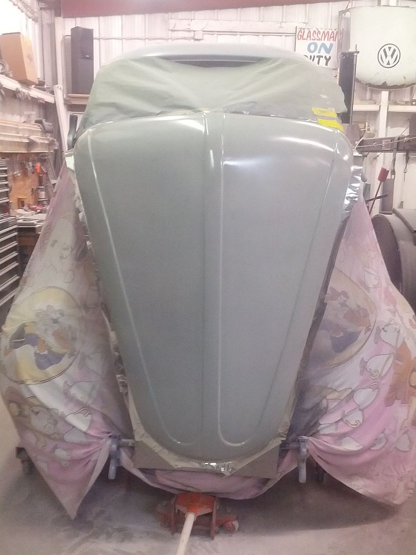

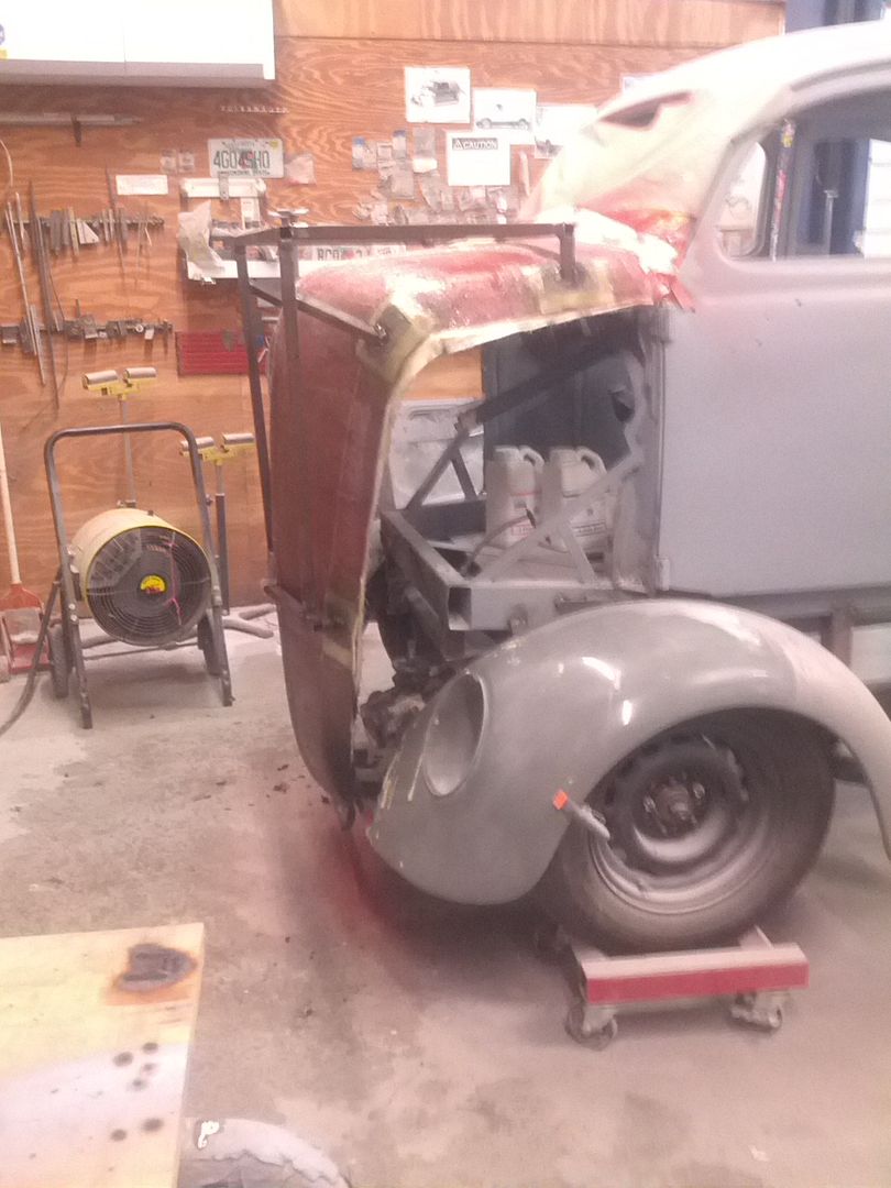

Got a little block sanding done today after work...........

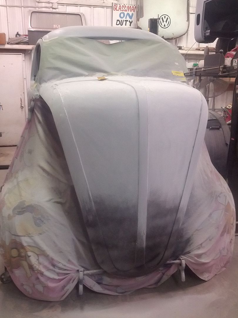

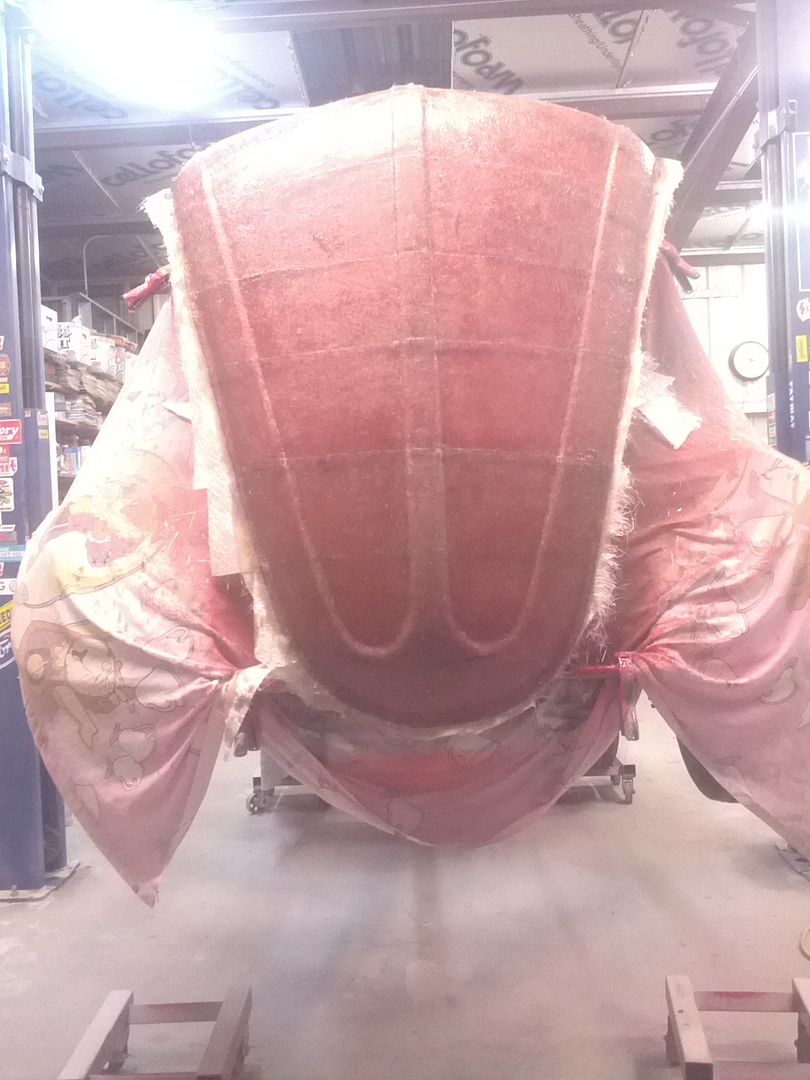

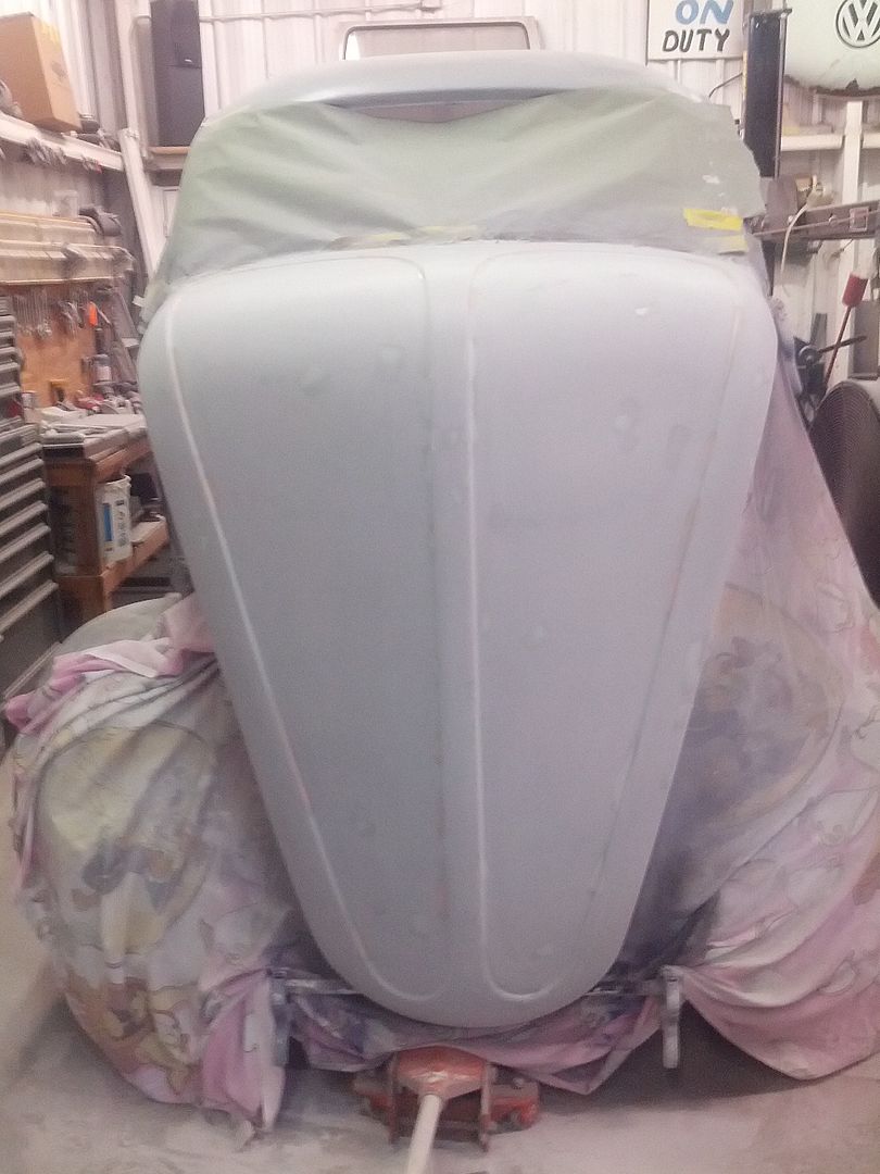

Finished the block sanding this evening, all is in 180 grit and all of the pin holes and minor imperfections are taken care of. just some sanding with finer grits now until it's slick as a babies butt and then the mold making will commence, stay tooned !........

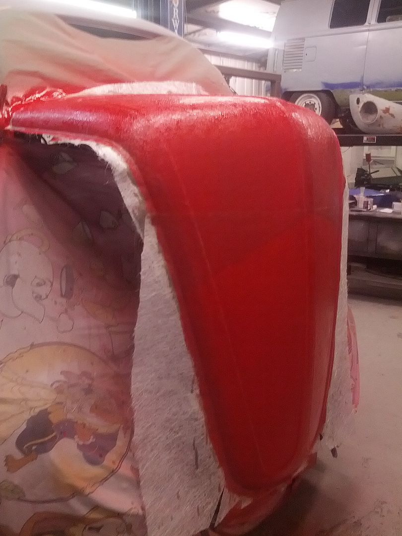

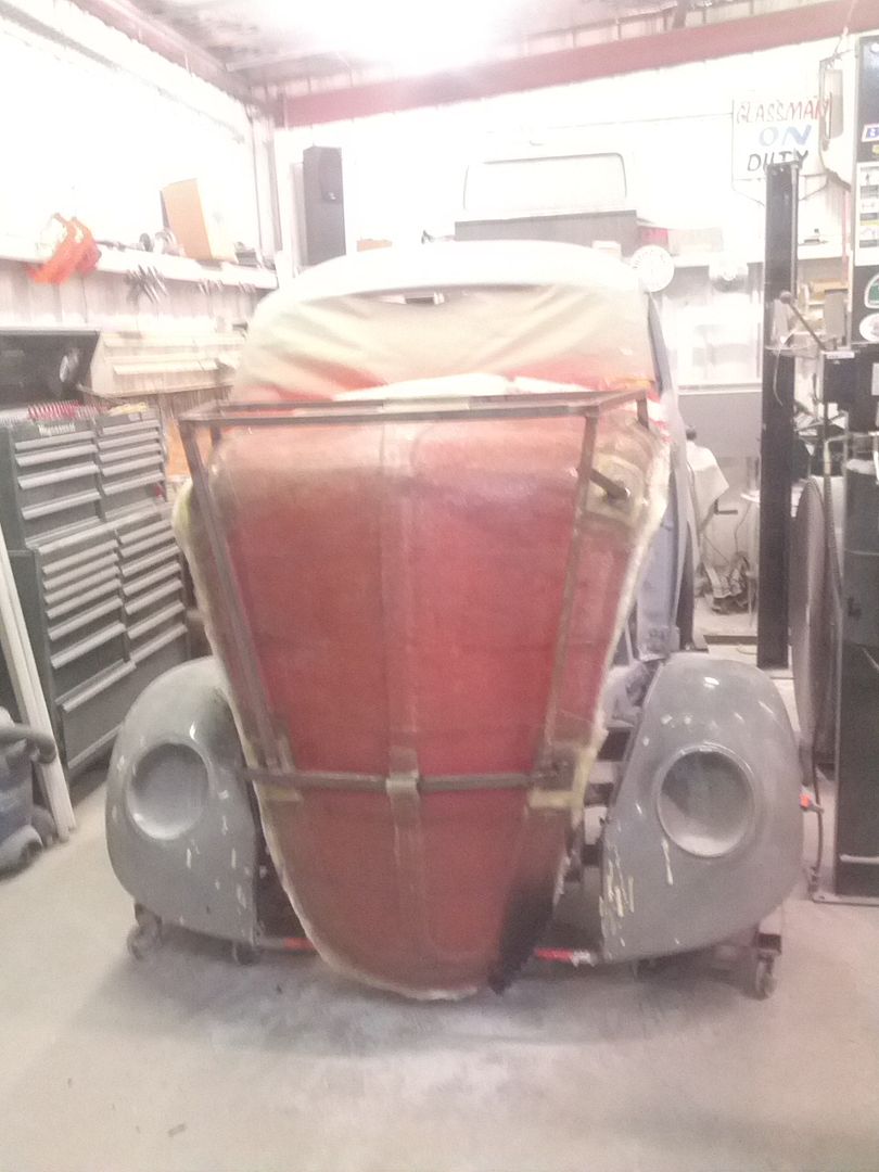

The hood has been waxed and is now coated in PVA ( mold release ) and the tape around the edge will create a "dam" which will allow the return edge to be formed.............

And now the gel-coat is on............

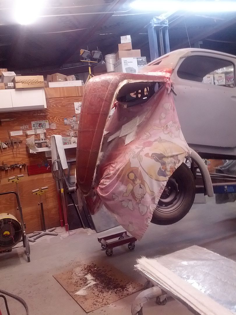

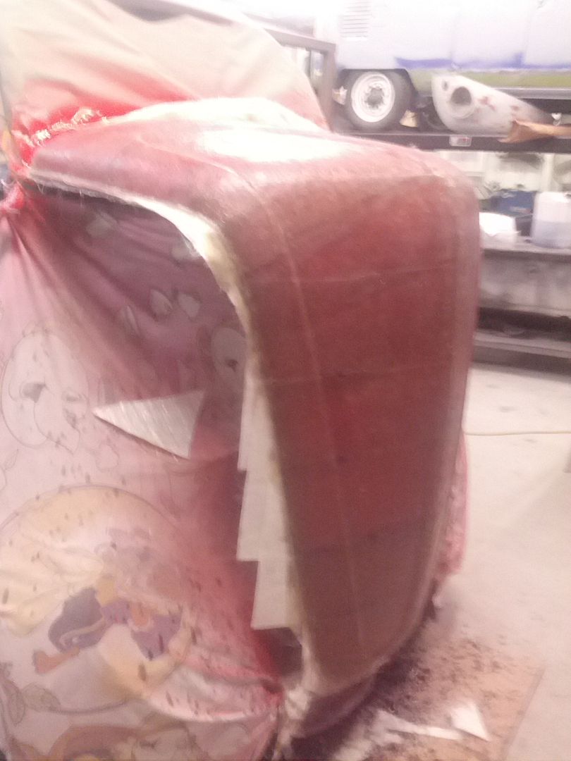

Trimmed the edge dam down to about 3/4" and laid up 1 coat of 2 Oz. mat over a barrier coat of aluminum tape on the back-side to start creating the return part of the mold. one more 2 Oz. lay-up will be enough on this part and the mold will be complete as I have laid 2 coats of 2 Oz. mat on the outside today as well. I'll lay that up in the morning, add a structural element to the outside and push it in the corner until next week-end when I'll peel the mold from the plug ..............................

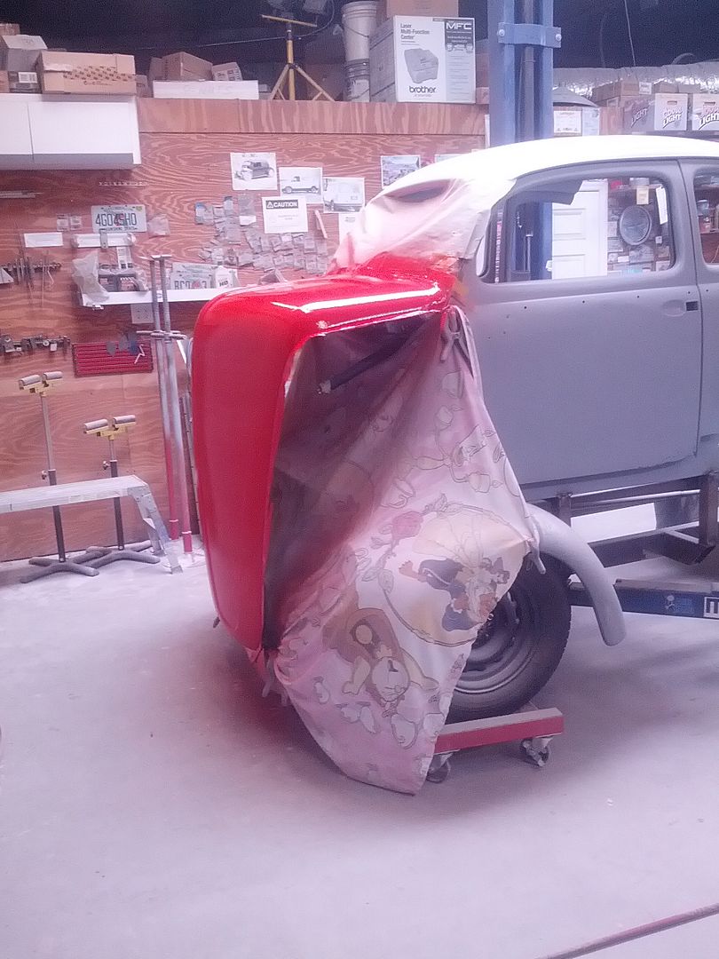

here's what it looks like now, mold is all done and set aside to cure until the week-end.

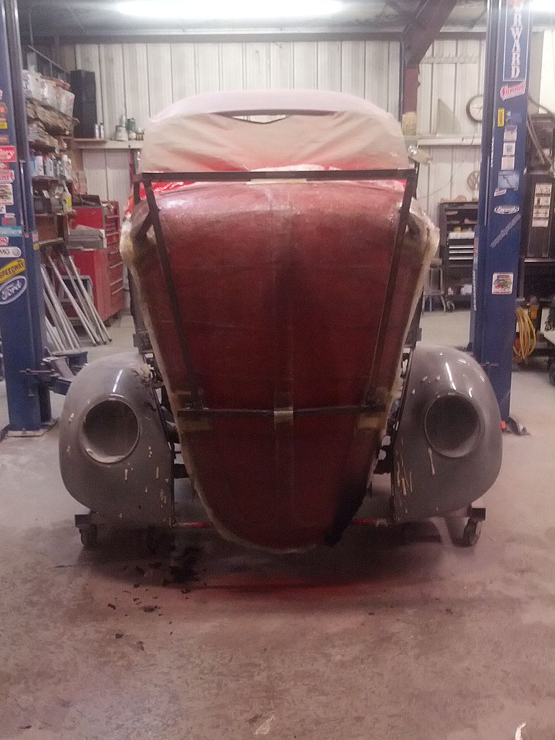

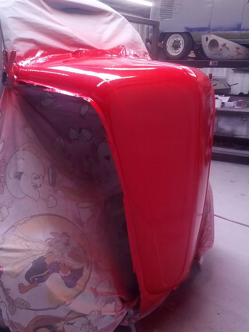

Here is a picture of the final mold.................................
GOOD LUCK, GO !!!
