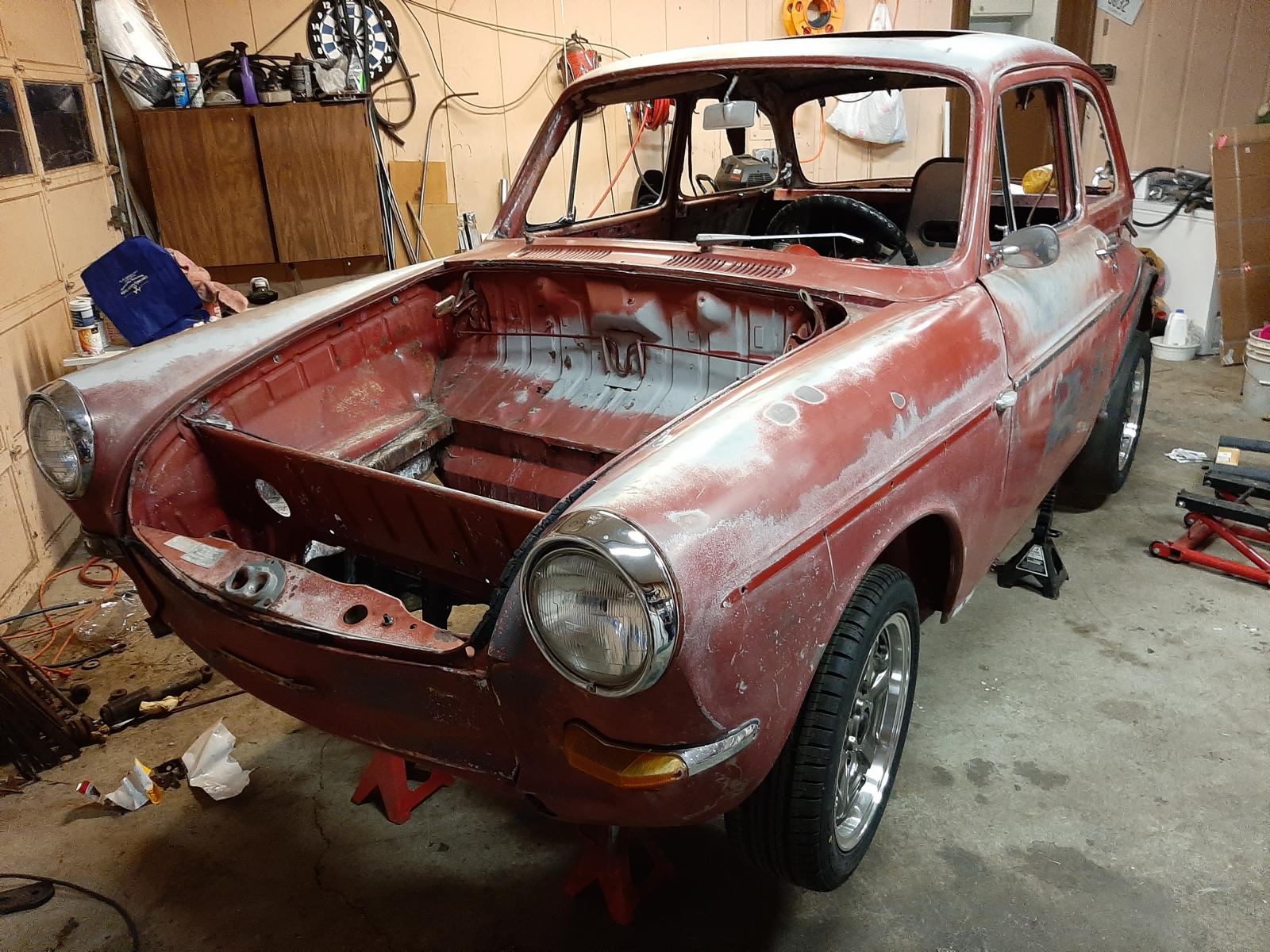

Rolling the car in and out of the garage has been an adventure as the steering box and the shaft were not connected.
Now I can steer the car! The t1 box and the t3 shaft align perfectly! Woot!!! Small victories.
Things have slowed as we have added house remodeling to the mix. But, for today, some progress.

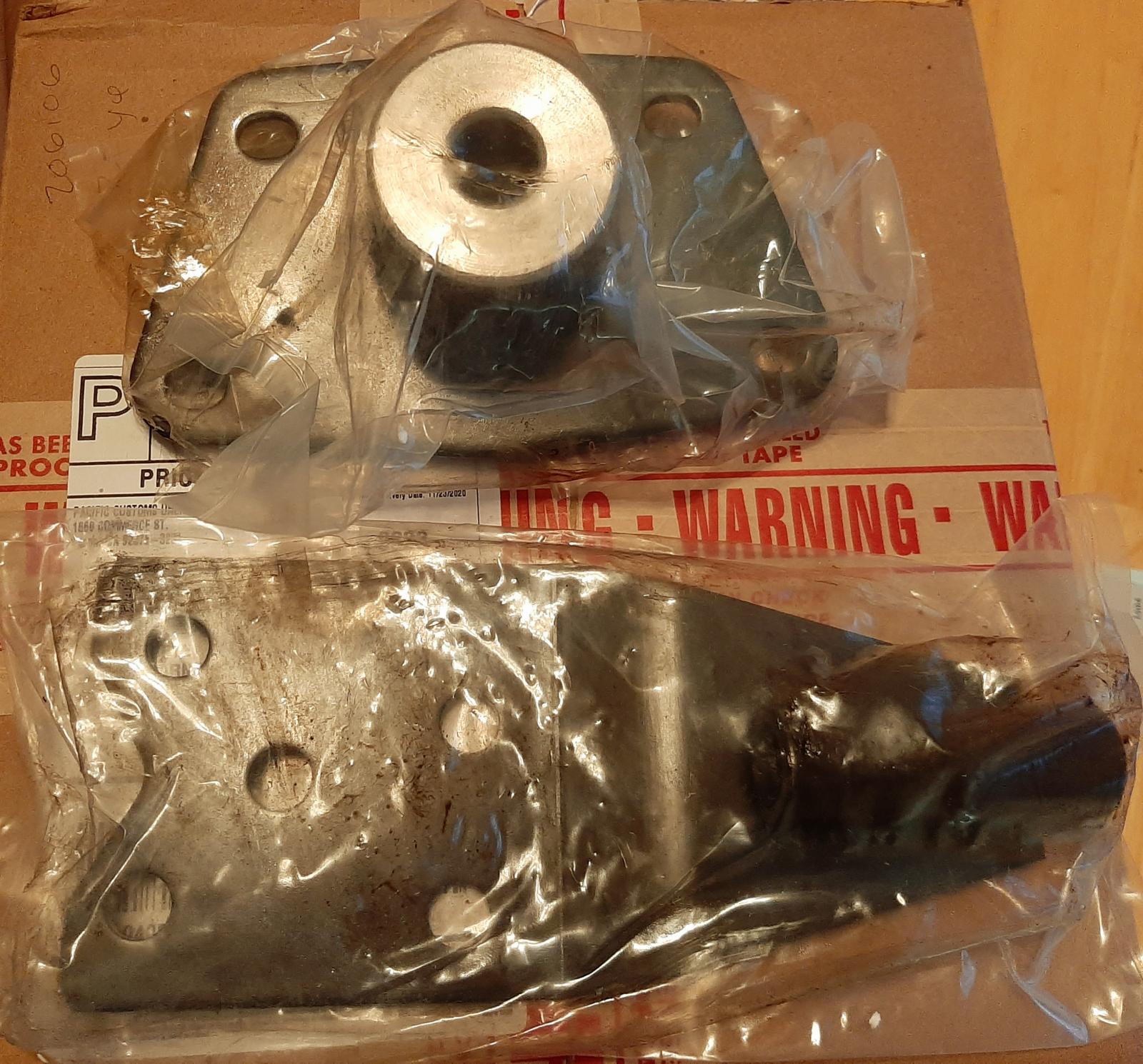

My heads finally arrived from the head porter with a loud bang on my front porch. I was out behind the house when I heard it. By the time I got to the box, the driver was gone and the damage was done 🤒 So, I contacted the head porter with pucs of the damged chambers on one of the heads and he told me I could work them back.
Now, I have opened up manifolds to match intake ports, but to touch the chambers, on something as expensive as these were, well...
I was able, with nervous trepidation, to clean up the combustion chambers on the new to me heads.
I also installed valves in one chamber to see what the volume was. 52cc. Going to an .060 deck will put me right at 10.3 CR...Perfect! That was where I was hoping to get to. Whew!

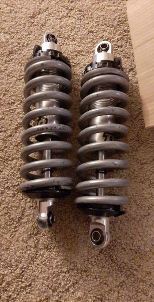

They are obviously adjustable, what brand are they?
Old November 11th, 2020, 04:28 PM   #85
Posts: 6,482
Default Re: The Roach
QA1

QA1s will be controlling these...

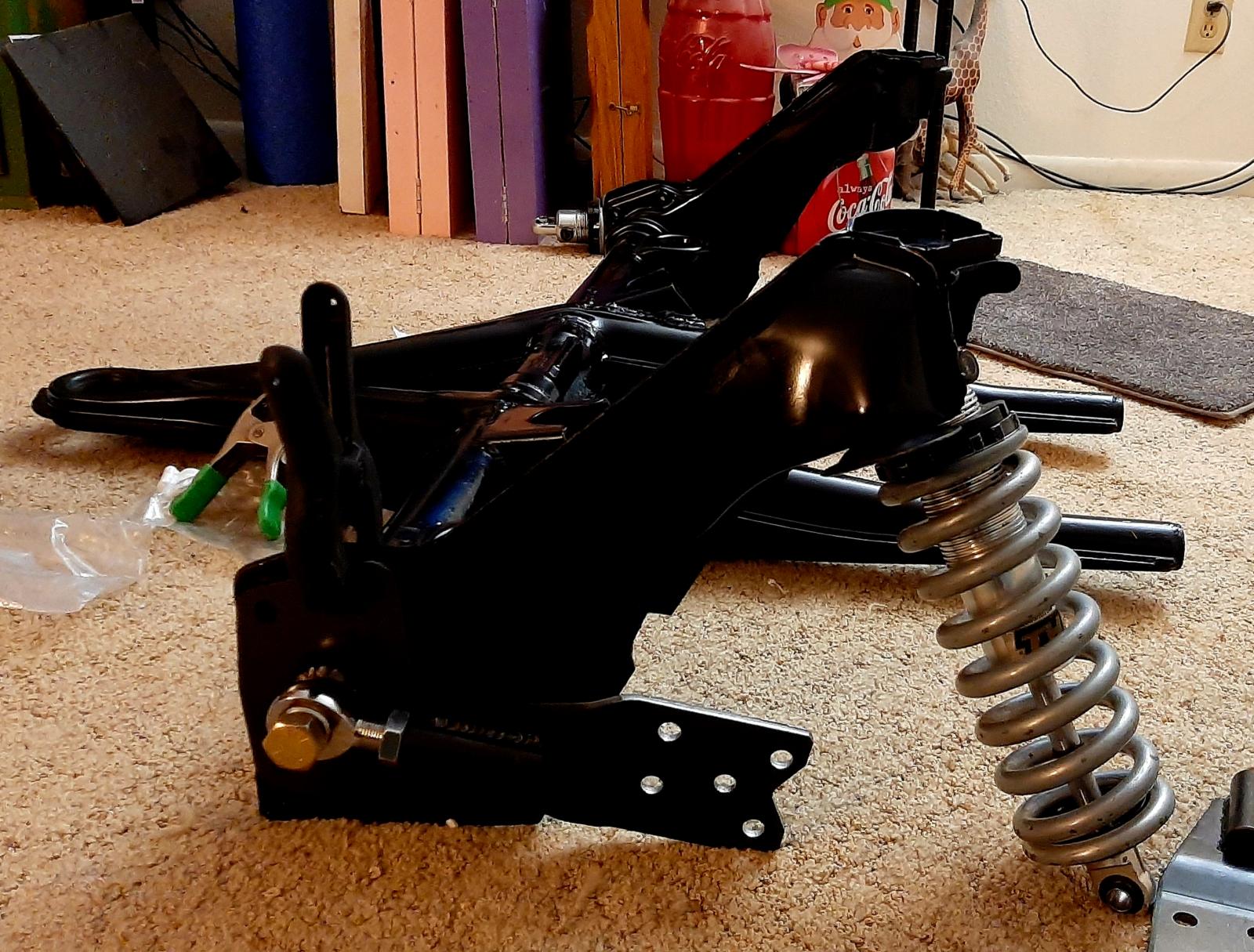

Mock up

Are you going to brace the upper shock mounts and tie them into the rollcage? I did on my last pan car and it stopped the flexing on the framehorns. Less chance of trans breakage and more consistent on suspension tuning.
Tim
Old November 24th, 2020, 08:37 AM   #92
Posts: 6,482
Yes, once I sort all the placements out.

This is a stock swing axle rear subframe for a type 3, they bolt in. Added are the IRS pivots to convert to IRS. Why? Type 3 rear ends require hanging the engine/transmission from the body. Now, I do not need to do that. Also, I am not going to run torsion bars, so this is a sub that will use 550lbs spring coilover shocks to hold the weight.
