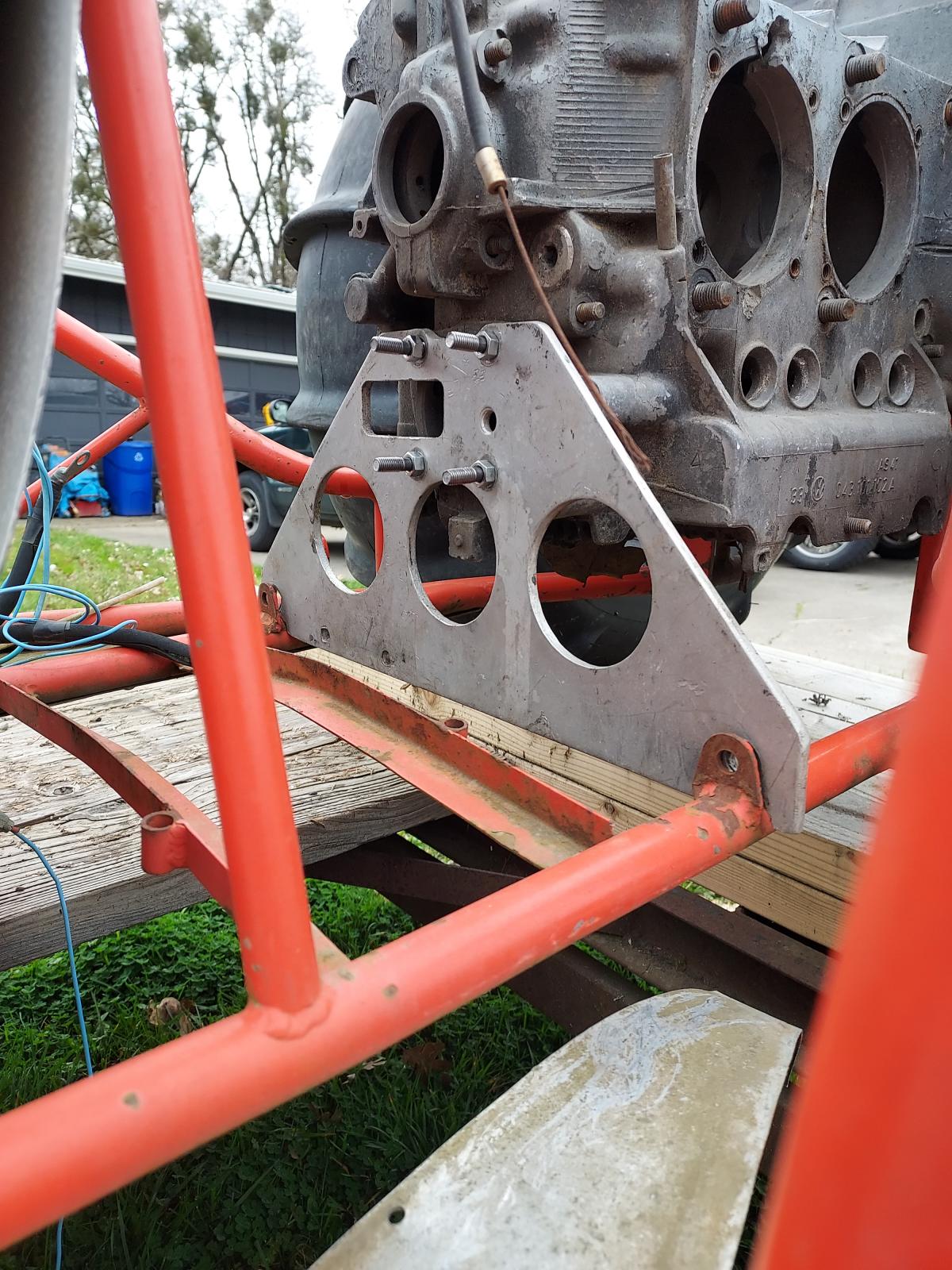

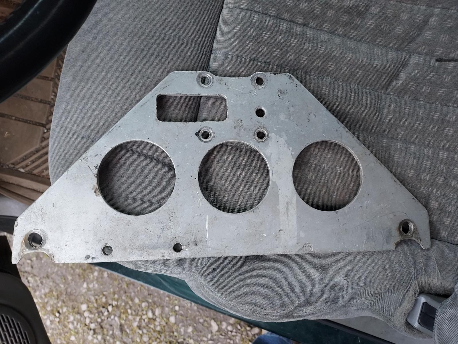

I finally have the engine plate! That's better.

I know I should have test fitted me much sooner, but hey...

Looks like a snug fit. It’s getting better by the day.👍

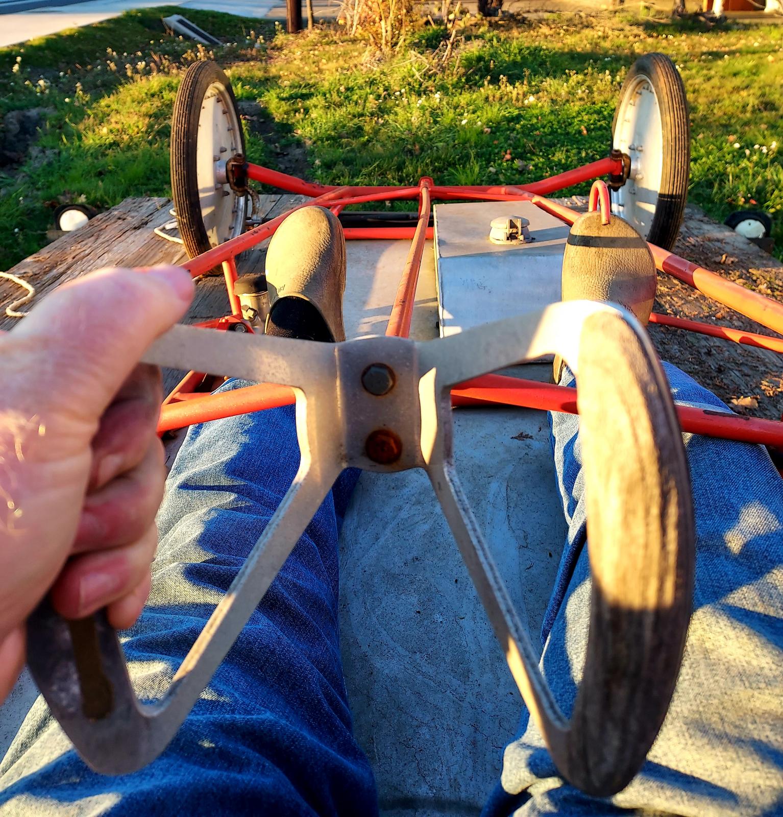

I have to relocate the upper steering braces.
Old February 15th, 2022, 06:53 PM   #31
Default Re: Rutrower?
Looks like to clear your knees?

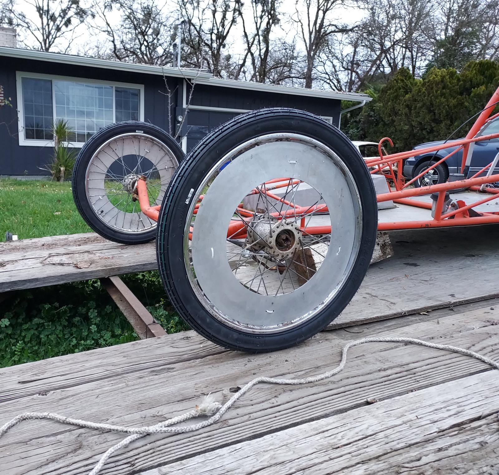

New tires, tubes and spoke covers showed up. I can put the OG spoke wheels back on the car!
Old February 27th, 2022, 09:40 PM   #33
Posts: 6,482

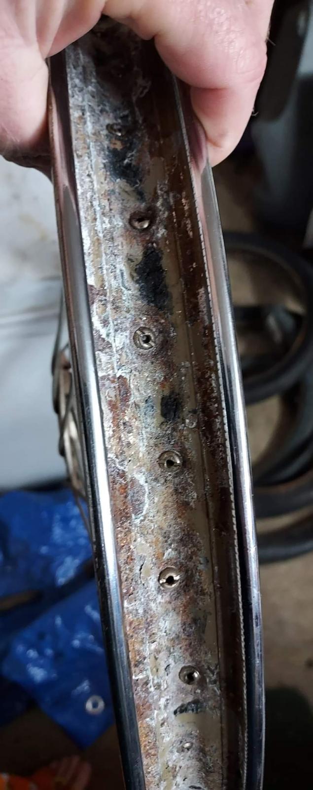

These old wheels were covered is rust spots on the spoke sides and covered in flaking rust on the tire side. Rustoleum Rust Desolver and 30 minutes wait did pretty good! But... why bother? A new pair in steel chrome is $900.00!!! A new pair of aluminum is $1000.00!

The wheels are OG as are the timing rings.

Looks good. Um, what are ‘timing rings?
Old March 1st, 2022, 08:13 PM   #36
Posts: 6,482
Spokes don't always trip the timers on the drag strip. The inserts make sure they work.

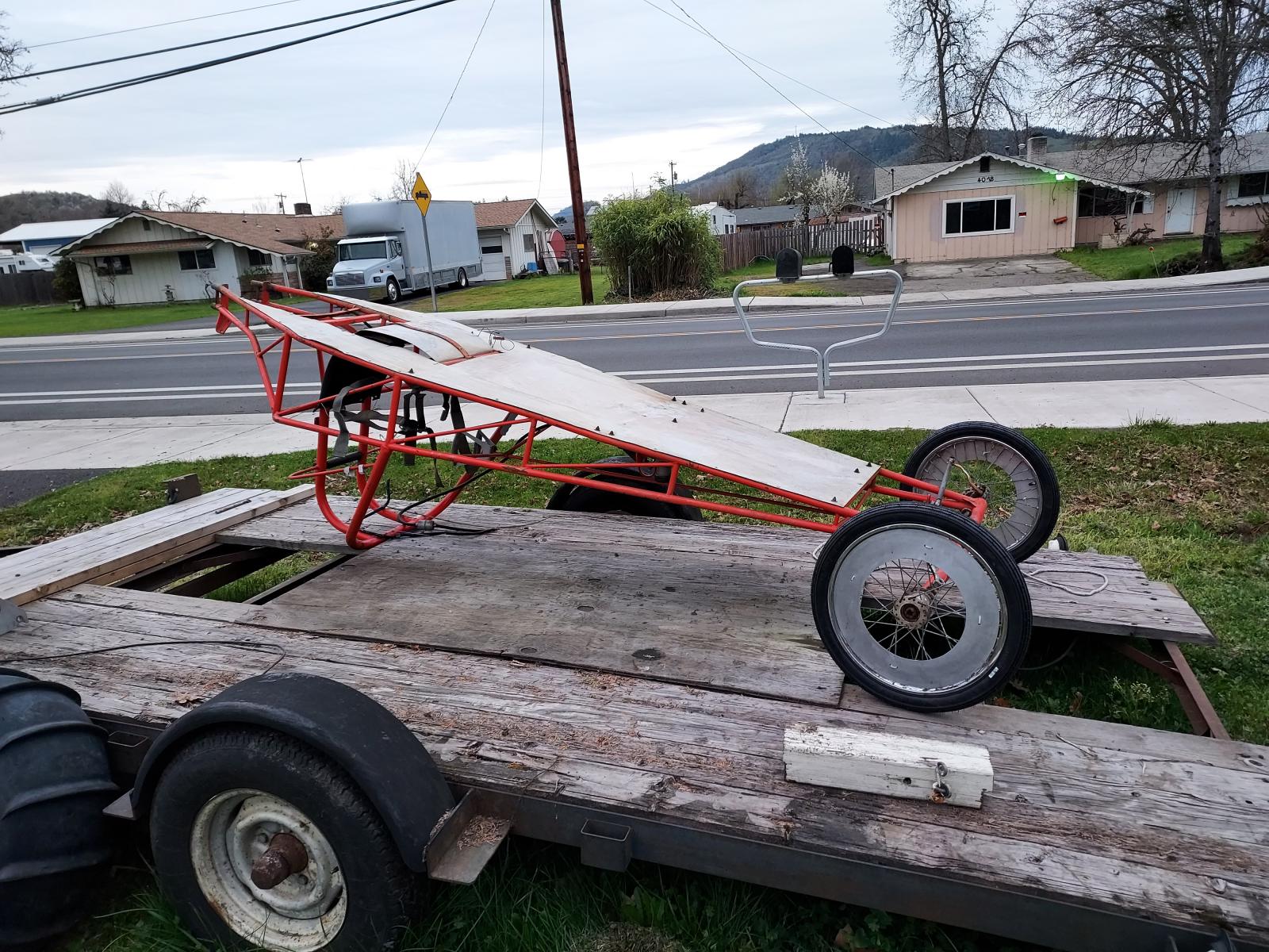

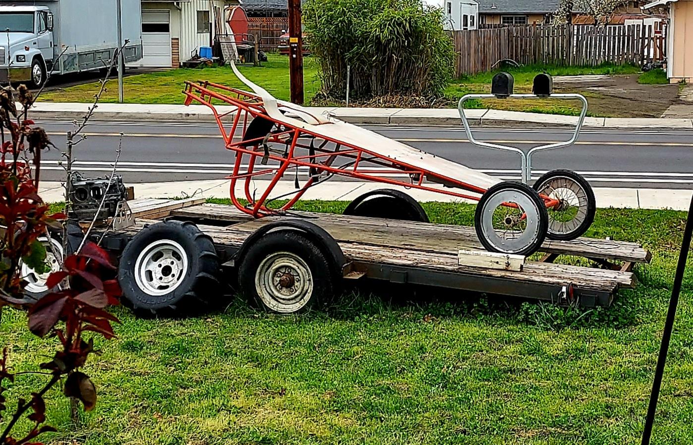

I should have the mandatory wheelie bar built next week.

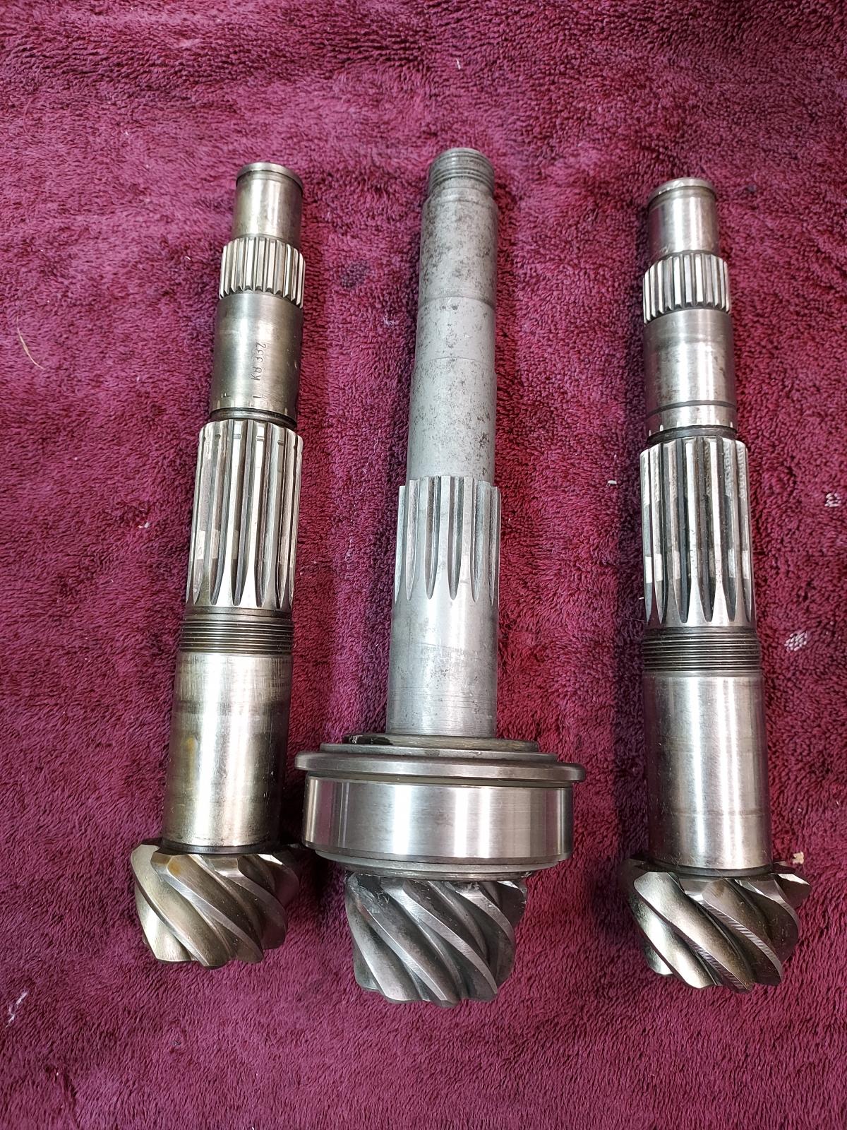

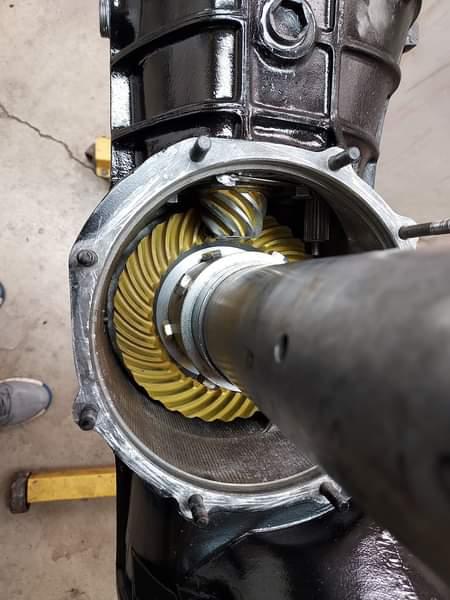

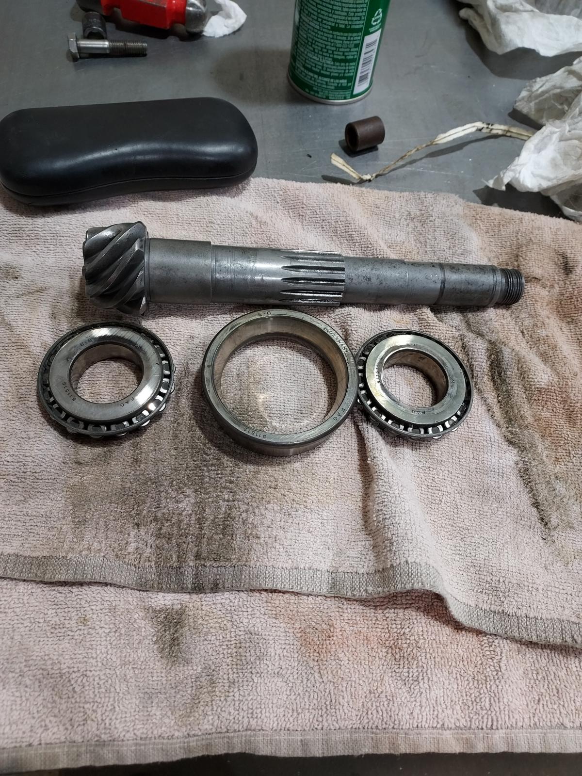

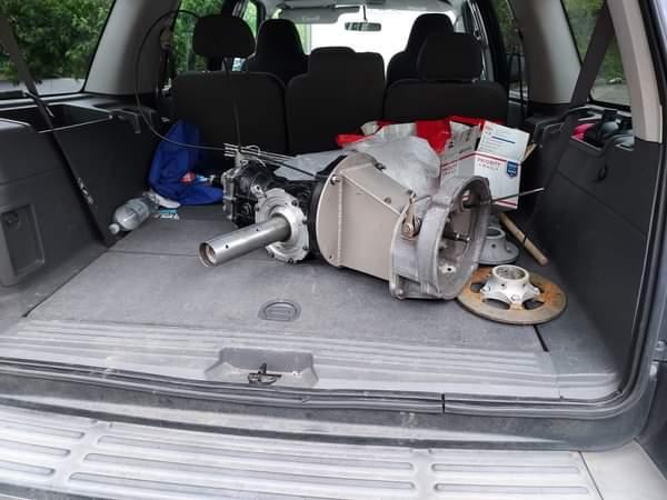

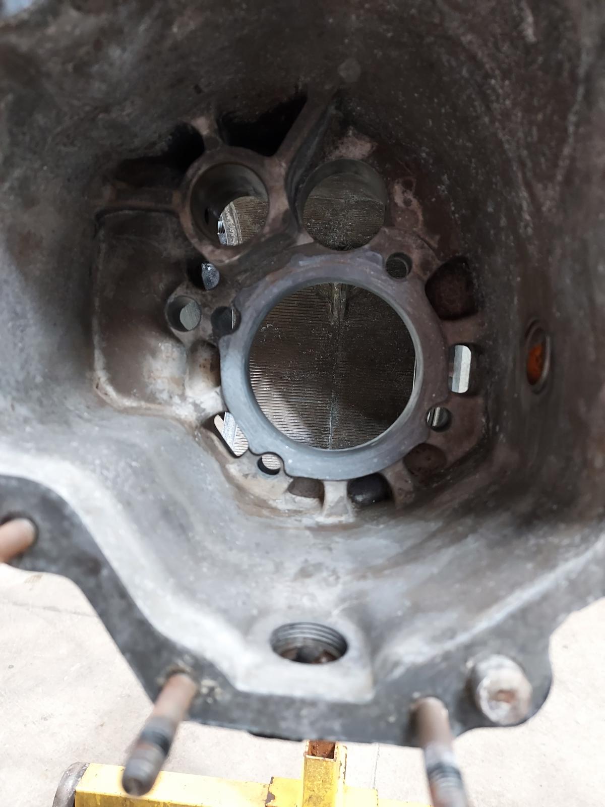

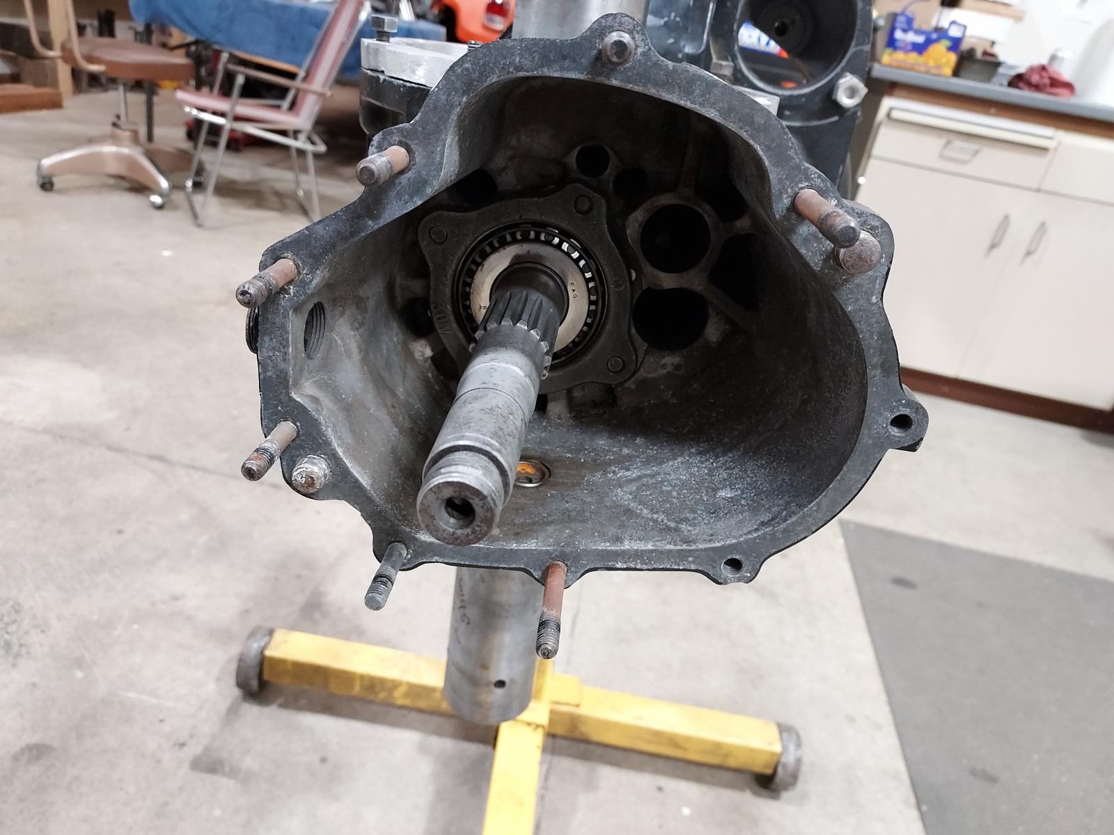

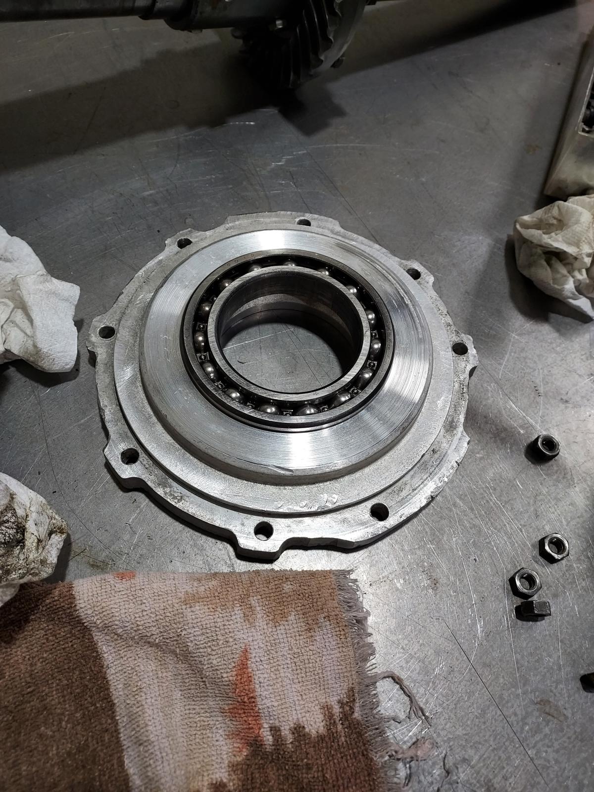

4 hours of trans set up today. Stopped after setting preload and getting initial r/p lash to work from. Much learning today as well as some progress.
Photos loaded in reverse order.

Finally assembled and working! Lots of customizing the custom parts!

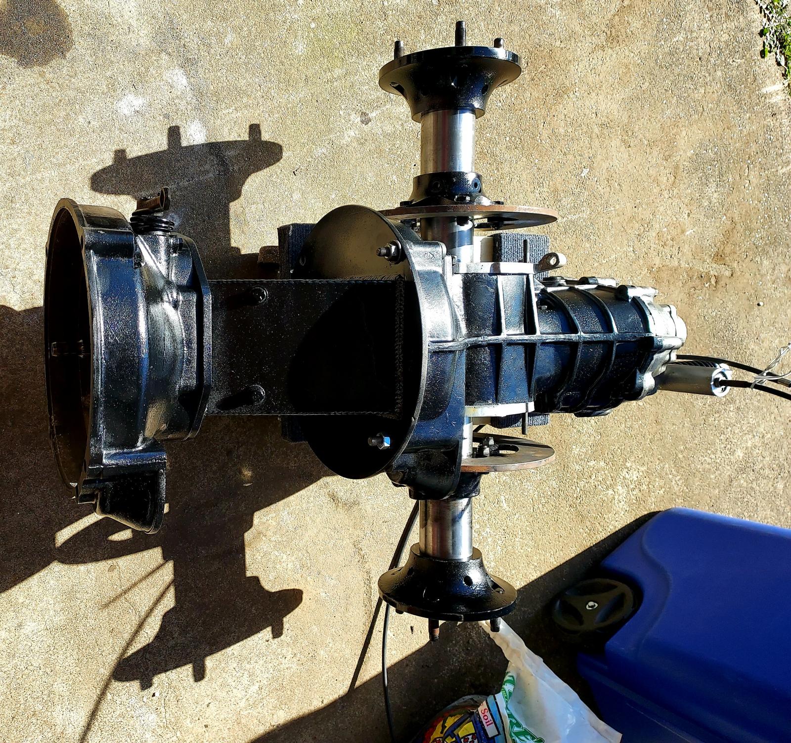

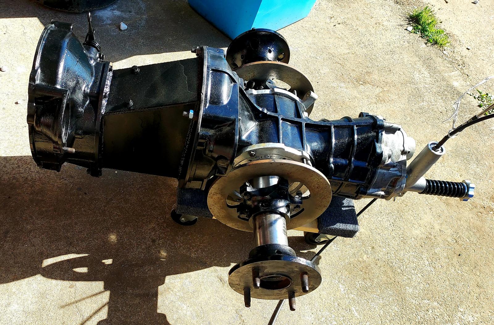

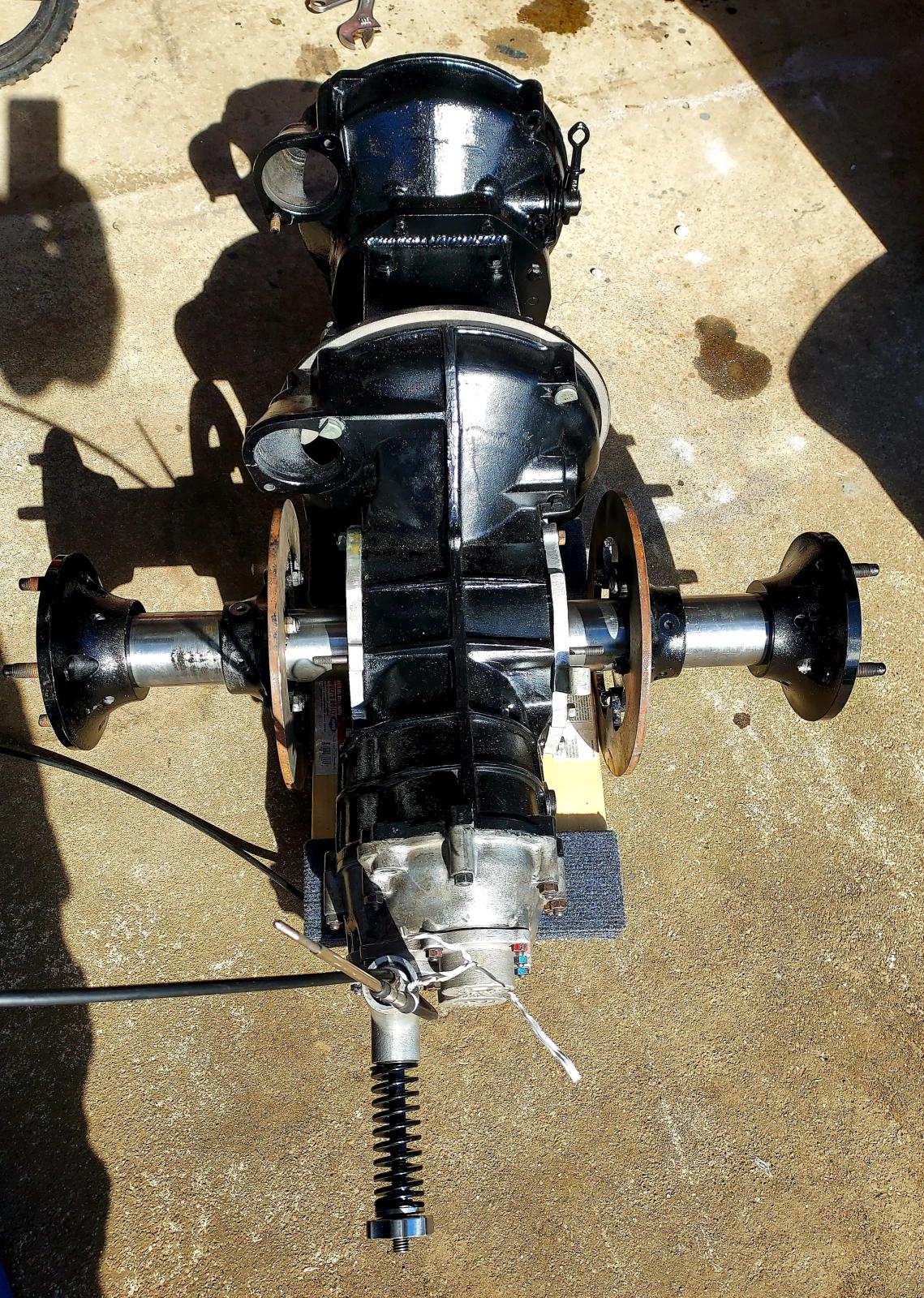

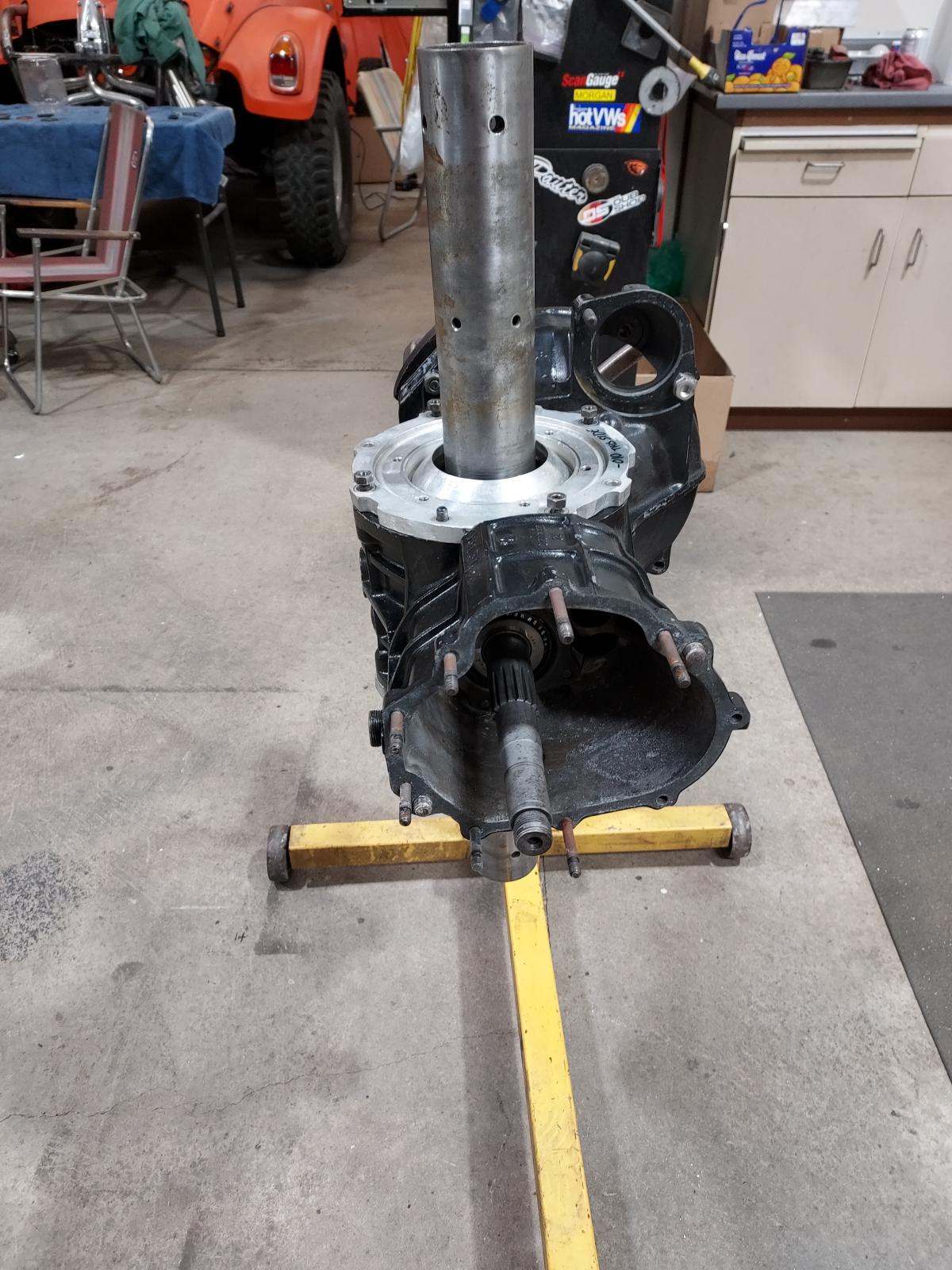

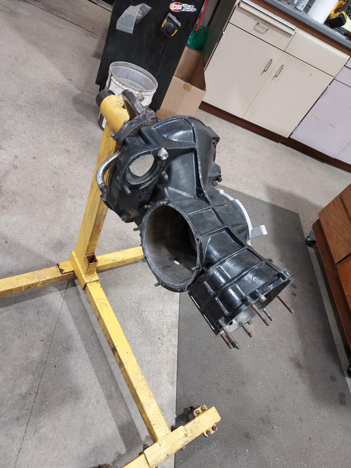

Originally I was going to try and run without the trans extension, but my axle is too narrow to allow the engine to fit between the tires, so... extension. This kicks the wheelbase from 124 to 139 inches.
Old May 15th, 2022, 02:02 PM   #45
Posts: 6,482

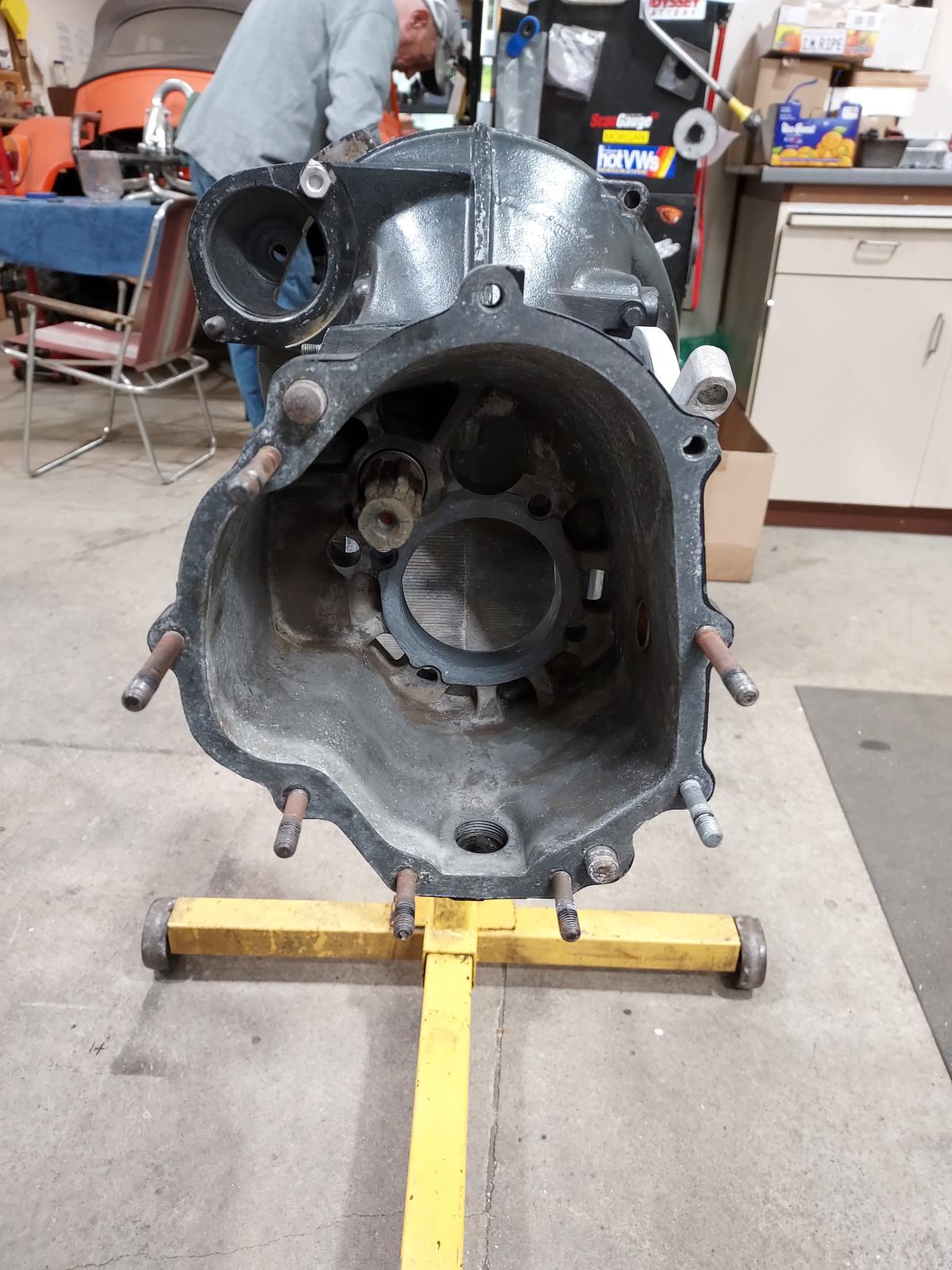

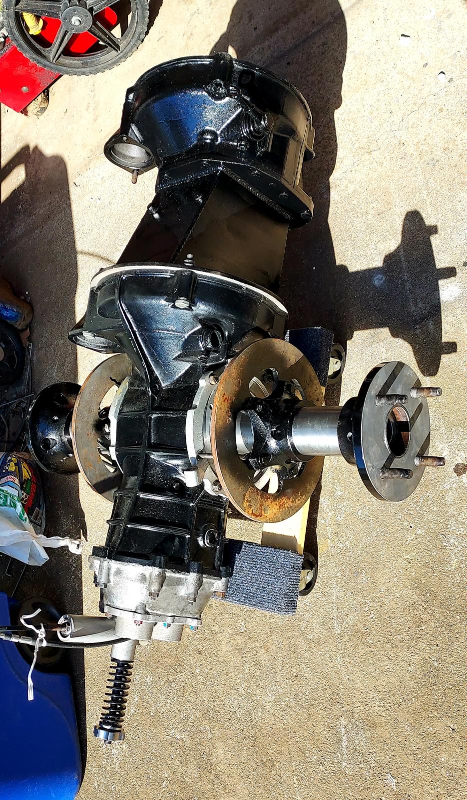

Piddly, but necessary things today. The Magnesium casing for the transmission extension and the hubs and disc brake hubs all needed paint. So what color do you use with orange? Black. Now I just have to wait for paint to dry.

First time I’ve ever seen a tranny extension. But it makes sense and looks great. Definitely adds to the rides ‘impression ratio!

I am on my 3rd set of transmission mount designs. Oigh...

I have an empty trans case for an extension for my front engine VW Trike (it's on my to do list)
