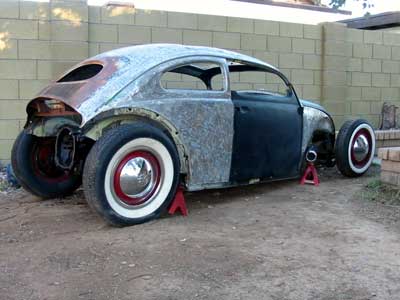

oldskool
oldskool's Avatar
Join Date: Jan 2003
Location: Phoenix, AZ
Posts: 321
Originally posted by Griznant@Dec 14 2004, 07:57 AM
oldskool,
Did you try fitting your engine yet?
Have fun! (I know I am).
Ugh.
LOL!
I've been nervous about it since I began, but look:
I know it's sitting in the wrong spot. There's a hole cut in my oval section that the PO did, I just need to enlarge is slightly to make this fit. It'll tuck in real nice. I'm half looking around to see if anybody's got one of those 80's aluminimum center mount shrouds that looks like a triangle. I wouldn't have to cut to get that shroud in.
I think your car is either lower or further back on the pan than mine...
motor,metal,tires,fire
-chris
oldskool is offline

Griznant
Griznant's Avatar
Location: Southwest Michigan
Posts: 898
Well, on top of the channel, I did do a 2" section to it too, so it's lower. I also didn't extend my roof, it's still the stocker, so my wheelbase is shorter to fit the roof. It's sort of like apples and oranges, but I was curious how yours fit. I know that my entire inner vent section is gone now, and the fan is up behind it. Oh well, function follows form when it comes to hot rods. [img]style_emoticons/<#EMO_DIR#>/biggrin.gif[/img]
Griznant is offline

oldskool, how is your motor going to fit then? stuck out behind the car like in the pic? but later on in your post you say you want to run a deck lid [img]style_emoticons/<#EMO_DIR#>/wacko.gif[/img] im confused! *edit* i see now the shroud is sitting rear ward in that pic isnt it... doh [img]style_emoticons/<#EMO_DIR#>/wacko.gif[/img]
Griznat in you previous post you say you cut the frame horn back by 2 inches to help tuck the motor into the car, is it still threaded that far back or does it need tapping out?
how much can you channel a car befor you run into decklid clearance problems?
is there more room to tuck the motor up under the vent section useing an oval/split section than with the normal 70's style window/vent?
respect to all those out there actually doing this as opposed to me sitting inside thinking about doing this!
Thanks,
TFTom
<span style=\'color:orange\'></div><table border=\'0\' align=\'center\' width=\'95%\' cellpadding=\'3\' cellspacing=\'1\'><tr><td>QUOTE </td></tr><tr><td id=\'QUOTE\'>I'll kill you you sick english FREAK!</td></tr></table><div class=\'signature\'> alltypesvw</span>
Top_Fuel_Thomas is offline
Old December 14th, 2004, 11:11 AM   #62
oldskool
oldskool's Avatar
Join Date: Jan 2003
Posts: 321
Sorry to confuse, I was posting this so others could give it their twist and learn as well...
In the pic w/ the fan shroud-- the shroud is actually installed further back. I was just using that pic for reference-- it's just resting on that case. There is space between the outer vents and the inner firewall to trim slightly so the shroud will fit. You'll be able to peek into the vents and see the motor.
Grizzant's car is done differently than mine, and his motor is in a totally different spot.
I will be running a decklid-- at least part of one. I have aspirations of making a bobbed 'sprint car' tail for it, but that may not happen. I will probably take an early 60's lid, cut it so most of it is shortened with the body (2-3" long), but leave a 'tail' around the style line that goes thru the license light. I'll curve that down and under the motor for a faux-rear end.
You can channel the car as much as you'd like. You can run Type 3 tins and gain lots of clearance back. And yes, there is more room under the oval window as compared to my 63 window. Possibly 2" or so!
-chris
oldskool is offline
