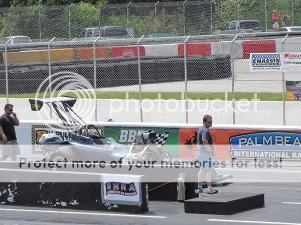

Here is a video of the car running a 4.21 1/8 mile.
Here are some shots of him and the car at work.

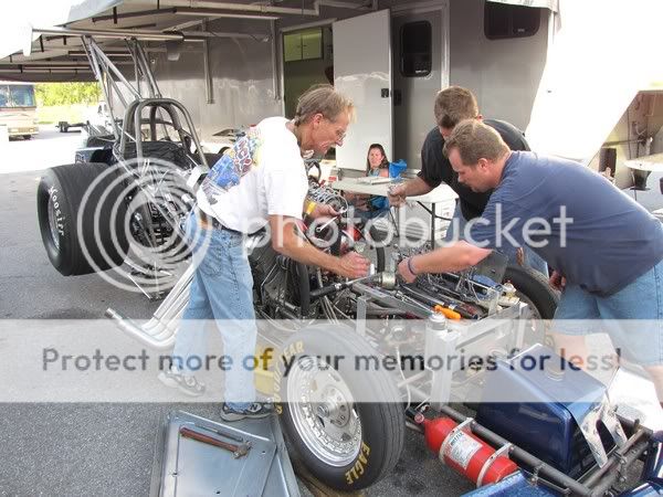

Tearing down the car between rounds.
What a Motly Crew they are...
