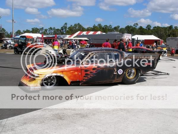

2009 Super Chevy Show
Here are the photos of the show
I am in love with this Studebaker the airbrushed rust paint job was too cool.
