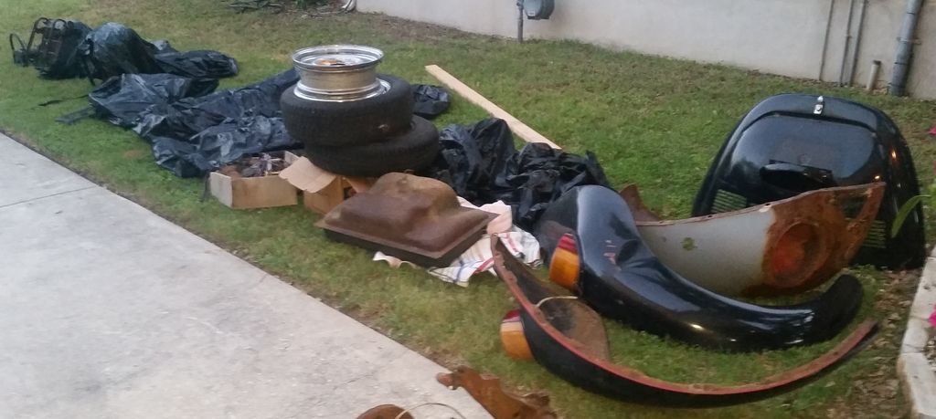

Bought the following off a guy:
  1. project car in pieces that hadn't been touched in 15 years
  2. one engine that is supposedly in good shape
  3. one engine that is not in good shape
  4. multiple extra doors
  5. 2 hoods
Additionally I just really like the oval rear windows and bought the back half of bug with an oval window.

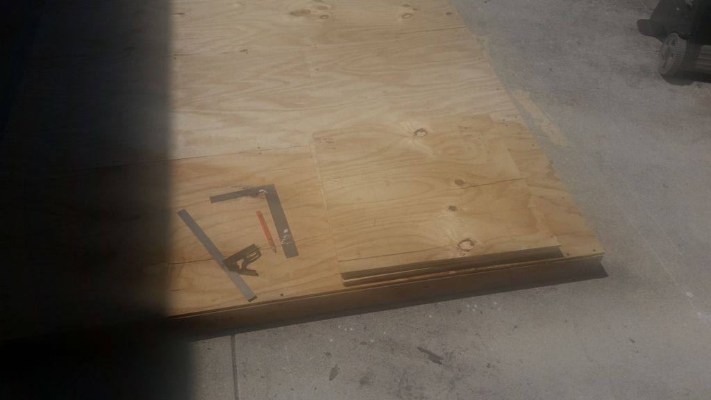

I'm dealing with the same issue most everyone here deals with: space.
I need to pull the body off and also minimize the space taken up. My garage is about 81" high.
I've built a platform, no wheels or legs yet to put the body on. When done it should roll over the floorpan and shock towers, but not the engine.

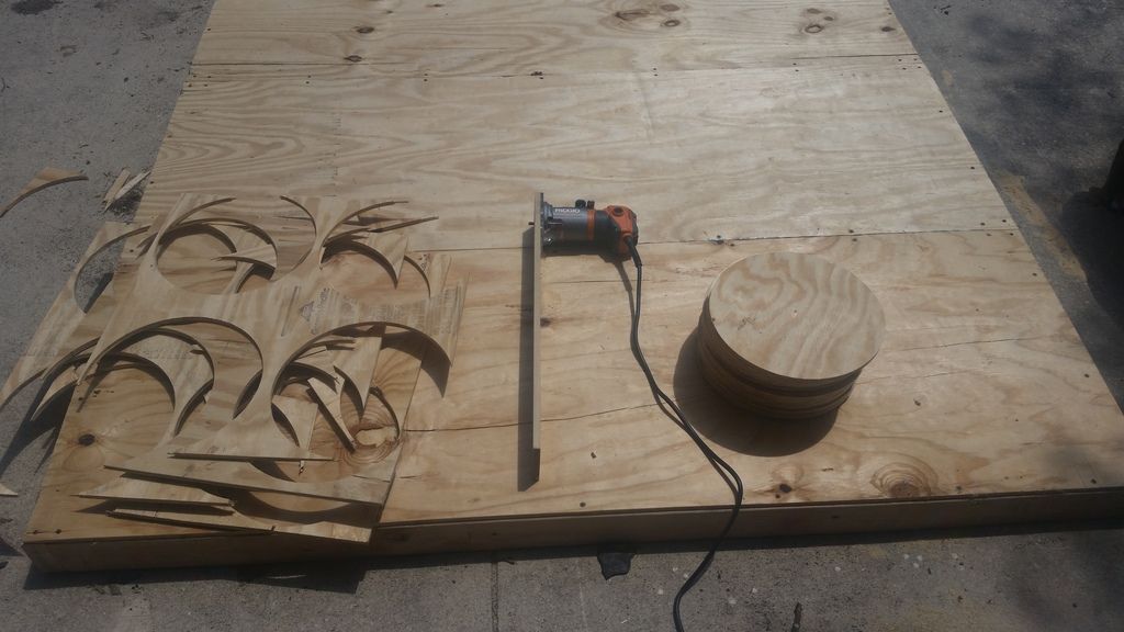

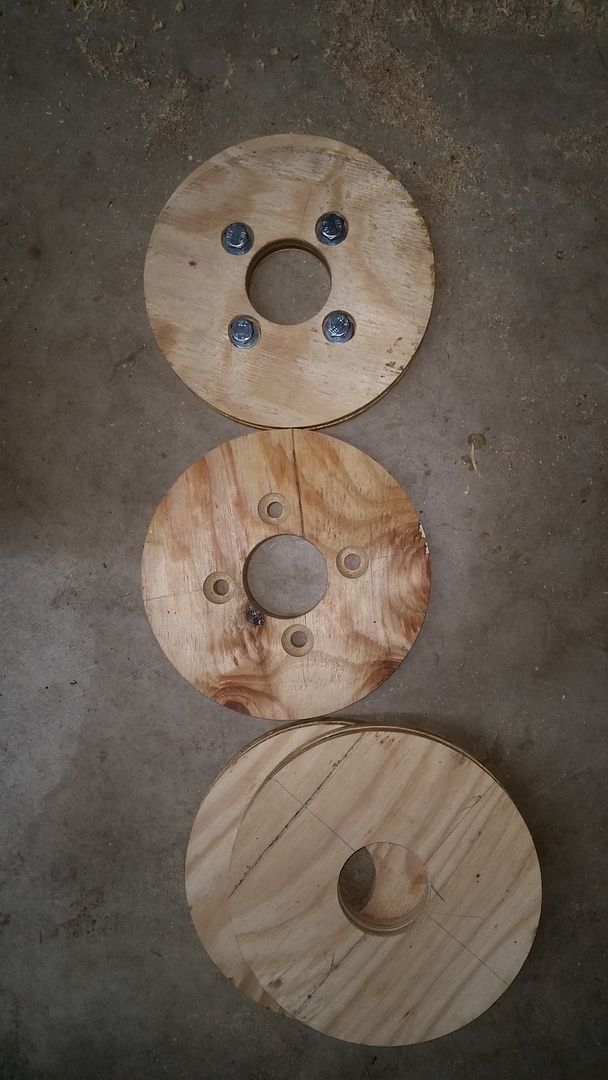

Part of the solution is to lower the floor pan. I've taken the extra plywood and the newly purchased router and cut 16 1/4" thick 11" diameter circles.
The first set of wheels are getting glued up. The plywood was 3/8" thick so I'm gluing 4 wheels to get to 1.5" thick. That is some thick heavy wood.
Should be strong enough to hold the floorpan, but let me know your thoughts.
All this work and I haven't even started on the actual car.
-Eric

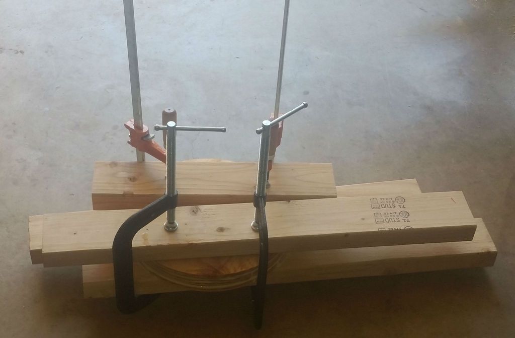

With floor press in hand...
I glued up the rest of the plywood to get 4 fours wheels.
And drilled out the holes in the 4 lug bolt pattern.

For a quick reference the lug bolt pattern is 130 MM center to center.
The bolts are M14 (14 mm) with a fine thread (1.5 mm thread depth).

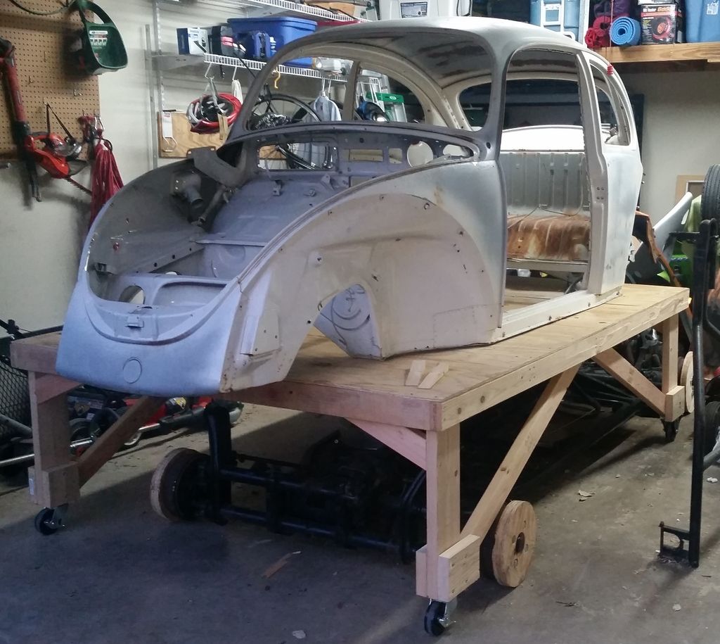

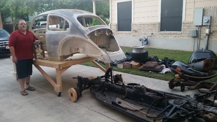

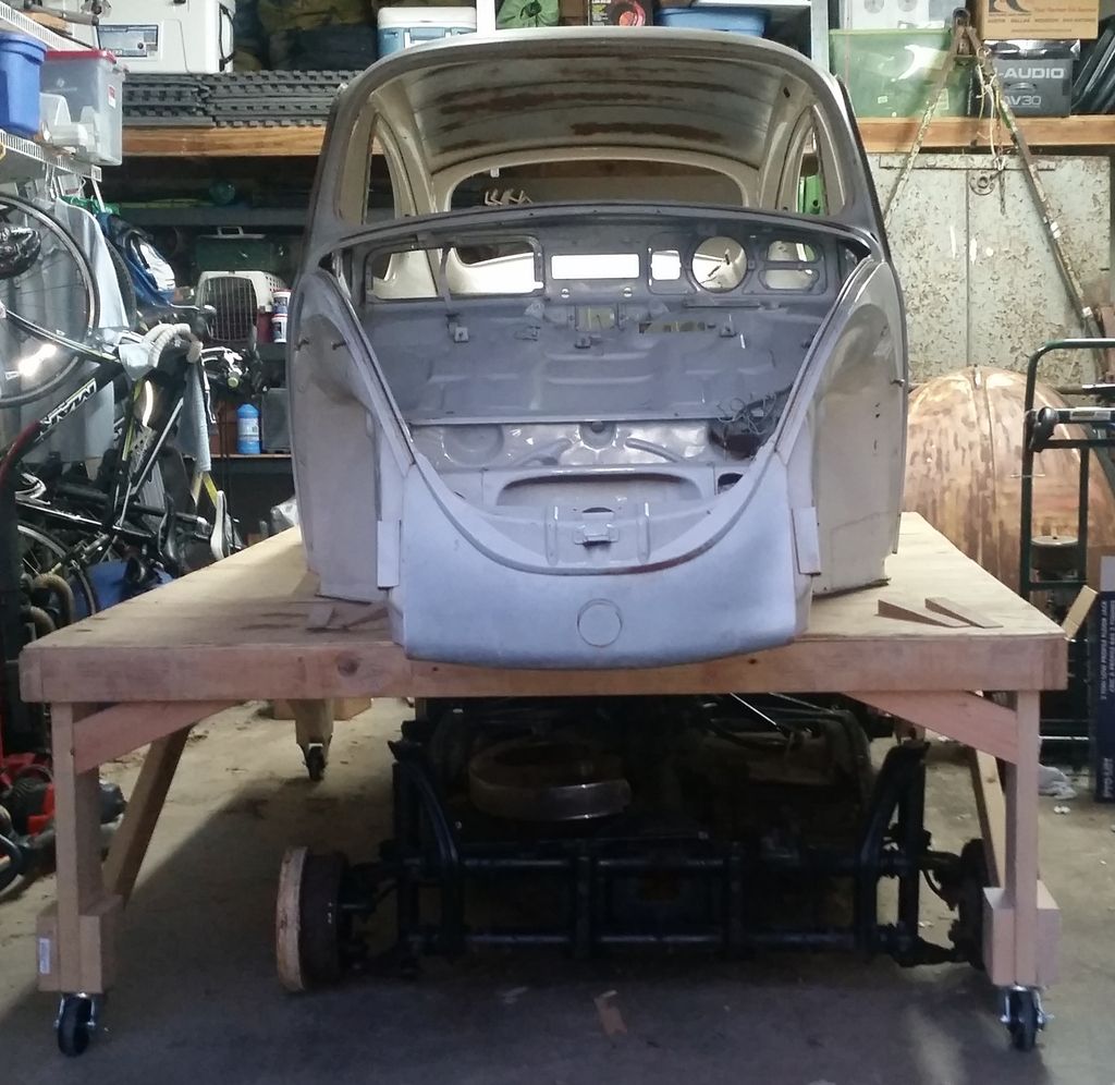

The body is off the car. Woo Hoo!
My wife... Kickin' a little VW @$$.
Actually my neighbor came over and we lifted it up on each side and got it onto the rolling platform.
Below are the rest of the parts I need to go through.
More pictures on the platform.

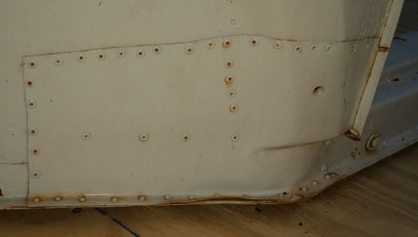

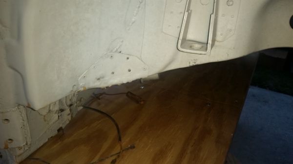

Here a couple of many patch panels I'm going to have to clean up.
