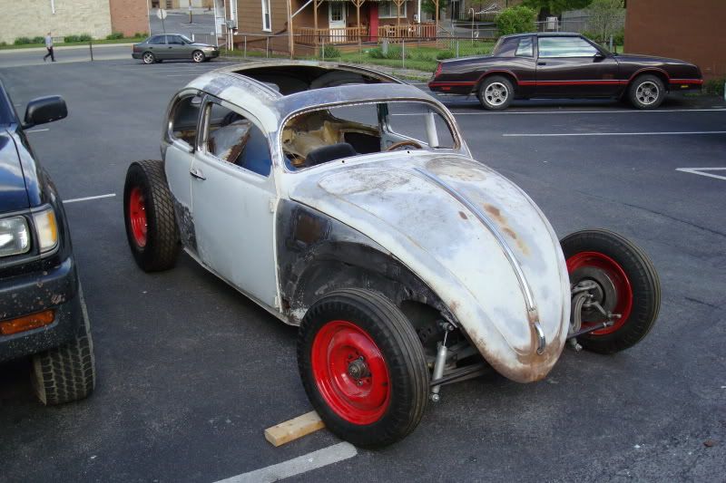

Well, for the last week I've been getting my front end mocked up and here is the result.
You'll have to overlook my dad's mug! He insisted that he get to sit in it just when I was trying to take a couple shots...LOL!

Ok, after too much time sitting I finally got back to work on the volksrod. Since I can't leave well enough alone and the chopped '69 windshield kept bothering me (I didn't like it) I got myself the pieces to convert it to an early windshield.
So this is the beginning of me making a run to complete the body. I've been putting time in every evening so with any luck, I'll be keeping you updated semi daily on the progress. So for starters, here is the windshield area about half way finished.
It is a much more aggressive look than the late model and I'm a thousand times happier that I dove into it.

Ok, so after one more evening of working out this window frame it's mocked up and ready for finishing. I have to say that this has been one of the most interesting and trying mods I've done. Why, some might ask?! Well, the '69 roof was already chopped and finished but I just didn't like the late model windshield. It's definitely not something that is usually done but I can say without any doubt that it made a huge difference for me. Early windshield versus late, there is no question which is the best looking. I just can't wait to finish it up and move on to the rest of the nose.
