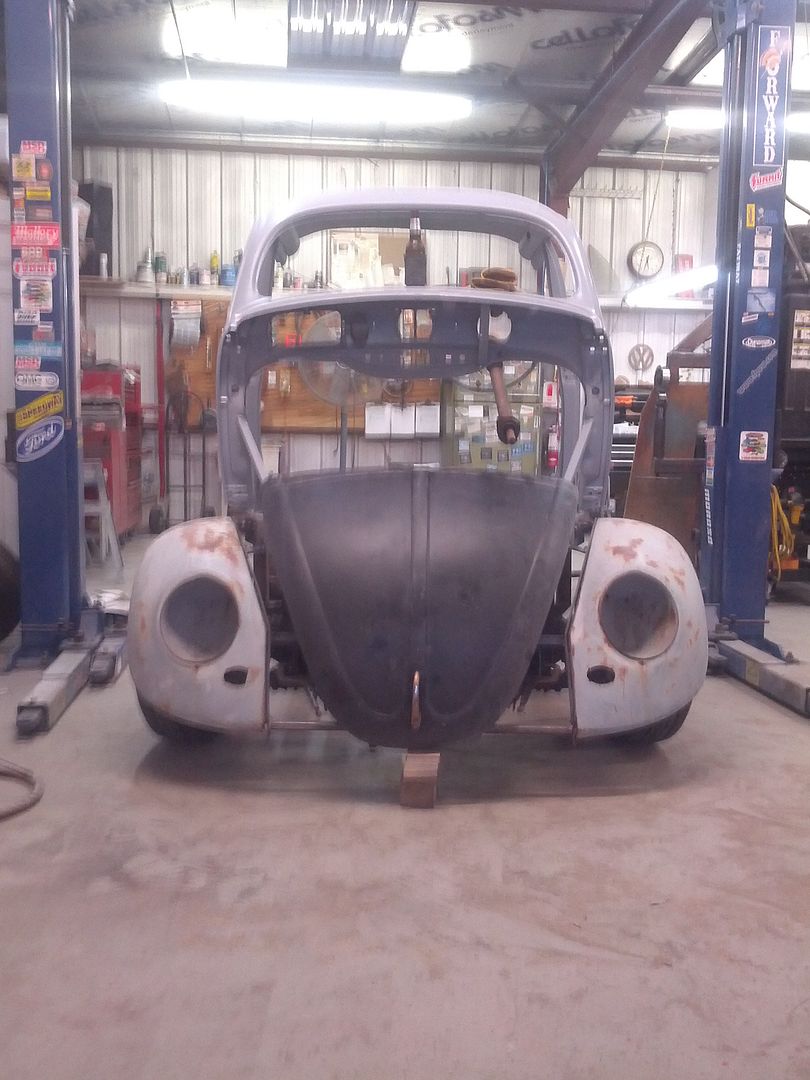

After seeing the rendering I decided to buy an old derelict bug and chop it up and play with the pieces to see how they might fit together as a C.O.E.
Deciding that a front engine configuration would not work without too much effort I decided that it would be possible as a rear engine truck.

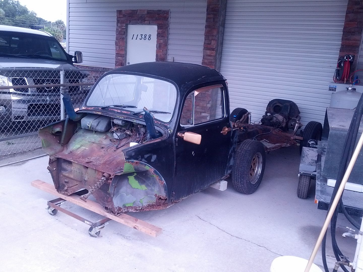

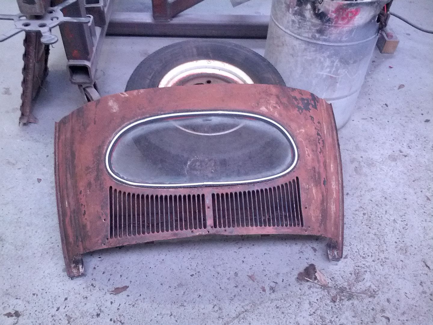

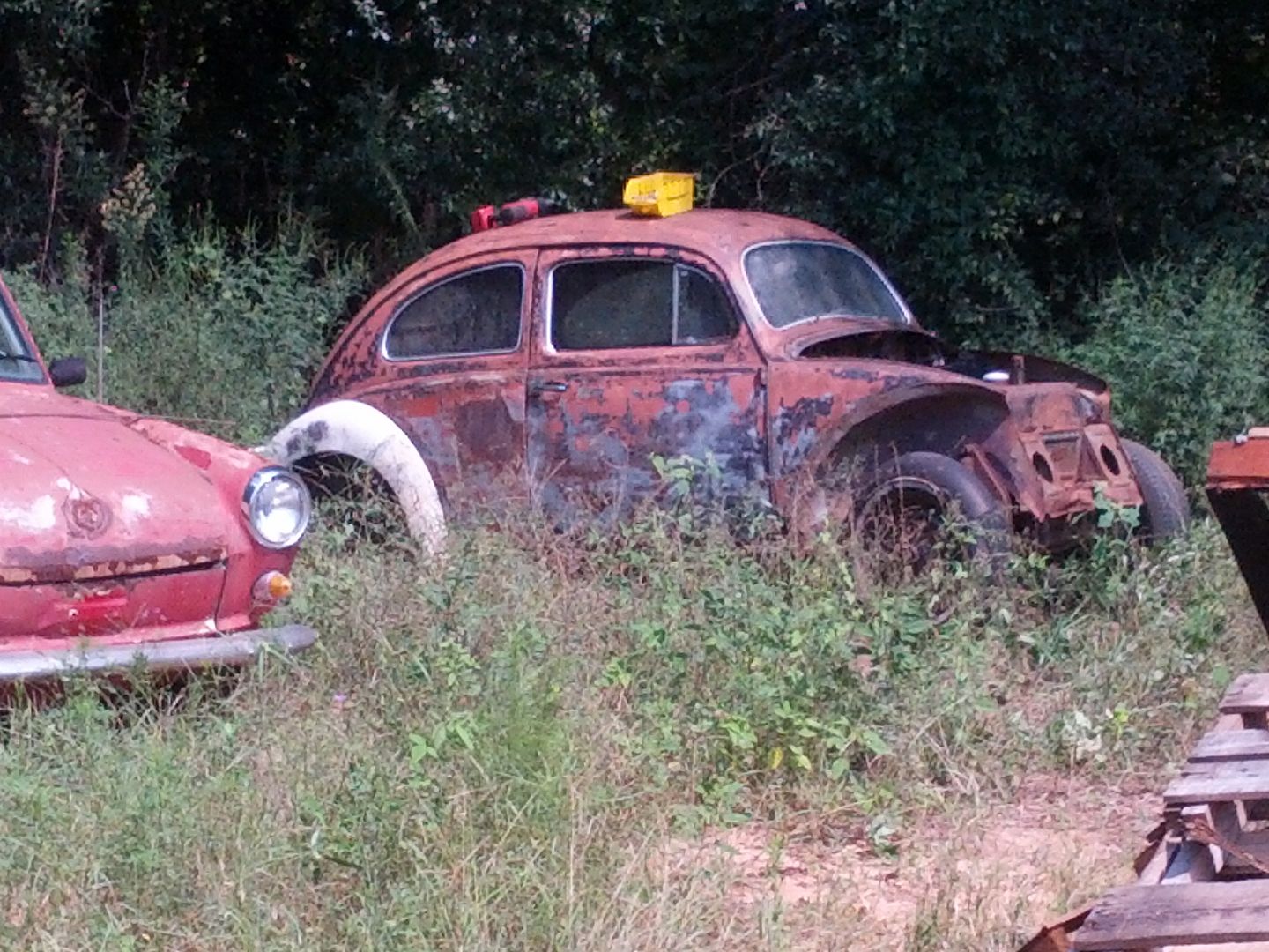

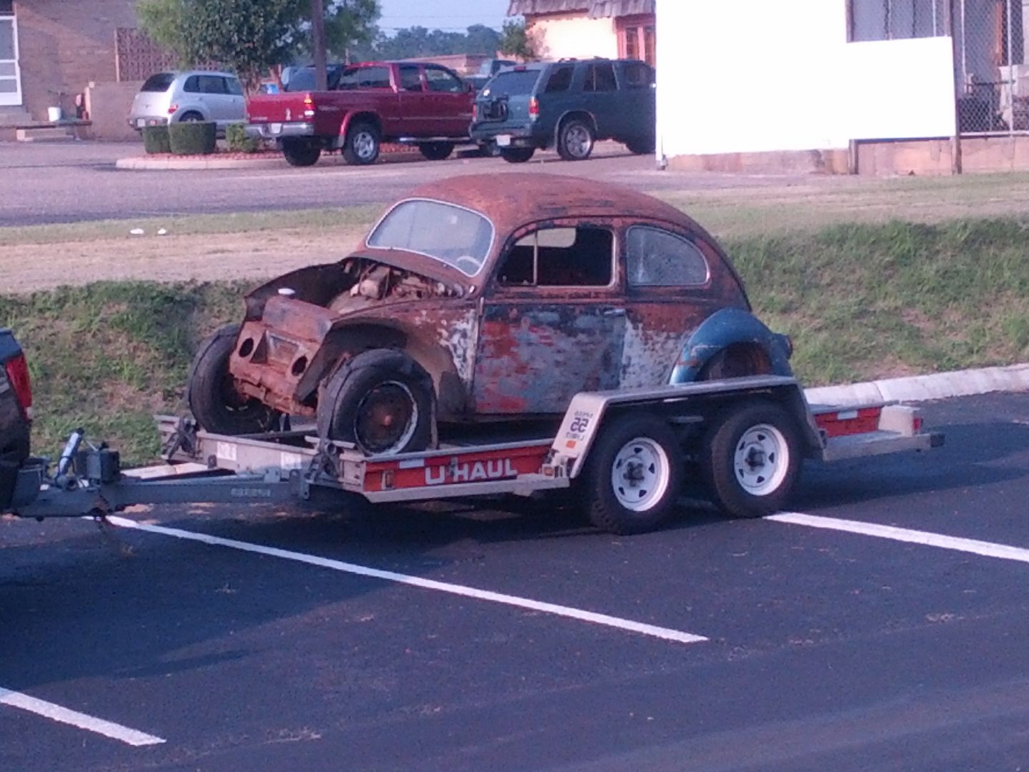

So the build is on ! and I start looking for a donor bug and decide I like the early look better because of window size and dashboard Etc.......I'm thinking 64 or earlier and then this Oval pops up!.....
Up to Alabama I go and drag this baby home with me.......

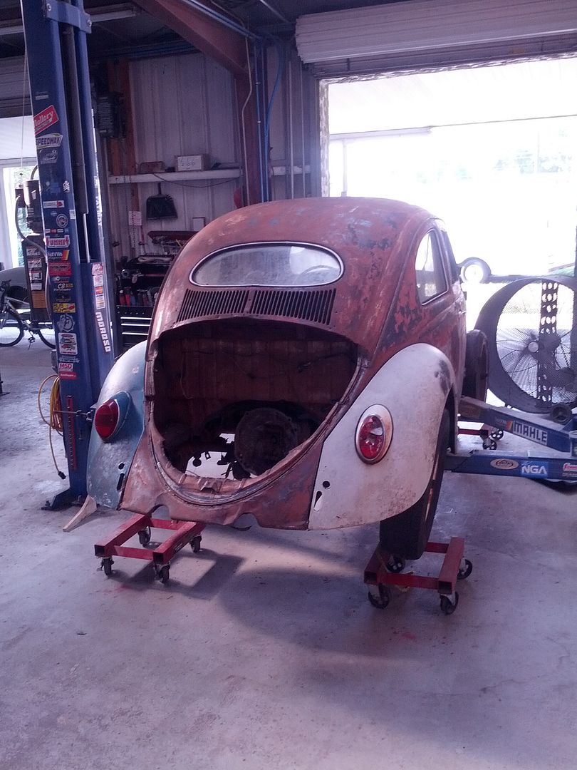

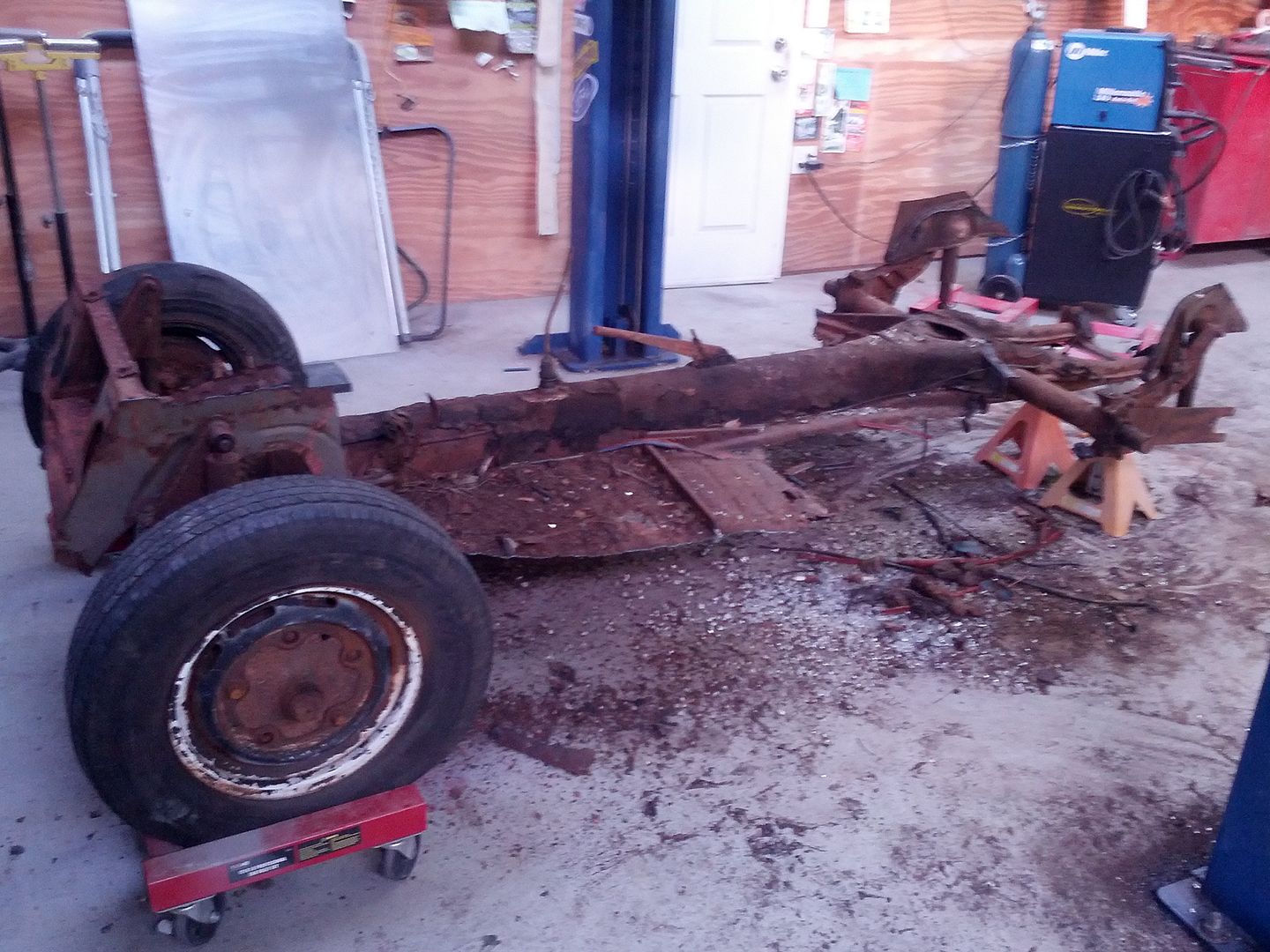

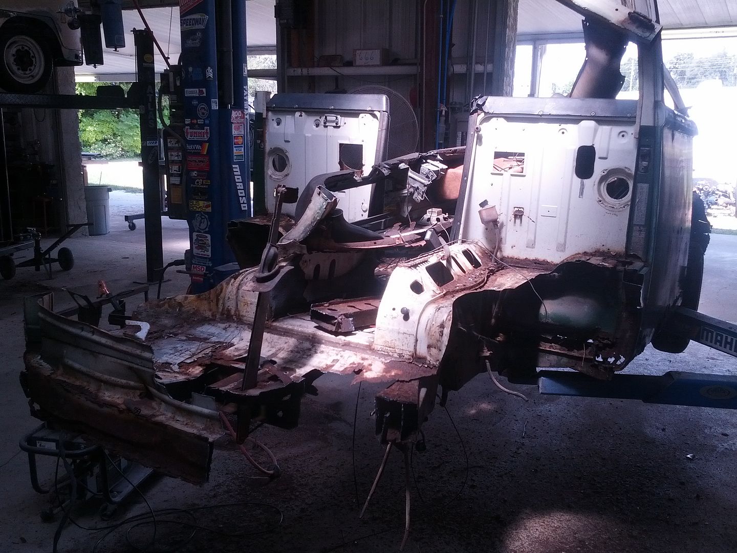

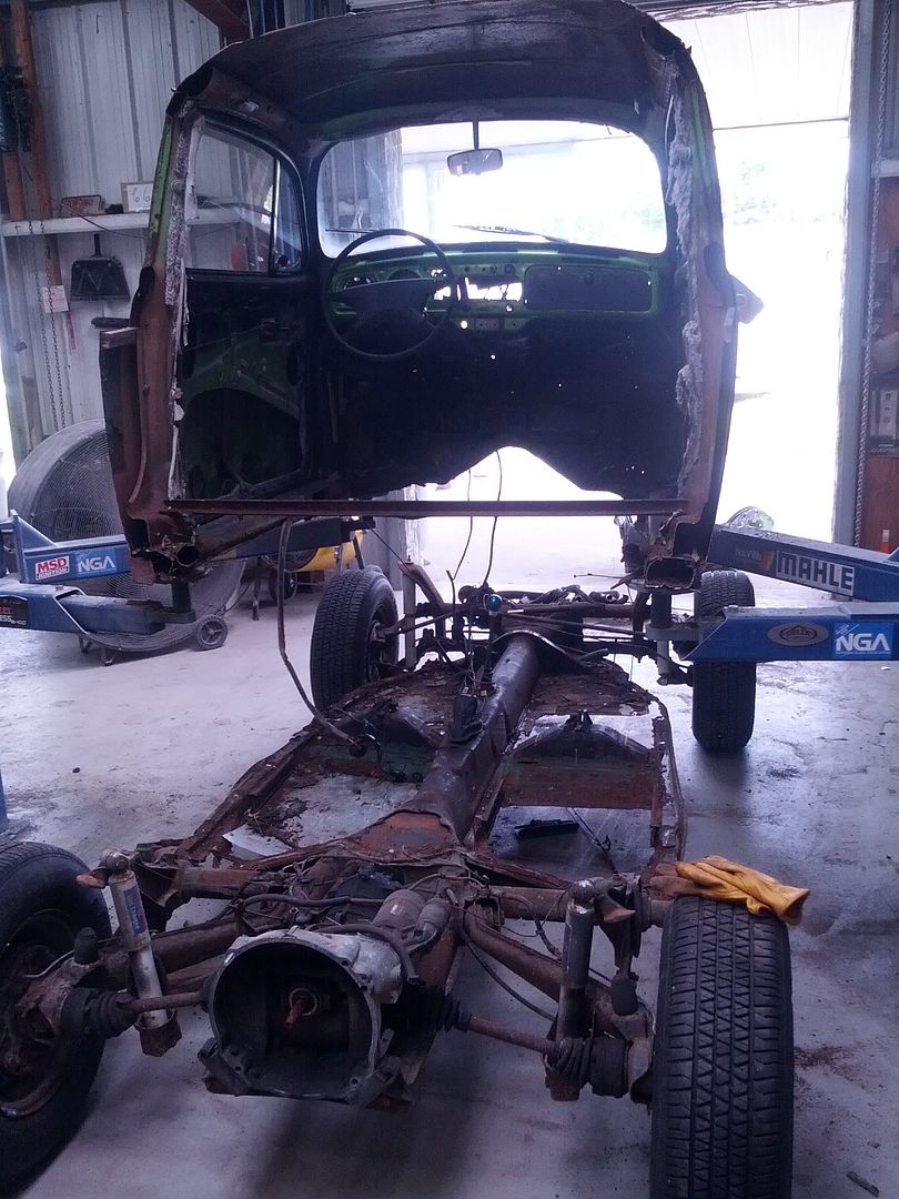

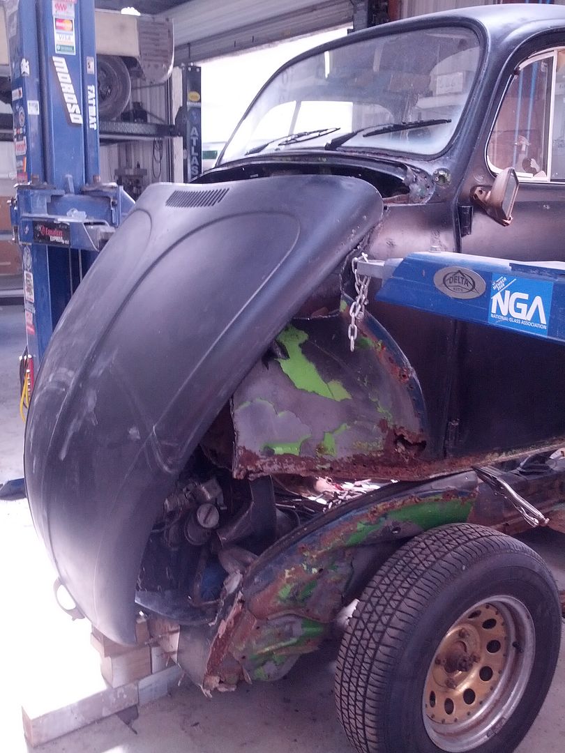

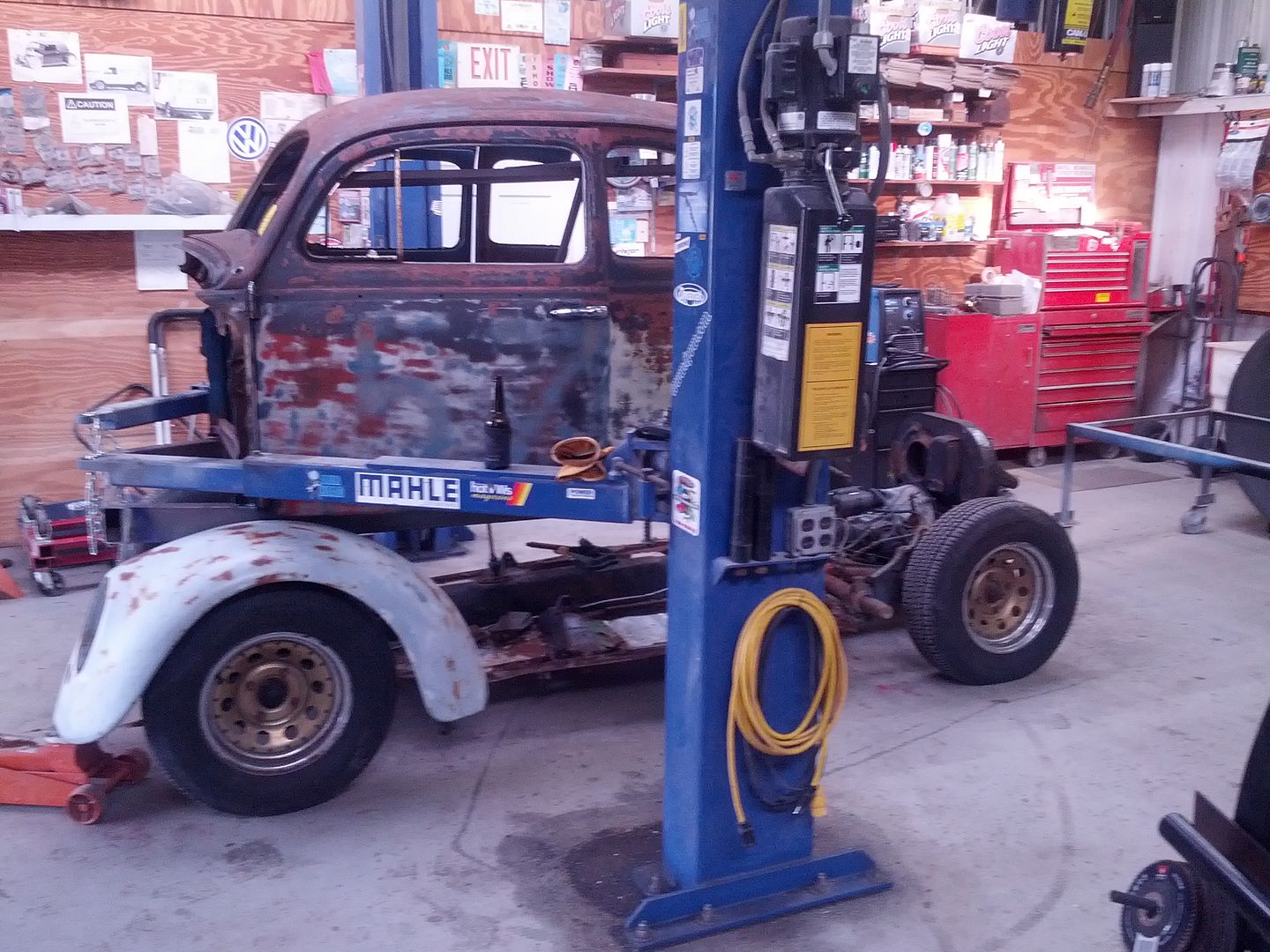

Got it home and unloaded onto the roller plates....
Johnny fived this thing.............

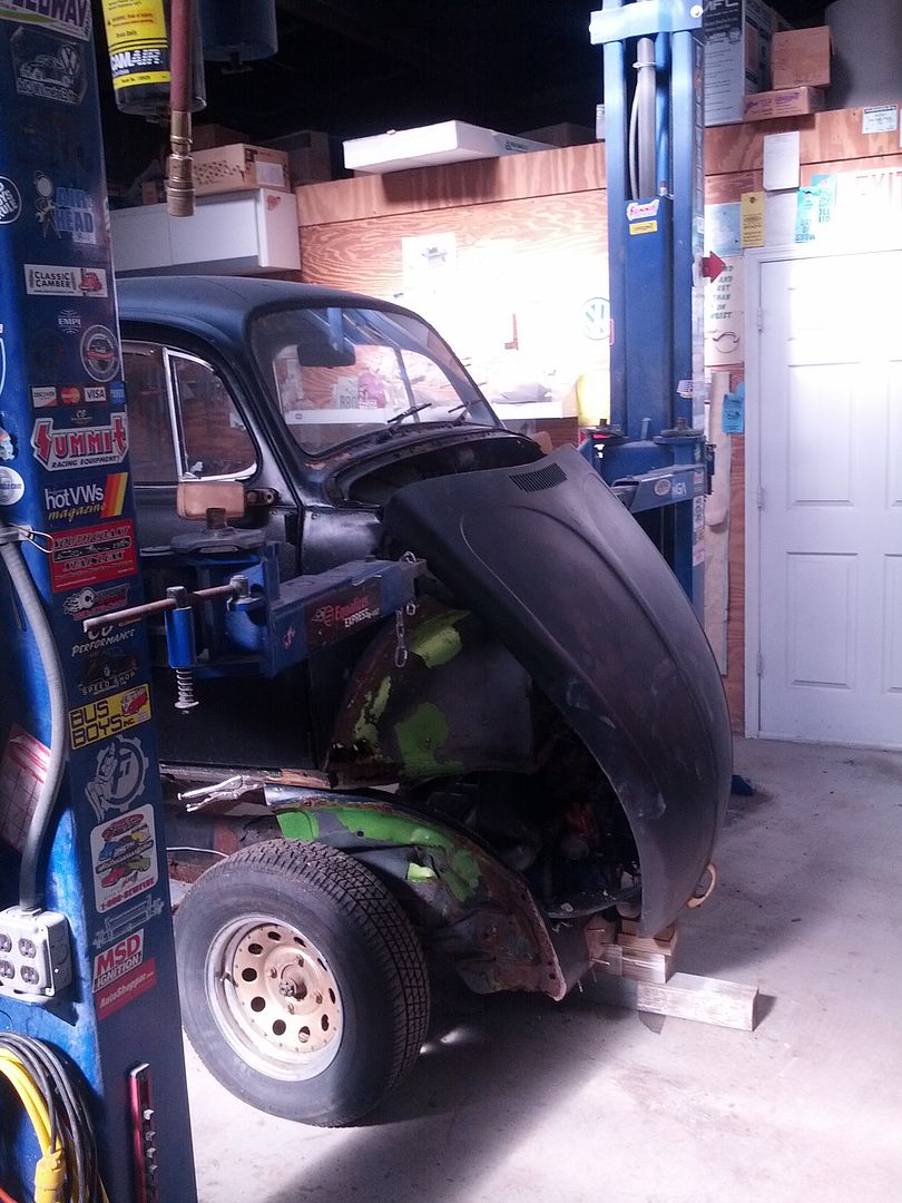

Original 57 pan, didn't put up much of a fight coming apart....

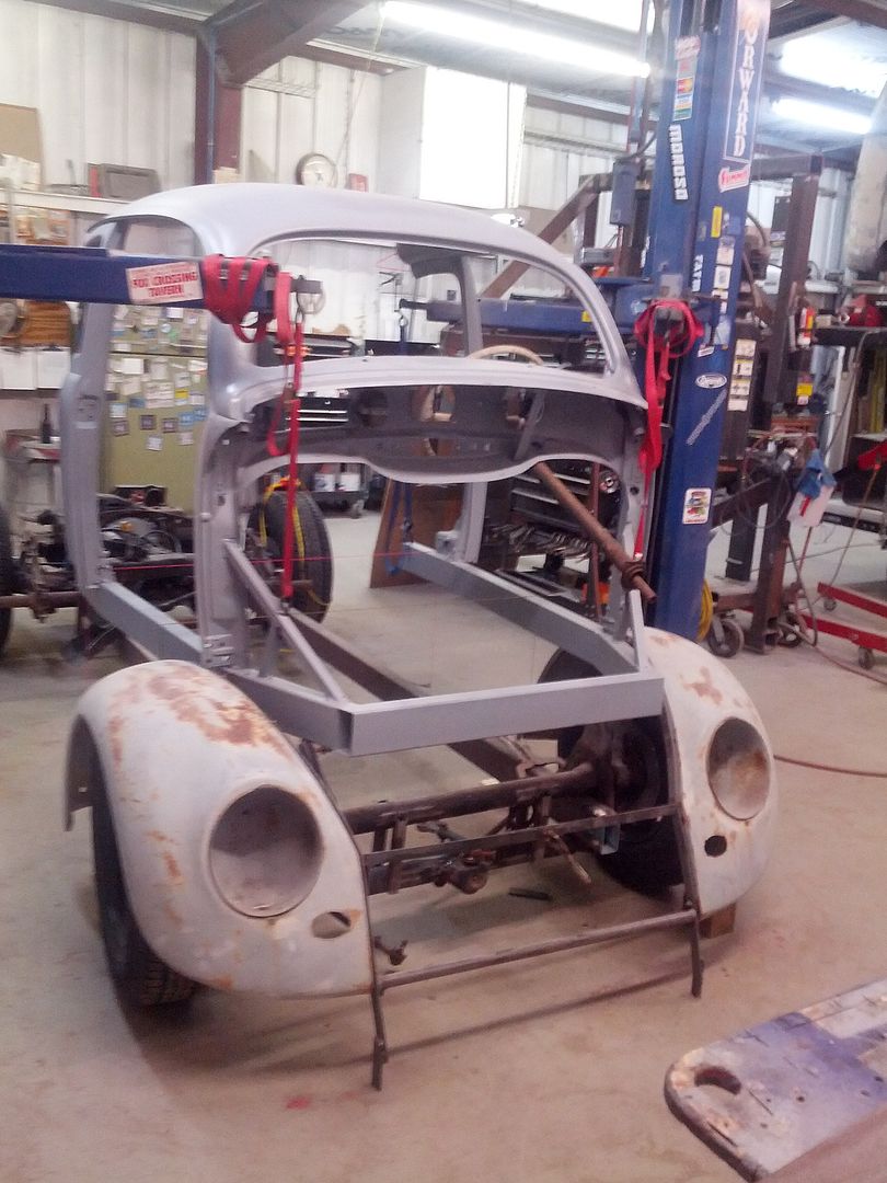

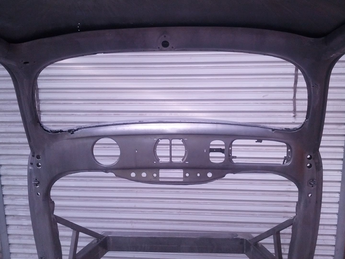

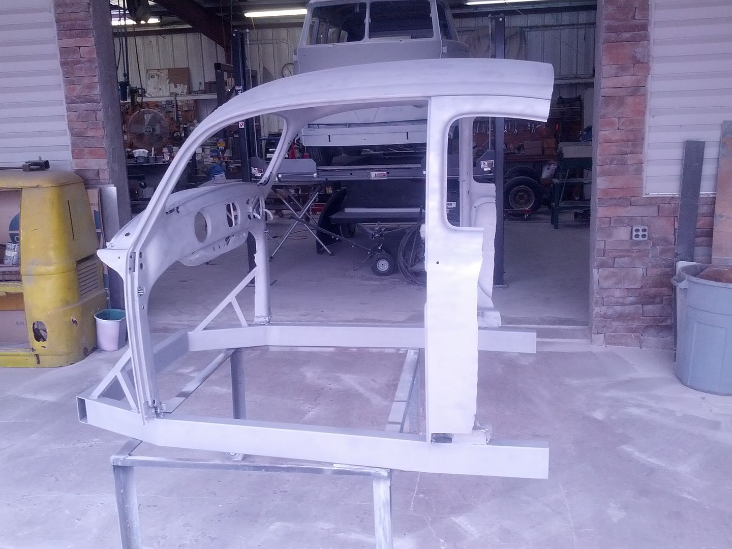

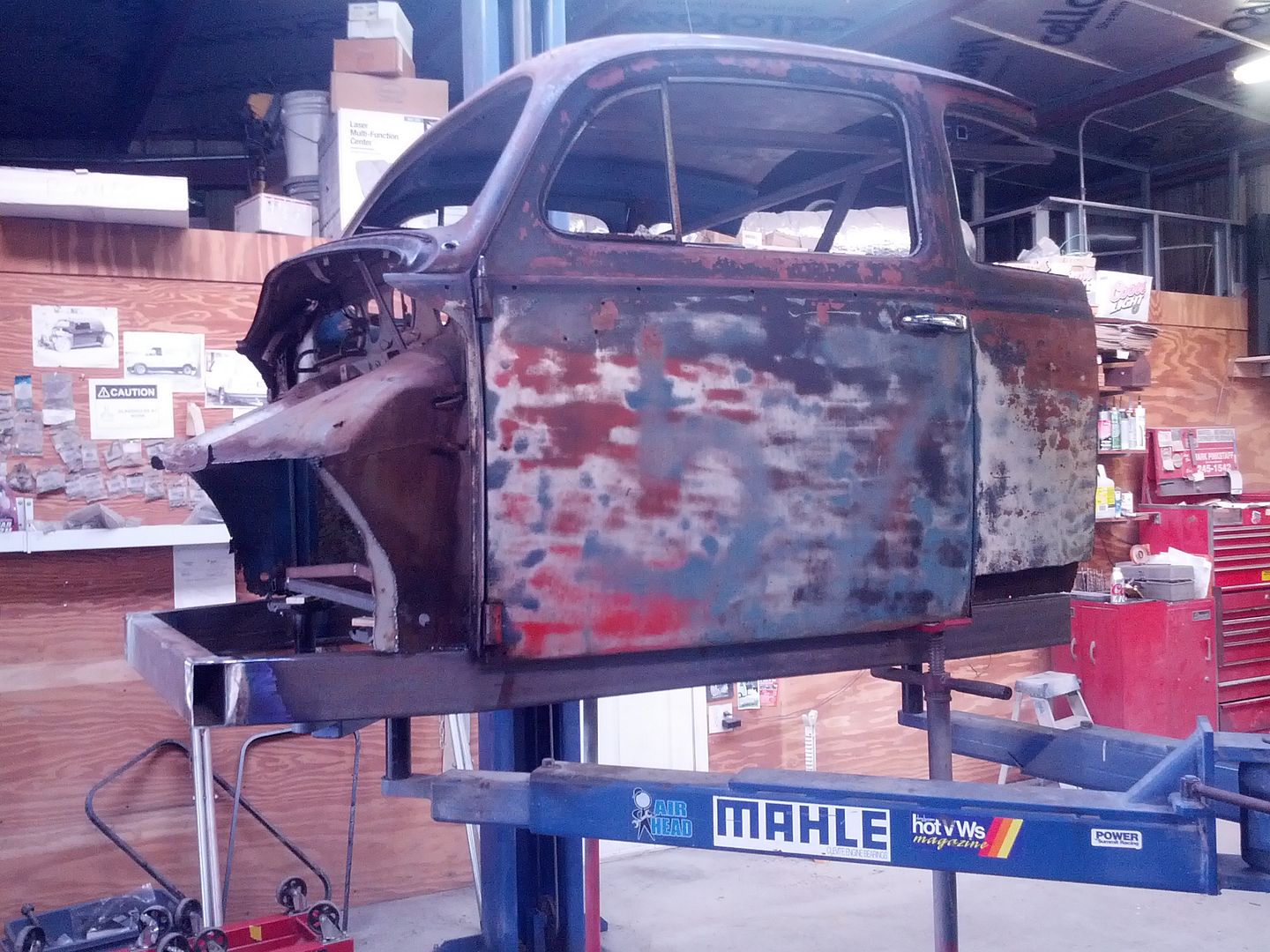

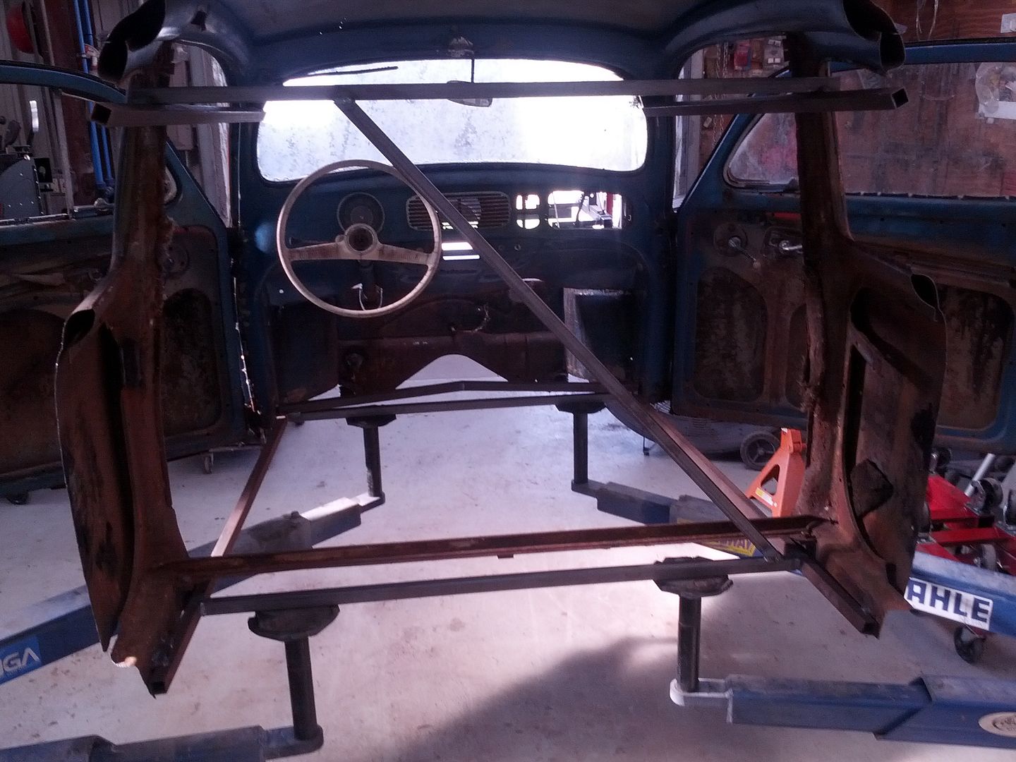

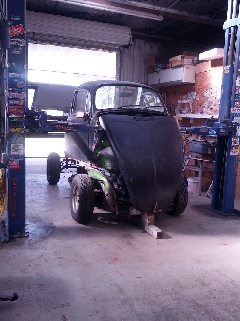

Welded some bracing in the body and started to whittle away to get down to what I need of it..........
Heater channels were absent so made up my own heavy duty version..........
and installed them............

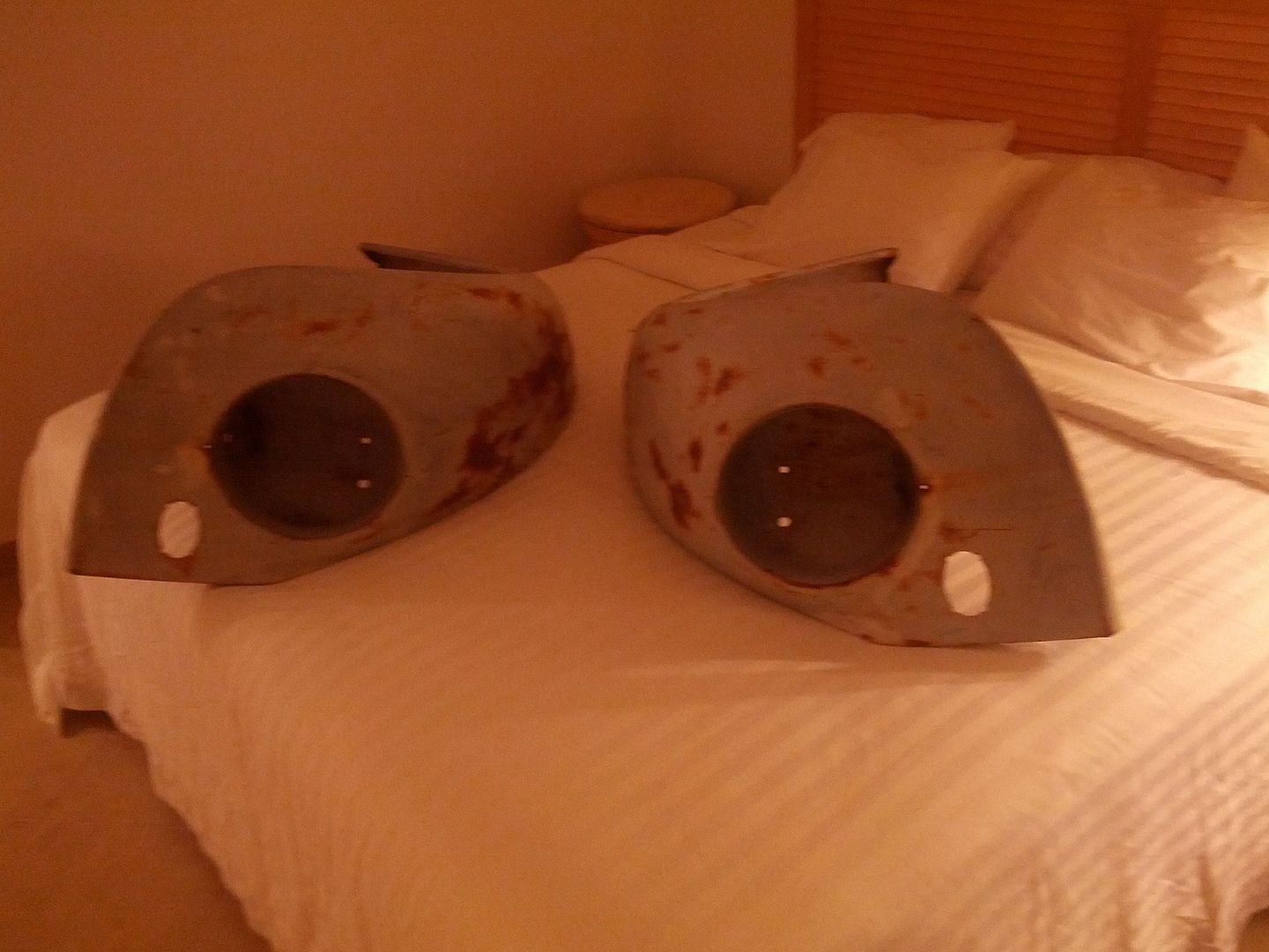

Picked up some nice early fenders..........
Still picking away at the body got it down to the essentials now.........

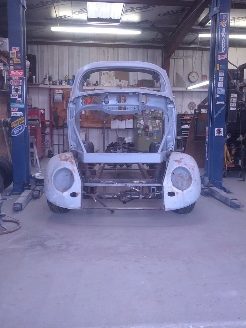

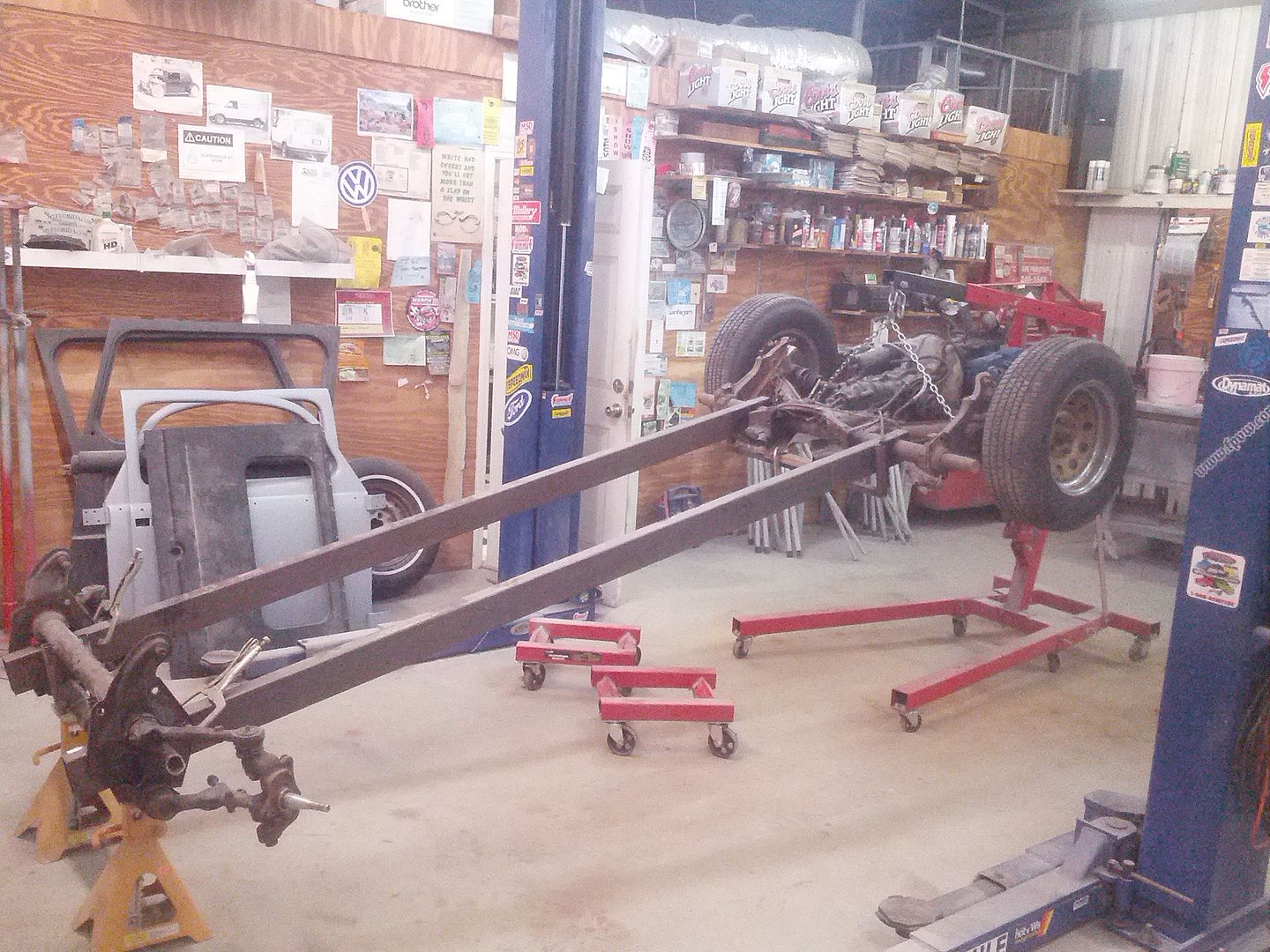

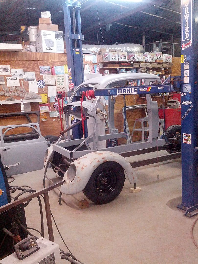

Time for a little mocking up and stand back to see where I'm going............
Bought the remainders of a 73 bay bus for it's beam and some steering and brake parts then scrapped the rest.......

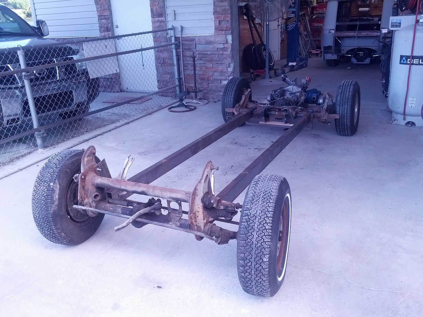

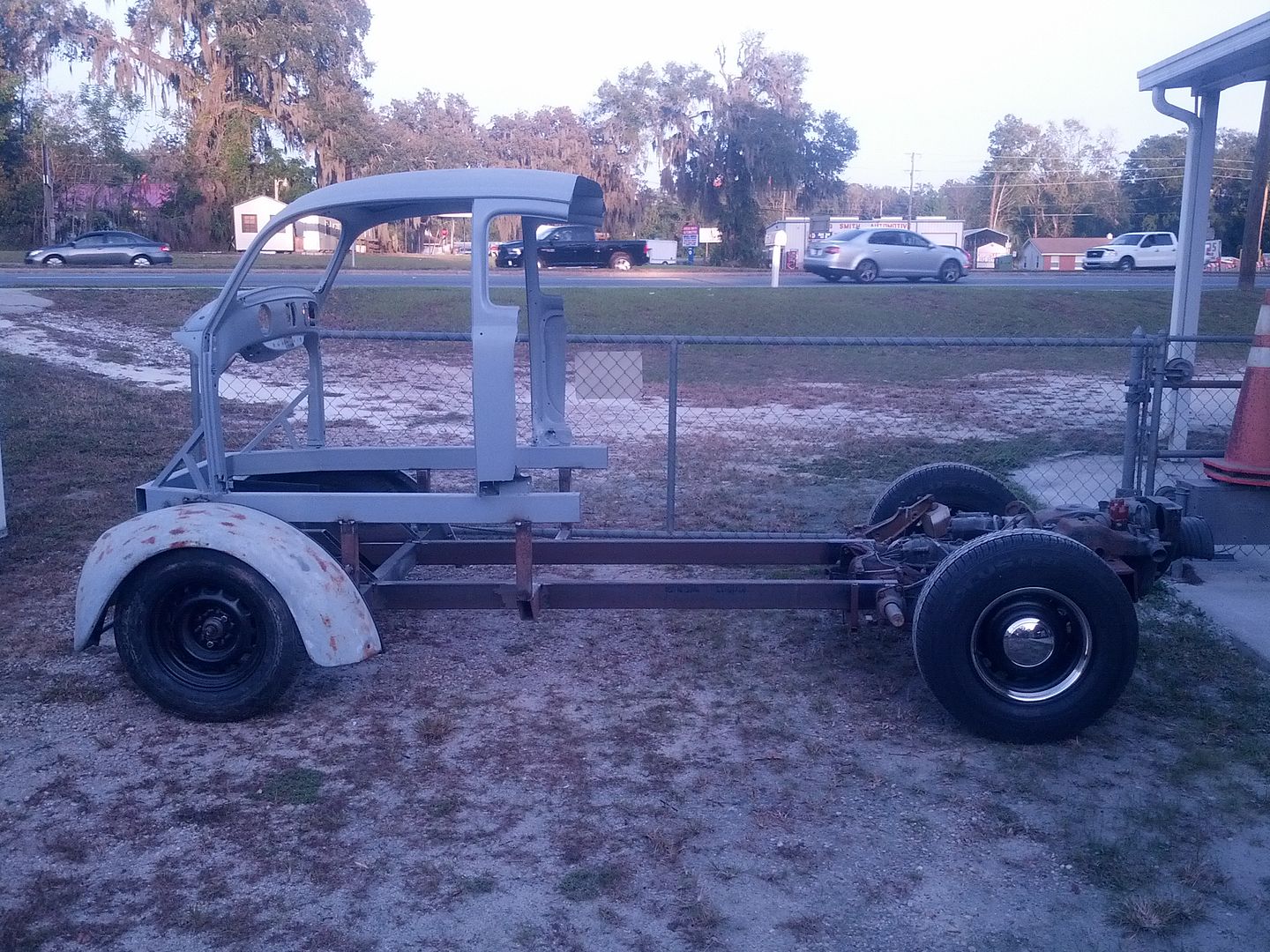

That bay beam, some tubing and the rear end of that first bug will be the chassis.......

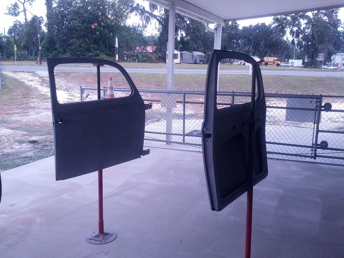

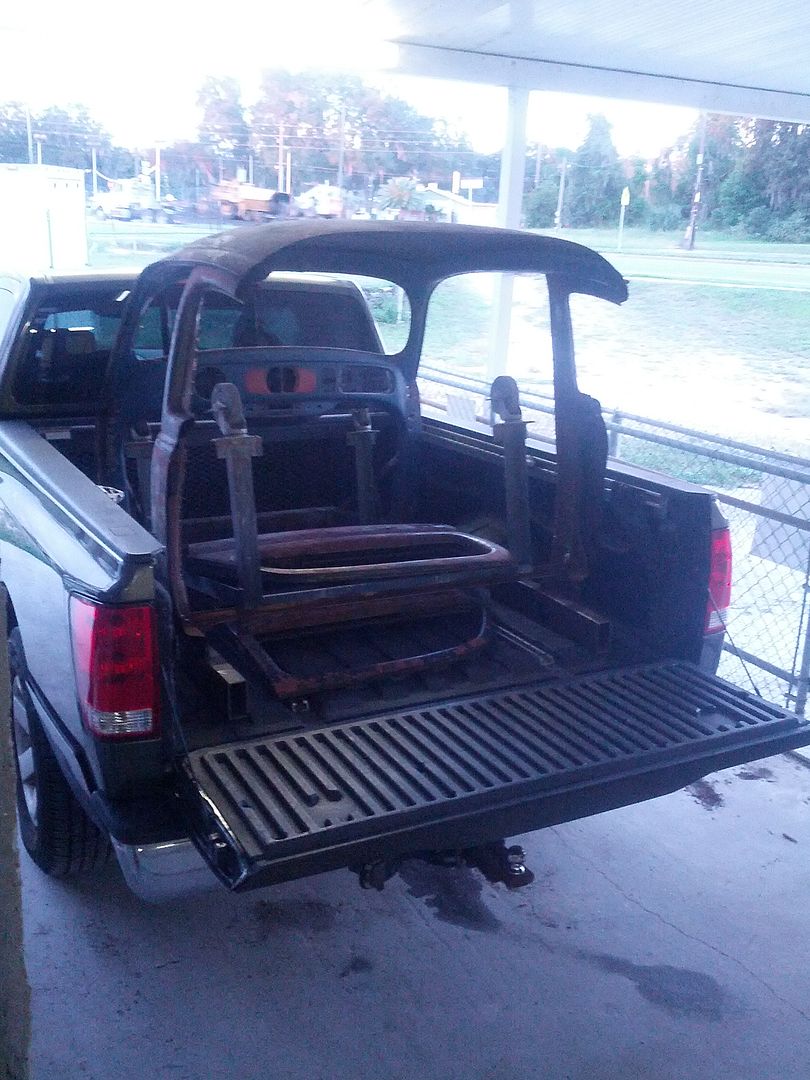

Body and doors are going to
http://www.autorestorationdepot.com/
for a dip in their "pool", the parts come back clean !.....
At least now I know what I have ( and have not )

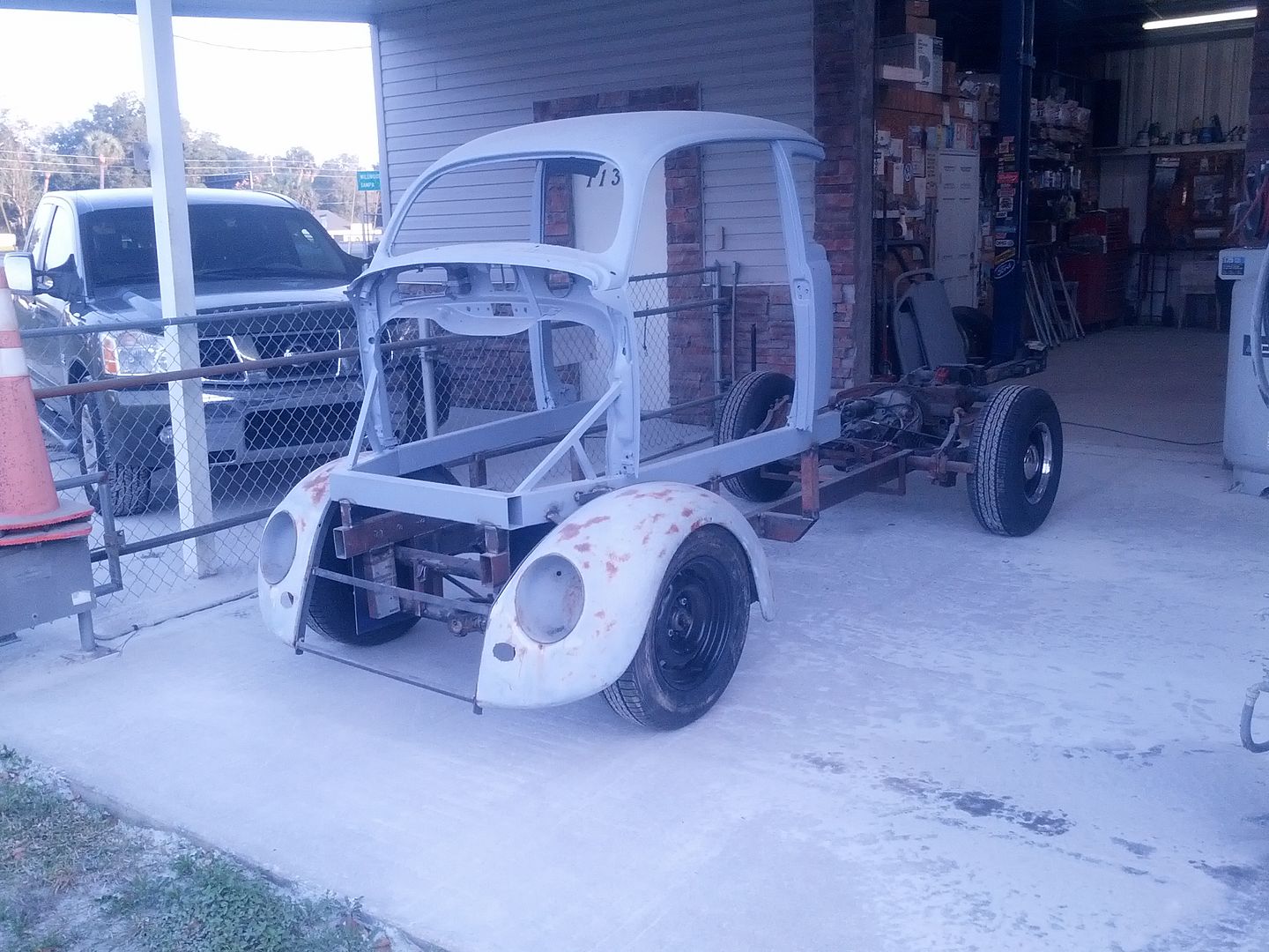

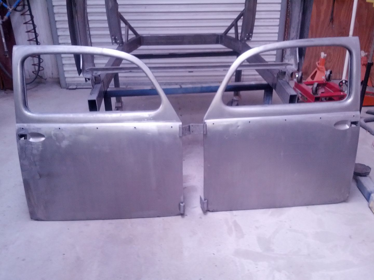

The body and doors then got a coat of epoxy primer....
The beam was taken apart and Beefcake adjusters from Wagenswest were added.......

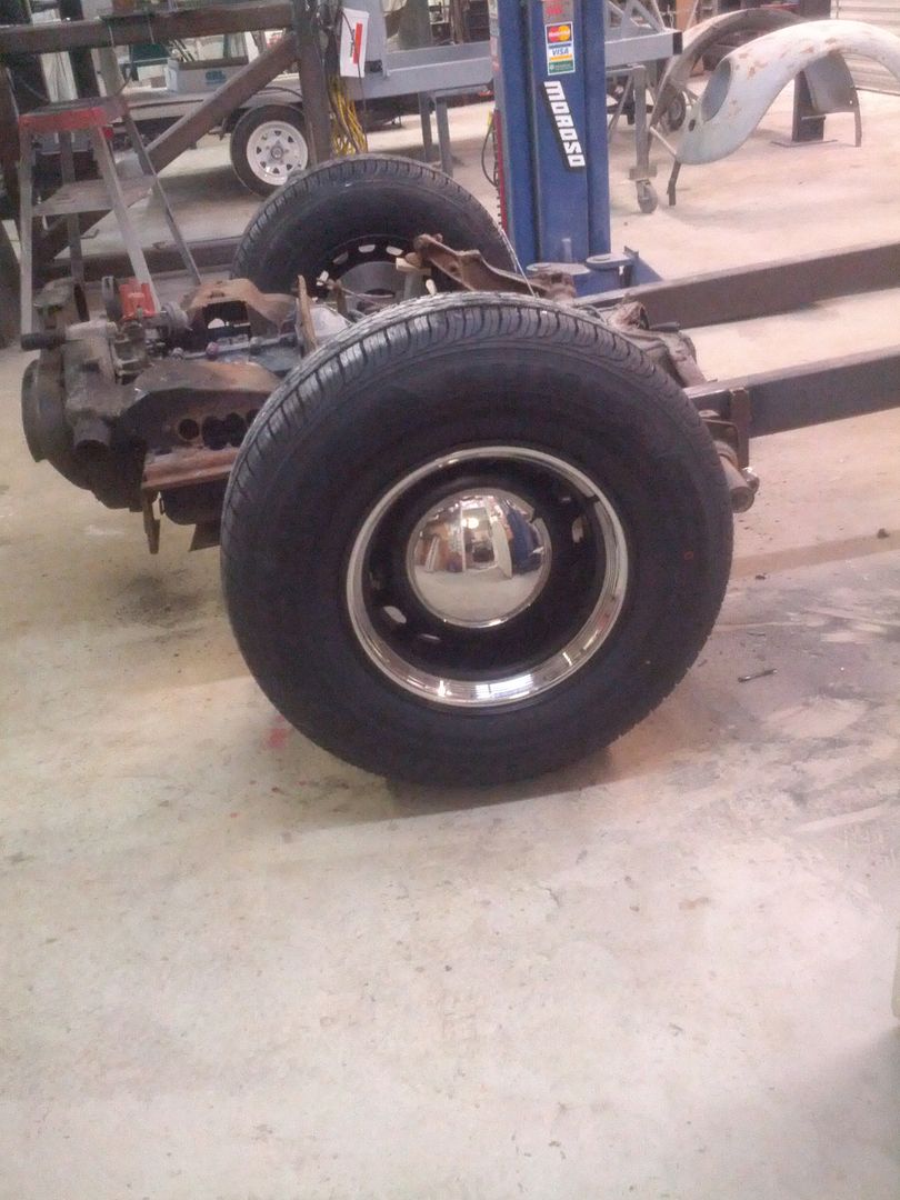

C.B. Performance disc kit added to the rear along with the new tires and wheels...............

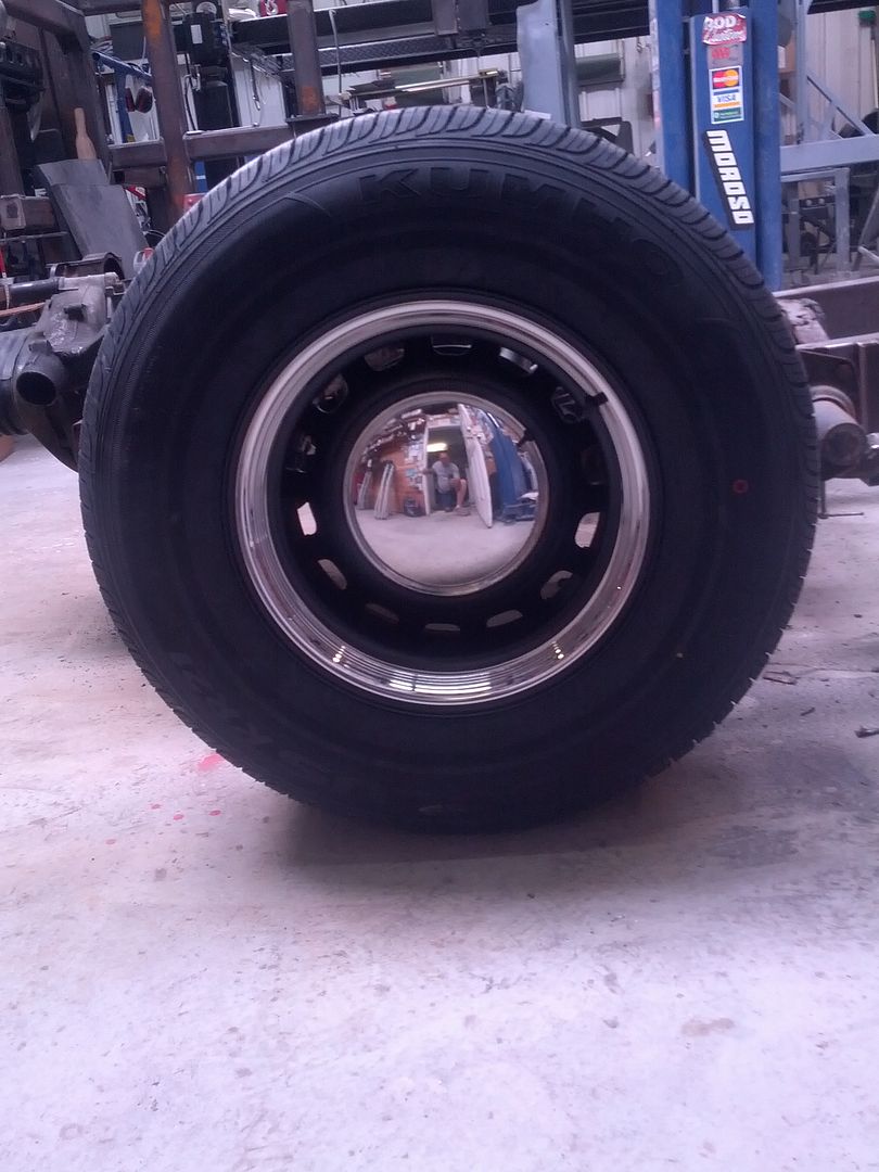

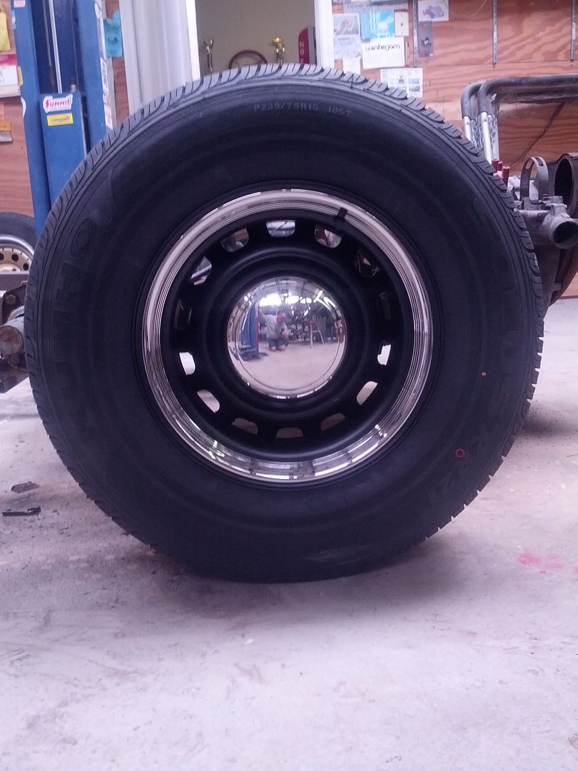

Which center caps you like best.....
A.......
Or B.........
Skidmarks Garage is offline   Reply With Quote

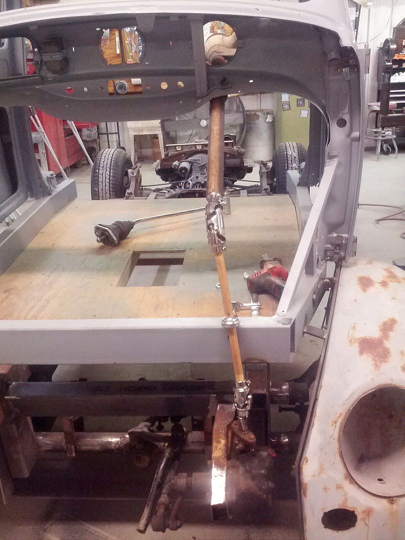

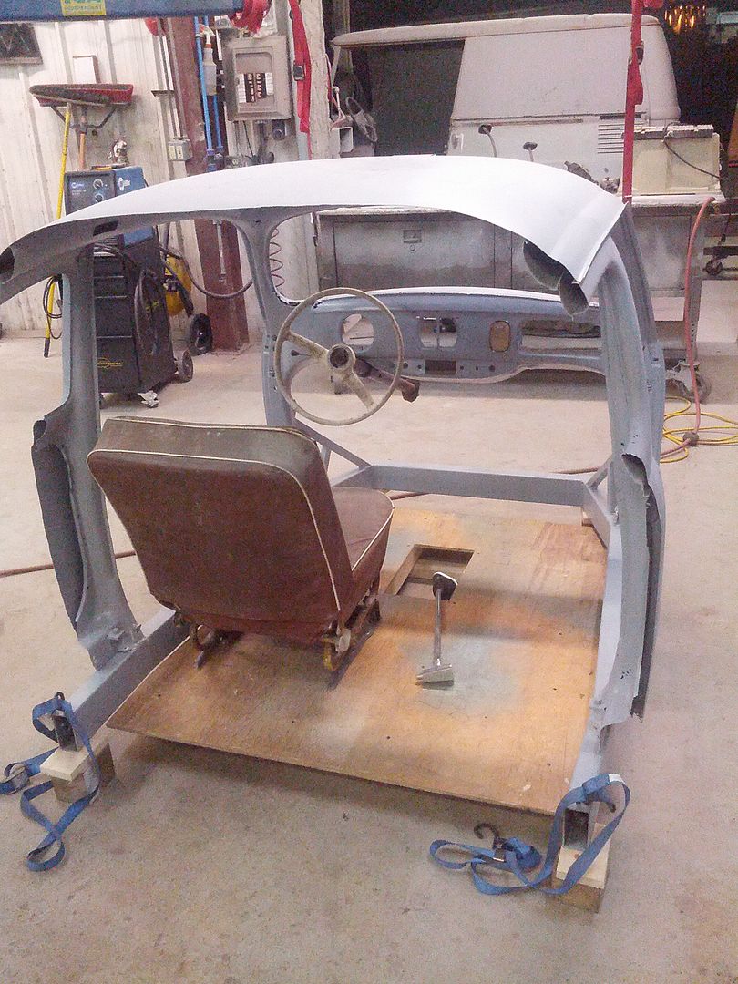

Made a floor "board" to help mock-up the seating, steering, brakes, clutch, shifter, Etc...
[IMG]http://i232.photobucket.com/albums/ee4/halfastvw/Skidmarks%20Shop%20Truck
/IMG_20131123_185356.jpg[/IMG]
One of my favorites..........

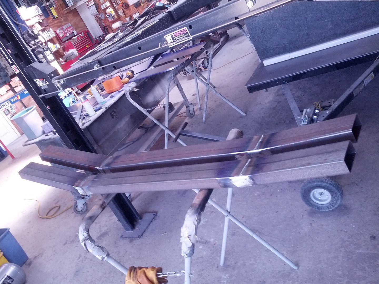

The super side plates will be trimmed later, after the chassis rails are mounted to them.....
Front frame kick-up.........

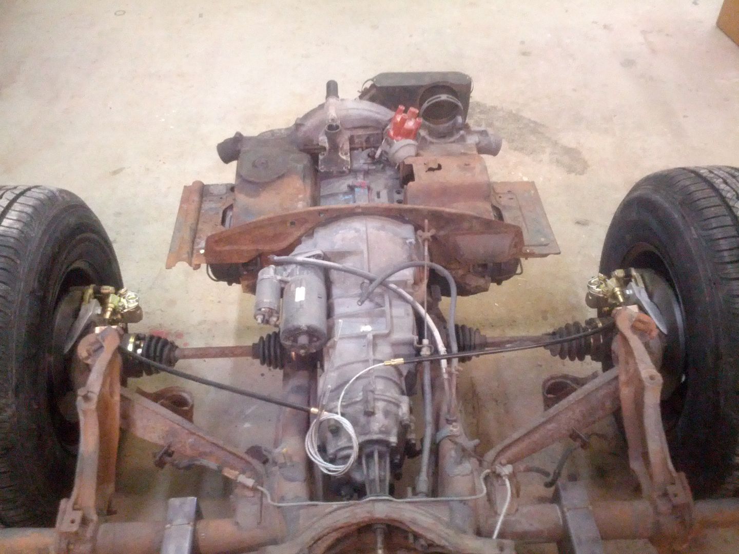

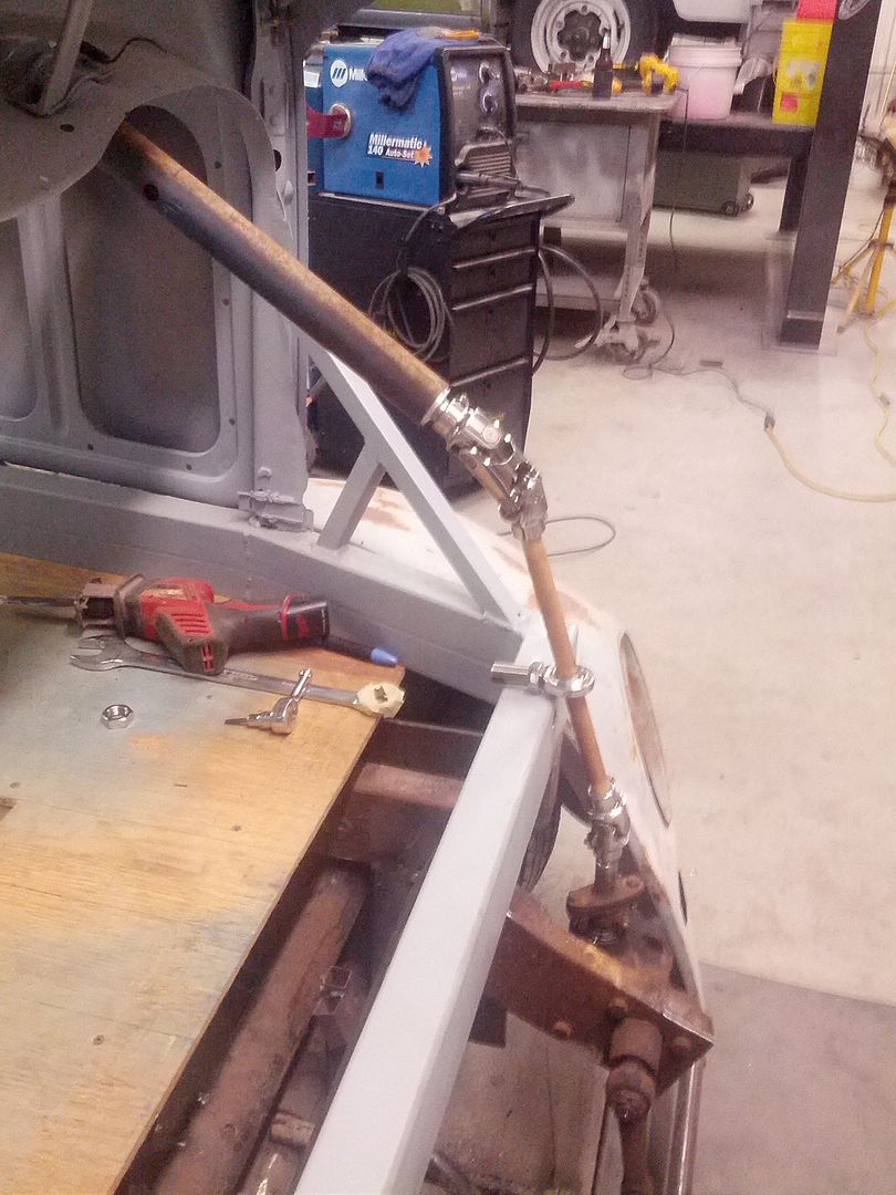

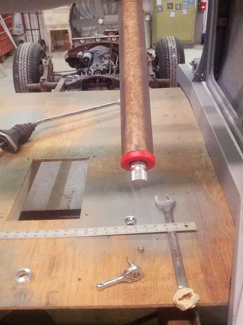

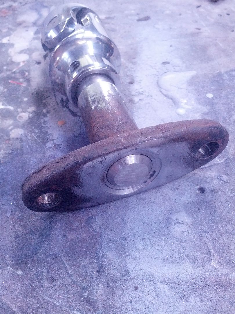

Some steering going on.............

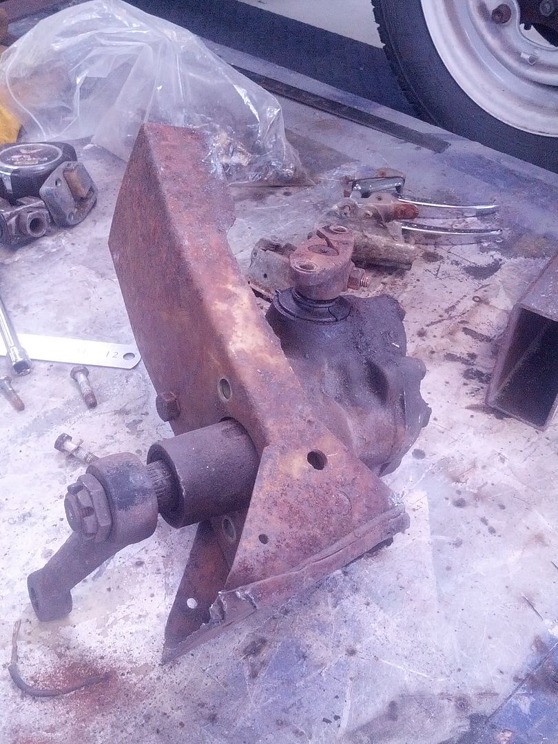

Bay bus box and frame chunk.......

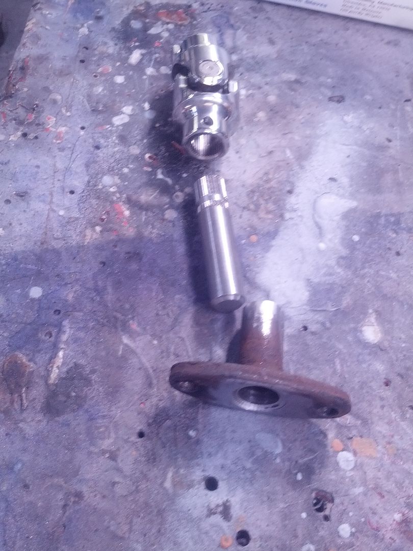

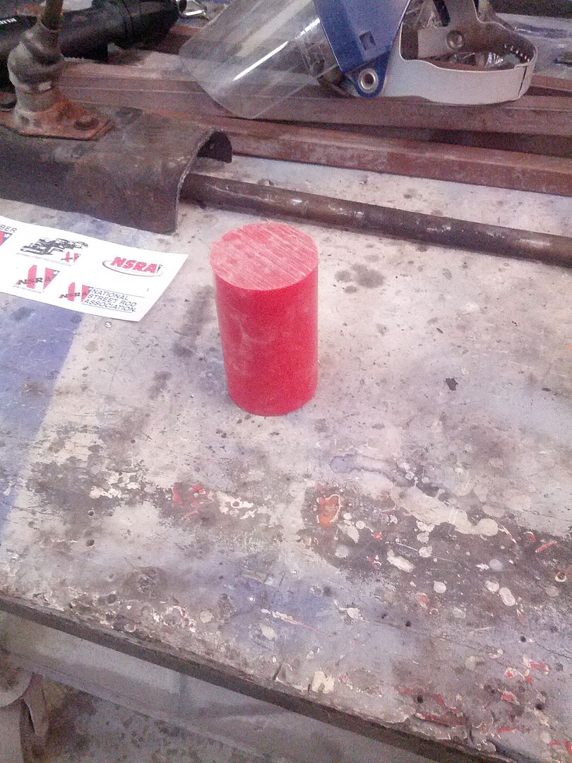

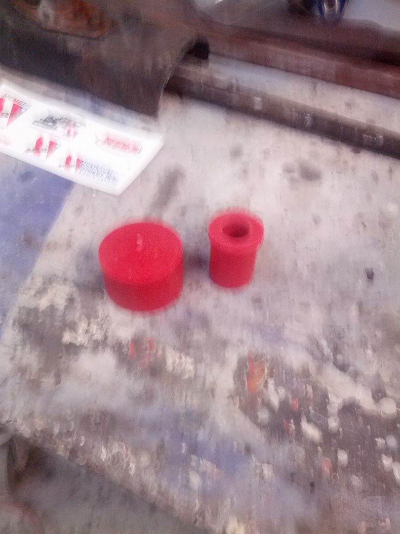

Had to make a non conductive bushing.........
Getting the shifter and pedals mocked-up.........
