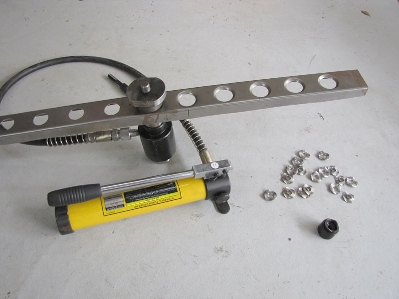

After punching out a bunch of holes last weekend for the deck lid piece we thought it would be great if we could make an adapter for the Hydraulic Punch Press so that we could also use the Dimple Dies with the press.
Since we can't leave a perfectly good working tool alone, we gave the press and the largest Dimple Die that we had to my Father-in-Law and he brought it to his friend that is a master machinist.
He took all the parts and turned down a new adapter for the Dimple Dies so now we can use the Hydraulic Punch Press to not only cut out the holes but also Dimple Die the holes afterwords.
(Look out... Now we are Dangerous).

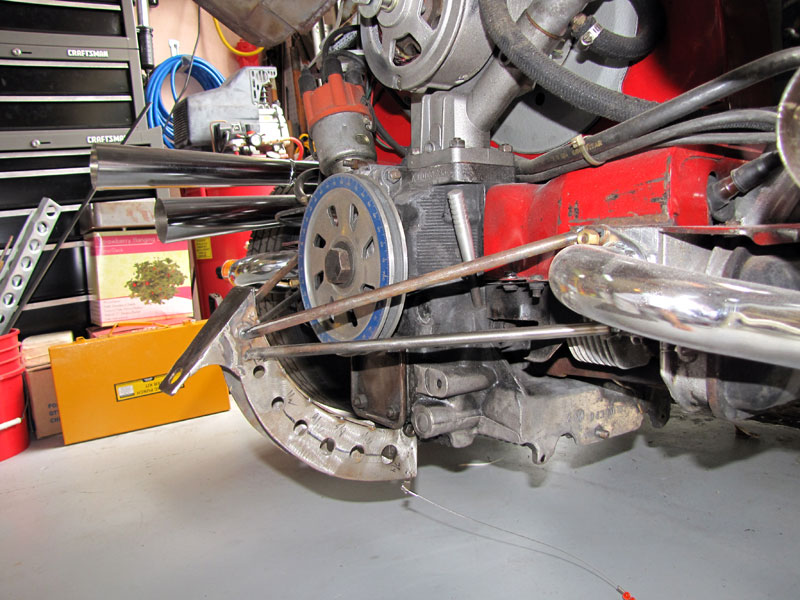

We next focused our attention to the rear end of the car, that has been an issue since the beginning. This is where three body lines come together and we have modified the rear end so much that it was easier to fabricate all new panels for the rear end than to use what was there.
First thing was to weld up the three body lines in the rear so that we had a solid piece to work with.
Then we had to taper the inner frame so that in flows in to the piece that we added and then cut away all of the rear metal and start to define the shape that we wanted in the rear end.
Then we proceeded to fabricate the inner lip for the new structure.
Checking the fit of the inner lip. Once this is in you will be able to grab the rear end without cutting your hands and it also cleans up the rear end.
Then it was time to weld in the inner lip.
With the inner lip welded in place you can see how the rear of the car has a scalloped or (Dragon's Wing) look to it. We also like the fact the the carbs are exposed.
Now we can finish welding up all of the other pieces together.
Time to roll it out and have a look.

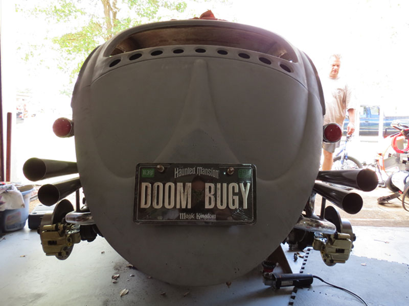

We have been playing around with some ideas for the license plate holder for the rear of the car. As usual we just couldn't use a stock pope nose and bracket on the W-lid and since the whole Frenched-in thing is played out, we decided to go back to our roots and get all nostalgia on your ass.
So as usual we broke out the cardboard and started to play, then the Evil Metal Genius took the templates and started to break all the metal so that we could make the new bracket. Once everything was cut down it was time to weld it up.
From the back it looks like an ordinary tag on the back of the car.
But after a shit load of cutting and punching holes it begins to resemble an old AA/Fuel Dragster parachute box.
The plate will be held in place by L.E.D. Plate Bolts (that will also light the plate) so the plate will float on the back of the lid without a frame.

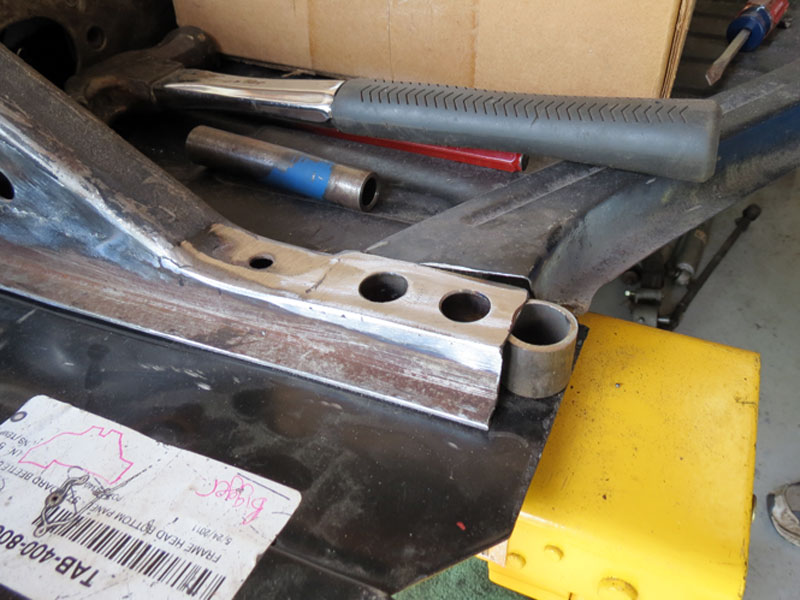

We began by adding the lower stabilizer bar to the bracket and then make the top piece for the pin to slide into the bracket.
Then we added a curved piece to the side to tie in the top plate to the drilled side bracket.

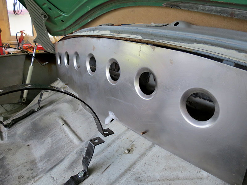

Then it was time to add the inner plate bracing, but as usual we had to punch holes into it.
A shot from the side. This thing is Evil Looking, you really need to see it in person to appreciate it. We just need to add the bottom to it.

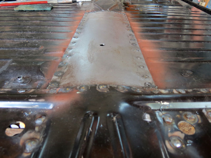

We spent the entire weekend patching in little panels everywhere on the car. We are at the point where we need to finish off all of the major fab work on the body before we pull it off the pan for the last time (LOL).
Cutting out parts of the body to patch some of the holes.
Welding in a new panel to fill the hole.
Also added the front piece to fill in the rocker panel, since the inner fender well is not covered by the fender we wanted to roll the panel in to follow the body line.
Did the same thing to the driver's side.
Again all of the panels have been filled in including the original hinge area, this makes a nice solid clean support to the heater channel. We will also cut away the front pan and make a neat cover for it so that you cannot see it.
Then we finished filling in and cleaning up the hinge area of the driver's side door.
Welding up all of the little holes on the driver's side door and adding more support to the hinge pocket on the door.
Starting to look a little cleaner, it will have one more go through once we start to do the body work, we will take everything apart and fill in all of the remaining holes that we may have missed and then smooth out all of the metal before we Duraglass and then Bondo the living hell out of this car.

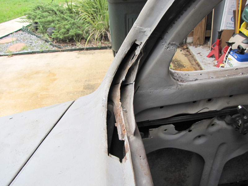

Then it was on to replacing the windshield area of the car. there were several areas that had been replaced by the previous owner that really needed to be done the right way, so I began by cutting out all of the areas that needed to be replaced.
Then we began to make replacement panels for the areas that were cut out.
Set in place to make sure they fit, you can see that we also put in the holes so that we can spot weld the dash face just like the factory.
A little welding in the panel.

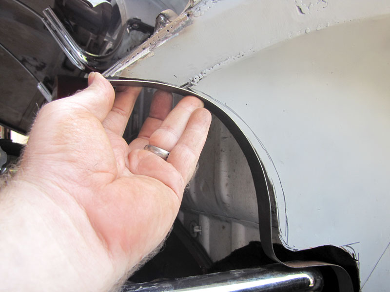

Then it was on to the tricky piece to replace, the corner has a tight radius to conform to.
So we broke out the shrinker and began to shape the metal piece to fit the area.
The piece bent to the shape of the area before it was trimmed to fit.
Set in place to be cut down to fit.
After all of the trimming to fit the area that was cut out.
Again adding the factory spot weld holes. Yes we are very anal about specs.
Then the piece is welded in to place.
Now it just needs to be ground down.
The windshield area is done and now we are ready to make the safari frame to go into the opening.
Until Next Time...

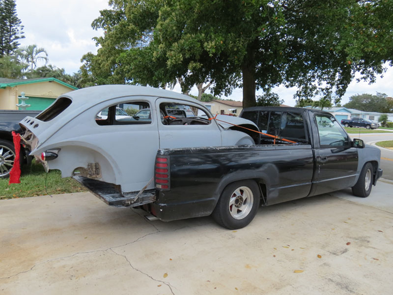

So the time has come to separate the body from the pan so that we can start to get to work on the frame and finish the lower end of the car.
Since the body will not be on the pan for a while I thought I should roll it out and take some shots of it before it's gone. I spent most of the week stripping everything off the car and unbolting anything that was not needed on the body.
So lets roll it out and have one last look.
(the car looks like a model)
A couple of shots of the Suicide Doors.
And now we start to separate the body from the pan. (Everybody is channeling their car, we are lifting ours)
The body finally separated from the pan.
Now we load it up on to the back end of a pick-up truck (yes we are rednecks) and get it ready so that we can store the body.
Say goodbye for now.
Roll the frame back into the garage and get back to working on it.

Then we tore down the rear trailing arms and began to sand blast them to get them ready for paint. After that we decided to finishing up the bottom end of the tunnel.
First we wanted to run a new stainless steel fuel line inside the tunnel, so that required several hours trying to get the old one out and then run the new one in the factory brackets (again, yes we are anal as hell).
Then we decided to brake out some of the high tech tools that everyone seems to think that we have. Since we cut away most of the front tunnel we had to fab up a new one and we just could not throw in a flat piece of metal so we started to make a new tunnel piece. (notice the ultra cool tool that we are using, yes that is a welding tank).
Then I start to cut down the metal (on our ultra cool work bench) so that it can be manipulated more.
Then we put the piece into the vise and form the edges to match the bottom of the tunnel. After that we do a test fit and drill a shit load of holes for the spot welds again.
Then it's time to weld everything back up.
Add the front bulk head piece and then stand back and have a look.
You can even see the bow of the original tunnel match up with the new piece that we made.

So it was back to work on the frame head. The other lower side needed to be formed so that the beam would fit in and then welded and ground down.
Then we needed to make a piece to fill in the gap, you can see the curved piece that we had to make in order for the beam to fit in place.
Now the front is all welded up, ground down and finished.

Then it was on to tackle the inner rear C-Pillars. You can see here that the gap from the body to the roof is pretty significant.
Playing around with several different ideas from making filler panels to reforming the entire inside we decided to step back and approach this in a logical way... Cleco the panels together and weld them.
The answer was so simple and made for a clean transition.
Make several little filer pieces and wallah there you have it a finished rear C-Pillar. No Muss... No Fuss... and with minimal welding it will be easy to clean up and make it look factory.

Next we wanted to reshape the lower panel that we made for the front end to give it a little more subtle curve.

So before we start the body work we need finish off some of the inner panels so that we can get all of the mounting tabs welded in place and finish up any inner welding before we start smearing mud so it doesn't lift.
So as usual we broke out the cardboard and started to play with some ideas for the inner panels.
We wanted to make panels for the inside of the trunk area to cover up the sides of the trunk and the back of the dash to hide all of the wiring. We just couldn't use one of those plastic dash covers, so we decided to fab one up.
Then we started to lay out the design that we wanted on the panel.
After that we knocked a bunch of holes in it and then dimple died the panel.
We made some tabs on the top of the panel (after we took this photo) to secure it and give the panel a little bow so the panel now follows the top curve of the trunk line.
We also made side panels and began to mount them to the inside of the trunk. After we get everything mounted we will make a kick-out panel to cover the shock hinge for the hood and then we will punch a bunch of holes and dimple die the panels.
This should clean up the trunk area real nice and then we can get started on the interior panels, since we made suicide doors we need to make all custom panels for the inside in order to cover all of the modifications that we made.

We wanted to finish making all the inner panels in the trunk area and get everything mounted so that we can start working on the next project.
We needed to mount the rear panel so we began by cutting off the original mounting tabs for the panel so that we can make our own.
Then we made some new tabs and nut-serted the tabs so that we can screw the panel onto the new mounting tabs.
Then we fabricated a bunch of mounting tabs for the side panels and then welded them in place.
After all of the mounting tabs were in place we got to work on fabricating the inner panels to form to the trunk area.
Then we started to punch a bunch of holes in the panels.
After we punched all the holes and dimple died the panels we mounted everything up to see what it would look like.
You can see the kick-out panel we made to clear the hood hinge and shock tower. The shock lines up perfectly in the center of the front hole when it is all mounted up.
