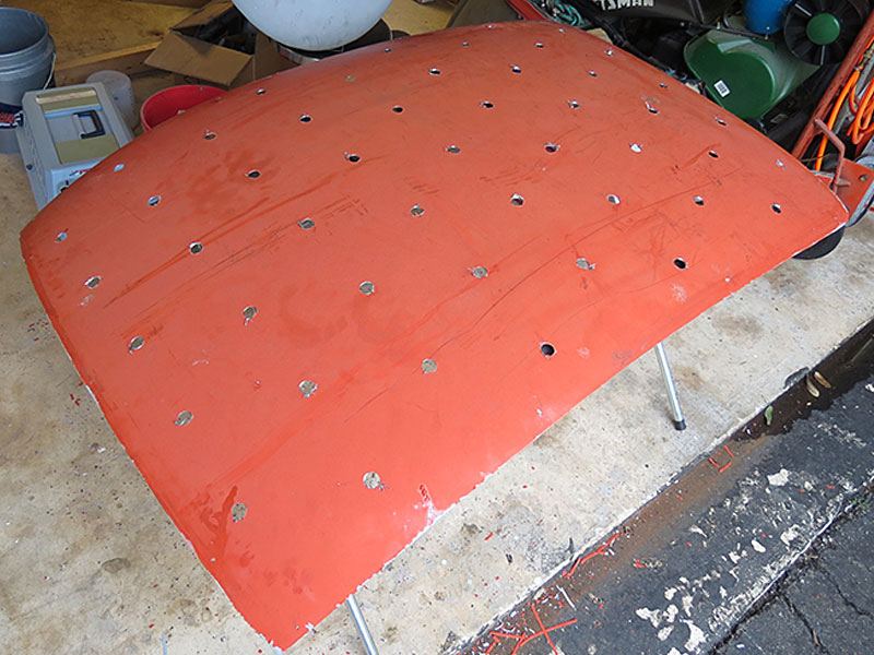

Then make a few thousand calculations and plot out your design...
Then begin to drill a bunch of holes...
After that you can take the can cutters and punch them out larger...
By the way the Hydraulic Press is probably the BEST and WORST tool you will every own.
The BEST because it allows you to do stuff like this and the WORST because it allows you to do stuff like this...
Then it is time to break out the Dimple Dies and go to town...
Walla... the worlds largest cheese grater...
Now place it back up into the car and have a look...
Now Nut-Sert the tabs and put the panel back in....
There you have it a one-off custom headliner that takes a ridicules amount of time to create...

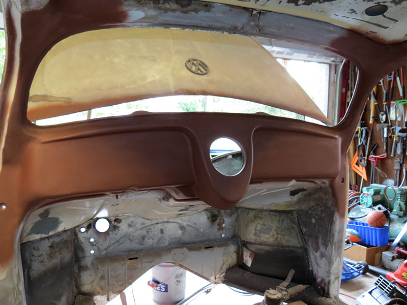

When The Dust Clears
So for the past two weeks we have been getting all of the major body work done to the interior of the car making sure that all of the panels are cleaned up and filled in so they are ready for final prep before paint.
Since we are not running a typical headliner you will see all of the metal inside so you can't half-ass it, you don't realize how much a headliner and all of the trim pieces cover up all your mistakes.
So we begin to work on the rear interior C-pillar to clean it up. First we grind down all of the welds.
Then we begin to apply several coats of Dura-Glass to fill in all of the big areas.
Then it's time for Body Filler then sand then more Body Filler then Sand then... well you get the idea.
We also took care of the B-Pillar post at the same time.
Then after hours and hours of sanding the rear sides of the interior are ready for final prep and paint.
Then we started to work on the A-Pillars since we had to modify them during the chop.
Again after lots of grinding, filling and sanding the front section is ready.
We began to strip down and fill the inside of the trunk.
And now it is ready for final prep and paint.
We then turned our attention to the one thing that was going to take the most amount of time... The dash on this car has a multitude of compound curves along with flat panels and on order to make everything look right we had to fineness everything to give off the subtle curves.
Again first off we began to grind everything down.
Then it was on to several coats of Dura-Glass.
After that it seamed like endless coats of Body Filler and sanding to get everything as smooth as possible.
The dash is now ready for us to do the final prep and get all of the custom trim pieces in place before we paint it.
You can see the clean transition from where the vents were into the dash.

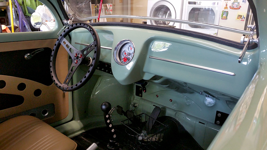

Now that the bottom half of the car is done we can start to work on other areas of the car.
We wanted to finish up in the interior of the car while it was still up on the high stand and easy to work on. The back end took about three (3) weeks to grind down everything and fill panels. Since everything is going to be exposed on the inside we had to smooth out everything inside as well, including the little tabs that run along the side of the back window to hold the headliner in. There is so much work that had to be done to the inside that is normally hidden when you put a conventional headliner in.
Then it was back to work on the dash, doing a semi-final finish. We still need to prep the dash for the trim pieces but it is starting to take shape.
Removing the defrost ducts really helps the smooth look of the dash.

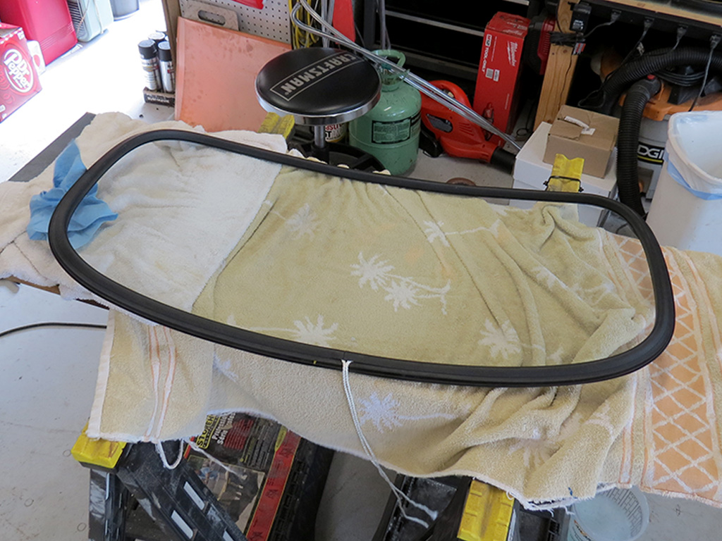

So we have been working on the safari windshield for a couple of weeks now and the fame for the most part is done, so we began to focus our attention to the hinge issue. We did not want a piano hinge that you can see from the outside so we had to create a hinge that would be mounted from the inside.
Since this is a 1962 body that (well lets just say has been heavily modified) we just couldn't buy a safari kit and adapt it for our needs, so we began to draw out and test some designs and we came up with a hinge that is recessed into the top header panel and swings out to clear the body as well as the windshield rubbers.
We set a test windshield rubber in place to make sure the hinge clears.
With the hinges held in place with clekos we can now cut the hinges down to size and then we will begin to build the tabs and adapters so the hinges can attach to the frame.
We cut the windshield rubbers and set them in place so that we can test fit the windshield and set the tabs up for the hinges.

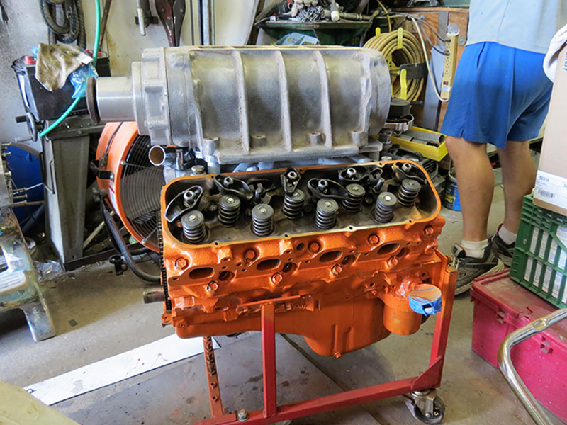

So we decided to take a little break and play around with one of the Big Block Motors that we had laying around. Just one of the many projects that keep us busy. We needed to drop in a new cam so we broke out the super high-tech cleaning ram and began to get the motor prepped for the new cam.
After everything was cleaned up it was on to installing the new cam.
After the new cam was installed we decided that this motor needed some serious fucking horsepower.
OK... Maybe it's a little Overkill!!!
Lets step it down just a little with a smaller blower. This one should keep us from killing ourselves.
This is just for mock-up we still need to add the carbs on it and that will raise the intake even higher.

First thing we wanted to work on was the headliner so we could get it out of the shop. It takes up a lot of room that we could use to work, so time for it to go.
First thing was to strip it down to bare metal and then shoot it with an epoxy primer.
Then shoot the base on it.
Then the clear. This thing really pops when the light hits it, Too bad the car sits so low that 90% of the people that ever see this car won't even notice it unless then hang upside down to look up.

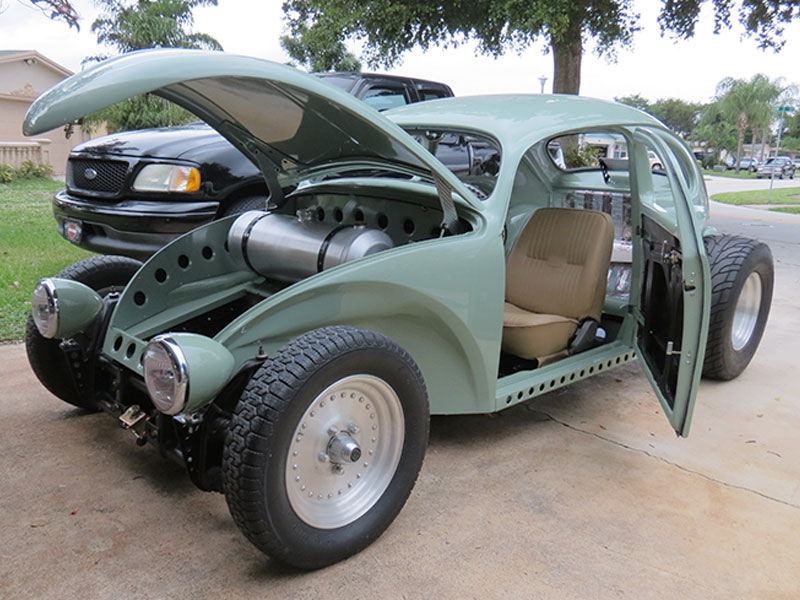

Once at the house, we unloaded the body and set it on the ground.
Then we began to get everything ready to mount the body onto the frame.
With the body setting on the frame we began to bolt everything down. This is one of those moments where we had to make a leap of faith since we made some modifications to the body and also the frame since they were separated for the past couple of years and we were not sure if everything would line back up.
Believe it or not the only thing that we had to adjust were just a couple of openings on the body since we made all of the mounts not taking in consideration for the pan seal gasket (and also the fact that we put a 1962 body on a 1972 I.R.S. chassis). So as usual we made our adjustments and moved on.
With everything bolted down it was time to add the rocker panels and then drop the car back down on the ground. It's starting to look like a car again.
We still need to lower the rear end quite a bit so that it doesn't look like a Baja.
Bolted the headlights on to make sure all of that lined up as well. Still need to wire up the buckets and figure out the inner mounts, but that will happen when we wire the rest of the car.
The rear lights came out pretty nice with the mounts.
Set the inner panel in place just to see how it looks. The logo is actually raised from the panel less that 1/16" so it looks like it is floating.
Then we installed the steering shaft.
The steering column was then set in place. You can see the polished shaft so that it stands out inside the column.
Also installed the shifter that matches everything else in the car.
Then it was on to putting a seat in just to make sure that all of this would actually work. (yes my fat ass actually fits in the car )
We also made the switch console so that we can add all of the controls. we still have some modifying to do to it but it will be tucked in between the two seats so that the dash is completely bare except the center gauges. Clean & Simple.

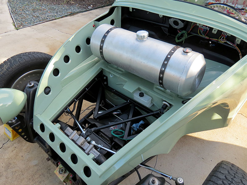

We finally put the motor back in this thing after installing the new clutch. So far everything fits so now we just need to finish wiring this thing up so we can fire it up and see if it actually works.
We even put in the gas tank to make sure it still fits as well. We still need to run the fuel lines from the tank but at least we can get an idea of were everything is now.
I am going to have hours and hours of fun cleaning the tank and re-brushing the aluminum.

Then after endless hours of refinishing the tank we dropped that in as well.
You can see all of the lines in place. We need to change out the bulkhead connectors because we weren't happy with the way they were working out but they are on order and will be changed out soon.

I installed one of the seats so that we can start to make adjustments for mirrors and door panels.

We installed the rubber gasket to the rear glass and also inset the rope so that we can install it.
We also installed the rear carpeting for the car. This is the only part of the car that will have carpeting.
It took us a while to install the rear glass but it finally went in and it looks really good.

After working on the design for the panels I began to layout the design on the outer panel. The rear panels are made in two pieces, the inner panel is steel and the outer panel is made from 1/8" brown board (peg board without the holes).
Then after all of the cuts were made to the outer panel I sealed the inner steel panel so that it would not rust.
Then I wrapped the inner steel panel with a perforated black vinyl and the outer panel with a weathered tan vinyl to match the seats (wrapping the vinyl around the curves and into the holes was a nightmare).
Here is a close-up of the two materials together.
This is what the panels look like installed into the car.
