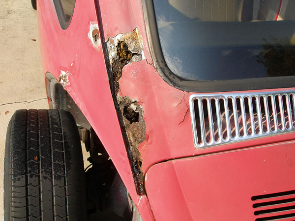

Back to work on the passengers side heater channel, after replacing the heater channel we decided to replace all of the lower metal on that side as well.
Another nice big hole to fill - the bottom end on this car is being replaced with all new metal- no more rust.
OK - I have to rant a little, it is amazing what we have found on both of these cars since we have been working on making the Volksrod.

Sorry... I had to vent. OK back to the build, the back panel has been cut out to be replaced.
This is what was cut out. More rust...
Fabbing up a new piece.
A little welding and good as new.

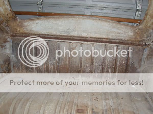

Posts: 6,296
Default Re: Fernons Chop
Car looks great.
Would it be possible to see some pics of the firewall inside and out ?

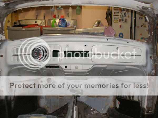

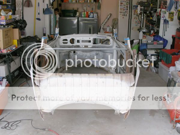

Old July 18th, 2008, 06:14 PM   #44
Posts: 758
Jon - Here are the firewall shots
We haven't really worked too much on the inside yet and we are not sure of how we are going to finish off the firewall and package tray area yet (I really like what Bulldog did with the curved sheet cover - although I really like what bulldog has done with everything on that car) but I am playing around with some Teak and Stainless finish too...
Here is the cut firewall.
Here is the firewall tacked in.
The top strip tacked in.
Someone also asked if a 5" Monster Tach would fit in the speedo opening - YES!!!
We are still not sure what we are doing with the dash yet???

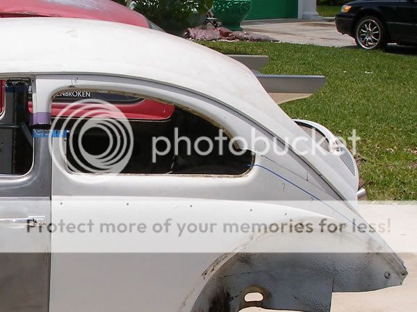

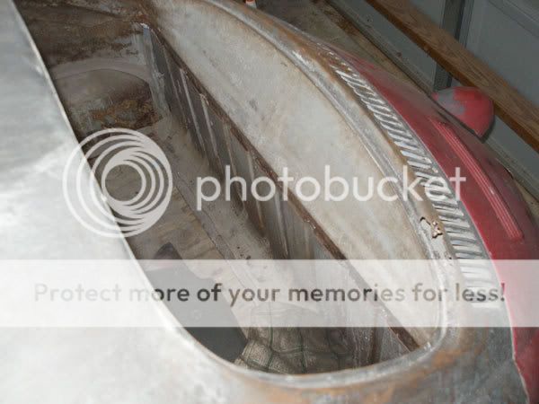

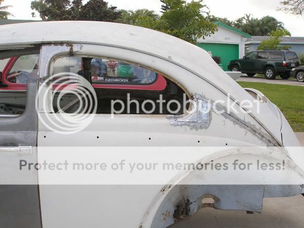

Old July 25th, 2008, 06:51 PM   #47
Posts: 758
Firewall Follies
Jon, there is really no simple answer to that question, but I will try to do my best to explain what we did.
First we cut the firewall about 2" from the top of the lip that rolls over on the firewall. You can also see where the roof will sit inside the openings that were created from removing the roof.
Here you can see the blue line and the many question marks on the side of the car. This is approximately where we wanted to end up when we where done.
(Major note here, in order to avoid the wedge look of a typical Capella Chop you need to trim and adjust, roll it outside and look at it from all angles, then trim and adjust then... well you get the picture)
We took approximately 2" out of the back end and moved the roof forward about 2" to meet up with the initial 4" taken out of the A Pillars. Remember the only measurement that never changes is the A Pillar cut everything else is trimed to fit the look that you are going for.
Here you can see after everything is cut and put where it needs to be the back end begins to take shape
Here you can see that the firewall (A) actually sits in front of the window deck (B) even after the entire roof was moved forward 2" (Try and figure that out!!!) actually since the roof has been cantered and the roof also sits inside the body it actually winds up behind the firewall, thus making it easy to fab up an enclosure for the back end.
I hope that this explanation helped you and everyone that reads this, but more than likely it just raised more questions. Hell everytime we figure one thing out, something else happens and we start all over again, that's what we are all here for.
(Cut, Weld, Ask a Shitload of Questions, Drive)
Old July 25th, 2008, 09:05 PM   #48
Location: North Florida, Jax to be specific
Posts: 6,296
Makes perfect sense to me. I had already gathered the roof fitting into the firewall like it did. I was just missing that all important 2" part of the equation. I would expect there to be a cut, trim, adjust, cut trim and adjust again....... method to this kinda chop and would have no problem doing so.
My plan originally was to either do the Capella style tilt but not cut the firewall loose or just cut it out go for it and then piece it back in afterwards in one trimmed piece.
I like the look and proportions to this one, and was half thinking that maybe tacking the decklid in place while doing this might help get the look right if I were to vary more or then you did on your chop. But genrally on a early body 4" seems to be the magic number.
