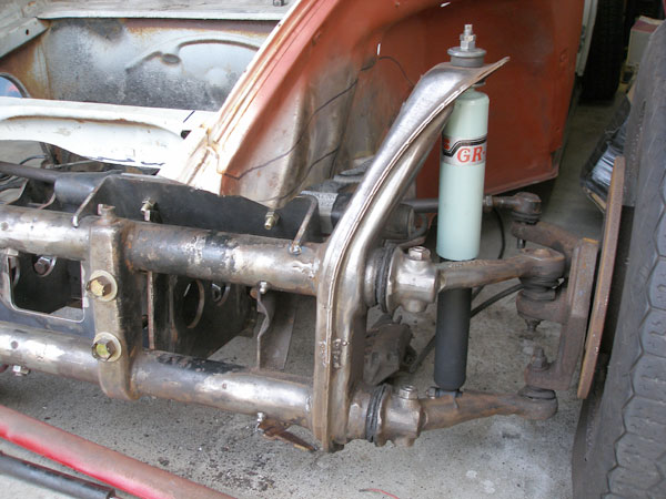

What would you do with an extra 10-1/2" Inches?
Yes kids that's right not 8", not 10" but a whopping 10-1/2" inches.
Just so that we can say I bet you never seen one of these this big before…
OK, like I said, the Evil Metal Genius really outdid himself this time, he went ahead and fabricated a 10-1/2” beam extender for the bug.
As usual, we pulled the beam off the car to find more rust and more holes to fix.
The Evil Metal Genius making some final adjustments to the beam. Notice the OSHA squint.
Doing some test fitting before its all welded up.
Old January 1st, 2009, 04:21 PM   #68
Posts: 758
Default Re: Fernons Chop
Let's see you make it fit Smart-Ass
So now that we have the beam extender we have to see if it all fits under the hood
A little cut here, a little cut there and what do you know...
That steering box is going to have to go.
Looks like we're going to put a rack and pinion set-up in here so we don't have to cut the hood!!!
Yes, we do have top and bottom plates for it, we are just test fitting before we weld it all up.
Damn That's Sexy, Now we just need to weld it all up.

OK, so the beam extender dropped the front end down another 2" but the car still looks like a Gasser, so once again the Evil Metal Genius does a Cut and Turn and now it has the right stance.
Before the Cut and Turn.
After the Cut and Turn. What a difference that made.
It's starting to all come together now...

Hey Fernon,
You've gone this far.........I think you would be happy if you and the genius would cut the humps (smooth out) out of the front fender wells. The car looks great !
James

that is nice... I had to channel the front of the body on mine to get it to hide the beam like yours. It looks great when you can get the hood to almost touch the ground!

Hey Babe Nice Rack!!!
Well we finally got the rack and pinion set-up tacked in and it looks and works great.
It is a Wright Rack and Pinion, it is super simple and very strong, but very hardcore, probably overkill for our purpose, but what the hell everything else we do is overkill.
Again everything tucks up under the hood nice and neatly.
Old January 4th, 2009, 10:36 AM   #74
Lookin' great man!! Any reason you didn't mount the Wright in the center?
Old January 4th, 2009, 11:03 AM   #75
I would definitely mount it in the middle, so the tie rods are even lengths.
