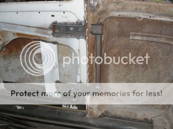

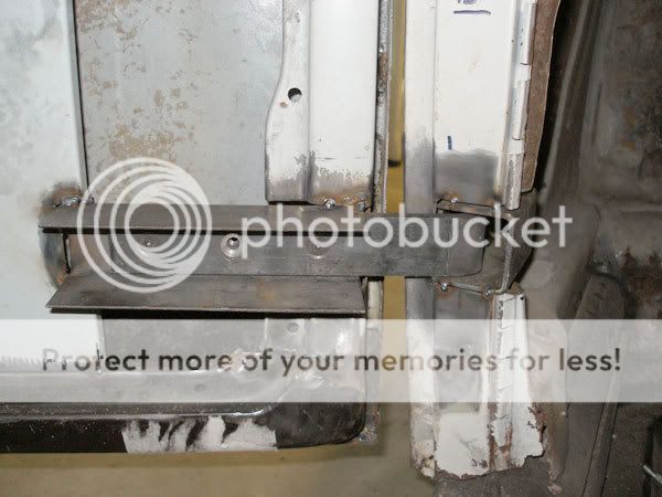

Remember, it takes twice as much work to make it look easy.
Just like all of those Ass Clowns on TV, there is a lot that you don't see that happens behind the scenes. So here are some shots of the hinges on the door, keep in mind everything is just tacked in right now and not cut down, this is our test door (Passenger side) to see if everything works out before we mangle the Drivers side.
We also added some bracing to the inner door panel so that we had something to weld the hinge to.
This hinge system is a dream to work with, the tops and bottoms are connected so you don't have any twisting when the door opens and the action on them is smooth.
Close-up of the top hinge in the door.
Close-up of the bottom hinge in the door. the hinge doesn't sit very deep in the door so extra bracing is required.
