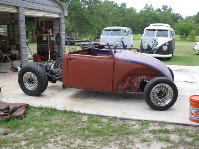

Thanks Hoosier, gotta take some time off for the Memorial Day holiday too. I was lazy and stuffed up for 2 days, so I got out there in my garage today and sprayed some paint, got almost done and saw 2 runs. Knew I shoulda hooked up that shoplight. Luckily the runs are on the side facing down. Also measured to make sure the T4 would fit in the rearmost part of the bed of the RPU, which has a rear brace at 18-1/2" from the edge of the transaxle. The dipstick and the distributor are at 17" so it WILL fit. Carb and manifold sit high, the carb measured at about 12" from the same point....wheeew. All that'll show under the edge of the pickup bed is the cooling metal, fanbelt/pulley and exhaust. Tight but functional.

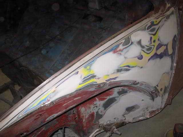

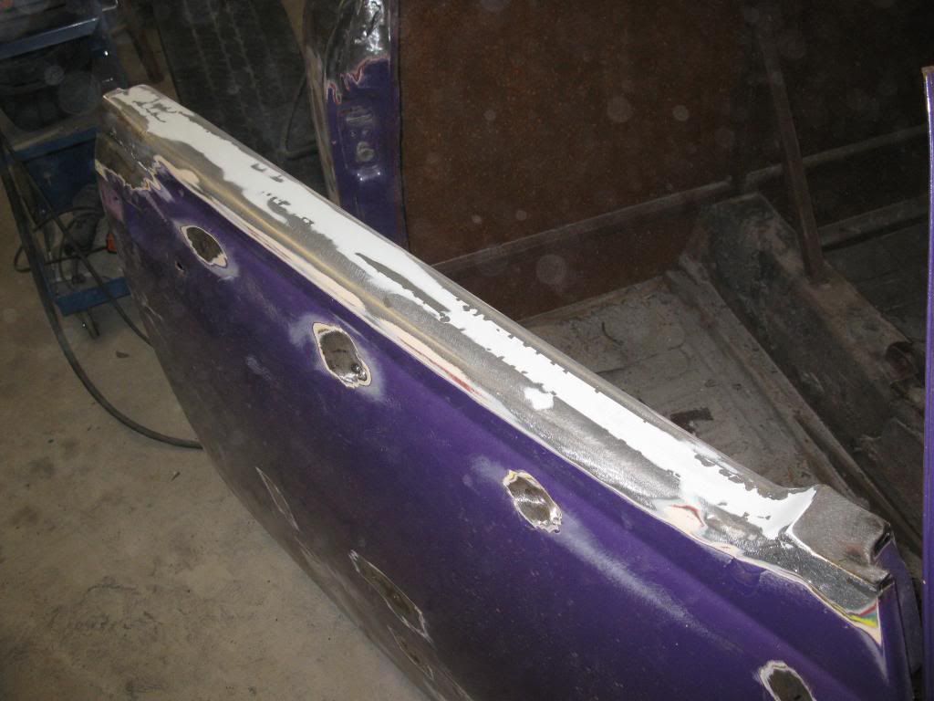

OK, first off, let me say that there will be no more updates this week. Zim, you can have Friday off b/c I'm done for a while. I got out there today and was ok until I picked up the cut-off wheel and then the DA. Bad idea!!
Anyway, I'll pick up some filler this week and you can just pay me for it next time. I'm ready to get the passenger door finished and move on. I still have to weld a couple spots on it (the primer shows them very well).
I'll sand it clean again and smooth it out at some point.

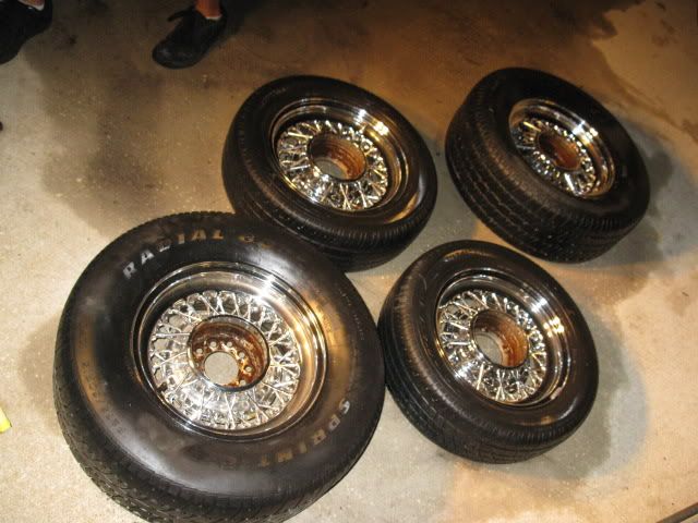

Old June 11th, 2010, 08:00 PM   #32
Default Re: Zim's RPU

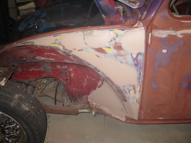

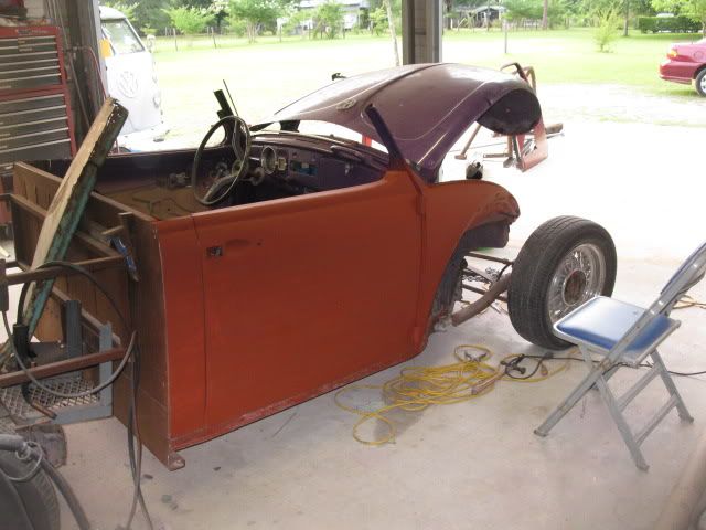

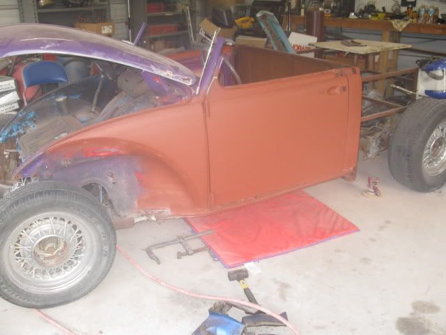

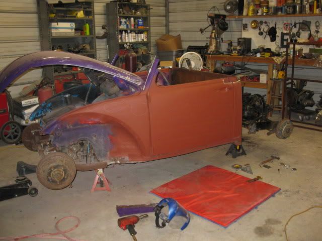

Zim came up today to do a few things to his volksrod. The bed came off first and then Zim took off the old air shocks and rear brake lines. Then he worked on the looks of the rear suspension, pan, trans, etc.

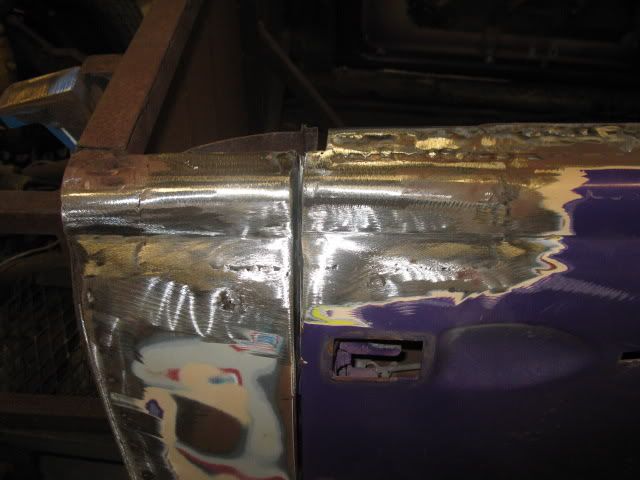

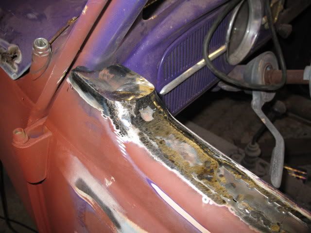

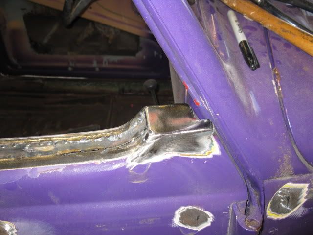

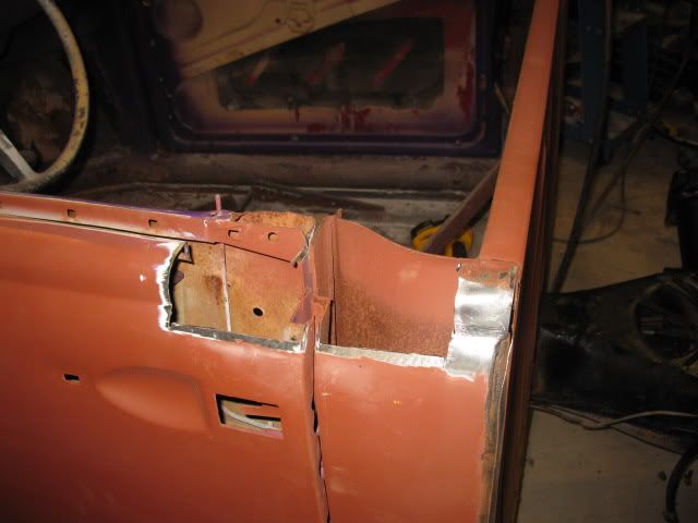

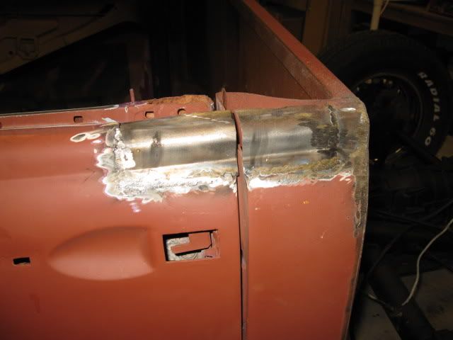

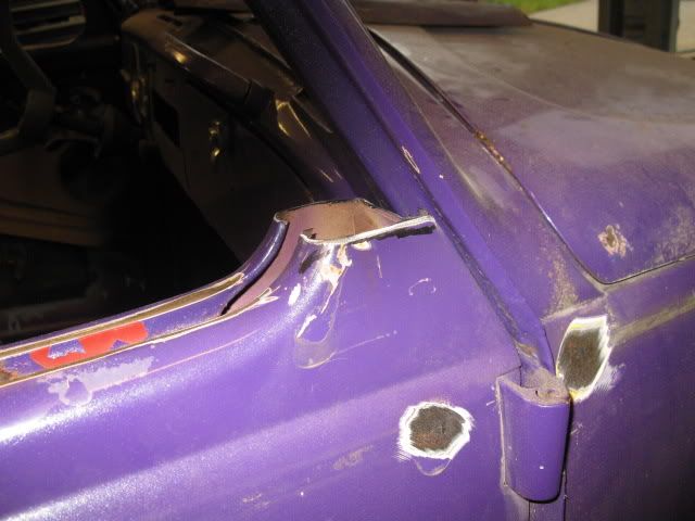

I cut up some of the driver door & B-pillar area and made a new piece there. I decided to weld in one long piece instead of two and then cut it but I ran into a problem. The rear of the cab is not square so I have more work to do there. I also cleaned up some of the welds on the rear of the cab and sanded it down some. I also realized both rear drums were loose and had wire or a clip stuck in the hole instead of a cotter pin. I torqued them up and put a cotter pin in one, still have to find another. I started removing the defroster vent from the dash when I stopped screwing with the mis-aligned B-pillar. I hate fixing other peoples crappy work. The right side b-pillar is pointed straight forward, almost 90°, the left is pointed to the left a few degrees so it made my patch piece not line up right.

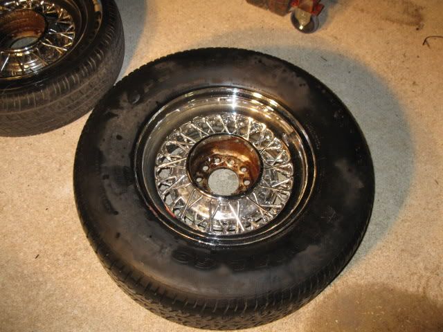

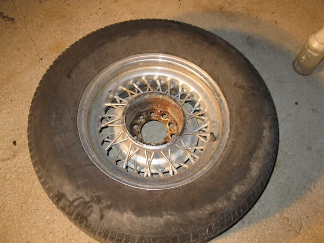

All four wheels came off and got an acid wash. Three of them might polish up but one has some chrome peeling.
Some pics from today.
Zim's paint job
...more and some cab back cleaning
door cut out more
don't actually have a pic of the patch piece yet?
how it sits now
left rear wheel before
left rear wheel after acid wash
*wheels thanks to Keven's Mobile Detailing

Yeah, my buddy Keven came by and just happened to be in his work van so he had all his stuff with him. He did the acid wash but didn't polish them or anything. Oh, he lives and mostly works out of Gainesville. We were out there until a little after 11.

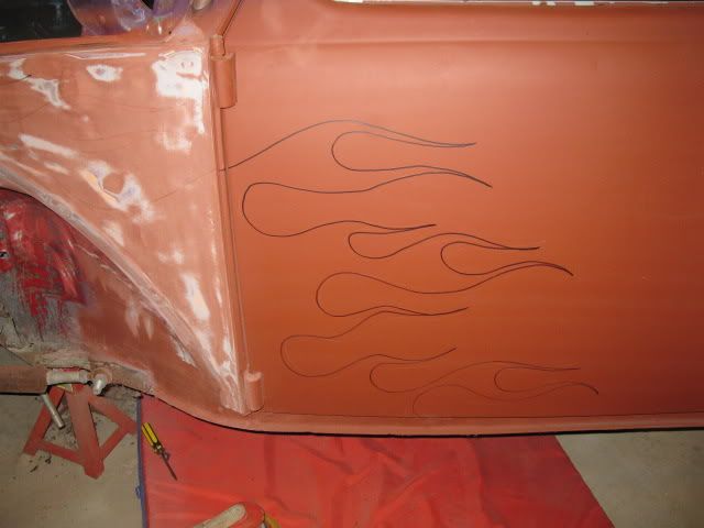

The cheap paint didn't really look as planned so Zim started prepping everything for something different.
the pic I forgot to take last night.
my son started cleaning up the wheel wells
some sharpie flames

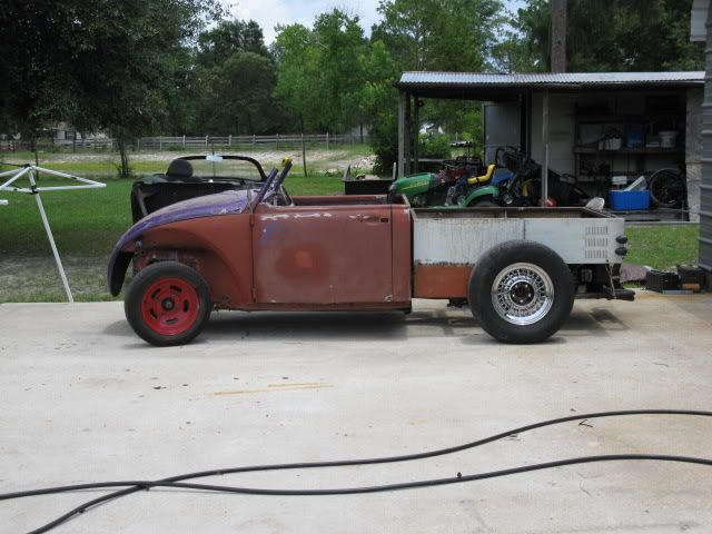

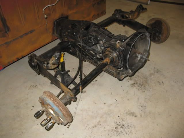

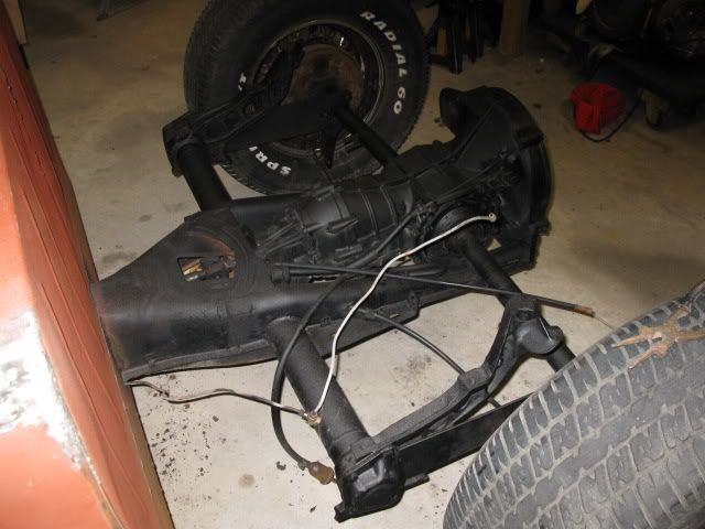

I put the wheels back on the RPU and pushed it outside this morning. I sprayed some degreaser on the rear of the chassis and hosed it off. Zim towed the black car up here today. I took a pic of it with him in it so you'll see why he calls it the Lil Bitch.
Old June 20th, 2010, 06:20 PM   #36

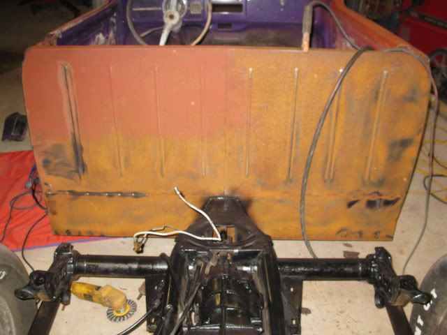

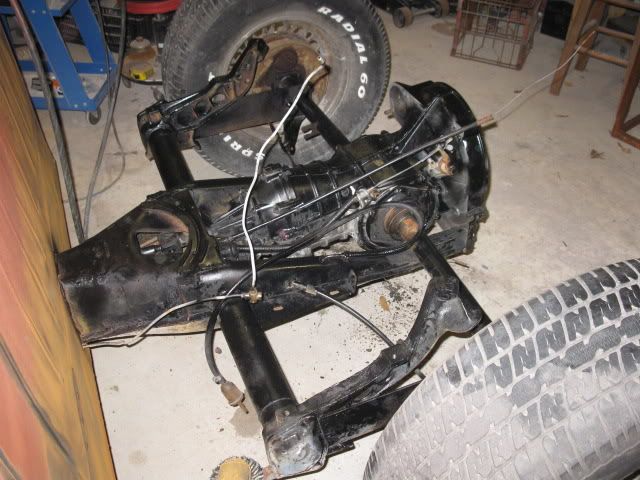

I got a few minutes after dinner to tinker in the shop a little. I welded up a few spots and tried out the flat black on the rear of the chassis & transaxle.

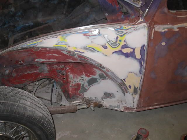

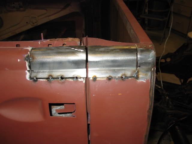

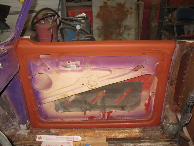

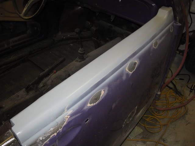

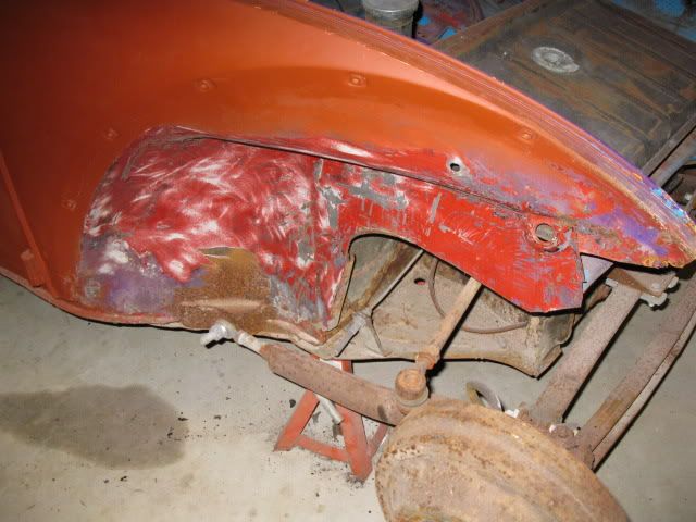

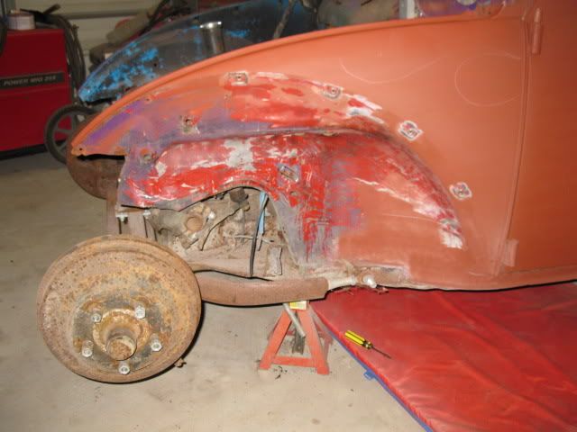

I started capping the driver door. I also put the front on jack stands again so I can work on the fenderwell. My ADD kicks in and I never know what I'll work on.

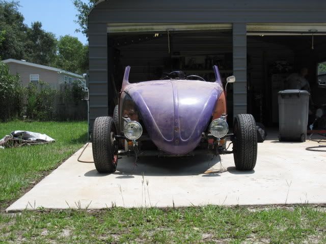

Old June 29th, 2010, 01:07 PM   #41
I didn't think about keeping all the pics in one album so HERE are the Garage Thrash pics and HERE are the rest of the RPU pics.
I can't wait to see it with the wheels pushed out again and the front lower.

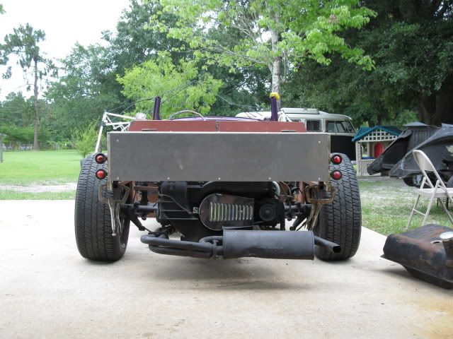

Ok. Im not all that bright. But with some good fenders....
Dually!!
haha...
Anyways. Is the exhaust stayin like this?

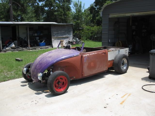

Old June 29th, 2010, 01:51 PM   #43

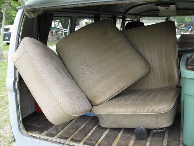

A few random pics
the seats that we're using

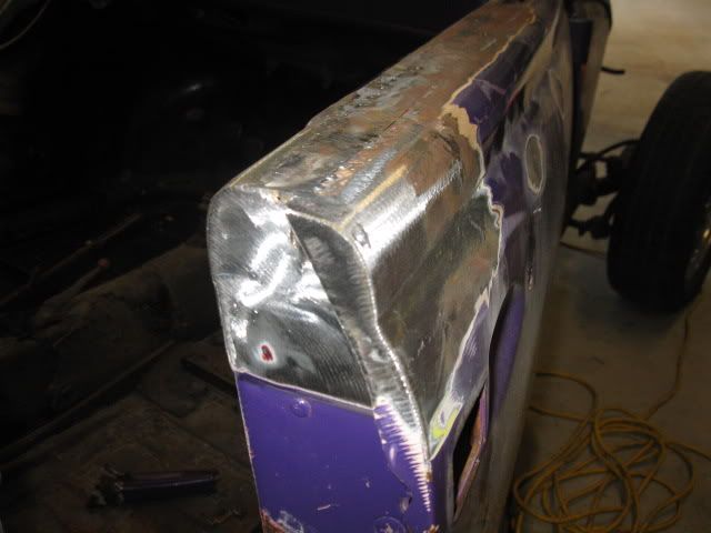

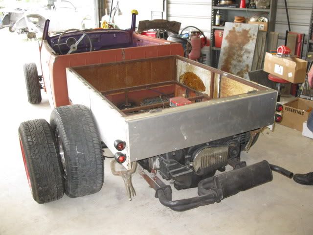

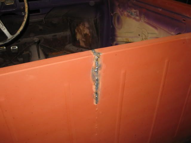

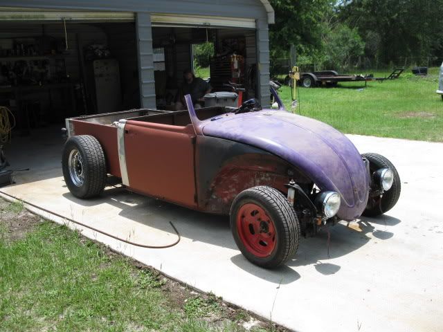

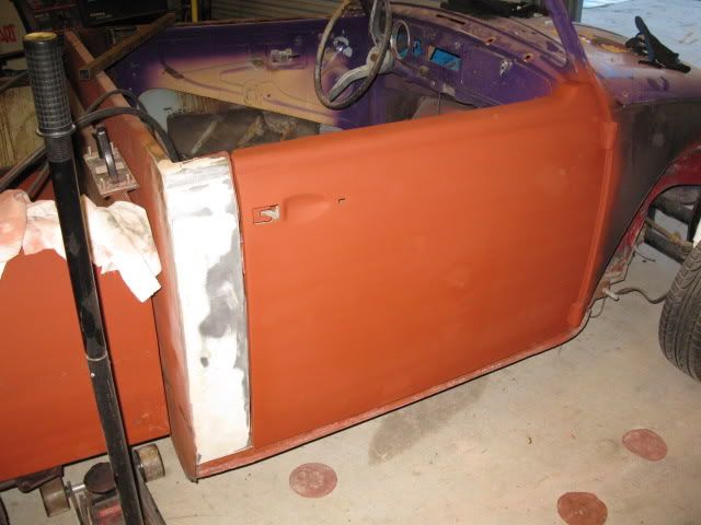

Just a few pics. I had a few minutes to work on it the other day. Hey Zim, that filler you bought is hard as hell to sand...same brand as the stuff I bought that I didn't like. Anyway.

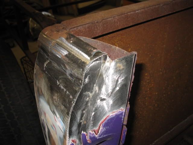

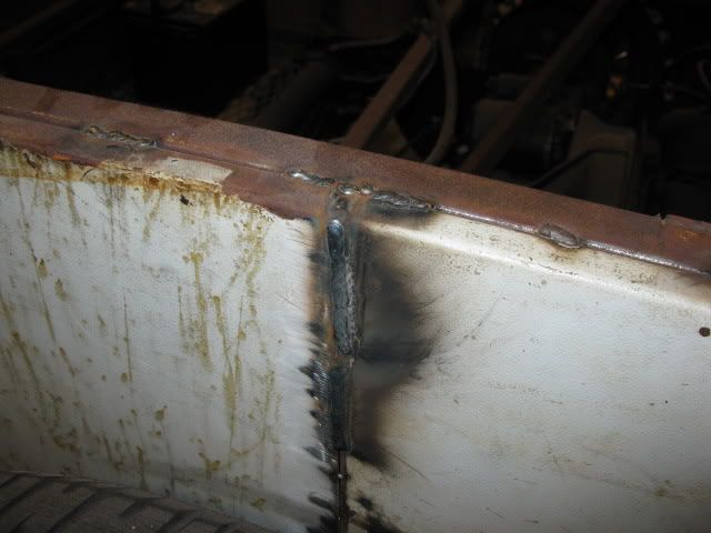

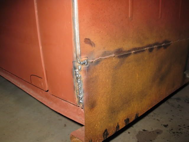

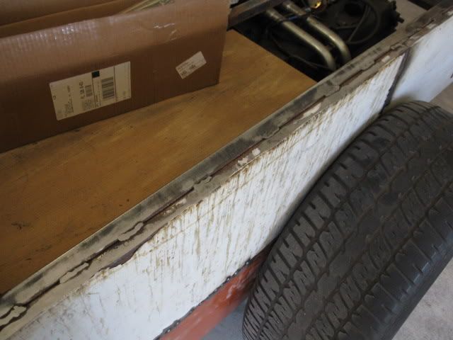

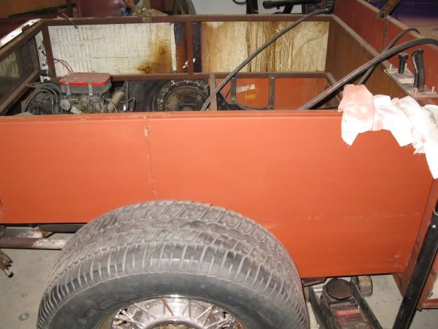

started welding the bed sides (will jack this side up to finish welding, other side done)

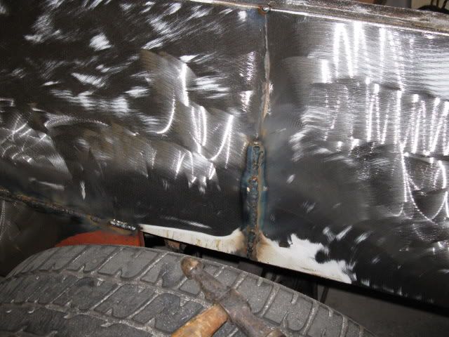

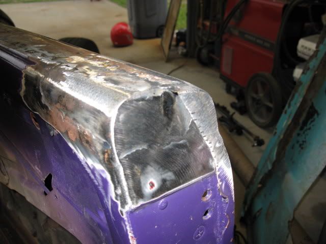

welded the right side bed seam and stitched some across the top, still have to grind. I also took all the textured paint off this side (except around the vents)

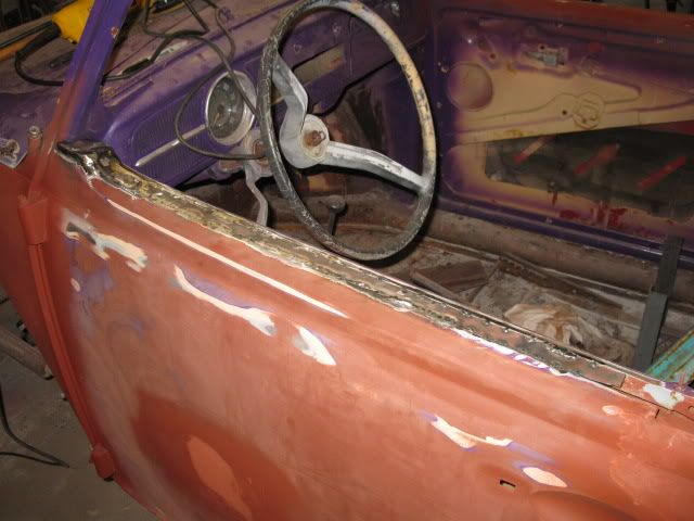

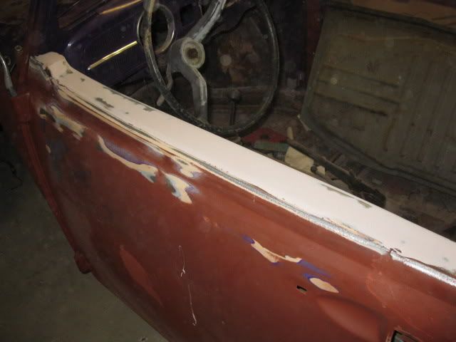

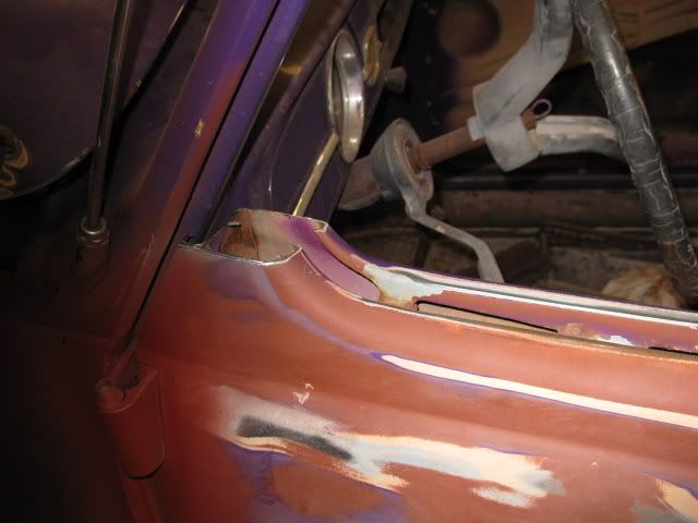

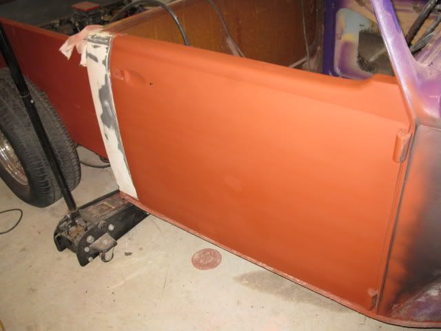

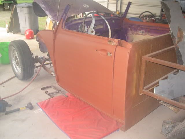

I pretty much finished the passenger door. It will still need a little putty in a couple of spots and some finish sanding but I'm done with it.
inside too!

Old July 10th, 2010, 11:18 AM   #45

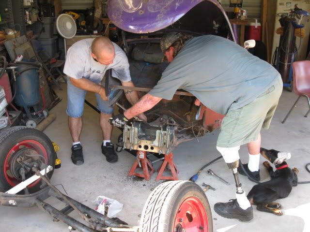

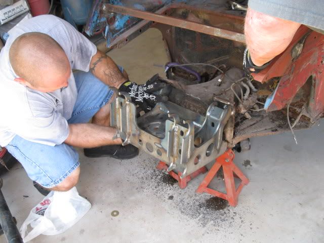

I slept in until 8:30, got up and Zim and Brian (dragnbdy) were out in the garage.

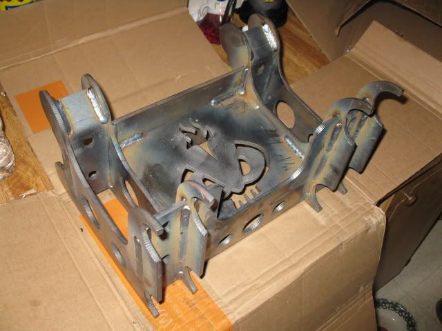

First off I want to thank Doug (dbug41) for donating one of his killer extensions to this project.
I should buy stock in whatever company makes the tape he uses to pack them up. It was sitting here Wednesday when I got home from work. I've got to say, it's a good design and the craftsmanship are top notch. All the welds look good as well.

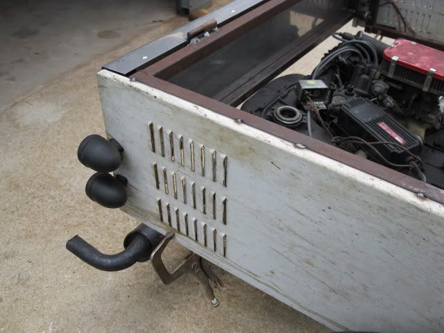

By the time I rolled my lazy butt outside Brian & Zim had the beam off and was fitting the extension. Brian had already drilled out the framehead for through bolts. We did have to open up the holes on the extension a little to get the bolt through but other than that it went right on.

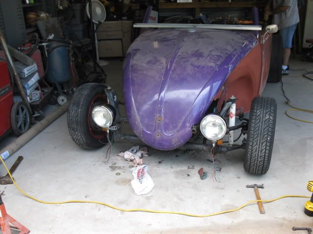

We got the hood mostly notched (I will trim it out later) and the steering hooked up and working. I didn't get any pics at the time, too busy working on it.

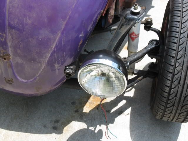

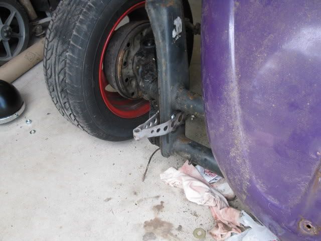

Brian tweaked the headlight brackets and I welded them on. Brian trimmed the rear afterward.
Zim got ahold of a grinder and started grinding down the welds on the bed sides.
By this time it was getting pretty hot so we called it a day. We did manage to get my wife to go get us some subs for lunch. Finally, we pushed the rpu outside for a little sunshine.
Don't worry about the stance. We'll get that dialed in once the right tires are on it and the seats, gas tank etc are in.

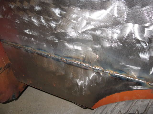

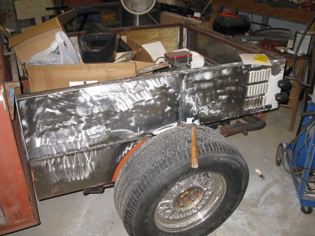

I went back out after dinner and did a little more to the rpu. I welded the left side of the bed, took off most of the textured paint, welded most of the left door top, ground it down, cleaned the paint off the dash areas that will get welded and put a layer of filler across the door top. I hit that with the DA once. I still have a little work to do at the back of the door and then I'll put another coat of filler on it.
