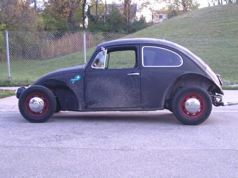

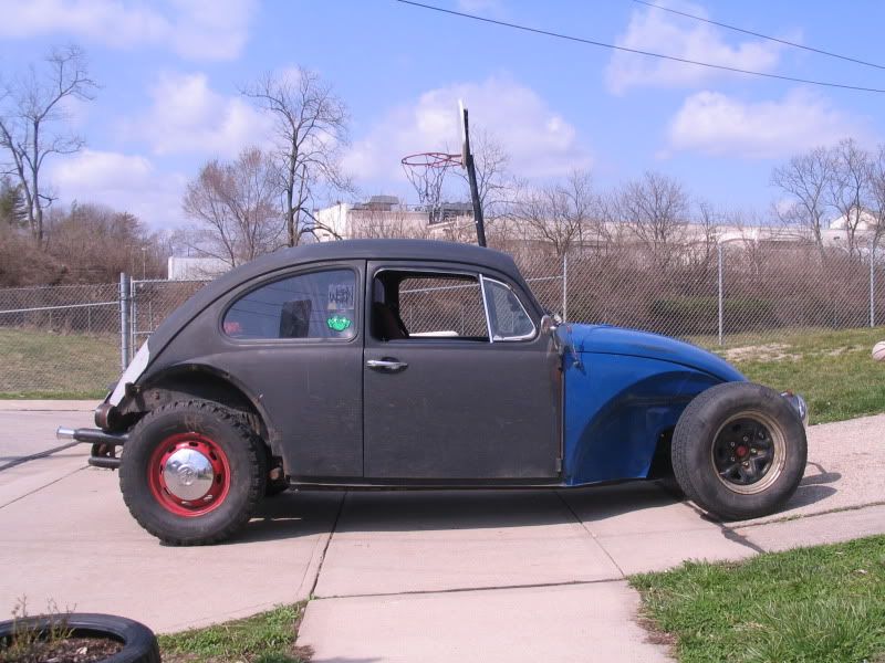

This next picture shows how far the front beam was cut and turned by the P/O
This is an uncut beam which I did go ahead and put on, raised it up by almost 6 inches
After the uncut beam was installed
Before switching the front beam with a pop can to show how low it is
After switching the beams
It has settled down a bit and I took off the coil-over shocks as well which lowered it another inch or more.

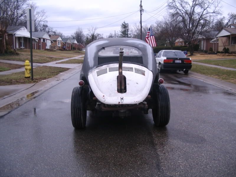

Rear fenders added because the Law pulled up next to my Bug while I was in the store, he told me that he has seen me driving it more and more so I should put some kind of fenders on it unless it is just a weekend nice day driving car, so since it's gonna be my daily driver I added the rear fenders
I still need to do something to fill in the apron gap, not sure just how I'm gonna do it yet

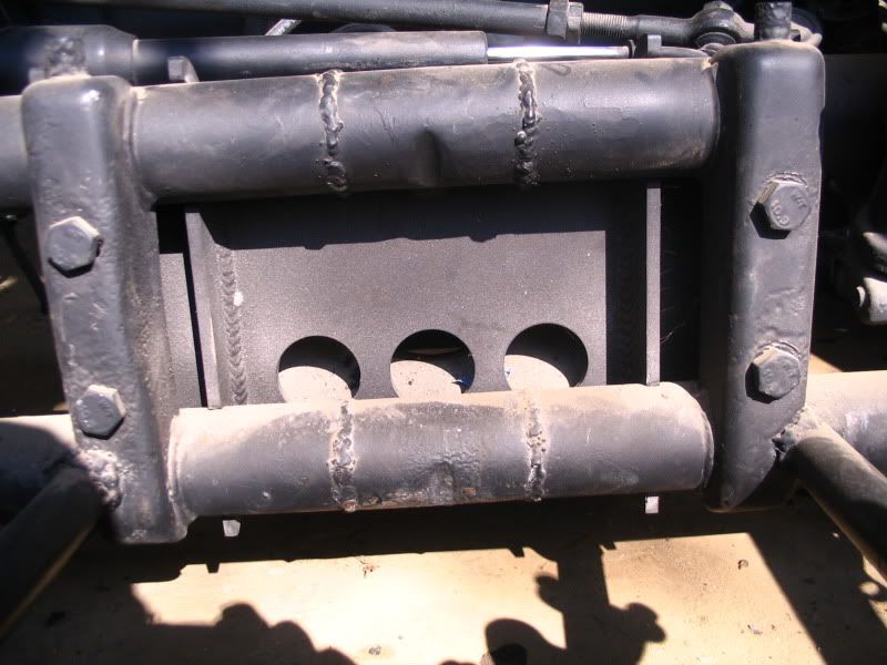

Front apron

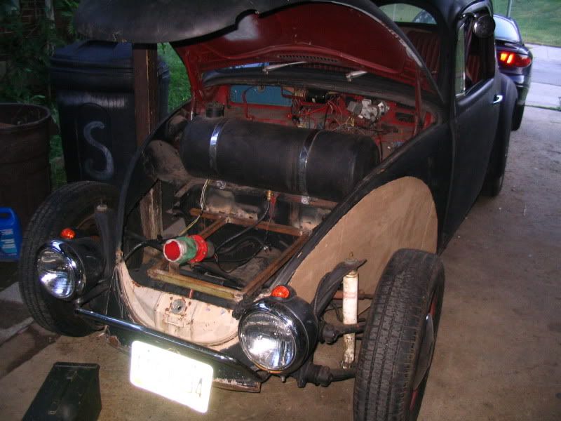

Beam bracing and front body mount, still in the works
Front wheel wells with cardboard patterns, hope to have enough sheet metal to do both sides (I may hafta use the 2 Honda Accord hoods my son has sitting here), if not I can just enclose the front section so it's much more rigid, I can do the fender wells later

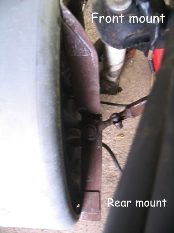

Made my fender brackets over the weekend, mounted them on and turned the wheels side to side and made sure nothing was touching, did a small amount of grinding a bit off to clear the left tie-rod
Yesterday I went for a ride and had no troubles with them, now to mount the fenders to the brackets
I think I'm just gonna weld the same angle iron pieces onto the fenders then drill and tap some holes and use some flat head screws to screw them to the brackets
I'll post a few pictures at the end
The fender brackets which still need top be cleaned up to look good, maybe I'll put some light'nin holes in em
The fenders are just resting about a half inch above the tire on some pieces of wood
Still not sure how far forward or back to mount them, guess I'll go sit back and see what looks the best, then put them on and see what happens
Fenders are resting with brackets in place
They need a bit of adjustment, but I think it's gonna work

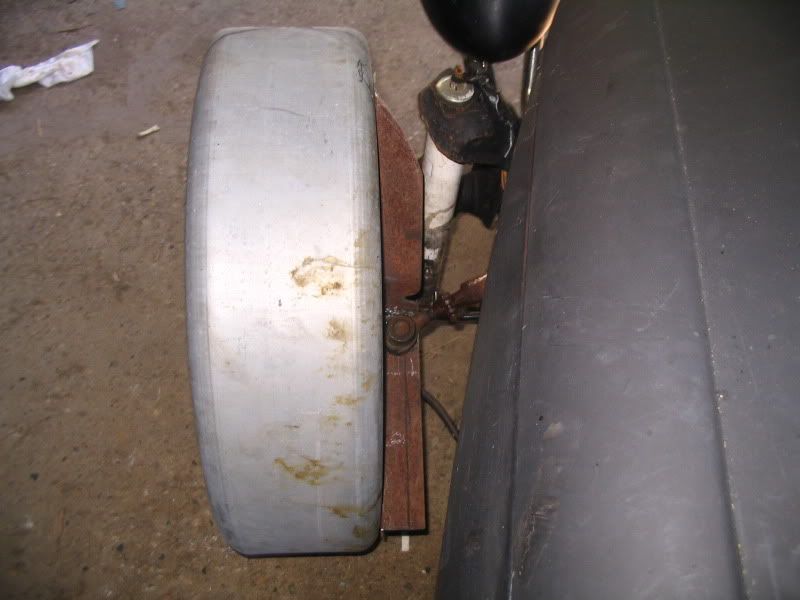

So this morning I spent most of my time doing things around the house, then I went out to make some fender mounts, drill some holes, and tap them
I only got the left side finished and mounted on the car, it looks purty good altho I'm still up in the air on whether I wanna round the front edge of the fenders because they are completely square except they have a radius on each corner, I'll just hafta leave them go for now
If it starts to annoy me I'll just round them up a little bit at a time until I get them to my likening

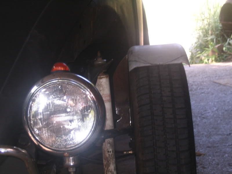

OK here's pictures after I mounted the tabs on the left fender, drilled and tapped all the holes, then painted it Black
Here both fenders are sitting where I want them, the drivers side has 1/2 inch space between the fender and the tire
Here is the left fender with brackets welded to them, then I will bolt them to the brackets that bolt onto the steering spindles
With a bit of paint on them

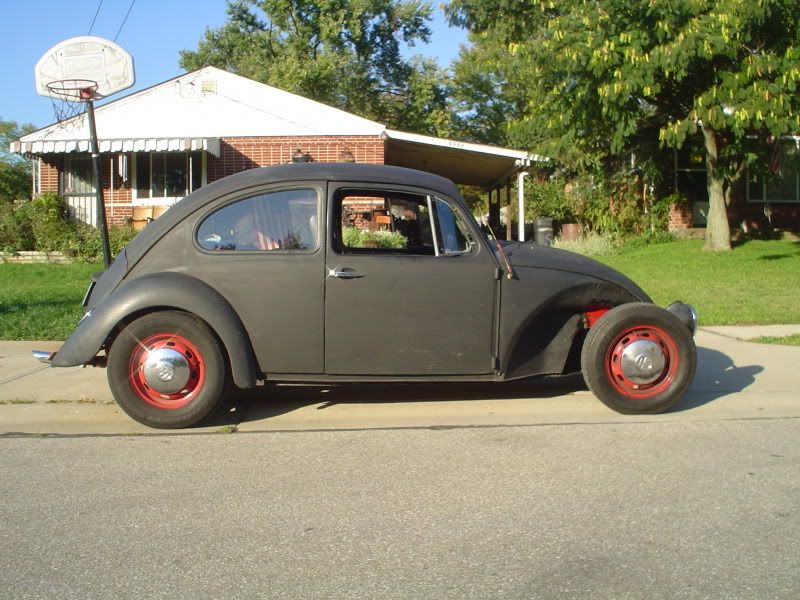

Got my hands on a set of lowered spindles and put them on Friday afternoon, took it for a drive that night and it sits about as low as it did when I first got the car which had the beam cut and turned about as far as it possibly could be turned while on the car, the ride sucked as it bottomed out having maybe 2 inches of suspension travel
I put a stock beam back on with no adjusters, it was only lowered with the beam extender which I believe was made by Tin Beater and sat up purty high
well now it sits real low, my tag drags the ground and hits all the speed bumps as well as the curb when pulling into my driveway
Well here are a few pictures showing ride height using a Mt Dew can
The 1st is when I got the car, then after I changed beams, and finally after the lowered spindles were put on this past Friday
I don't think I'll need to drop the body down much except in the rear, I may just get away with turning the spring plates a few notches and then get some taller and wider rear wheels and tires and it's ready for a Top Chop

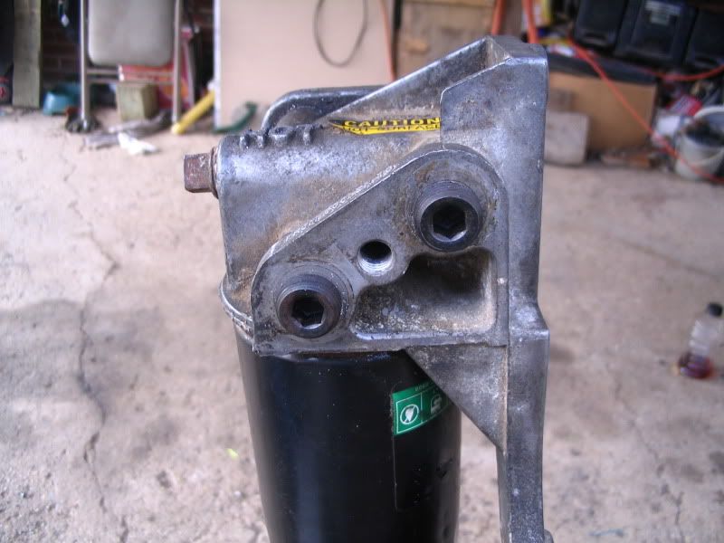

The next thing I did was to get my brakes working better, I put the front disc brake setup I had from my Rail Buggy onto the V-Rod back in March when I started driving it, I had to push the pedal real hard in order to stop, after a few months I had to do something about it
So I put a larger bore master cylinder (M/C) on, you need a large bore M/C for disc brakes because the piston in the calipers are also very large
I only had a single circuit M/C from my Rail Buggy so all I needed was a new reservoir for the brake fluid. The original plastic one was all broken up from sitting since 1997.
It just so happened the plastic reservoir had a threaded fitting that screwed into the M/C which had a hole thru it the same size as the tap drill for a 1/4 inch NPT pipe tap, so I tapped it then gathered all the pipe fittings I had laying around and made a reservoir using 1-1/4 pipe nipple as the main part with a few reducers at the bottom to fit the thread I tapped into the M/C more fitting a few reducers to make the top a 3/4 inch pipe fitting and used a plug as my cap
Now it stops real good and using much less leg muscles, now my leg doesn't feel like jello after a drive

So nothing much new other than putting a set of coil over shocks on the front, it raised it up an inch, but I had to do something
Where the extender adapter bolts onto where the beam originally bolted to was the lowest part of the front, the part of the thick sheet that make up the hmm the craddle that holds the beam bends down at the bottom and extends about 1/2 an inch to 1/4 or an inch keeps hitting the blacktop or the concrete which ever I'm driving on when I take a big gouge out of it
I mean it hits hard if my tire goes into a large enough pot-hole, or at intersections that have a stop sign only and lots of traffic which leaves a trench from all the car tires on hot days
The bottom of my car drags for almost 10 feet at an intersection like I described which is less than a half mile from my house
So I put on the coil over shocks and raised it up about 1-1/2 inches, after I drive it a bit to let it settle I'll measure it to see how close that flange section is, I'll feel better if it is an inch higher
A few pics

So today I started something I have wanted to do since being told to run rear fenders on my V-Rod if I'm gonna use it as my daily driver, and I drive it everyday.
I wanted to cut the rear fenders so they are about at the center line of the rear tires that are on the rear of the car now, my future plan are to use some 8 inch wide wheels in the rear and use the widest tire I can on them, so that means they will stick out a bunch.
Rather than cutting the original steel fenders, I had a set of baja fenders that weren't in to good of shape so I cut those about where I thought I wanted them and not ruin the steel fenders by cutting to much off. I cut both of the baja rear fenders, then cut and drilled the holes for the tail lights and turn signals, the turn signals aren't the ones I plan to use when I get around to finishing everything, I just used them because I had them, and because they have reflectors on them just in case my tail lights of brake lights burn out after dark.
Well here are a few pictures of what I did to the rear baja fenders, they almost look like what I want except the back of the rear fenders need to go down more so they line up as good as possible with an early rear deck lid, I may need to use some filler metal if there are any gaps between the deck lid and fenders where they meet near the bottom in the rear
Pictures
Front view
Left rear view
Right rear view
Rear view
Side view

So I decided to lower the ass end of my V-Rod now that I have smaller fenders on it in back, now the fenders are only temporary until I decide to cut the original steel fenders, as I mentioned before I used a set of fiberglass Baja rear fenders to get an idea what it's gonna look like once I do it right.
I lowered it down 3 outer notches on each side, I checked the pre-load before raising the spring plates over the lower stops and they were at about 0 degrees (plus or minus a degree) they were at 20 degrees when I pushed the spring plates off their lower stops, after checking everything out once I finished both sides and took it for a ride so it could settle into place the front was about 1/2 inch higher than the rear, I want the rear about an inch or maybe 2 higher than the front
The spring plates also bottomed out on the upper spring plate stops at every bump in the road I hit, yes I could have notched the top of the spring plates to give more room but I'll do that to another set of spring plates because these are dual spring plates and I wanna keep them for my Dune Buggy, so maybe in the next week or two I'll take a set of the spring plates and notch them so it won't hit them
Here are a few pictures of it after I finished lowering it, I had to raise it back up 1 outer notch because I had to drive it Friday to have my hand surgery which means I hafta take it easy with my hand for a week or two, that gives me time to notch a set of extra spring plates I have, then I'll buy a set of front beam adjusters and lower it to where I want it, I may even put a set of coilover rear shocks on it so it rides a bit stiffer than it did when I lowered it down 3 notches, or I'll just hafta just adjust the rear torsion bars so both sides are as close to one another as possible because there was an inch difference between the rear sides
A few pictures

Well, did a few things while this warmer than usual weather was here, ground stays nice and warm
So I wanted to rebuild and put my 2 barrel progressive carb kit I got many years ago on, been on a bunch of different Bugs as well a few engines
It's been sitting in a cabinet since '97, I took it in in the house and disassembled it, then I cleaned it all out up, compressor and blew air thru it, I couldn't get a carb rebuild kit where I usually get my VW parts, they are gonna have it Monday
I went ahead and put it on, it was running really good, had much more power than it did with the dual Solex carbs I took off, I believe they were way over jetted for my engine, it got terrible mileage, the past 2 - 3 month it's been around 20 MPG, I know when I ran my progressive carb I was getting about 28 MPG when I kept a lite foot on the pedal, on the highway I could get 33 MPG

So I removed the rear fenders, added a new exhaust system, as well as added a set of coil over shocks I had laying around that were from a Yamaha Blaster, I wanna lower them to the lowest notch after I get the engine back in, this morning I started installing the new set of piston rings I've had for a few months now
It should run much better, it was starting to burn a lot of oil and I was gettin g a lot of blow by again, so I did buy a new set of rings rather than keep using used rings, this makes the 4th time I have had the heads off to replace a piston ring or two over the last year, tomorrow 3/15/2012 will be 366 days since I took it on it's first drive
No pictures of the engine, but here are a few after I put the exhaust on and removed the rear fenders, it sits up a bit high, but I 'm starting to like it, may drop the shocks now as far as they will go

Well I tried the after market oil filter adapter, ended up with problems, I've mentioned it before, the tapped hole where the oil filter itself screws on was out of square with the sealing surface, I tried to face it off but only had a long screw to chuck up in the lathe, it was within 0.015" out when I screwed the filter on until the seal just touched at one point I could push the 0.015" thickness gauge thru the gap, well it blew the seal out after a 100 miles or so
Last weekend I found the oil filter adapter that came as original equipment on my 1988 Chevy S-10 Blazer with the 4.3 V6 engine, the oil lines bolt on the adapter using 1 bolt screwed thru an aluminum block which had about 3/8" sticking out past the block, "O" rings went on the short section, then that got bolted onto the adapter and to the engine as well as an oil cooler (most GM cars have A/C connections similar on the compressor)
Turns out the holes going into the adapter were 9/16", a tap drill for a 3/8" pipe tap is 37/64" (0.578") so I drilled all 4 holes out and tapped them so I can use the hose and fittings I already have, I tapped the holes on the opposite side which are for an oil cooler, I'm just gonna plug them unless I ever have an oil cooling problem, if so then I'll just go buy two 3/8" male pipe thread that is barbed for 3/8" oil line
Tomorrow I hope to make up a crude mount so I can put this thing back on, I just hate running it without a filter, plus this filter adapter also has an oil pressure relief built into it so it should work well during the colder months
Few pictures of the adapter with old filter on, need to clean and de-burr everything so no metal chips get pushed into the engine's oil
