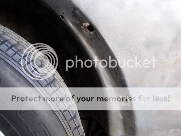

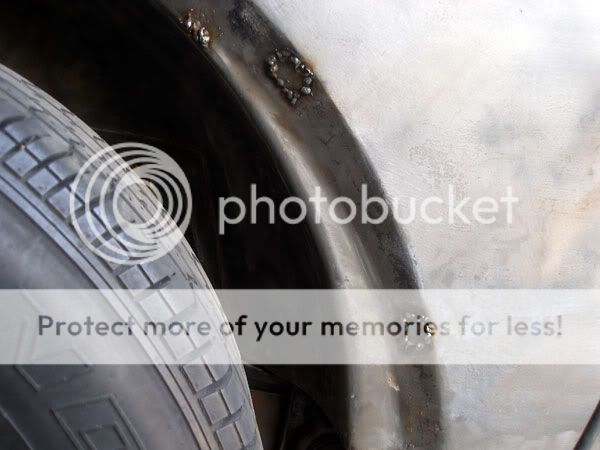

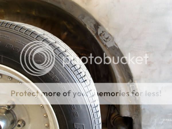

Havent had alot of time to work on it lately but I've been pickin away at it. Got the fire wall cut out and the new one in place and started making my inner fender panels, got the louvers in them last night I just have to finish fitting them and weld em in. I think they are going to look pretty cool especially with the louvers, I havent seen anybody do anything like it before?
I also finished welding in the windshield and cowl, got windshield wiper bumps removed and the gas filler filled, and got everything ground down smooth.
I need to start cutting out and welding up the fender bolt holes too... not looking foward to cutting or drilling them things all out. Whats the method you guys use to get em out easy?
-Gary

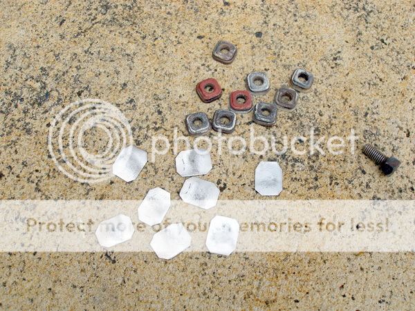

Anyone got some helpful insight on cutting out all the fender nuts and welding and smoothing it off?
-Gary
I did a write-up on how to do this in the Fernon's Chop thread, here is the best way to fill in all the fender holes.
I put a screw in to the holes and then beat the plugs out of the body
They come out pretty easy and are easy to fill in then.
I just made a bunch of plates to weld back into the openings.
Then tacked them in.
Then ground them down.
Hope that this helps...

FOR SURE! Thanks for the advice, I was most concerned with getting them out.. that looks like a good method! Thanks, Gary
