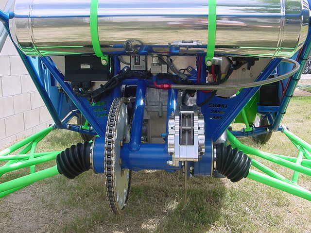

yeah but steve you have about 600lbs of reinforcement for the bed.
Old December 30th, 2007, 06:07 AM   #30
Posts: 5,914
Default Re: my kawasaki beetle project
The green and blue setup in the picture above would not work well for the street. You will need a differential to avoid squealing tires going around corners.

Chain drive units with differentals are way expensive.. The big design problem is how to hold the outter bearings. So here is what I came up with in mock up form..
dude thats a sweet idea why didn't i think of it that would work great thanks for that pici mite use it

My pleasure... those side plates are 12"x12"... You will still need a method to adjust the chain. A VW torsion clip could be use way easy too.. Funny thing is even after the hundreds of trikes Iv built, Iv still have never done a chain drive one.

I probably won't ever actually build anything, but I've researched the "chain drive diff" quite a lot on the net. Here are some links:
Chaindrive Diff 1
B'ville Salt Flat Car This site is very detailed with great pics.
Chain to shaft conversion
Michael
