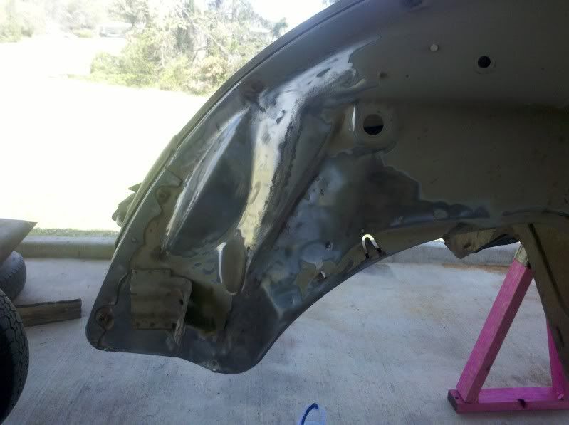

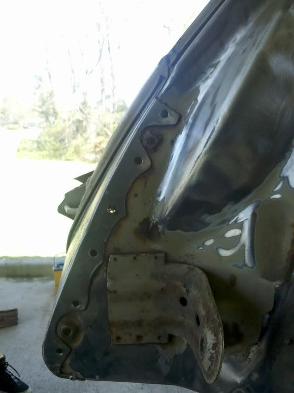

Well, here we go again. I shifted my attention to the hood yesterday. The alignment has always been off, but I just assumed it was going to be an adjustment at the hinges.
Well, now I'm 99% certain it isn;t going to be that easy of a fix. It appears that it has been hit in the front driver side of the front clip.
After seeing the indent there, you can look at the edge alignment of the hood to the fender bolt sections. That's a really significant difference.
Looking form the side, there is this gap thatn I'm nearly positive isn;t suppose to be there. The hood should be resting on the body completely here, correct?
So, I guess I need to start looking for a front clip now...... just when I was finally seeing the light at the end of the tunnel......

Maybe this project is trying to tell me to go fenderless????
I really want teh wide fender look, but doing an extension and cutting out up here would allow me to realign everything without the need for a replacement clip.

If you go fenderless, it will be a snap to straighten out your gaps.

It looks like the apron is bent up just slightly near the nose more). I am betting with a little finesse to the apron and maybe a little persuasion to the clip it would be ok. These things move alot with little work.

Yeah, I've spent the entire afternoon out there looking at it. I can't find any crimps, bends, or other indications that this thing has been hit hard. The nose is obviously out of kilter, but I think with some work I can get it straight. I remember the PO telling me that the body was only being held on by a couple of bolts. Tomorrow I'm going to build some stands and get the body off the pan and make sure it isn't twisted somewhere first and that letting it all relax doesn't cure most of it. If not, I'll start with a little banging here and there. If I can;t force it, then I'll start disassembling the welds at the nose and giving myself the movement needed to get it straight.
I've had a vision for this car from the very beginning. I'll be damned if I take the easy way out at this point. I want a fenderless ride, but this one wasn't meant to be that car.

Well, I made a couple stands this morning so I could separate the body from the frame. Was an interesting time since my son decided he wanted to be part of this today and I always welcome that. Unfortunately he isn;t the most coordinated and, well, it took about twice as long to do it with his help...but hey, I think he learned a little something out of the ordeal.
Rolled the pan out and he decided he wanted to start cleaning up all the metal filings that had fallen into it and started rusting.
Then I set to removing all the paint from the front nose section so I could see exactly what was going on and also so it would expose the spot weld points better.
Here you can see the slight twist and crease from taking a hit. This also explains why he didn't have the fender for that side, huh.
Spot welds exposed.
drilled the spot welds open and then pulled the nose section forward.
Stopped here for the evening so I can get some yard work done. But, I quickly realized that I'm going to have to take all the spot welds apart so I have full freedom to move the panels. The drill holes will help in reassembly so that I know I have everything back squared up and in the correct original alignment prior to the damage...that's my plan and theory anyways.
Anyone have any secrets to popping the welds out any easier or faster..there are a shitload of them.
Lot's of work to get this nose section realigned all proper.
My slowass, learning as I go, project..... http://www.volksrods.com/forum/showthread.php?t=30607

I like using drill bits that start out with a small pilot and step up to the size you are goint to use. Some people have told me to use a full stepper bit the one that looks like a christmas tree. The thing abought say using a 3/8 with a starter pilot is most of the time the hole in the second pice of metal is the size of the pilot. This is because the step up is flat and once it clears the first peice the weld will normaly break loose. Sorry abought the shitty spelling it is early. One way or the other it is a tedious process. I took the cowl off of my Chevrolet like this and replaced a section in the lower cowl that rusted out from years of debris.
