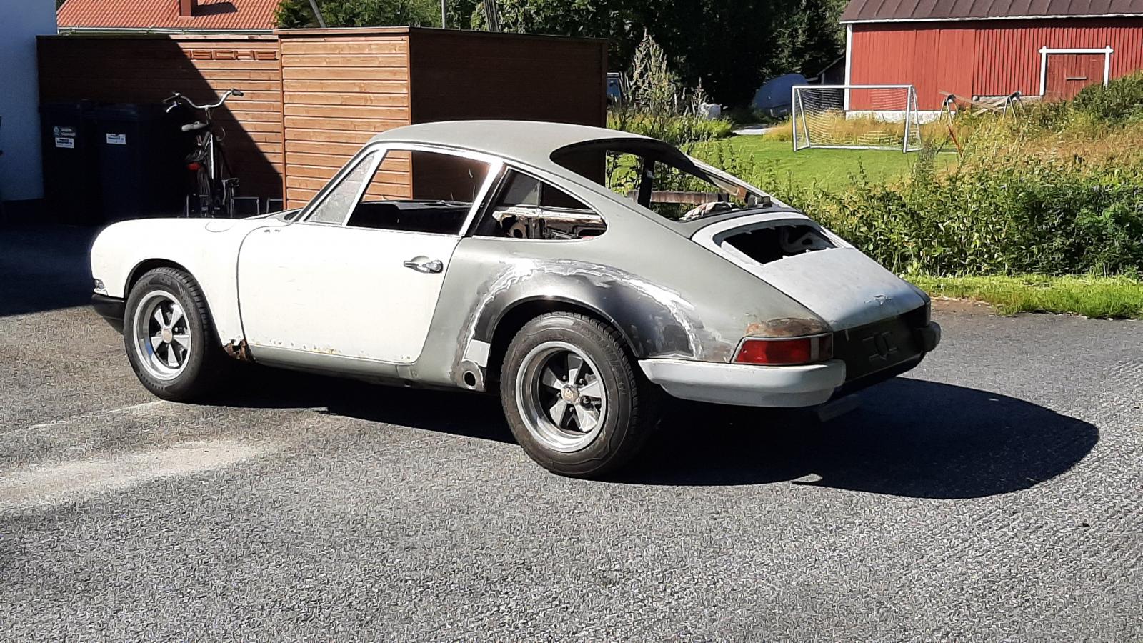

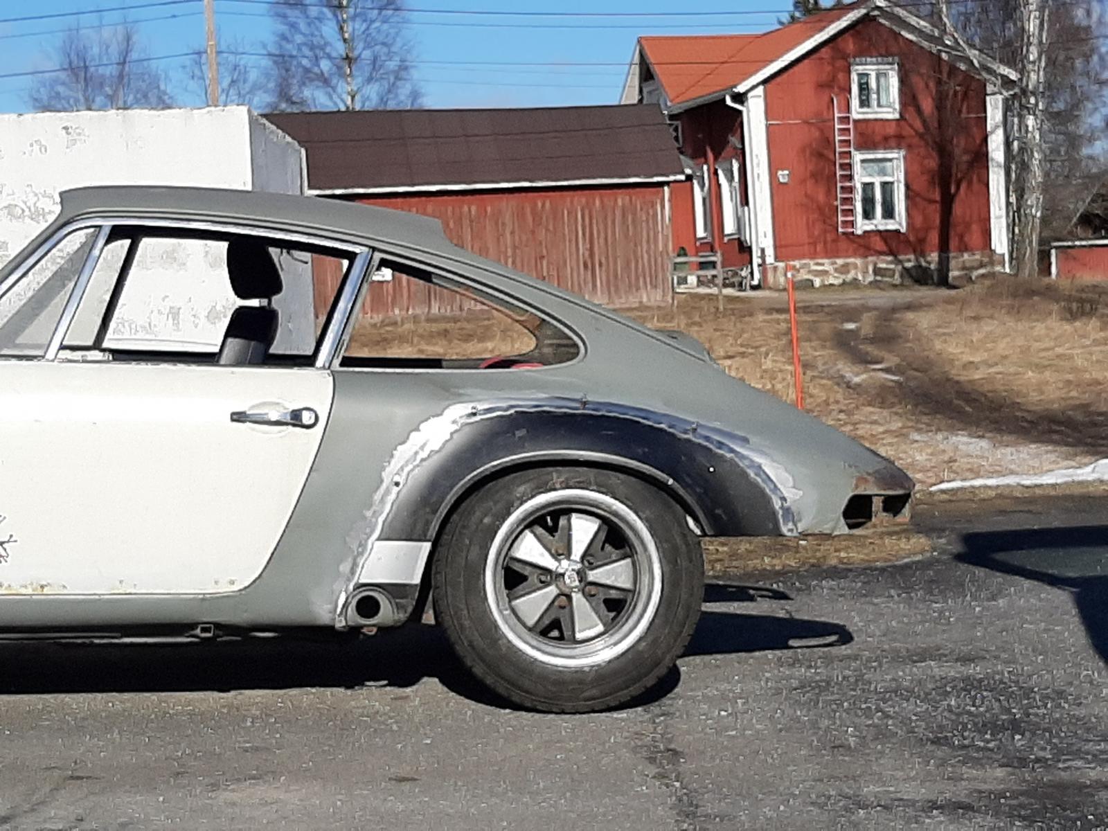

All kind of shit been around since my last post. But not too much progress on the new porsche though. Some welding (a-lot!) have been done on the rear-end though... Converting the 912 to a 911ST looker with a flatsix in the rear instead of the original flatfour.

Your 911ST looker is lookiní good! Those wheels and metal work around are really cool. Iím looking forward to seeing more!

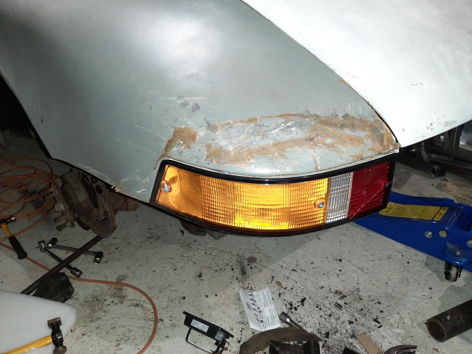

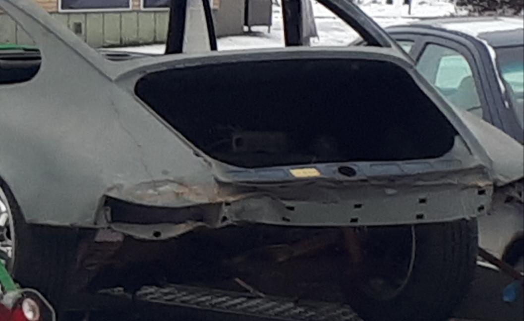

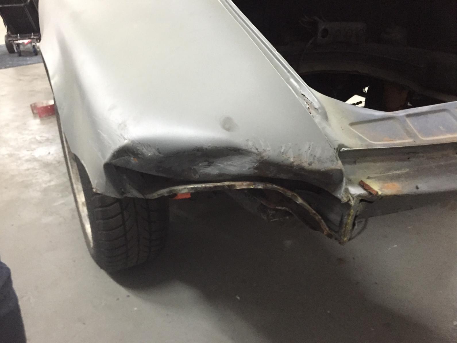

The rear had some damage due to shipping company by PO..

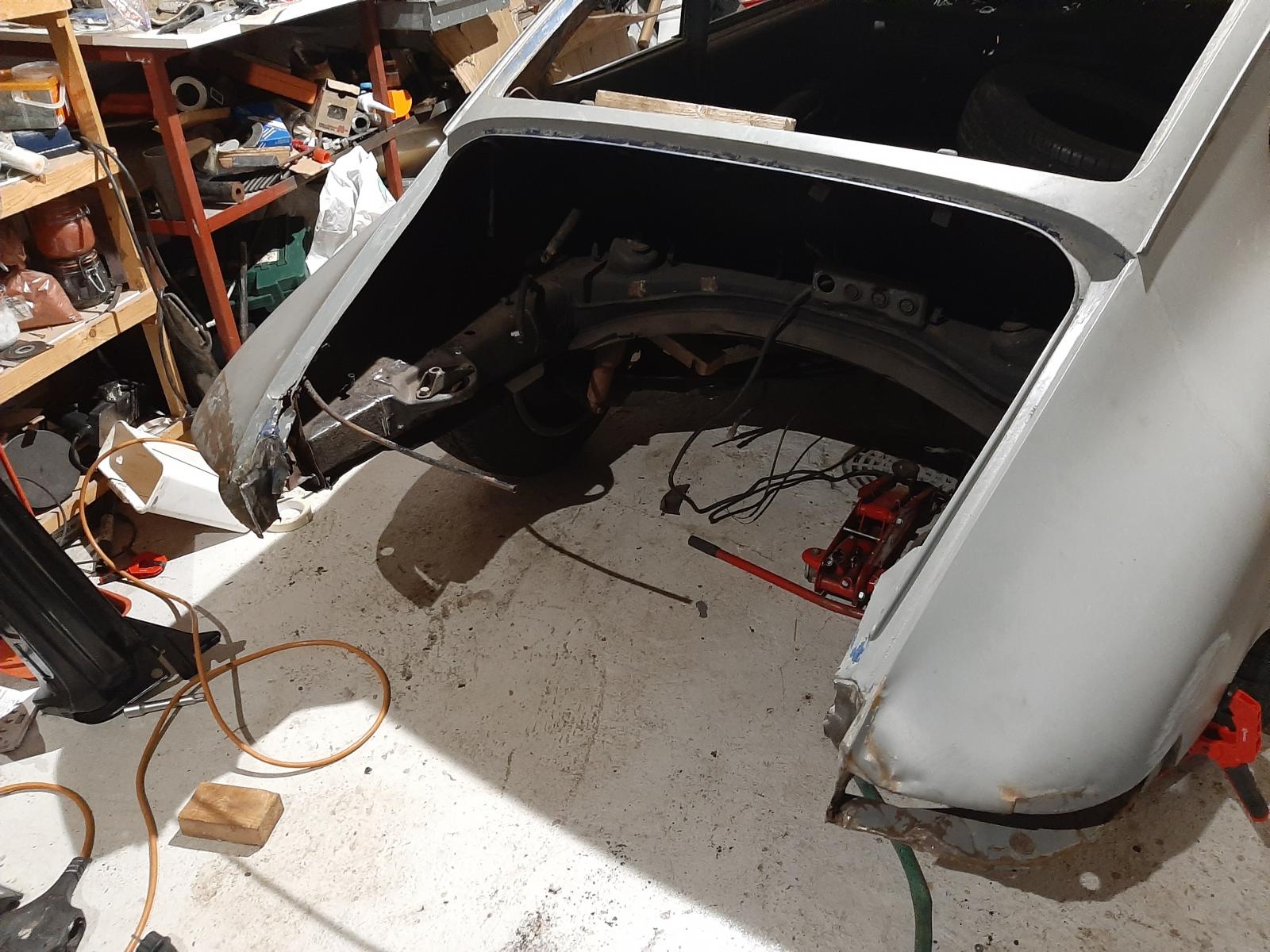

Hammered out the damages and replaced the crossmember.

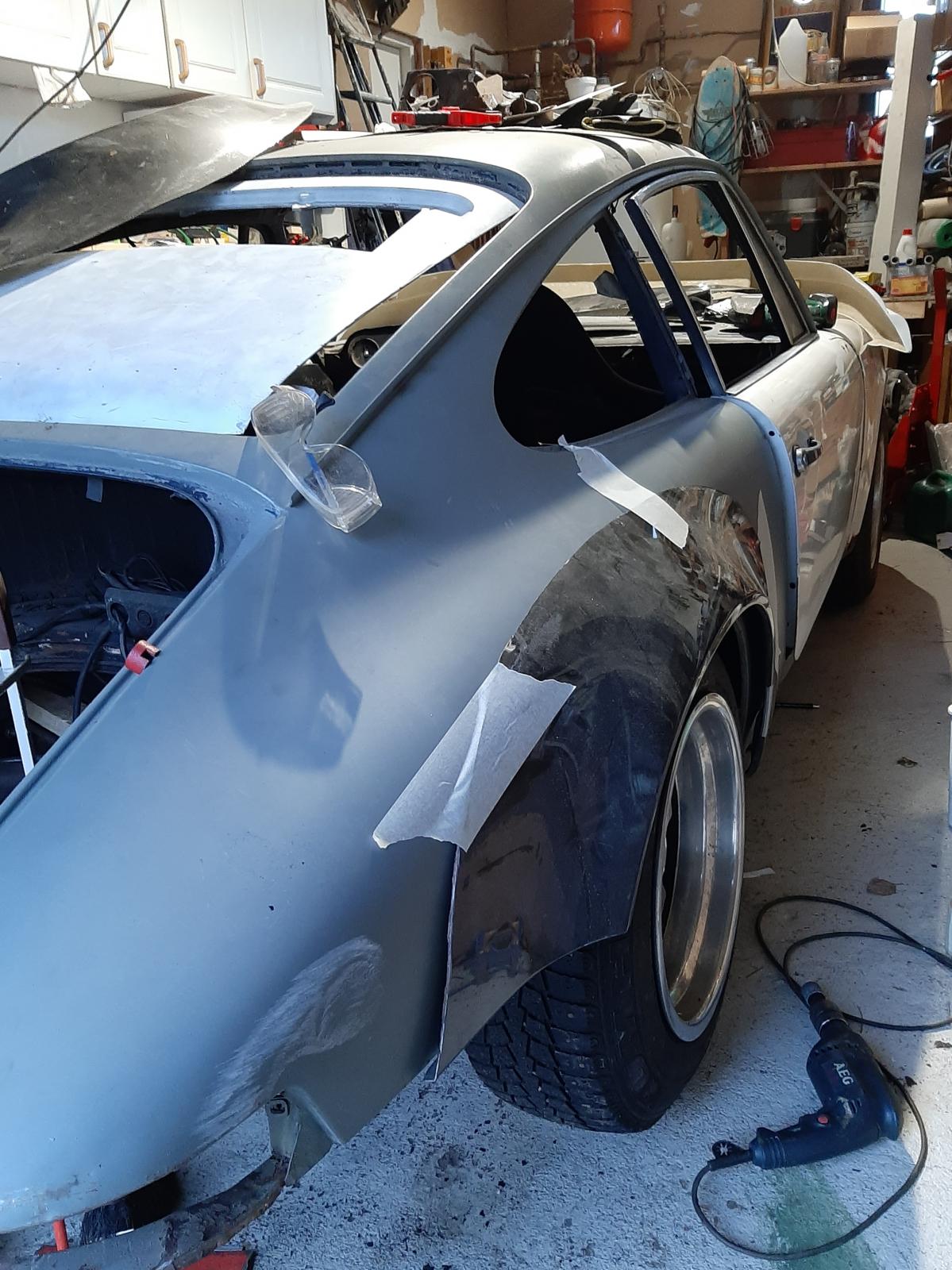

Also removed 912 enginemounts to be replaced with enginemounts and some rust repairs...
Also tracked down a pair of SC fenderflares to get more hips in the rear..

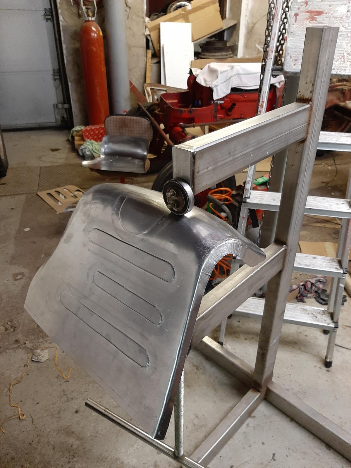

Since I'm a poor diy guy most is done with a tight budget...
The rear floor/seat buckets need to be replaced but are crazy expensive so I chose to take some sheetmetal instead.
Not yet welded these though.

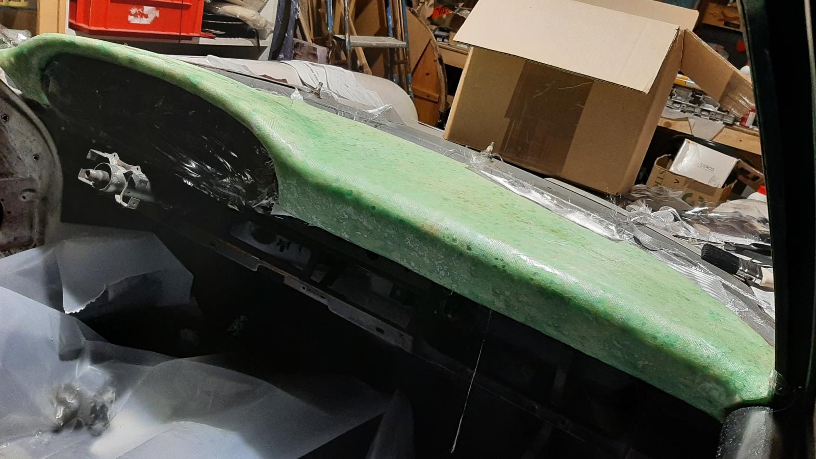

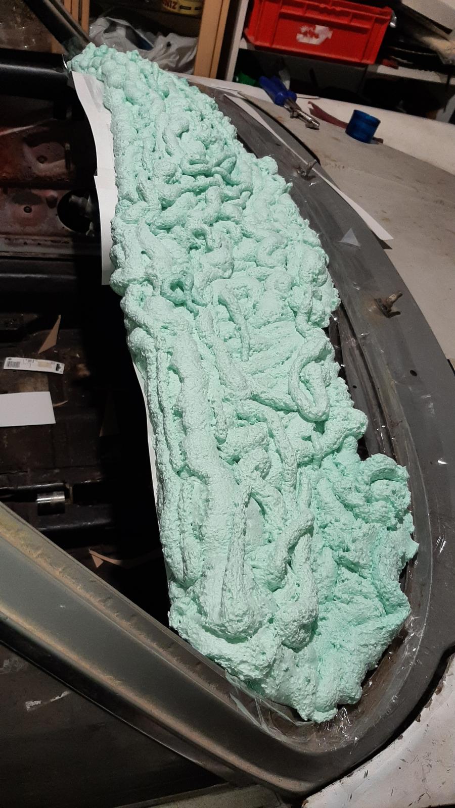

Wanted to try make my own dash pad too...
And at the moment trying to make rearbumpers out of crappy fiberglass bumpers...

You diy work is seriously cool! Iíve never seen dash work like that before.
