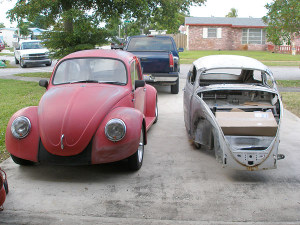

First off here is a comparison of the two bodies, on the left a 1972 Fat Chick, on the right a 1962 future Volksrod... A roling dolly was made to the current ride hight of the Fat Chick so that we had a reference point to compare.

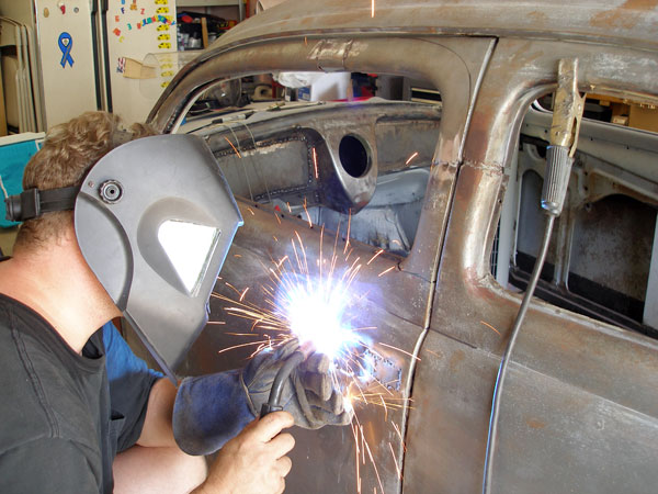

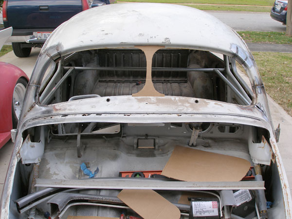

Here you can see the two blue lines on the back section of the car. The top blue line is where we made the initial cut to the roof and the bottom line is approximately were we wanted the roof to sit when we were done.
Here you can see the cuts to the post
All things in life look better Topless
Relief cuts made to the roof and A pillars to match the pillars to the roof

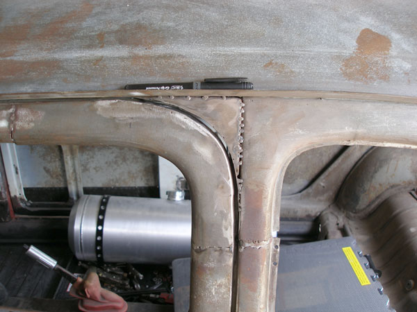

OK here is the little secret that we did not tell everyone when we did the chop, in order for the back end to line up again you need to cut the inner fender well below the fender bolts (see photos - red line indicates where to cut) so that you can draw the rear of the body in so that it lines up with the roof, then just trim off the excess metal from the inner fender well.
Chopped - Side View
Chopped - Close-Up Side Window
Chopped - Rear View
Not bad for a weekend job...
4" chop in the front 2-1/2" in the rear - roof moved forward 2" - B-pillar cut and realigned with body - rear inner fenders cut to align with body sides - I wonder if the engine is going to fit...

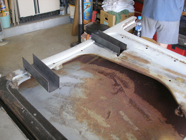

Here is some of the fab work that was done to the fucked up tunnel. Better than the original, my brother-in-law can weld like a MOFO but I am a crazy grindin' son-of-a-bitch, after the bodywork you will never be able to tell. (sorry bug guys no JB Weld or Foam Fill in this car).

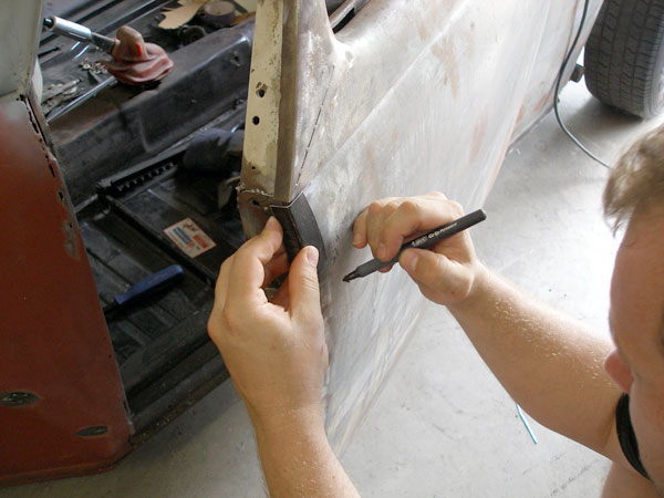

It was very easy to put the pans in with the heater channels so that you can line everything up, then after they are welded in you unbolt the heater channels and set the body on, then replace the heater channels on the car one side at a time, I will have photos of that for you to see when we start doing that.
Make sure you use the original spine in the back if you can, it is stronger than the aftermarket pans and it helps lining up the pans, just drill out the spot welds and separate the spine.
One side in, now it's time to fix the other.

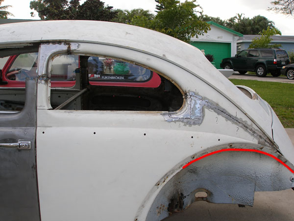

Next thing to do is cut out the heat tubes and close up that hole.
We also shaved the drip rails around the front of the door. Hmmmm I wonder if that means we are putting suicide doors on???

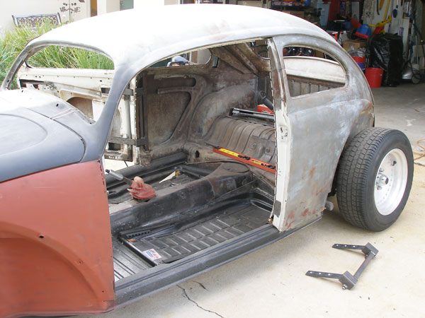

Back to work on the passengers side heater channel, after replacing the heater channel we decided to replace all of the lower metal on that side as well.
Another nice big hole to fill - the bottom end on this car is being replaced with all new metal- no more rust.

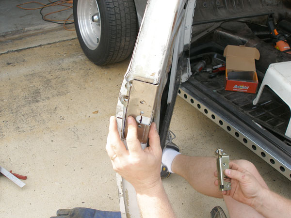

Here is an example of what I am talking about, these are the hinges to the doors, notice the nuts JB Welded to the plate (Priceless)...
Sorry... I had to vent. OK back to the build, the back panel has been cut out to be replaced.

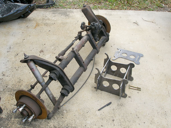

OK, like I said, the Evil Metal Genius really outdid himself this time, he went ahead and fabricated a 10-1/2” beam extender for the bug.
As usual, we pulled the beam off the car to find more rust and more holes to fix.
The Evil Metal Genius making some final adjustments to the beam. Notice the OSHA squint.

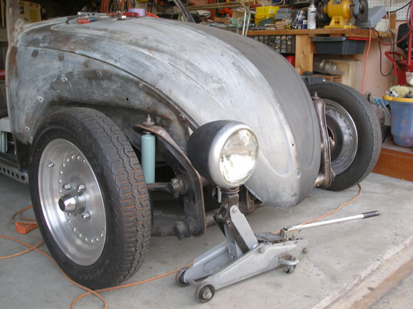

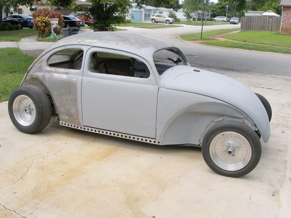

OK, so the beam extender dropped the front end down another 2" but the car still looks like a Gasser, so once again the Evil Metal Genius does a Cut and Turn and now it has the right stance.
Before the Cut and Turn.
After the Cut and Turn. What a difference that made.
It's starting to all come together now...

Then we proceeded to form the metal to the shape that we wanted.
After we got the look that we wanted we had to start building up the sides.
Checking for fit.
Then it was time to strip down the dash and start to make everything fit.
With both sides tacked in it was time to work on the top
Now this is what it looks like all welded in and ground down, after we finish welding up the dash and adding a skim coat it will look factory (or what the factory should have done). Notice how the top of the dash flows into the pod and all of the radiuses match up (OOOOOOOOOOH Detail)

OK, so we got our hinge kit in and let me tell you this kit is nice, it is a Williams Hidden Hinge / Suicide Kit and they did a nice job making this kit.
The kit also came with Bear Claw latches and the latch install kit.
Starting to cut into the body for the hinges
The Evil Metal Genius in action.
Checking the fit on the inside
Welding the hinges into the body.
Setting the hinges up.
Hinges installed on the body, now we just have to make the doors fit.
Cutting the doors for the hinges.
Pocket holes cut into the door.
One side done. - That's it for today...

This was a non-build week since we were at the Super Chevy Show all weekend - the good news is we were able to score some more parts for the v-rod.
Picked up a nice quality set of door handles for the inside just have to give them the brushed look and they are good to go.
Then I was able to trade my drive-in speakers for this nice set of B-L-C headlight buckets with the bulbs. I have been looking for a while for these since they have a deeper bucket to give it a beefier look to the front.
Did a mock-up to see what they are going to look like on the V-Rod, now we have to fab some ultra-cool brackets to mount them.

So we wanted to finish putting the structure back into the one side of the car so that we could finish mounting the door. As I approached the car I noticed a black dot on the roof, I slowly moved in a little closer and then I realized the v-rod had been compromised, yes boys and girls this is how bugs are made.
OK, so back to finishing up the door jam, welding in all the pockets around the hinge kit.
All tacked in and ready to be ground down.
Adding a support beam to the inside of the car to reinforce the hinge kit.
With the angle iron welded in place the hinge area has all the structure put back into it so the door and the body will not flex when you open it.
Added a piece to tie in the body to the heater channel.
Then it was on to the door, again we just couldn't have suicide doors we had to radius the top corner of the door as well.
After cutting the top of the door off. Now we have a nice big hole to fill.
Making a filler piece.
Welded up and ground down.
Top of the door done, now we have to make the filler plate for the body. We also welded in all the original door handle openings.
Beat it to fit. Paint it to match, a little fine tuning.
This is another one of those things that you won't notice the first time you see it. Subtle little details is what this build is all about.

We finished welding up the top of the door and set the gap all around the door so that it looks right, filled in all the remaining holes from the original front hinges and shaved the drip rails from the front of the door, it really cleans the lines up on the car.
After that we decided that it was time to start working on the drivers side door.
Checking the hinges for placement
Marking out the area that is going to be cut out. Since we are going to make our own solid rear panels instead of using stock rear panels, we decided that we could cut more metal out of the car the make installation easier.
Cutting out the inner frame to install the hinge kit.
Removing the section that is not needed.
You can see the section that was taken out so that the hinge can be inserted.
Cutting the lower pocket for the hinge.
The lower pocket is an open cut into the body.
The top opening is a little harder to do since there is four (4) layers of metal to cut through.
Checking to make sure the holes are in the right place and the hinges are level.
Opening the holes up a little so that we have more adjustment in the hinges.
OK, This next part you may want to take small children by the hand and run, this is not for the weak hearted.
The driver's door never fit the opening right from the beginning and since we are anal as all hell about gaps and tolerances we decided to make the door fit the opening, in order to do that we needed to take a 1/4" of an inch off the front of the door so that the gap would be even all around. With that being said it was time to cut the front of the door off.
After cutting the front of the door off we ran a strap across it so that we could hold the door to weld it back together, a lot of work for a 1/4" of an inch.
Measuring the door for the placement of the inner brackets for the hinge kit.
Cutting the openings for the brackets.
Brackets tacked in place.
Making the adjustment to lean the front post in.
Front post cut off so that it can be leaned in.
Brackets all welded in so that we can mount the door.
Door opens and closes, now we have to install the latches and work on the tops and fill in all the holes and, and, and...

It's been a while since we worked on the Volksrod, we have been working on the Evil Metal Genius's 1969 SS Camaro for the past couple of months and it's almost done.
After working on a real car for a while we decided to take a break and play with the Volksrod again. I was able to pick up a Shrinker/Stretcher so that we could start working on the front panels for the car.
This is what the front end looks like after you add a beam extender, the front end looks unfinished so we decided to form our own panels to fill the void.
Marked out an area to cut away.
Placed a cardboard mock-up to see what it will look like.
A little primer to see it better. We will start working on the front end after we finish the driver side door.
We started to work on putting together the drivers side door, I think the heat is starting to get to us, we are now taking orders from this guy.
Marked the area that needs to be cut out, there are two layers of metal here.
Cutting the first layer.
Here you can see the second layer.
Have to break out the Sawzall to get to this one.
Now we have an opening for the pin assembly.

Now it's on to the top of the door.
This is how much the top was chopped.
Cutting the rear post to lean in.
Tacked in and ready for the top.
Top tacked together and center piece made to join both halves.
A little more work on the center piece.
All tacked together.

It's time to make the radius top to the driver's side door now and it's been so long since we did the passenger's side we had a hard time remembering what was done, have no fear, we can figure this out real quick.
First thing was to cut the outer skin of the door away.
Now we can see the inner frame to make the second cut.
The inner frame is cut at a different radius since it has the inner channel for the door gasket.
With everything cut away it's time to start fabricating a new top.
We begin with making the inner door channel.
With the Shrinker / Stretcher fabricating new pieces is no longer a major task.
Trimmed down now we just need to finish the outer skin.
With everything in place it's time to trim away the excess material.
Welding everything together.
The top of the door is now finished and ready to be bolted back on to the car.
With the inner channel in place the door looks factory.

Roll It Out And Have A Look
Not a lot has been done on it over the summer (too fucking hot down here) but I have been working on it a little here and there, I decided to roll it out and take some shots so that I can see what it looks like before I start tearing into it again. Sometimes you loose perspective on what you are doing when you are building in your garage, it's nice to see what you have been welding on and grinding all the time.
Still need to finish off the bottom of the doors and then it's on to the seats (this is actually what has been holding this project up more than anything, I just can't seem to make a decision on what I want to do for seats...), all I know is that after rolling this thing out of the garage (I want to drive the living shit out of it). But there is still a lot of work that needs to be done.
Hopefully I will have some time to get some more work done on it over Labor Day Weekend.
