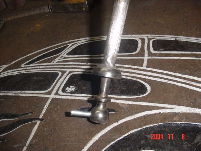

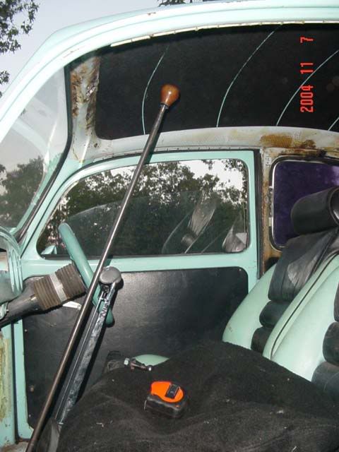

I'm building a longer shifter. I cut the threaded part off the top of a stock straight shifter and cut the bottom of the shifter where the tube part goes onto the solid part. I rounded the solid part with a belt sander then threaded it to 7/16 ( I think, I've used the tap & die set a lot the last few days). Then, I welded the threaded top to a pice of 5/8' solid round bar that is 40" long and smoothed out the weld and tapered the shaft with the belt sander. I have a nut that I'm going to weld to the bottom of the shaft as soon as I put all the bends in it. i may still have to cut some of the length off. I took the die grinder with a cut-off wheel in it and grinded the little ball that's in the bottom of the shifter. Once I got it small enough I pulled it out with a pick along with the spring. then I tapped a roll pin inti the hole. it's a little bigger diameter than I wanted so the slot I cut into the shift rod cup will have to be about 3/16". I still have to trim the roll pin because it sticks out about 3/4".
I should finish the shifter this week. I have the Scat bus shifter in there now and I just got a Hurst bus shifter off ebay but it hasn't gotten here yet.

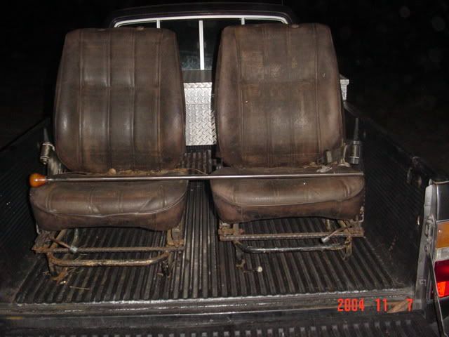

I also scored some free old ratty seats for it. The driver side has a couple small tears in it but I don't care. They were in a baja so they are on VW rails already. Check out the rebar braces. I'm not sure what they came out of originally but they have little round rubber bumpers on the back so I'm thinking some kind of delivery van? Plus, a friend of mine has a wooden Superior type steering wheel that I'm going to get or I have a couple 500s already.

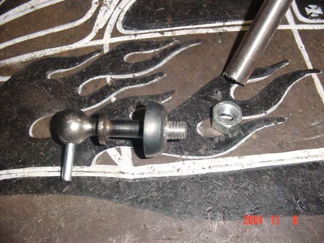

Shifter is basically finished, I think. I still have to put a quick-shift kit under it and maybe tweak the bends to get 1st and 3rd.
This is the pieces.
Old November 8th, 2004, 07:04 PM   #29
I welded the nut onto the shaft and grinded it until it was smooth and round. Then, I screwed it onto the shifter bottom part. I didn't really like the way it felt because when I threaded it the threads were a little shallow. So, I went ahead and welded the shaft/ nut to the bottom part, then grinded it smooth.
That knob is just there for now, I will put a different one on there soon.

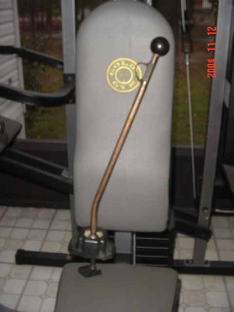

I just scored an old copper hurst bus shifter off ebay

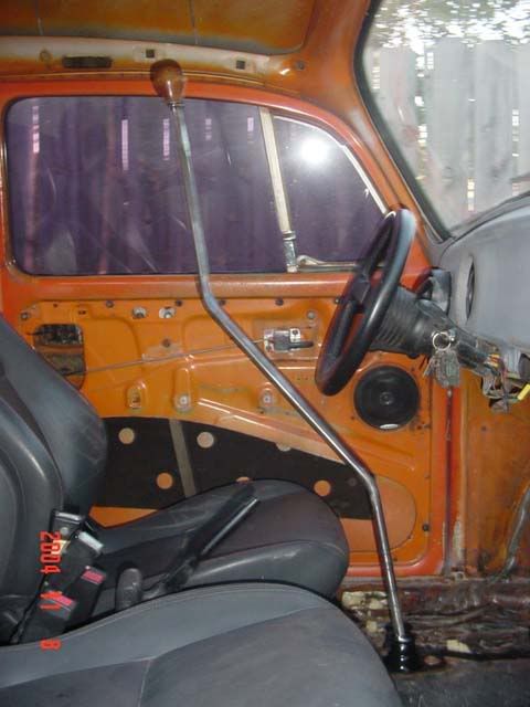

OK, I got the long shifter temporarily mounted in the baja with the shift lit. It's not going in there, it's just easier to switch shifters in the baja since the 69 has a 1" spacer plate that is a bit of a pain to line up and hold, etc. Anyway, I can get all the gears now but I'm still going to either bend the shifter a little more or shorten it a few inches. I'm working on a shift knob/T-handle for it also.
I yanked the ugly seats out of the 69 and put one of the "new" seats in just to see how they look & feel. I managed to take a little chunk out of my thumb in the process The seat sits a little high but it's pretty comfortable. I'll pull it back out and paint the frames & clean them up some. I might lower them too. I also yanked the steering wheel out and put in a Superior 500 that I have. I have to find the horn button (it's around here somewhere) I'll try to post pics within a couple of days. I think I have to get new batteries for my camera, it died today at a local show

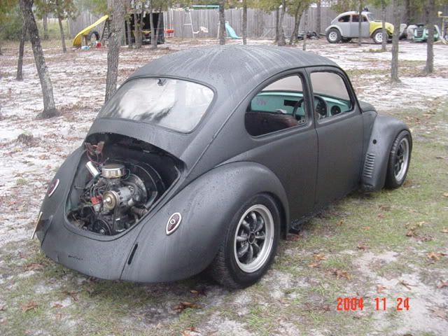

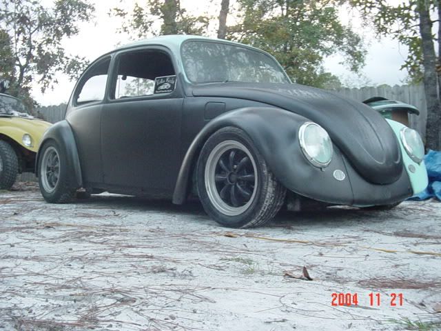

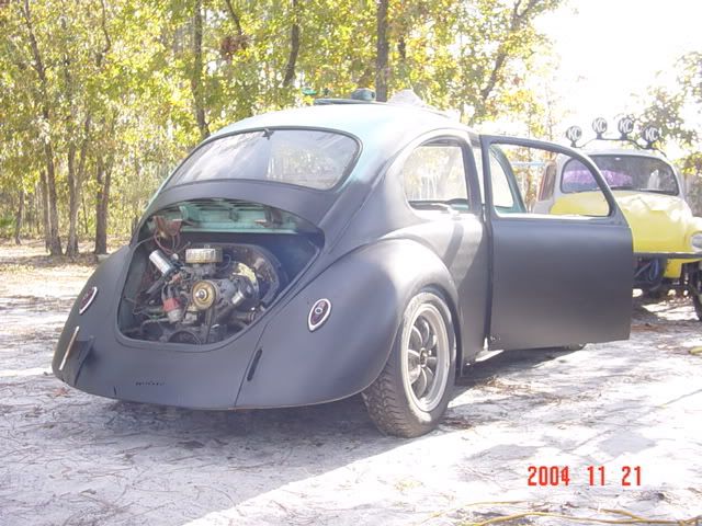

Minor cosmetic change in progress
Some new pics on the link in my signature under RHD 69 or whatever it's called.

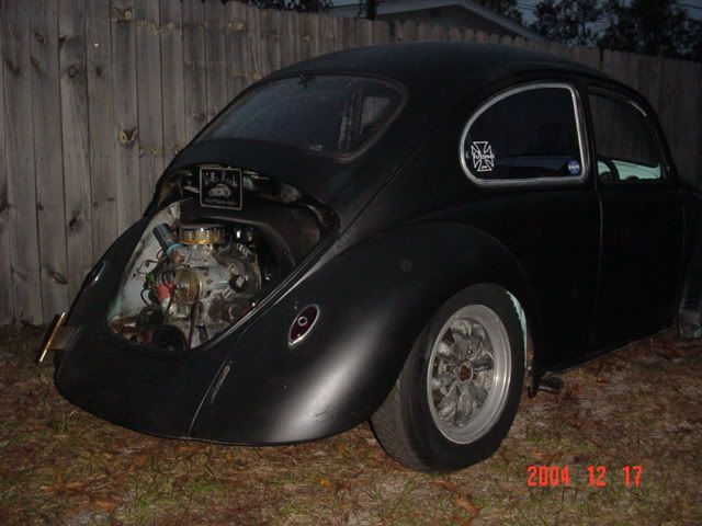

Bug is almost all painted, just have to do the left door & jamb and the dash.
The 69 has been shaved (door handles, trim, one wiper, license plate light, rain gutter in front of doors, turnsignals, emblems, everything), frenched (license plate, antenna, Porsche 914 guages), filled (dash, bumper mount holes, exhaust cut outs, rear air intake). More?? Has 4-wheel discs (914 rotors on type III hubs on rear, ghia on front), lowered, 8-spokes, new 165s on back, new 195/50s on front, teardrop tail lights, scat bus shifter, etc???

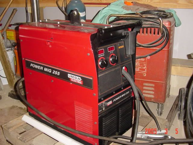

I bought a Lincoln Power Mig 255 welder. It came in today and it is sweeeeet!!! . I still don't have my building moved or wired but I'm hoping to have it finished within a couple weeks at most, I'm just waiting on my neighbor to get his stuff out of it and help me move it. I'll get a pic of the welder tomorrow since my camera is in my wife's van and she's at work.

OK, here's the pic of my new (to me) welder...

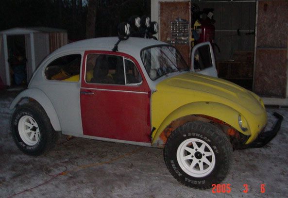

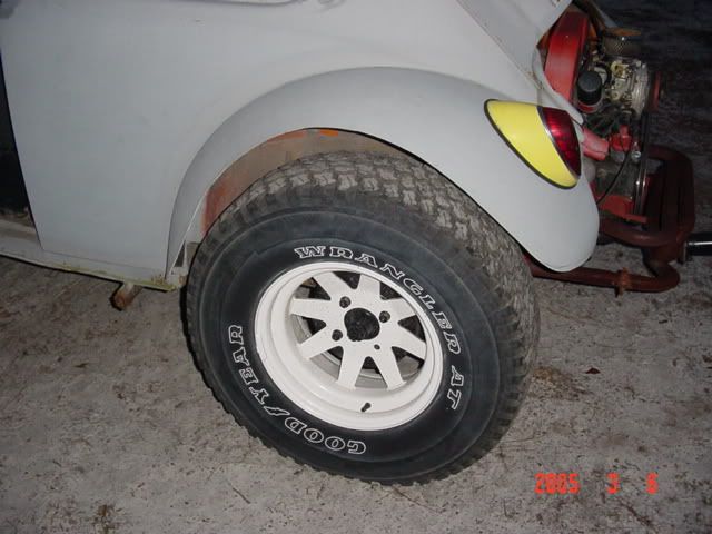

The baja came with shaved doors when I bought it. I decided to put different doors on it so I could have handles. I changed the passenger side door today but I stripped a couple screws out on the driver side.
I also trimmed the left rear fender. I have to make a template out of posterboard or something to make the other side match.
