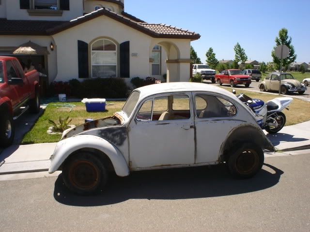

Whats up folks? Cash Peters here, aka Crazyman Stanley aka Josh. So I've been a fan of volksrods for as long as i have know about the site. Definately awesome scene. Anyway, I finally got a place with some of the buddies that I can freely work on projects with out the parents on my back. I just turned 20, but i have wanted to make a custom since i was about 14. Volksrods is the answer. Well, the night i got home from bug-o-rama, i moved out. And found a car that seemed like a great volunteer to go under the knife, err cutting torch to be more specific.
Heres the donar: a 1965 type 1
This sorry piece of shit that has been sitting around since the early 90's is going to be transformed into what i've named Veronica: The V-Bucket
