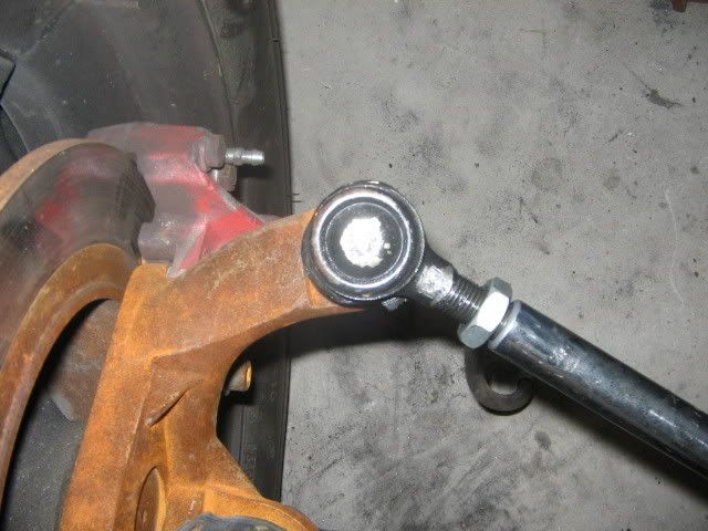

Yesterday, I posted about the tie-rod problem which is driving me nuts. Without the tie-rod end completely threading into the tie-rod, it robs me of steering adjustment.
I'm having a hard time finding a threader to fix the tie rod, so, if anyone has a threader (the coveted LH thread) tool that they could lend out to me, it would be uber appreciated.

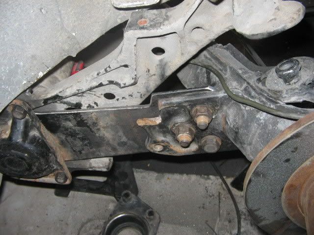

Here's a pic of the steering box swap, after I cut off the steering dampener:

Tearing apart the axles
Pitted C/Vs
Cut off the dampener bracket:

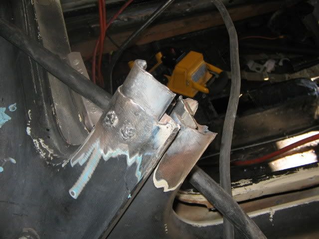

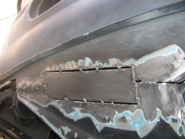

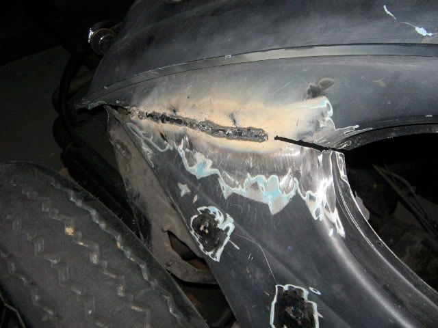

Not the straightest cuts doing the "Letherman Chop", so I have to cut out pieces and weld in filler plates

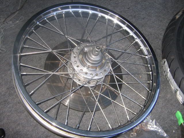

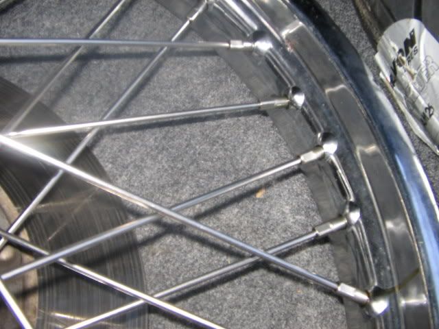

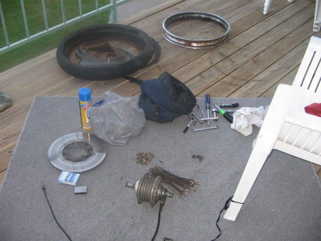

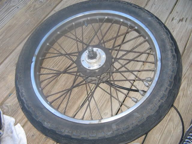

The Cafe bike was finished up last week after the headache of lacing and truing the new rim, and not to forget, getting the tire mounted, then eventually balanced. The progress has been posted in the motorcycle thread, but I figured why not post here too.
Here's the story:
After getting the 16" Harley rim and spokes dissasembled from the hub, I gave it a good cleaning before lacing up the new 19" wheel to it. After spending a couple hours lacing the new spokes, I took the wheel across the street to an motorcycle shop specializing in motocross bikes, only to have go back and pick up the rim since the guy couldn't figure out how to the get the lace trued. After several attempts of getting the guy to do it, I took it upon myself, with no truening experience. After sleeping on for the night, I realized that the rim was offset of the hub, making the truening nearly impossible. I flipped the rim/hub on the opposite side that I laced the wheel with and got the rim centered and started tightening the nipples down. At that point, I felt that it would be best to have a pro true the wheels, and the guy at the bike shop across the street turned me down for the last time.
Fuck it, I'll do it myself. I attached a straightened paper clip to one of the rear springs and after 6-7 hours, the wheel was finally trued; radially AND axially. I gathered up the tire, tube, and rim strip to a bike shop in Coachella that I have frequented since childhood (thank god they are still in business). 30 min later my tire was mounted and I left. After assembling the wheel on the bike, I noticed that the wheel wasn't balanced.
I took it back down to the bike shop and had it balanced. FINALLY, it was finished. Just to let you know, I gave a shortened version of the story since I don't have enough time to go through every detail, plus, I've probably lost your interest a paragraph ago and now you're busy looking at the pics...

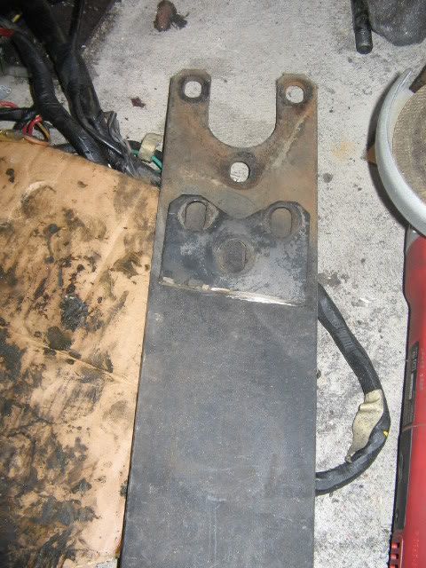

Finally finished up the rear suspension conversion from the IRS spring plates and torsions to the swing-axle spring plates and torsions. Doing so gave me plenty more tire clearance and also made the channeling process a bit less complicated.
Here's the basic the process:
I cut off one end of the double spring plate and used it as a guide to drill the holes.
After measuring several times, I marked where the holes will be and started drilling.

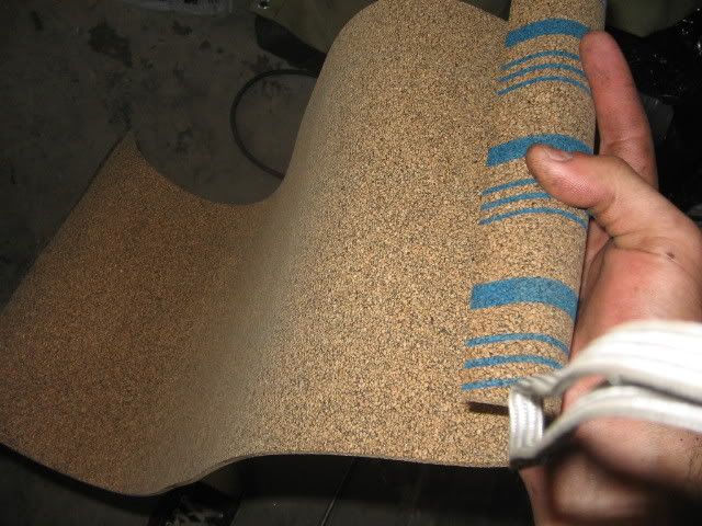

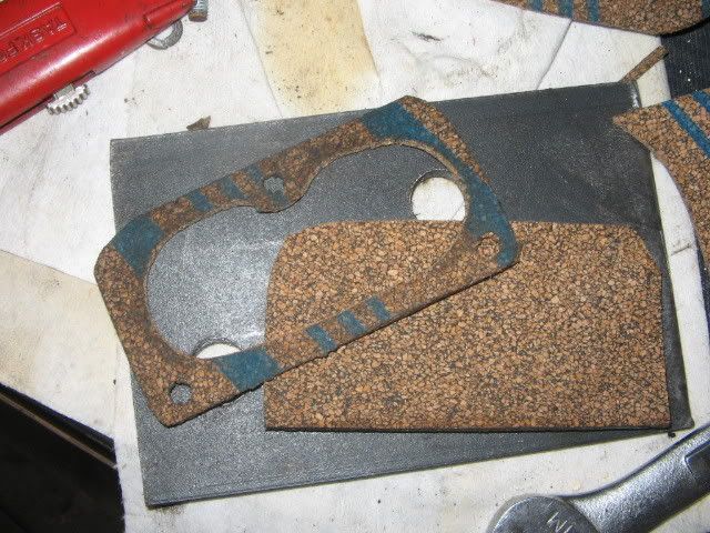

The lever shocks that I'm planning on running were in need of cleaning and new gaskets. I went down to the local AutoZone and picked up a roll of cork gasket material and got the the shocks sealed up.
I used some 20w fork oil for my motorcycle in the shocks, which good to say, works! The gaskets are holding up nice, but the only problem is that the shocks are way to stiff to use on the front suspension. Also the shocks need to be mounted a way that makes attaching the arms to the torsion arms a very difficult task. I might just pick up a set of Armstrong lever shocks for the front and use the other shocks for the rear.

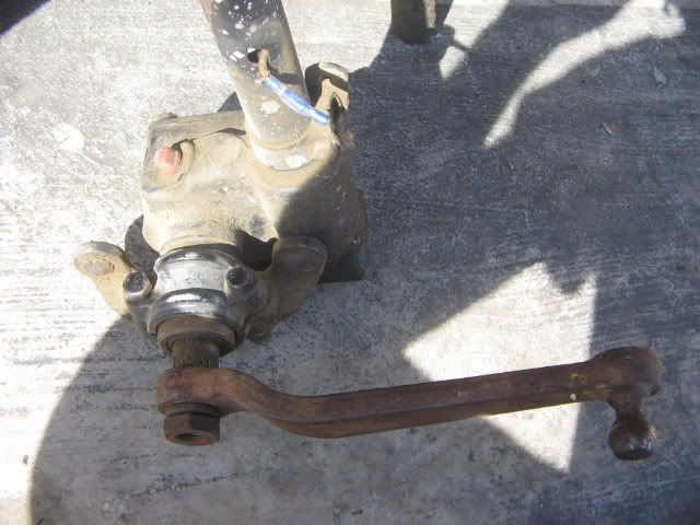

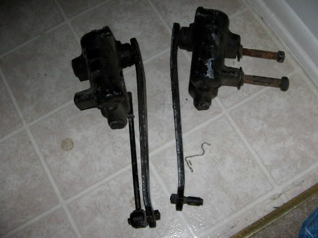

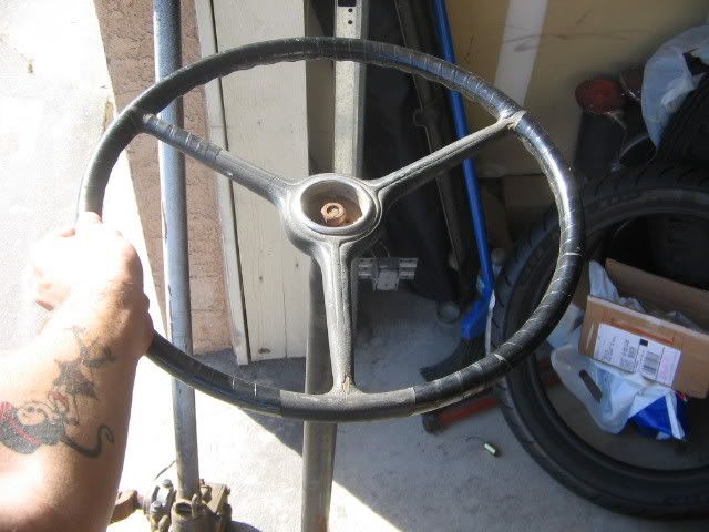

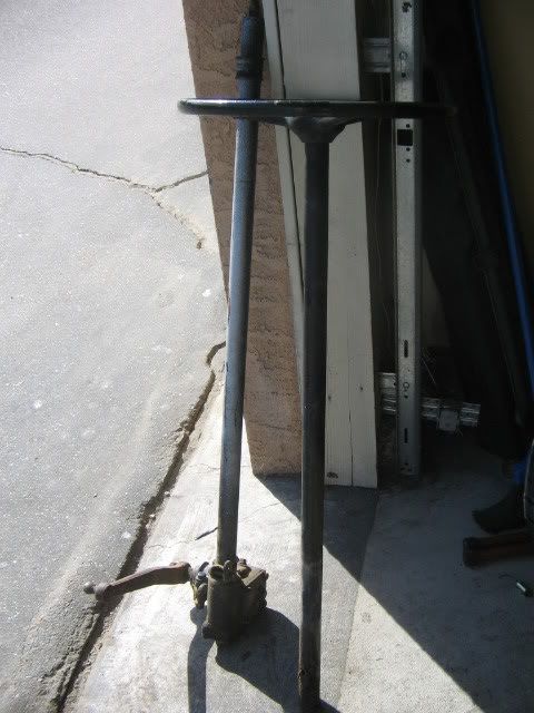

Here's my "new" steering column/ box/ and wheel that I picked up at the Pomona Swap Meet last Sunday for a mere $40 bucks.
Gonna look sooo fucking cool!
Steering box works perfect!
I'll be running a single drag link from the pitman arm to one spindle and running a separate tie rod to both spindles, hot rod style. The only problem is finding a drag link to work with the steering box. I'm scouring eBay and might have stumbled on a few parts that might work.

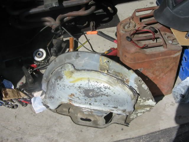

I've started clearancing the rear fender wells to fit over the torsion housing for the channel job and also trimmed up the front firewall as well. Hopefully I'll be able to run down to the local steel supply to get some sheet metal to fill in the luggage area.
A basic "before" shot.

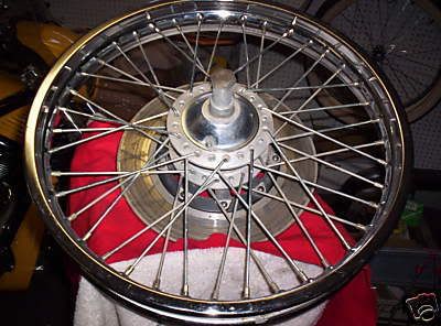

I bought, and received (Friday) a new rim off of eBay from an old Kawasaki (same size rim) which is in nearly perfect condition. A little polish here an there will make it look brand new. I'll get the re-lacing and truening done this week.

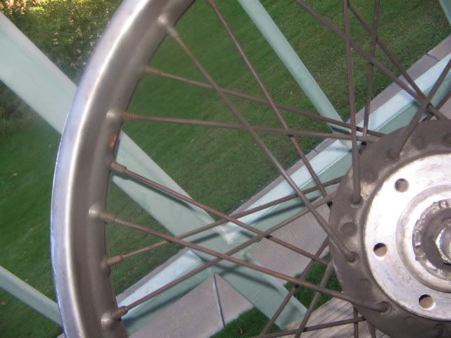

Original tire, rim, spokes that came with the bike. Definitely needs replacing.
Rusty spokes and badly rusted rim (where the tube sits)
Had to cut the tire off and tore down the hub/rim assembly.

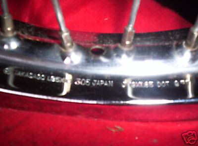

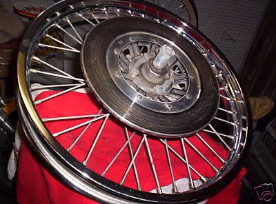

Rim off eBay - from an early seventies Kawasaki H1 in near new condish.

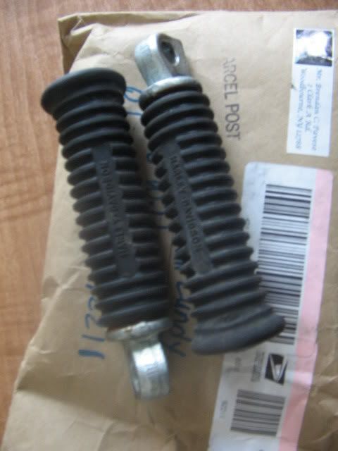

Also another item off eBay - 2 sets of pegs off a Harley Davidson that I plan to make custom rear-sets with. I probably won't start that project until I get my v-rod on the road.

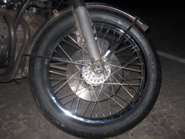

After weeks of getting parts and hours of tinkering, my bike is back on the road.
After the timing plate swap, the bike purrs and no longer has a miss at idle. I also did a couple things here and there to help get the best performance, like: installed bigger size fuel line (hopefully will end the fuel starvation at prolonged highway speeds). Also bumped the 130 main jets to a bigger 135 jets to stop the momentary lean condition when accelerating. The bigger jets also boosted mid-WOT and passing power. Last but not least, the new rim/spoke/tire mounted.
I took the tire yesterday for mounting and balancing, which the tire needed NO balancing whatsoever. I pulled about 80-85mph on the freeway today and had not a single wobble. Now for some pics.
Laced up Kawasaki rim (same size rim as stock Honda - 1.85x19)
Nearly perfect condition rim.

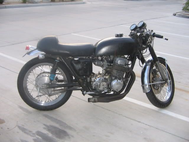

How she looks now:

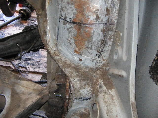

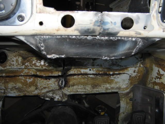

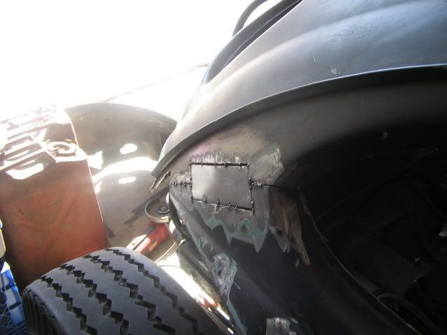

The biggest hurtle is achieving adequate clearance for the body drop, around the wheel wells and luggage area. The rear wheels are pretty tall: 31" that requires a slight tub around the tire and room for the spring plate caps if I decide to adjust the height at time in the future. The stock wheel wells are gone, and in place will be 16g sheet that will be a "mini tub" that follows the shape of the tire. The body is raised with 2x4s under the heater channels to give me room to work around the heater channels.
After the channelling is finished, I'll be able to finish the front roof chop (doors are welded shut and I would have to craw through the windshield opening to do any interior body work). I fabricated several "guides" that are spot welded to the inside of the windshield and door posts that will allow me to weld the roof on without a lot of trouble.

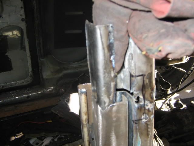

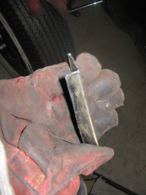

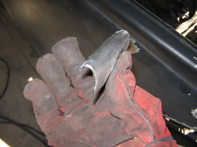

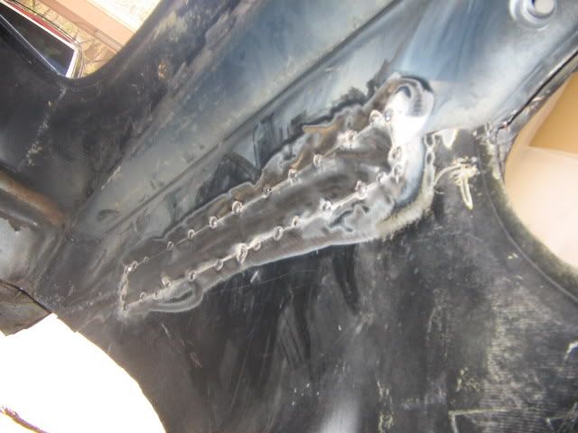

I made the rounded inserts by welding 16g sheet to a piece of 3/8 tubing and hammering the metal around the curve. The 3/8 tubing had a piece of scrap 1/8 x 1 x 4 metal to use as a "handle". I don't have the adequate room to use a vice, so it's all rigged up, but it works great.
The square "guides" were formed using 1" square stock instead of the round tubing; also worked great.
Welded in and ready to rock:

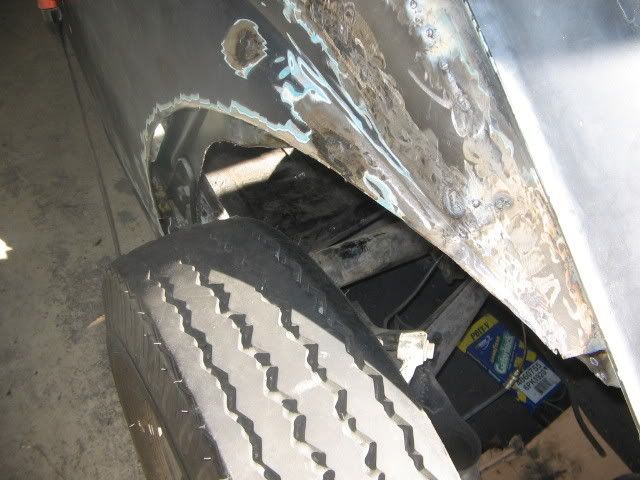

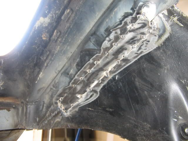

Holy hell, it's been a while since my last update. I had no work yesterday, which gave me some time to FINALLY get more work done on the v-rod.
I started out by cutting out the other wheel well (passenger side) so I can start gaining clearance for the rear tire to fit.
Small tangent here...
I've been lucky enough to be able to work with Mitch at his motorcycle shop, which I have gained so much knowledge and have been honing my fabrication skills to the level that he needs and that I can go home and use the same skills on my own project.
That being said, I noticed how crappy my old work has been turning out so I spent most of yesterday redoing the sections behind the rear 1/4 windows and began working on the interior panels behind the 1/4 windows as well. I'll take some pictures tonight or tomorrow and get them posted.
Here's how shitty it looked before (I know, I'm cringing too)

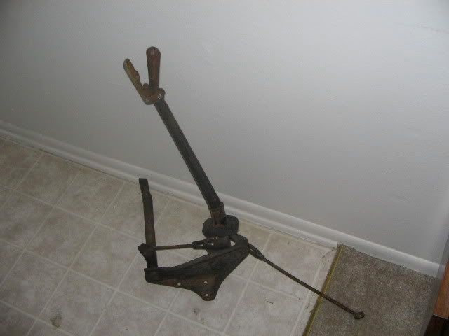

3) Relocate the e-brake to the outside (if possible). The cabin will be a very tight fit with the shifter and seats inside.
Here's the e-brake I picked up at the Pomona Swap Meets several months ago:

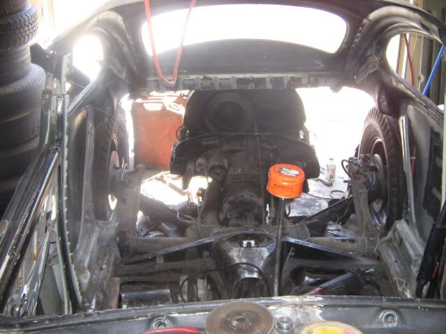

Completely gutted luggage area/ wheel wells:

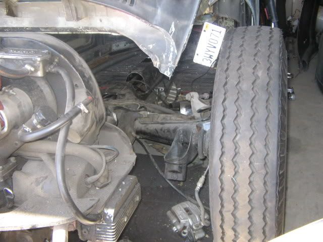

You can see in the picture above, the tires will interfere with dropping the body. That problem will be corrected by narrowing the body an additional several inches. The plan will be to fill in the wheel well area with a flat piece of 16g sheet.

After a couple years of hibernation, she's rolled out into the sunlight.
Firewall cut to for channelling
Floorpans cut to lower body down.

Welding the pans back into place.
Cutting the majority of the remaining firewall out to weld in fresh sheet metal.
Needs some sheet metal to fill in.

Made new sheet metal to clean up the front firewall, first making a template
Outside Front Firewall:
Outside Front template.
More updates soon.

Just been working on adding in the door pieces around the windows...which is slow and VERY tedious.
I'll be heading to the local metal supply warehouse for some 16g sheet to make the front firewall piece, and to start filling in the rear luggage area. It will be braced and boxed with 3/4" square tubing and an access panel in the center to get to the starter and transaxle area from inside the car. Still lots of work go, but getting closer.
***If anyone has some door tops to get rid of (the area in red), please let me know!***

Bug is on a short hiatus till I get some sheet metal for the luggage tray area/wheel wells, get some square tubing, and get my Scirocco up and running again.
Been doing some work on the cooling system plumbing, as the P.O. really did some wacky routing with the lines after the factory oil cooler was removed.
Should be back to the bug soon.
