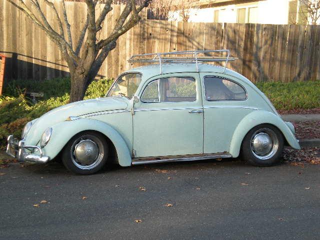

Since I seem to be building a ratty hoodride sorta thing, gotta get the roof rack going on.
Seems like everyone has the flat-four style, and it's a little too rectilinear to me. After hemming and hawing for a while, knocked this together out of 1/2" EMT conduit.
I still have to get some wood slats on there, and a brace between the upper and lower side rails, but it's on and attached firmly.
Lots of wind noise. Is that normal?

finished up the roof rack, I really love it.
