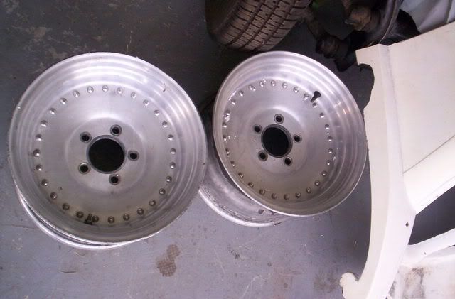

Well been getting spme working time on the pile. I've adjusted the stance, put indroped spindles and adjustable front beam. Just been collecting parts little by little the bigest purchase was the front nose from Bugroadster.
Rear wheels from Hal

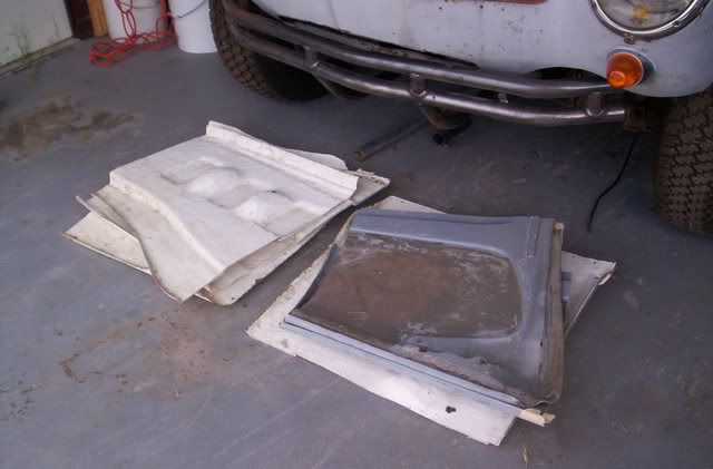

Well, The pieces are going together better than I thought. I cut the side panels. Now piecing the hood back. The angles of the side panels were giving me greif. I cut down the quarter to get them to swing enough to fit flat. after cutting I noticed the whole windshield area would move a little. I'll need to make some supports.
