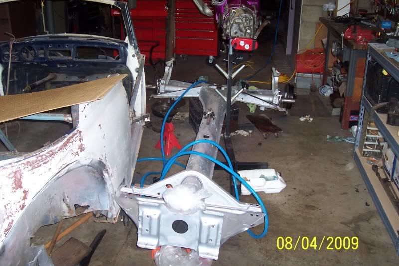

so things are starting to come together. trans is almost ready to drop in, and the beam is ready for puck removal and avis adjusters to go on. master series the pan a couple more times and put floors in. going with a corvair flat 6 modified nicely and who knows what else.....

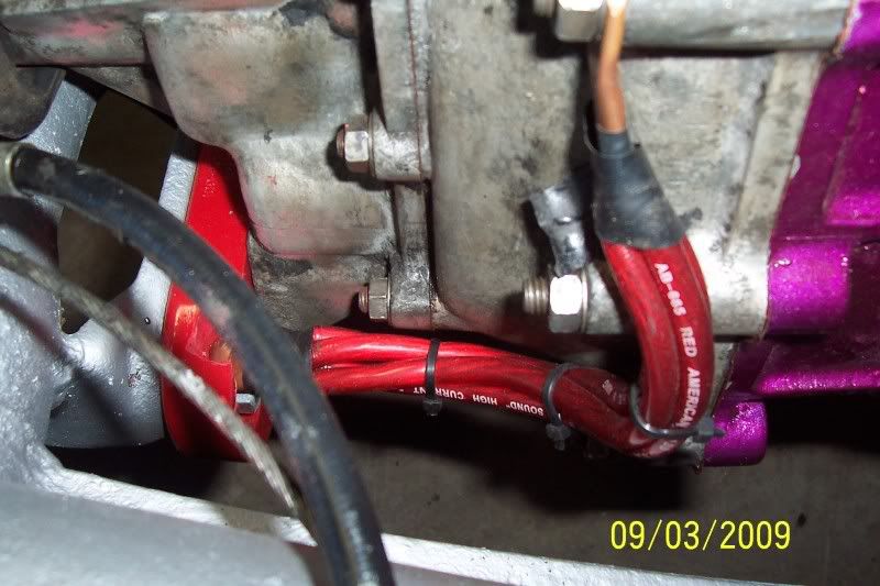

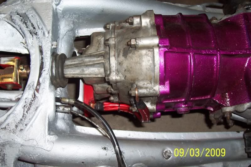

here's my answer to the $24.99 ground strap that MAMW wants. free stuff from the garage collecting dust. 4 pcs of 8 gauge wire with copper ends crimped with a hammer. THIS is a ground strap!
yeah, i know.. its purple. check out the poly bushings, the whole car is getting the prothane treatment.

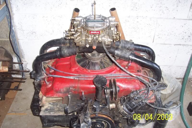

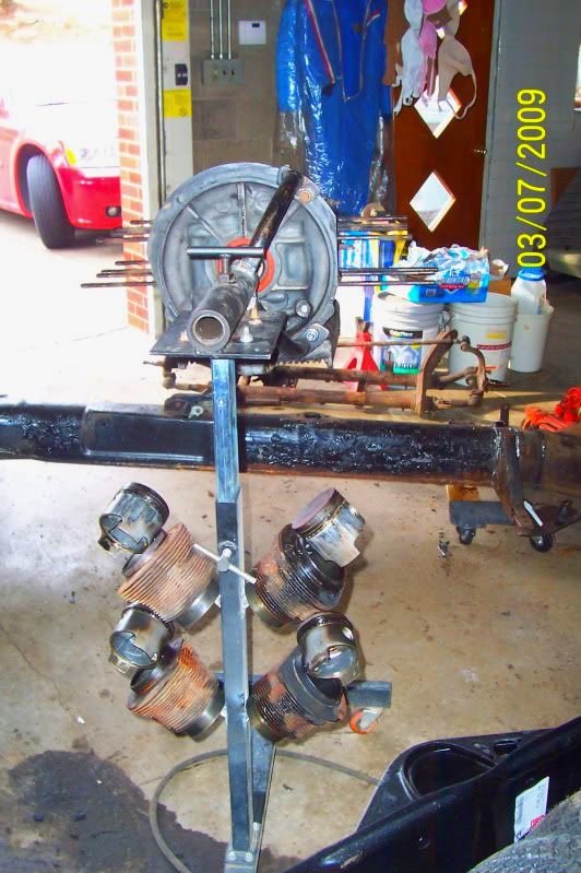

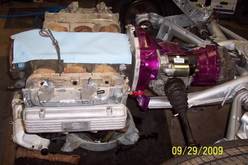

here's a few pics mocking up the engine making sure the new 12v starter works with it and measuring out for headers from either a buggy setup or custom corvair applications. VW's have more room apparently since the transmission and suspension isnt in the way like on a corvair. engine is still dirty but not as bad as 5 layers of paint over top made it look!

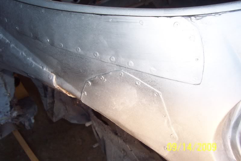

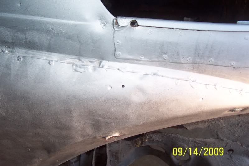

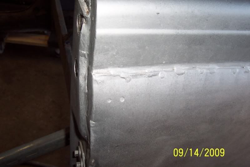

more master series work ... as always, poured more out than needed. coated the bug pan, impala gas tank and right side floor pan....
