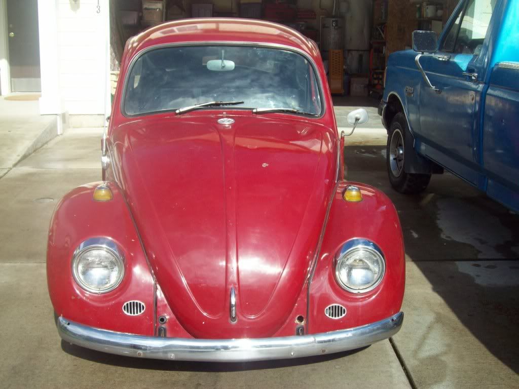

The donor: a running, driving, everything works 67 bug. Here it is all cleaned up:

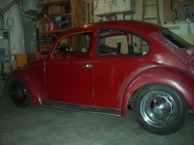

Quick update. Started disassembly, installed 2-/12" dropped spindles and lowered the rear one inside spline. The rear came down an inch and a half. Also discovered that all the rubber mounts have been replaced along with the torsion swingaxle bushings. Also pciked up the chevy 3-window cab to use as the donor for the new roof and rear section of the cab.
Placed my order for a pair of 15X4 Torq thrust 2s for the front and a pair of 145X15 front tires. Once they arrive, I'll need to figure out how much to narrow the front beam so it all fits. Thinking 5'.

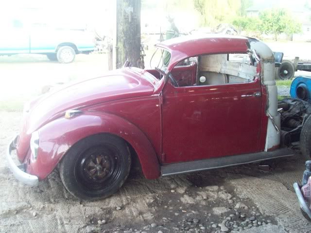

Step One: - cut the 67 almost in half and remove....Oh...this will make some purist mad for sure!! A 67 scrapper now!

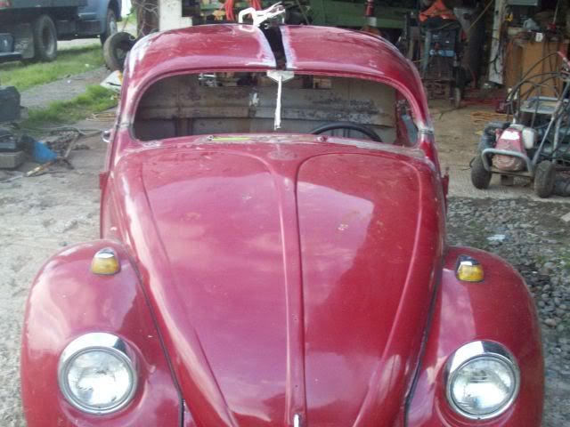

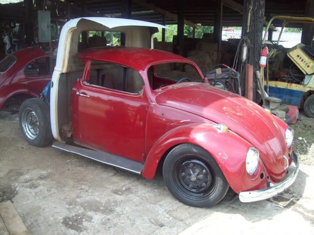

Step Two: Cut up good Chevy cab and set in place and chop 5" out of the bug roof
Step Three: Take a Billion measurements to figure out how I'm going to pull this whole thing off. The series of cuts made to the B-pillar are intentional. The bottom of the body line of the truck cab will be right in the body line of the bug; just below the notch I took out of the B-pillar on the bug body. I will also attempt to get the rain gutters to line up. Imagine the rain gutter sitting up against the door half of the B-pillar, that's where it will fit eventually. see it?
Anyway, this is where the fun begins!

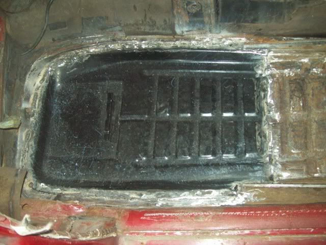

Before I get too far with the fitment, I will be replacing the quarter pan under the battery. This was an old Cali car so there is virtually no rust. The goal with the body is to make it so the entire body is removeable by using the same pan bolts as original.
The motor will be pulled once the bed is fab'd and the pan cleaned and painted.

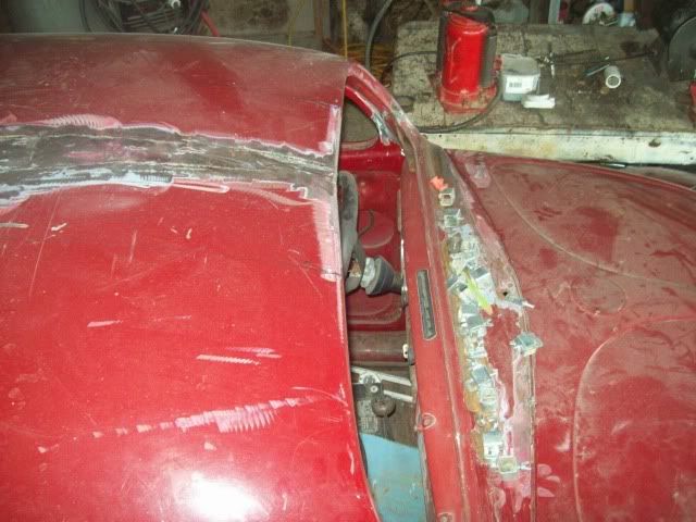

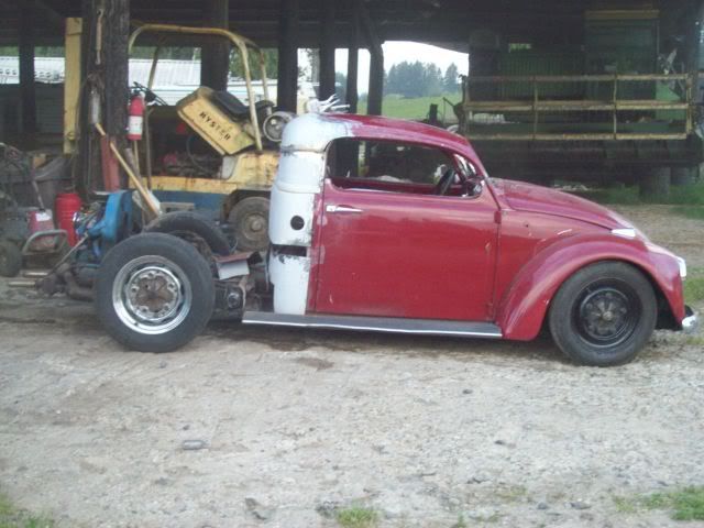

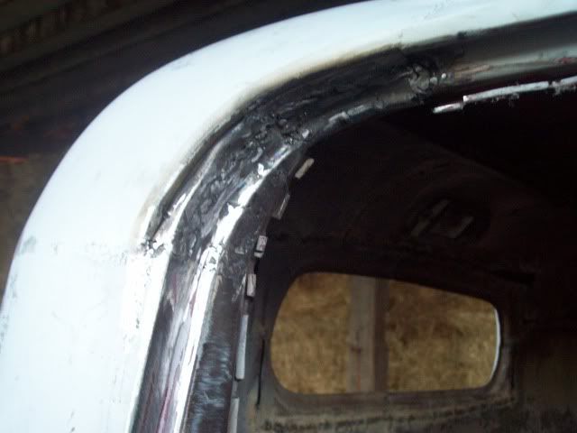

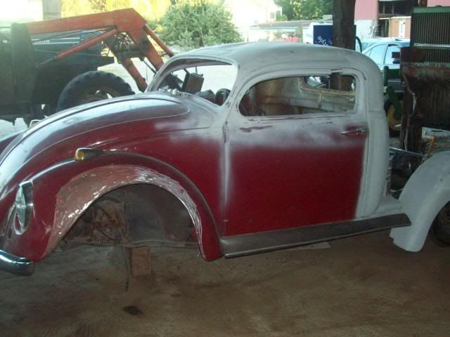

Started welding the A pillars and fitting the roof to the truck back. The gutters lined up nice and two curves are now one.
The top inside cab corners will take some work but once I'm done with the cab and roofline, I'll start on the door corners to get them rounded.
The center will need some filler and the front window opening is looking good.

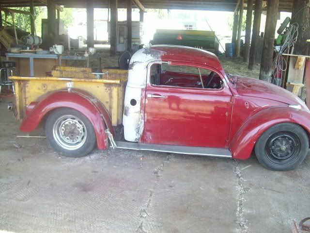

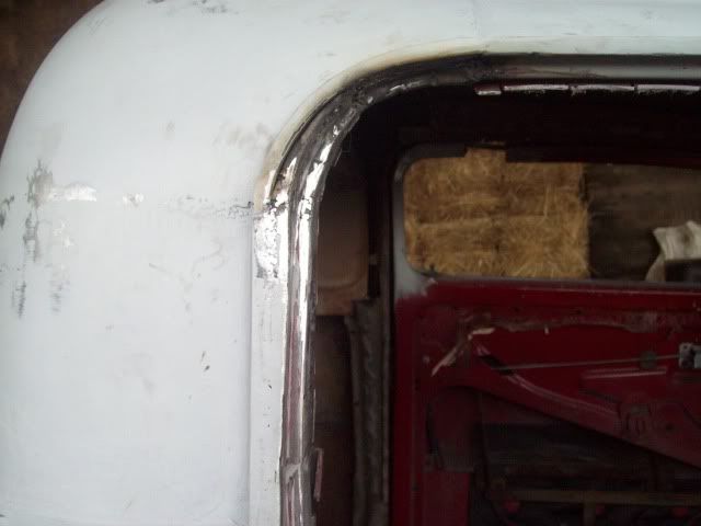

Spent some time over the weekend radiusing the door tops to match the radius of the cab corner. Now that they are on, I found a better way to make them a much cleaner curve so I'll have to come back and re-do the corners once everything else is done.
The other side is not flowing like I would like, so that wil be re-done first before there are any photos...yikes.

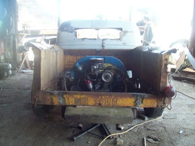

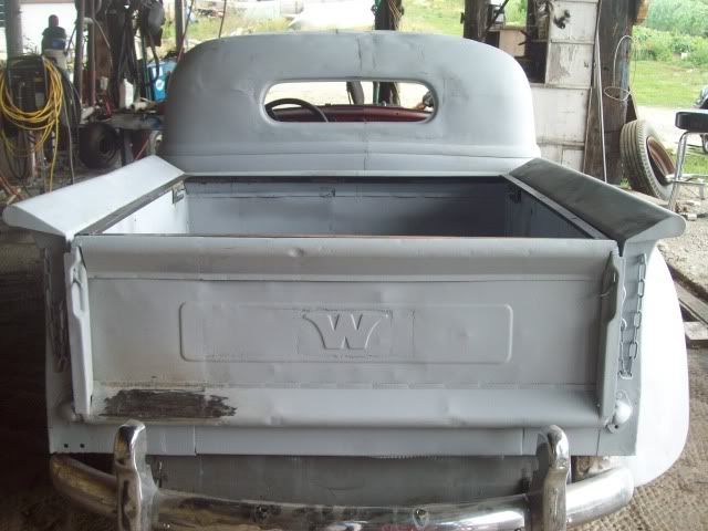

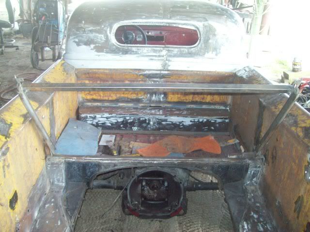

Also got the Chevy box narrowed and shortened to fit. I found the original mounting points on the shock towers will come in handy when I go to attach the bed. I will take the entire piece of sheet metal from the rear quarters of the bug and graft them to the bedsides for mounting purposes. Rather than the big bolt on the outisde of the wheel well, the bolts will be accessible through the top of the bed. I also hope to re-use the bumper mounts and re-install the stock bumper when it's all done.

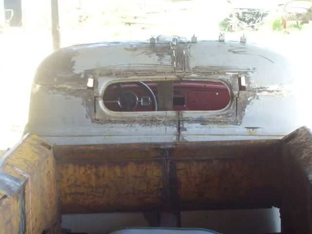

Anyway, the bed test fitted:
From the rear:

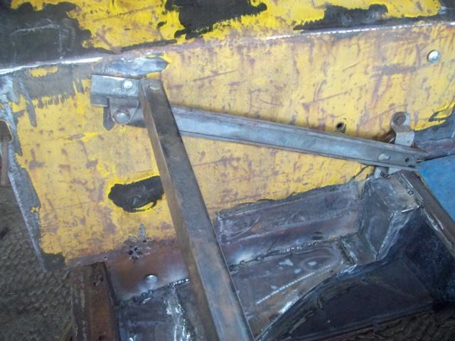

The rear cross support will be removeable for pulling the motor. I have it tacked in for now.
And for height comparison, here is my 5'11" nephew. The roof comes to chest height.

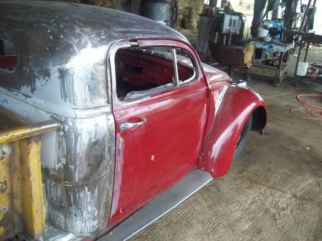

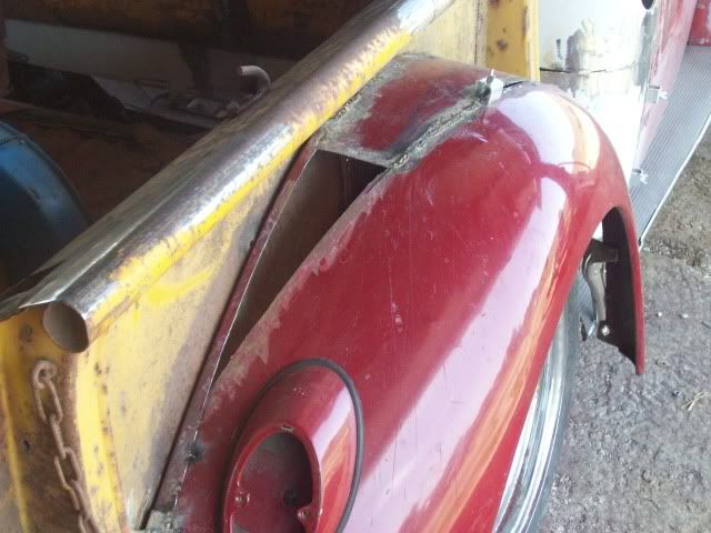

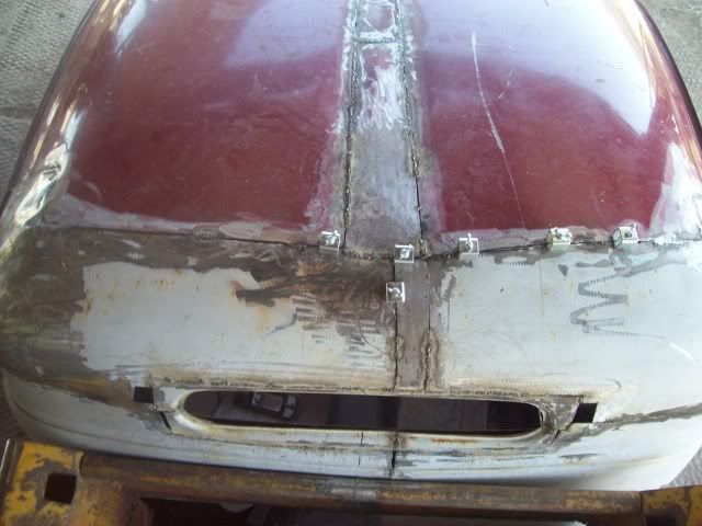

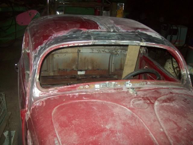

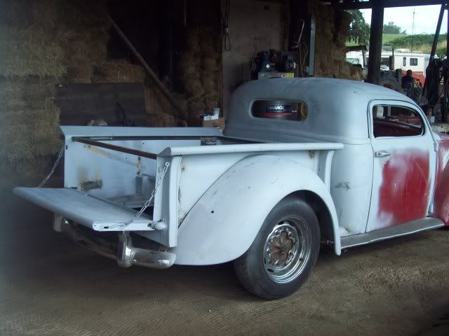

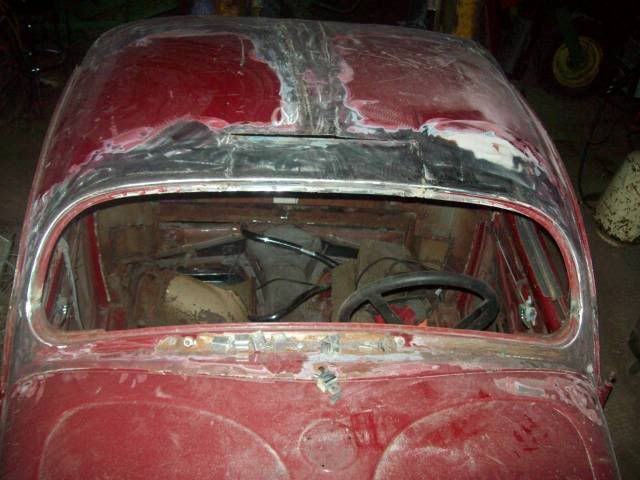

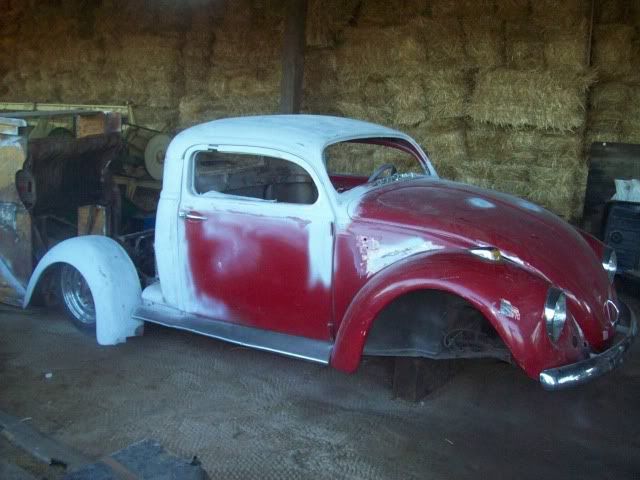

Spent some time working on the truck. Installed the rear window frame and got the roof put back together and worked on the A and B pillars of the roof and cab to get them to line up. The black vericle mark on the lower section of the window frame and the window is center the bed seam center, not the lower cab seam weld.
Still some final welding and a little hammer and dolly work to get the roof straight.
Started on the rear fenders. Found the old roof metal had a nice contour already, so cut a few pieces and started fitting things together.
Did it wrong the first time, so cut and weld a little more...
The lower edges of the rear fenders will be tied together with a rollpan with a recessed license plate and the dual exhaust sticking through. The fenders are plenty wide for the 17X8 Torq Thrust wheels that will be tucked inside.

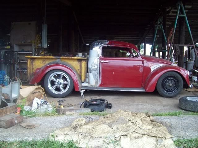

Overall profile so far:
Not a bad weekend at all! Once I'm done with one, I'll pair it to the otherside and make them match. I'll pull the fenders and final fit the bed. It will need to be lowered a couple more inches before it's done. I'm also working on the inner paneling of the bed so that I can use the original rear bumper mounts. Those photos are to come!

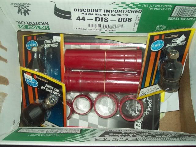

Over the past couple of weeks, been busy picking up parts for the to-be-narrowed beam and the dress up stuff for the motor including a Bosch alternator.

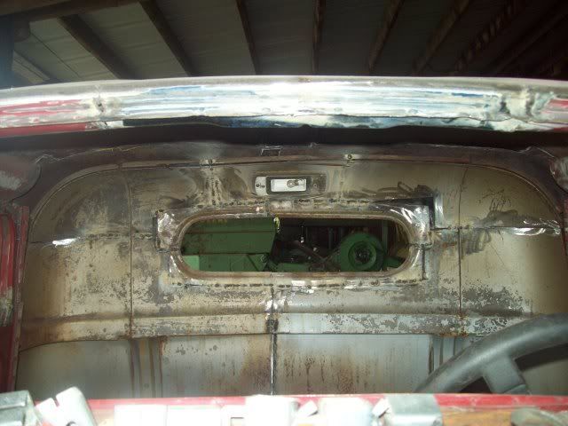

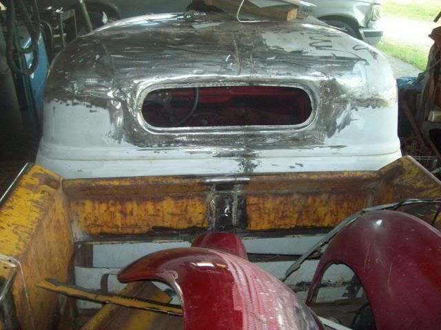

And finished up the rear cab window.

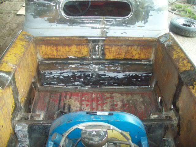

The bed around the motor will be all boxed in so I will be using most of the compartment seals to keep the heat away from the motor. Not a great photo, but you can see that the firewall stops just at the bend and a piece of square steel runs across the firewall and connect the bed sides. Also had some patch work to do to the bed sides. That ate up time and never mind the fact that I had to re do the cross supports because the bed sagged in the rear becuase I didn't level the bed before welding.

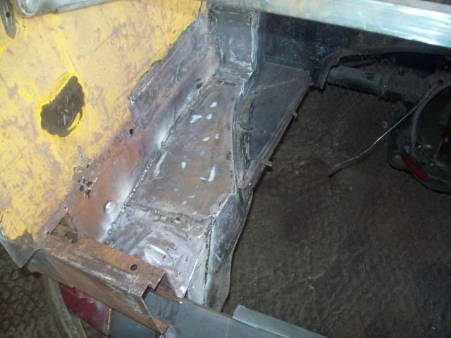

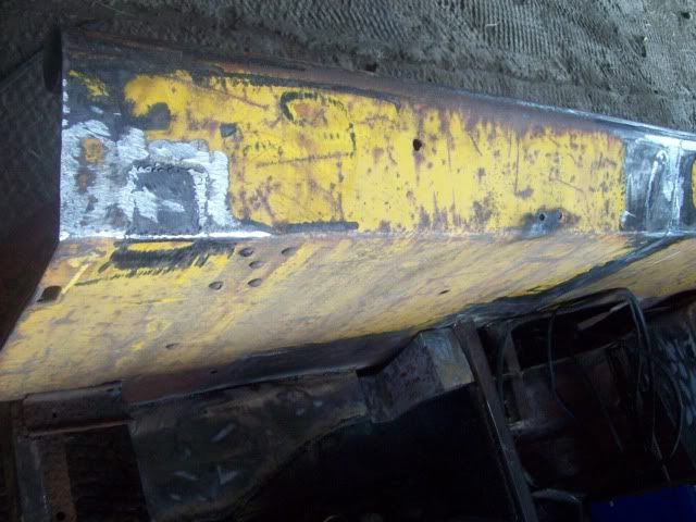

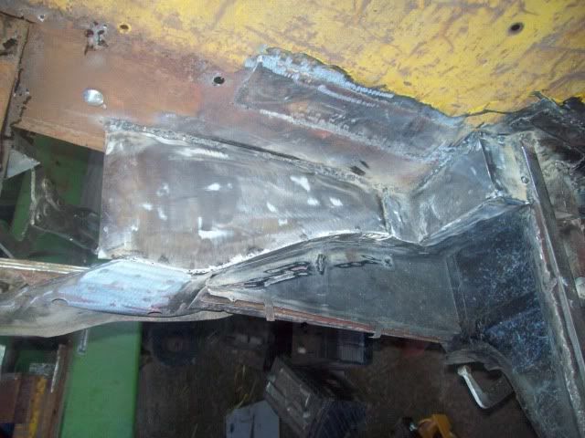

Another day of progress! Started boxing in the rear frame to the bedsides
Capped the stack bed holes.
Under the front edge of the bed, I created a box that is accessible from the inside to reach all the pan bolts. You can see the frame is now supporting the bedisdes.

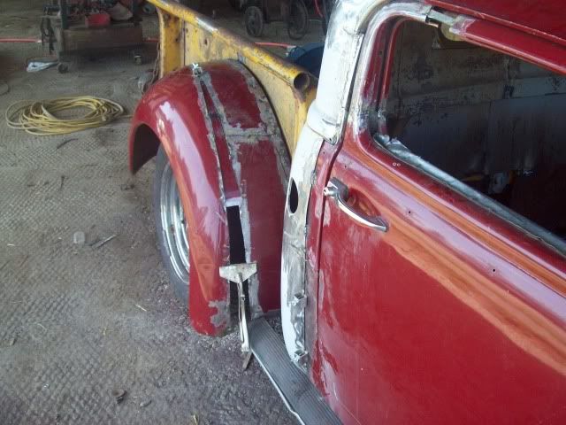

Made really good progress on the step side filler.
Filled the old gas tank filler hole.
Finished the other rear fender and test fitted everything and threw a wheel on for G.P.

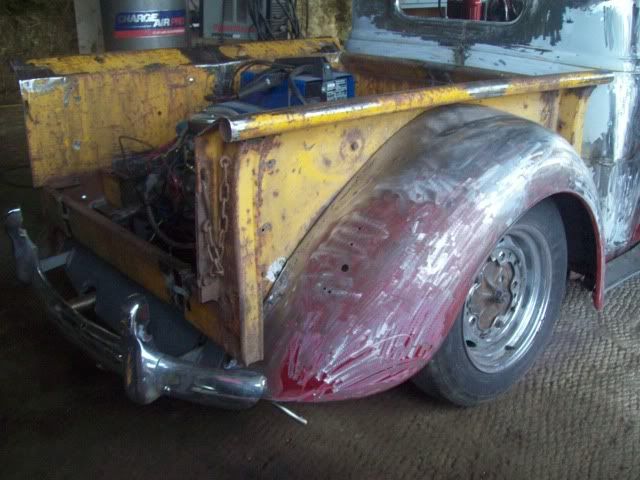

Formed the rear roll pan to tie in the fenders. Ok, maybe not a "roll pan" because it doesn't roll under, but I forget what one might call it. A skirt? Faring? Anyway, still needs some finish work but it gives a good idea of what it will look like when done. The bottom cross brace of the bed will be made to "swing" out or unbolt completely so the motor can be pulled straight back for removal.
Shortened the rear bumper but I like the way it ties in the fenders. This will bolt to the removale bottom rail of the bed and bolt to the fenders for easy removal.
I'll replace the over riders with the shorter versions.

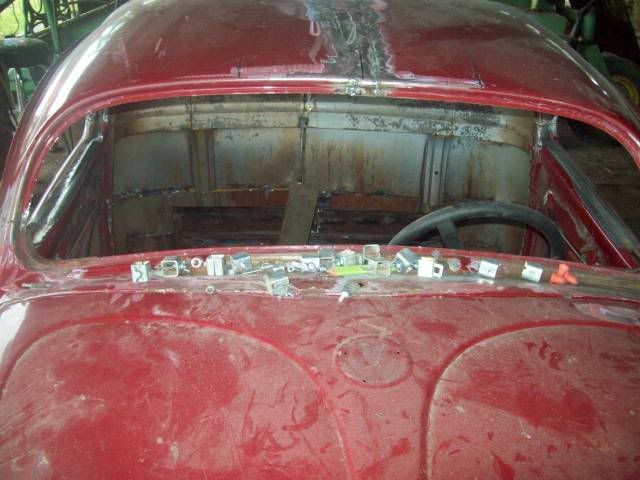

In my continued, "do it twice" approach to this truck, the front windshield frame was just not right along with the center filler strip. You can see it has an unnatural curve in the center.
The front view looks ok, but still not right.
So....cut it out and replaced it.
Still some filler work along the roof, but I'm much happier with the overall results.

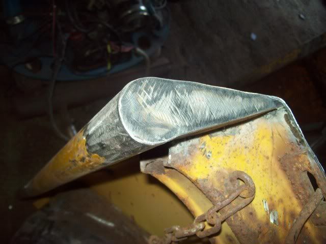

Capped the rear edge of the bedrails. Will start on the fronts next.
The other side.

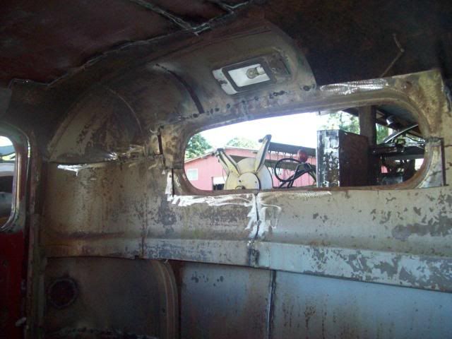

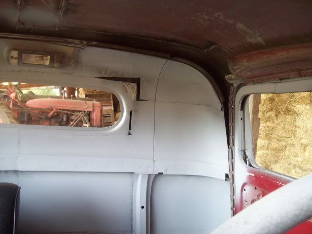

Also had some time to start on the inside of the cab paneling.

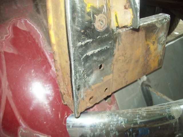

Here's a close up shot of the panel connecting the rear fenders and where the bumper brackets exit the panel. Thinking of cutting out the exhaust holes and using the original metal from the rear apron.

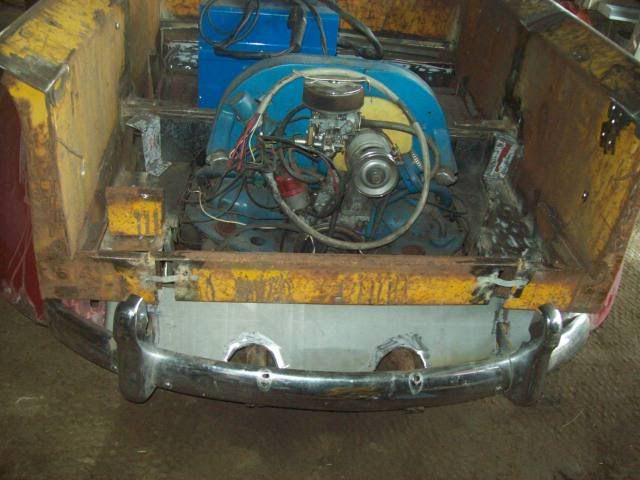

Default Re: VW Bugtruck pickup

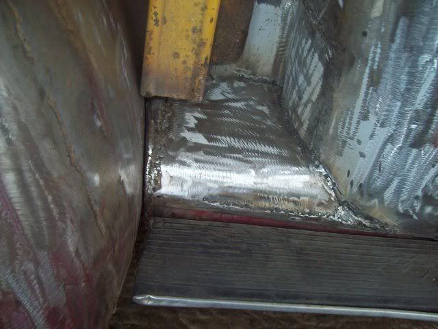

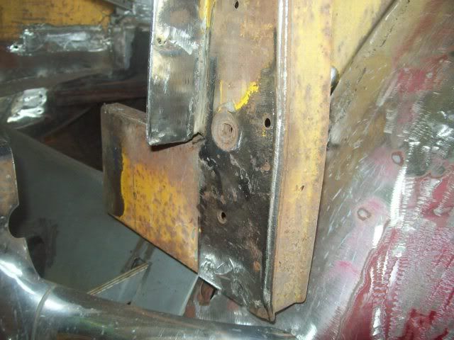

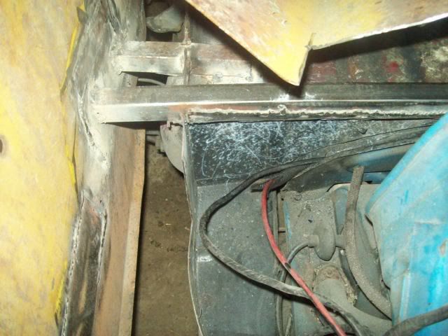

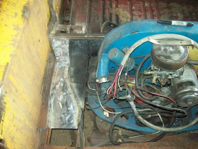

Worked on more boxing of the engine compartment. Have the rear sides done, still some more to go in the front half. The motor has been pulled and getting a once over and dressed up. Should have it back in a week or so.
The other side.

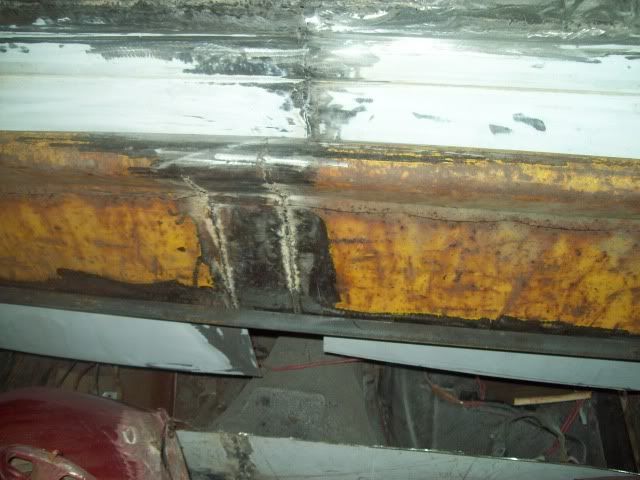

Also worked on some rust repair on the box. The lower edges crack where the tailgate attaches.
The other side. The bedsides come together right at the ends so I welded up those seams as well:

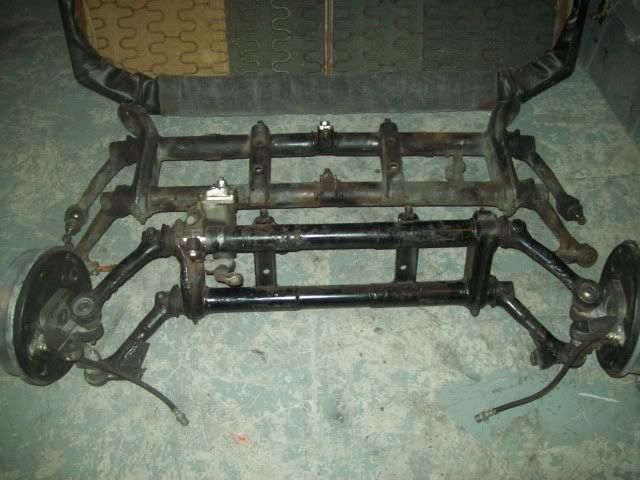

Picked up a crazy 8" narrowed BJ beam, shortened tie rods and spring pack, and two 6" airbag sleeves (which I'm not planning to use). All new and complete front drum brakes, ball joints, CB drop spindles, tie-rod ends, and steering box. The only mods needed to make fit was trim away at one of the cut off shock towers on the steering box side. The remaining shock tower will get boxed in and the access panel in the front apron was increased by a couple inches. Have full turn right and left with rubbing on the headlight buckets...which will need cut down and welded in. Only other thing to do on the beam....weld in adjusters.
The beam really helps pull off the fat fender look of the old truck. It feeds to the illusion of the front fenders are super wide like the rear fenderrs. It also allows plenty of turning radius for the 15X5.5 wheels.

A whole lot of photos of the new -8" beam and wheels. It may seem a bit radical but there is a reason behind my madness.
The reason....to fit these suckers and get low without worrying about fender clearance. The headlight buckets will be trimmed, but that's no biggy.
And a mock up with the rear wheels and tires:
Plenty of fender clearance.

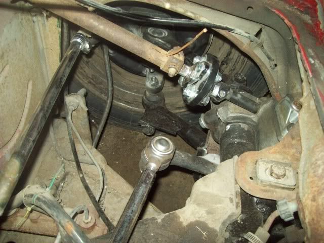

The steering box and tie rods line up. The tie-rod has a solid sleeve welded in but I will replace it with a solid length tie rod. This set up should eliminate alot of the bump steer.
Other than that, did some work on the inside cab panels. Have plenty of filler pieces to weld in but it's a start.
Also completed one side of the step side fillers between the cab and fender. There was a slight gap that needed filling. The other side is next to trim out.

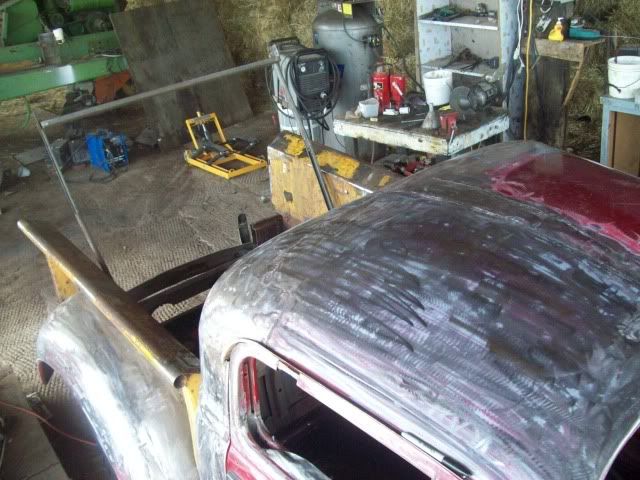

Those are done and now the bed is ready to go to the sand blaster....finally. Also installed a support for the back half of the bed. I hope it doesn't interfere with the motor. Shouldn't....

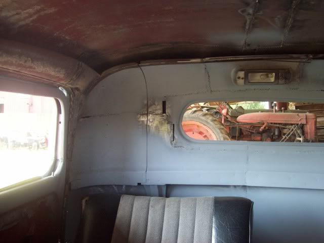

Worked on the inside paneling more but there is a lot to do inside yet. Also shot a quick coat of sealer to keep everything from rusting. Staring to look like something.
Pulled the beam out to install adjusters and to do a little boxing on the cut off shock towers. Here it is in front of a stock width beam.
More welding to go and soon I'll start hammering out the metal to get it straight before the bodywork. Here is one of the step sides completely boxed. Again, more filling and welding.

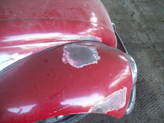

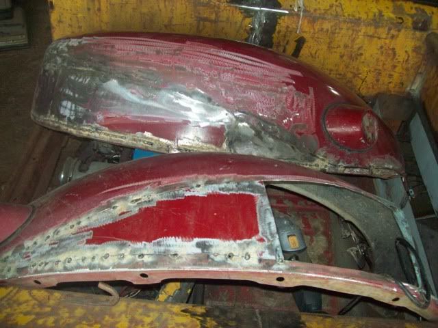

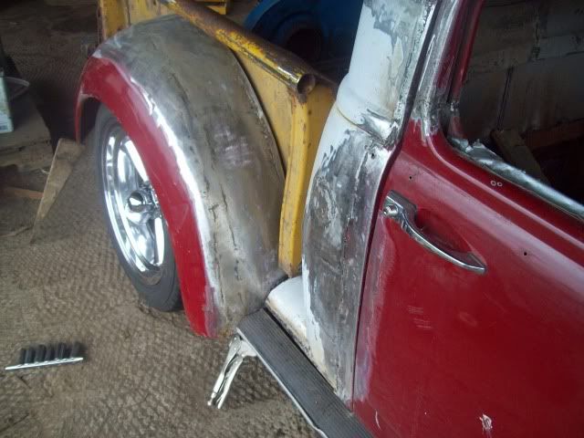

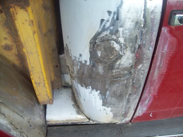

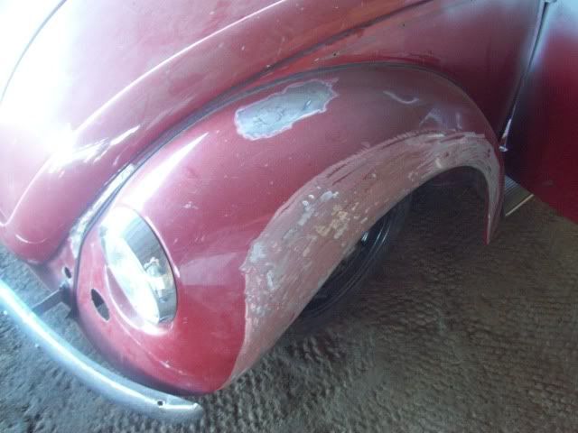

Started stripping the driver side fender to fix a couple stress cracks in the fender lip.

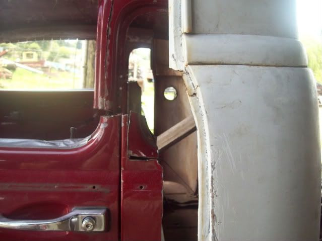

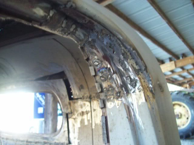

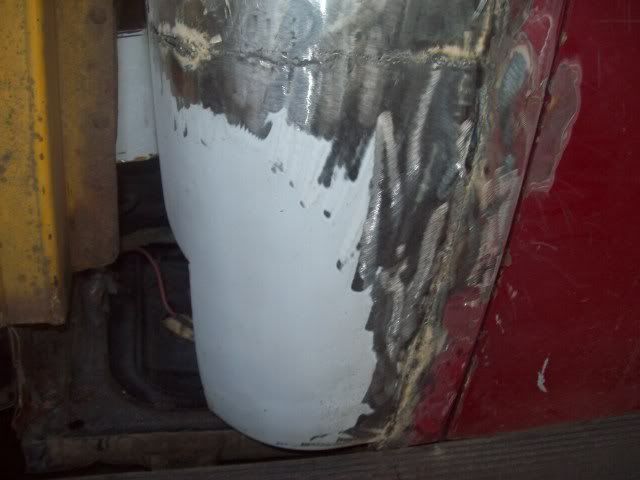

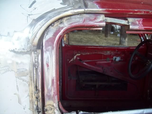

Well the bed is off at the blasters. Over the past couple of weeks, been finish welding a few areas and working on the front beam. But yesterday received a package in the mail from a VR member UT-X, thank you. Door tops to complete the door frames. My first attempt at the radiusing the door top coners reuslted in a need to re-work what was done but he was kind enough to send a pair to me to fix them.

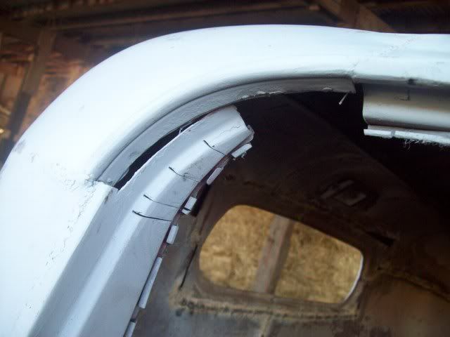

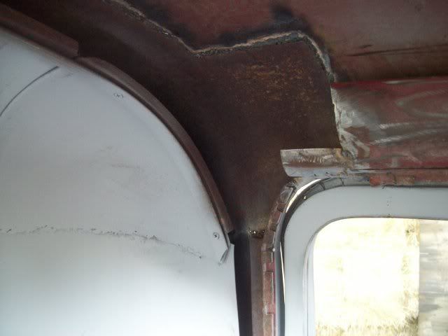

Before starting on the door frames, needed to finish shaping the inside corners of the cab. Have been dragging my feet as I had no idea how to tie it all together. As you can see, a big pain.
So bent up a few pieces. Tacked some, beat on them, repeated... and ended up with something that looks like this:
Photo from the outside. All the welds and seams need cleaning but that's the easy part.
The other side... You can see the different levels of the frame that caused the complication. Again. still needs some grinding work but the shape is otherwise there.
What else? Oh, shaved the front turn signals. Will be relocating them to the grills in the front of the fenders:
Other side:
Finished installing the weld in adjusters, and capped off the shock towers. Of course, no photos but I'll get those when I pull it back out for final cleaning and paint.
Anyway, with the adjuster in, there is plenty of adjustment up and down and with it being so narrow, there's still a good amount of travel in the suspension. I'm happy with the way the beam turned out. The ride shouldn't be bad either.
Lastly, a parting shot of the truck awaiting the return of the bed. Looks sad, but good because it's forcing me to finish welding on the lower half of the cab...boring...

Had a chance to see the bed over at the blasters and it looks good. Only a couple rust areas to fix!
Anyway, here are a couple shots of the capped off shock towers.
Passenger side:
Finished up filling the door tops after re-doing the radius on the driver side door.
And the passenger side:
From a little further away..
Finished welding the rear of the cab.
Still need to finish patching the inside cab panel.
Hit the whole truck with a couple more spot welds and grinder here and there.
Sand blast a few areas, and start beating on the metal to get a few things straight.
Follow it all up with some filler and make some progress on the bodywork!

With the bed back from the blaster, spent some time on the rust repair and filling a few 50-year old holes. Also spent some time blasting other areas of the bug that needed a good cleaning. Picked up the tailgate and narrowed it to fit.
The old lift hinges for the toneau cover just would not work out, so I went a much simplier way with a pivot at the front and built the frame using a discarded king bed frame.
The tailgate up:
"W"??? For "What" or "Whatever" or "Why not?" If you haven't figured it out, it's the "M" from the GMC logo!
Also worked on the inside upper cab corners. Before:
Before:
After:
Threw a stock low back in to check the room. Looks a little small for the room inside the cab. Looking for a nice pair of custom seats to fill up the area a little better. Still not decided. Need a trip to the junk yard.
Here's a quarter rear view of the bed, fender and tailgate. Starting to look like something.
That's it for this week. More patch welding on the bed. Oh yeah, also got a rear bumper from a 46 Chevy to replace the bug bumper. Should look nice and solid.

Well, it's looking like a truck!!
Spent the week welding more holes in the box and finishing the inside cab corners. Still more rust areas on the bed to repair. Became annoyed with all the hot sparks finding there way inside my socks, so started fine tuning the roof metal and other areas needing a good beating. Hit it all with the in-line sander.
No idea what happened to the photo quality...some low-light setting?
There are a ton of rock chips that needed to be taken down. The front end looks like it will not require too much work.
It takes all my will power to keep from starting in with the filler. Need to get the metal beaten out specially the roof before that happens.

Thanks to VR member Mundo, he went over my motor and found that I have a 1600 SP rather than the 1500 I originally believed. the rear motor tin will need to be custom made to fit against the rear cross bar of the pickup box so the seal will keep the heat away.
Anyway, he cleaned it and dressed it up:
Got it home and rebuilt the carb. Hopefully that will fix the idle problem. Haven't had a chance to test the idle after the rebuild. Other than the shady idle, the little motor runs great.
Also got the truck shot in a coat of sealer followed by some high build primer. Much better resolution on the camera this time around.
the rear wheel looks off center to the fender but the fenders are not bolted on and the front edge will pull forward some when all bolted up. The front edge of the bed looks like it is sitting down, that's because the front mounts will get a rubber pad to raise it up some.
More overall shots:
The inside of the bed with the frame structure exposed looks like this...
When the wood bed goes in (front of the bed to the cross bar just behind the brown angle iron), all of this will be hidden.
Also finished the inside cab corners and installed the top mounting point for the shoulder harness. Should be strong enough with all the attached points to the B-pillar, the inside cab paneling and roof structure.

One last shot for fun...What is really pleasing to me is the way the a-pillars line up. No filler and it's hard to tell it was ever chopped.

Got the roof pounded out enough to start with the Duraglass but that all came after welding a few more holes and even more grinding. Have finally reached a point where the cab is all welded. DONE FINALLY! Still need to address the front apron, the tops of the doors (again) and a couple spots on the bed, but getting close to putting the welder away.
Skimped on the hardner on the first batch and now must wait on the extended drying time. Good thing it's a real thin layer.
the roof is straight enough to finally show a front view. Was frustrated with the warpage. Ok, more embarrassed to be honest.
Once I got started coating all the weld seams, I realized how much welding was done to get to this point.
I Must have gone through 7 lbs of wire to stitch this thing together....ok I admit, not the best welder on the block.
The inside panel:
Once I pull the rear fenders back off for the 90th time and start on the outside paneling, there are even more seams and holes to coat.
When I'm at a point where I can start blocking it out, I'll get it up off the ground and finish cleaning the underside of the pan and get a coat of sealer on the belly. Until next time...

Worked on getting the roof straight. A little rusty at filler work. Took a few batches to get the filler to hardner ratios figured out again. Here is the roof shot in a coat of high build:
Looking much better
Welded up the overrider holes in the front followed by a quick coat of Duraglas. There is some work needing done on the front apron. It was repaired at one time so ended up blasting it all out and will start anew.
Got one front fender smoothed out and started on the lower section of the cab transition.
The goal is to have all of the rough bodywork done before the end of month. Once at home in the garage, I can work on the finish blocking coat. It's getting too dark to get any work done after work. Need to get it in the garaage!

Thanks to Mundo and his car trailer...the bug truck is finally home!!!
The rough bodywork is done. The rest can be easily blocked out by hand. Time consuming yes, but having it home is great!
Here she is sitting at home, this thing is really small. Look at at the height of a standard garbage can sitting next to it. Mundo crawled in and I thought he was going to lose his head. Still plenty of head room... Again Thanks Ray. Anyway, on with the photos:
Thought I would try the photo with the flash off, had to tweek the brightness some on the photo, but it's a cool photo:
All the fenders and running boards are hanging there with just a couple of bolts. The rear fender supports are not mounted either. Once the fender support brackets are installed, it will correct the fender alignment with the rear tires. Now tear it all apart and start working on the little stuff.
