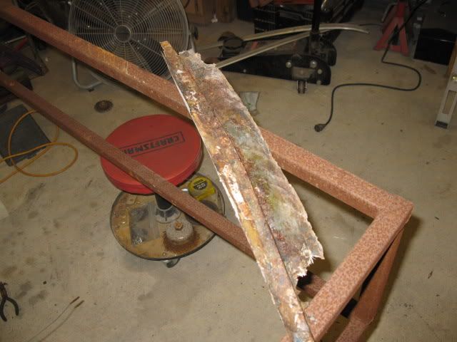

It's good news, bad news time.
It goes like this; curiosity got the better of me. I was sanding the left heater channel/ sill area to try to make it look a little better. As you may recall, the plan was to clean that area up a little and leave it alone. Well, cleaning it up left some loose edges so I "cleaned" them up a little and the metal looked good underneath. That's good news. So, I cleaned it up a little more and all of a sudden a large chunk of fiberglass and bondo came off.
That's bad news or good news, depends on how you look at it. I look at it as now we know what's under there (good) but more work for me (bad). There was some rust but not much in the door jamb (good) but the car has been hit pretty hard at some point so the heater channels is pushed in a good inch (bad).So, I broke out some of the fiberglass cloth and resin and started a couple of layers. The heater channel is pretty bad as it curves around by the vent (bad) but I can fix it (good).

OK. I've put a couple layers of 'glass on the heater channel but I don't like it. Here's the gap still
I just happen to have a section of heater channel so I might just cut out part of the old one and weld this in. We'll see.

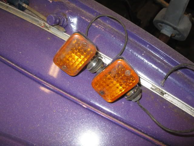

and I found these if you want to use them

That crap in a can known as great stuff sucks. Once Polyester resin touches it begins to swell a bit. plus it never fully hardens and will trap moisture.
I am not much for glass on steel myself amd would recomend epoxy for longer life, but it won't stop rust.

I won't argue with ( where's the damn book) Jon. I haven't had it melt on me.
Why dont you just weld tube in there?

I'm probably going to weld in a section of heater channel...see above.
This is a super-low-budget build.

not much happening today. I did cut out most of the fiberglass and bent, rusty metal.
and starting fitting a "new" piece
Once the top skin was cut off I was able to straighten a lot of the metal where it will weld to the new pieces. I also gave it a few whacks from below.
