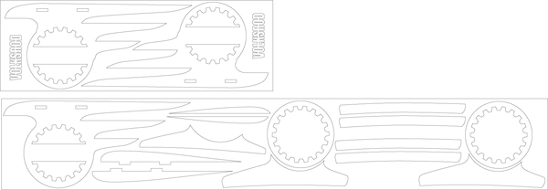

Didn't get as far today as I had hoped. I did manage to come up with the cut sheet for the basic elements of the hood ornament. The top, short pattern will be cut from 3/16" material. The bottom, longer pattern will be cut from 1/8" material.
It will all be cut from balsa to start.....on the new laser cutters that I got trained on tonight at the new TechShop here in town!!!
Then I will put it all together, sand and fill it, soak it with SuperGlue to harden it and see where I am at. If all goes well, I can send it to Unkl Ian for a quote on getting it cast.

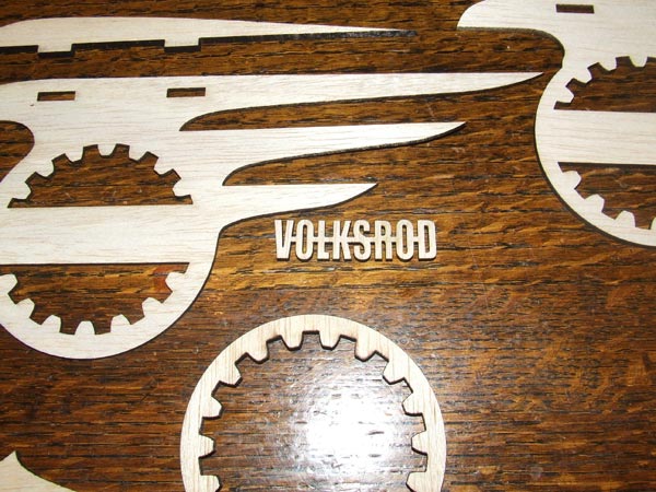

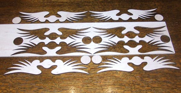

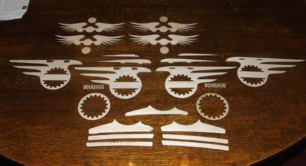

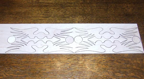

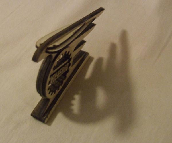

I took some time at lunch today to run over to TechShop and laser cut the bits for the hood ornament and a few other fun things.
Have to say the laser cutter is amazing. Total cut time for everything was less than 5 minutes. Only spent an hour total monkeying around set it up and trying to remember stuff from the class the night before. All parts cut from 1/16", 3/32", and 1/8" balsa. Totally cool...
Oh yea....pictures might help.
The VOLKSROD script is only 1/2" tall by 2" wide...
Just dry assembled. Need to glue it all together and add the draft and stuff...
and a couple of shots of the fun stuff...
That is a 4" wide sheet of 1/8" balsa...
I will be assembling these and painting them up for the auction at Autorama this year.
The machine can also do laser etching of jpeg images on a variety of surfaces. Got some ideas for that capability too...

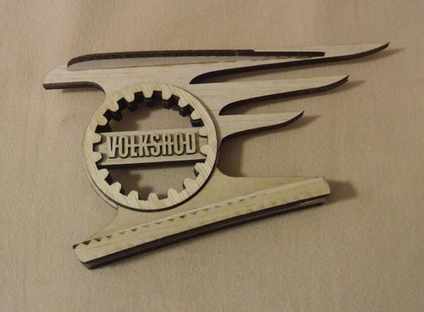

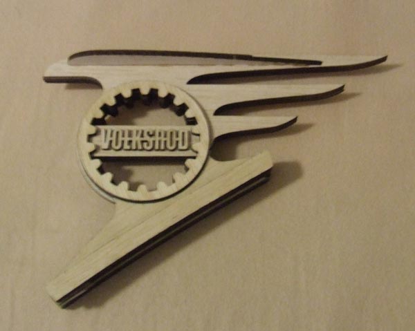

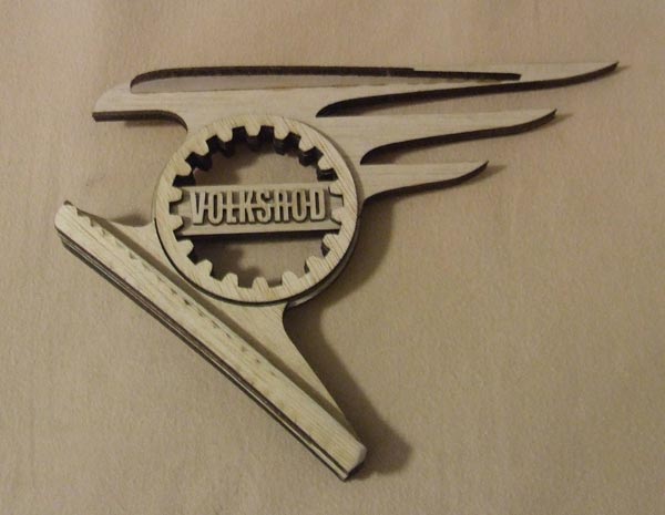

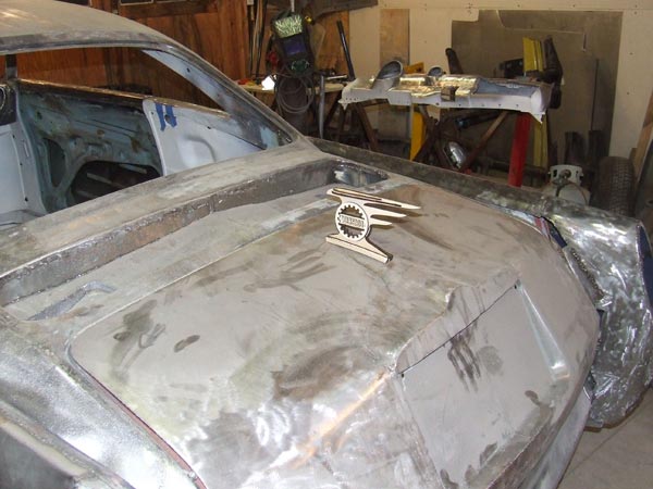

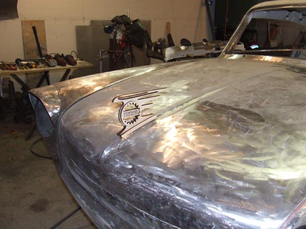

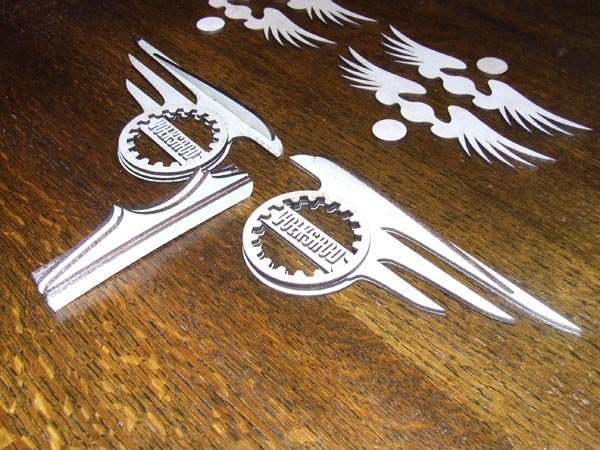

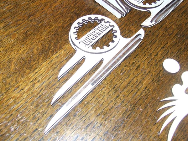

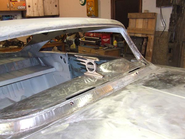

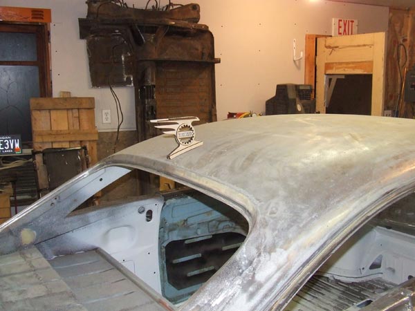

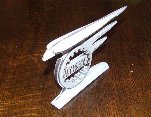

Got the pattern all assembled tonight....
Set up for mounting low on the front of a Beetle hood...
Set up for mounting on the Beetle decklid...
Set up for mounting on the hood of a Type 3 or high on the rear of a Beetle hood...
and a few examples of the possibilities...
the possibilities are endless....
Lots of sanding and filling still to do before getting around to the casting part. I am really happy with the results so far...

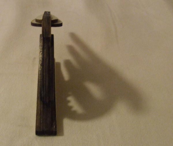

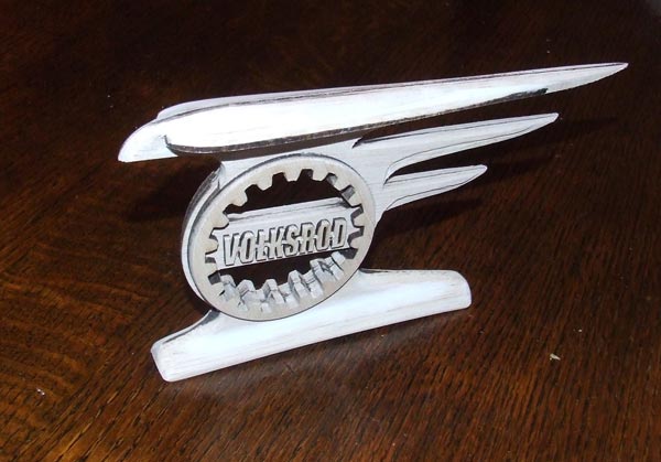

Lots of sanding and filling done. Lots more to go...
