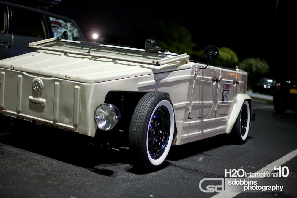

New to aircooled VW's and this forum. I have been busy playing with watercooled VW's and decided a few years back that we wanted an aircooled VW. We found a Thing near our house and we had to have it. The car had all sorts of issues so I parked it in the garage until I could afford to build it. We took the body off the pan and POR 15 everything. I replaced every cable, hose, hard line, bushing, bearing... Bought a 2276cc turnkey motor w/ Dual Weber 44IDF's and Freeway Flyer tranny, Airkewld air ride setup, 4" Narrowed beam, Wilwood Front disc brake conversion, shitty EMPI rear disc conversion, custom whitewalls from Diamond Back, pulled off the front fenders, straightened out wiring... This past summer we took it out on its maiden voyage. We had a packed car and one of the rear bag mounts broke off and the car slammed down. It caused a rear trailing arm to bend. As a quick fix I had a buddy of mine straighten it out until I replaced the trailing arm. I have found some boxed "beefed" up trailing arms (stock dimension) and will weld new mounting plates to them. Does anyone have any experience with lowering an IRS with those boxed trailing arms. I need to weld some mounting points for the shocks on the arms and figure what to do about the top bag mounts. I want this to lay frame. I also plan on installing a beam extender. Anyone have experience with this extender?http://www.peglegmetalwerks.com/beamext.html

Thanks for all the feedback. Unfortunately as a noob I was on the Samba and saw Airkewlds advertising everywhere and doing some searching around alot of people swore by Airkewlds product. I also was able to contact Pete throughout the whole transaction and when ever I had a question he was always there. I had a good experience with Airkewld, my only real gripe is the top mounting bar that the bag mounts are welded to. We bought a chromoly bar to replace the bar in the kit and welded the top bag mounts to it and with all the weight in the back (had 3 full size adults) a pressure point was created on the weld and a chunk of the bar broke off causing that side of the car to slam down. When I pull the body off were going to re-engineer the way that was mounted. I contacted Dbug41 about his beam extensions last night and will be purchasing one very soon. Thanks for the info. I also had a PM that recommended him for the extensions. Im going to check out what was done to Ratlook63's chassis.
vaporado is offline   Reply With Quote

don't get me wrong, ther's quite a lot of his non mechanical products that I find very cool if that's the look you are after( I've got a set of his dial faces for my buggy), but stories of mismatched brake components, poorly spec.ed hardware, missing hardware and just poor design. Glad to hear he was alt least nice to you. Doesn't sound like he offered or provided a SOLUTION to his inadequate design, but hten again, It sounds like it wasn't something he provided that failed, but something you had attempted to use to correct an obvious deficiency in his product. Make it beefier!
BTW, the shock tower castings were never designed to carry the weight of the car....
If the car was designed to carry three adults, his design should AT LEAST accomodate and support that.

I never considered the weight of the car resting on just the shock towers, hmmmmm. Well the rear has to be redone now anyway because of the rear trailing arms. When I pull everything apart we will look at how to overkill supporting everything.

Well after a long battle with the Thing its officially on the road. Thanks for all the links and insight. Got DBug41's 8" beam extension and had the front braced. We used boxed trailing arms in the rear and braced the rear really well for the rear bags. I will dig up build pics but this is the final product.
