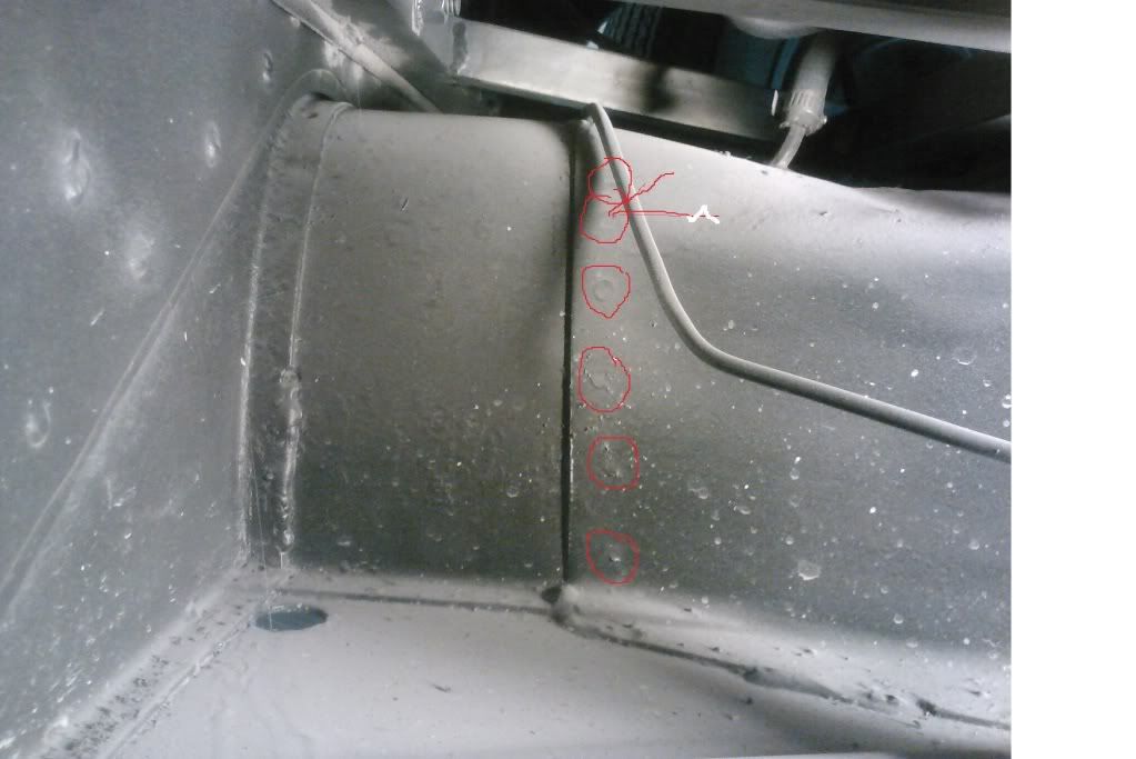

There is a lip ( red arrows ) wire wheel the area and you will find some spot welds that hold the frame head to the tunnel.
You should be able to drill them out and remove the old piece then install the new one. Please correct me if I'm wrong.

,Thanks very much for showing me where. I just went out and gave it the wire wheel but it is welded all the top and sides and whats really confuseing me I guess are all the overlapping parts with welds on them so that is why im not sure. Should I just cut it off in front of the weld and grind the rest off or leave what I have for extra strength and fit new one over whats there. Sorry for all this but I know this is VERY critical and would like to just do this part once.

You should still be okay, outlined in red is original material. you can try to find the spot welds or grind off what is there but be sure not to grind into the tunnel material underneath.
here is what it looks like from the VW factory....what you have has been butchered by a P/O.

Alright, now I can see more clearly, thanks alot for clearing it up for me, back to the grind tomorrow then. :-)
